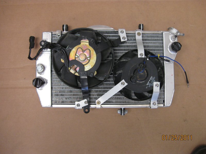

XX123 Posted September 16, 2013 Posted September 16, 2013 QUOTE(mekeal23 @ May 8 2008, 03:07 PM) ā In FLA I've had many problems with high temps on my BB.....But now I've solved my problem. I shifted the radiator 1.5 in forward to get some clearance from the header pipe.(had to do a little welding) Moved the OEM fan to the left side of the radiator. Installed a secondary fan(smaller fan) on the right ride using the bracket from another OEM fan.Made a littte mod the fairing behind the wheel. Installed switch and wire it directly to key switch.....presto. Tonite it's 82 degrees with no breeze and I let the temp climb to 220 and it pulled in down to 208 in 3 min. Have to give an update when I give her a field test...I'll update some pics when I get my camera from the wifey. I took your advice and also installed a second cooling fan on my 2002 XX and it works fine. I've never experienced boiling over but the temps would get to 225+ and even though there didn't seem to be any damage to the engine I didn't like looking at the gage reading that high. Thanks for the info and pic's you sent. Second_c...bird_005.jpgSecond_c...bird_006.jpg what fan is the 2nd one? I like the size of it, and it looks like a stock fan. Quote

XXitanium Posted March 30, 2014 Posted March 30, 2014 QUOTE(mekeal23 @ May 8 2008, 03:07 PM) ā In FLA I've had many problems with high temps on my BB.....But now I've solved my problem. I shifted the radiator 1.5 in forward to get some clearance from the header pipe.(had to do a little welding) Moved the OEM fan to the left side of the radiator. Installed a secondary fan(smaller fan) on the right ride using the bracket from another OEM fan.Made a littte mod the fairing behind the wheel. Installed switch and wire it directly to key switch.....presto. Tonite it's 82 degrees with no breeze and I let the temp climb to 220 and it pulled in down to 208 in 3 min. Have to give an update when I give her a field test...I'll update some pics when I get my camera from the wifey. I took your advice and also installed a second cooling fan on my 2002 XX and it works fine. I've never experienced boiling over but the temps would get to 225+ and even though there didn't seem to be any damage to the engine I didn't like looking at the gage reading that high. Thanks for the info and pic's you sent. Second_c...bird_005.jpgSecond_c...bird_006.jpg what fan is the 2nd one? I like the size of it, and it looks like a stock fan. Right, OEM - what vehicle? Honda Accord? Quote
