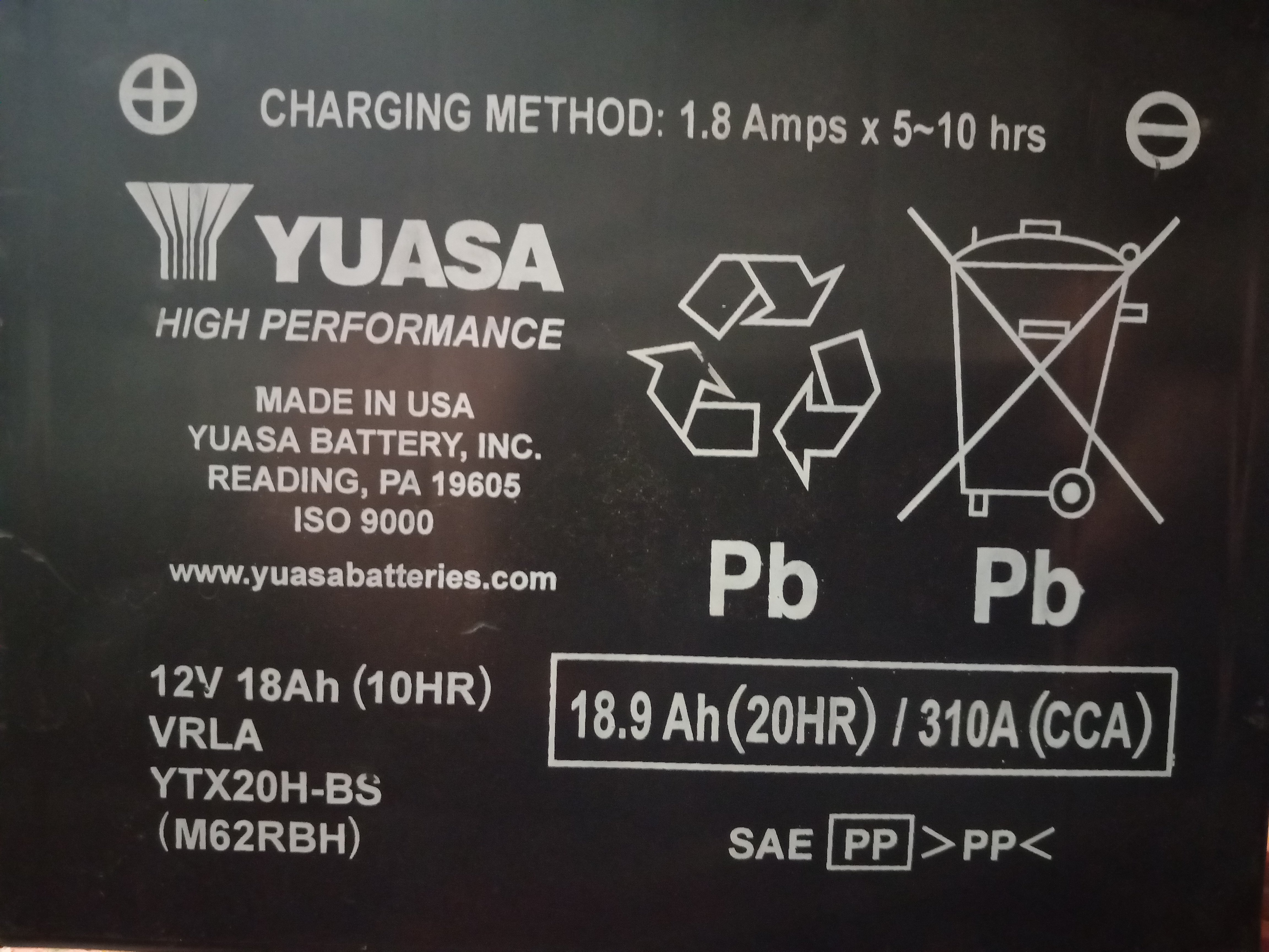

XXitanium Posted April 30, 2022 Posted April 30, 2022 On 4/11/2021 at 1:36 PM, ironmike said: Almost all trickle chargers have a programmed voltage threshold below which they won't initiate a charging cycle (check to original paperwork). Most have no way of alerting you to a below threshold voltage - per the LED(s) they appear to be working normally but they're not actually charging. Â I have an old Sears 12v 10/2amp charger w/voltmeter from the early '70s that I'll employ at the 2amp setting whenever I suspect a trickle charger isn't really performing. That works just fine for motorcycle batteries. After a full bench charge, the trickle charger is re-applied. After installation I retest voltage at rest and under load. Â I have an earlier version (BA-7)of this load tester . . . Â https://cloreautomotive.com/product/ba9/ Â Â Â Apparently you can trick the logic. You hook two batteries in parallel. Out the discharged AGM on the other side of the good battery. Â My AGM-battery in the CBX wouldn't even turn the neutral light on yesterday. Â I think the battery is more than six years old. I'm trying to decide if I should go try this resurection, or just excercise my plastic at the parts store and get a new battery. Â Â I think I "need" a C-TEC charger. Quote

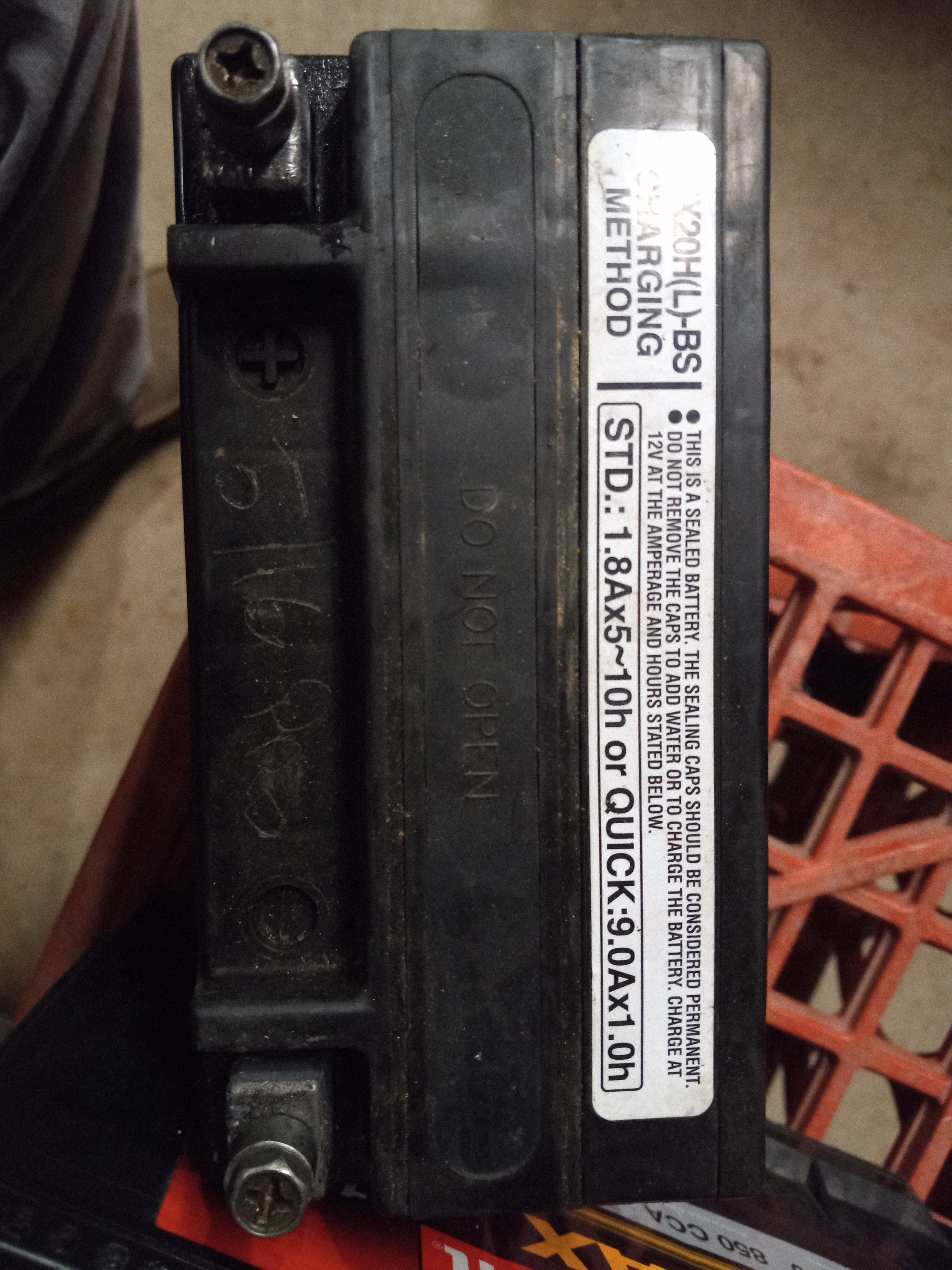

XXitanium Posted April 30, 2022 Posted April 30, 2022 (edited) Battery "Failed" version. (Need new battery) Â I typed in "AGM- battery" with a dash for searching later. I had almost 8,000 results here for everything from weed whackers to personal pleasure devices... Â The search function does not "do" TLAs pretty much at all. Â Â Edited April 30, 2022 by XXitanium Clarity dammit Quote
SwampNut Posted April 30, 2022 Posted April 30, 2022 A parallel battery is how I "jump start" my intelligent chargers. Â It can even be a tiny battery, I once used the one out of the alarm panel to do it. Â I recently did a thread about my generator battery. Â A week or so on the restorer and it's starting the generator almost like new. Â I keep forgetting that restorer is sometime magic. Â 1 Quote
superhawk996 Posted May 1, 2022 Posted May 1, 2022 On 4/30/2022 at 5:35 AM, XXitanium said: Â Â Apparently you can trick the logic. You hook two batteries in parallel. Out the discharged AGM on the other side of the good battery. Â My AGM-battery in the CBX wouldn't even turn the neutral light on yesterday. Â I think the battery is more than six years old. I'm trying to decide if I should go try this resurection, or just excercise my plastic at the parts store and get a new battery. Â Â I think I "need" a C-TEC charger. I stopped at the 4 minute mark, after doing some fast forwarding to that point, because right away I was guessing it would be somewhat retarded. Â You don't have to waste so much time doing what he did, and it's a bad idea because if the dead battery has a shorted cell the charger may not see it and keep trying to charge. Â Put your charger on the dead battery, jumper in the good battery, hit the start button, disconnect good battery. Â Option 2, do the same but use a dumb charger instead of another battery. Â Typically, once the smart charger starts it'll stay on when you disconnect the jumper, it just needs to see enough voltage to start. Â It's the same whether it's AGM or flooded, smart chargers all have a minimum start voltage. Â And as Carlos pointed out, damn near any battery will do the trick. Â It takes very little amperage to get the dead battery's voltage up, could probably even do it with a 9v alkaline battery. Quote

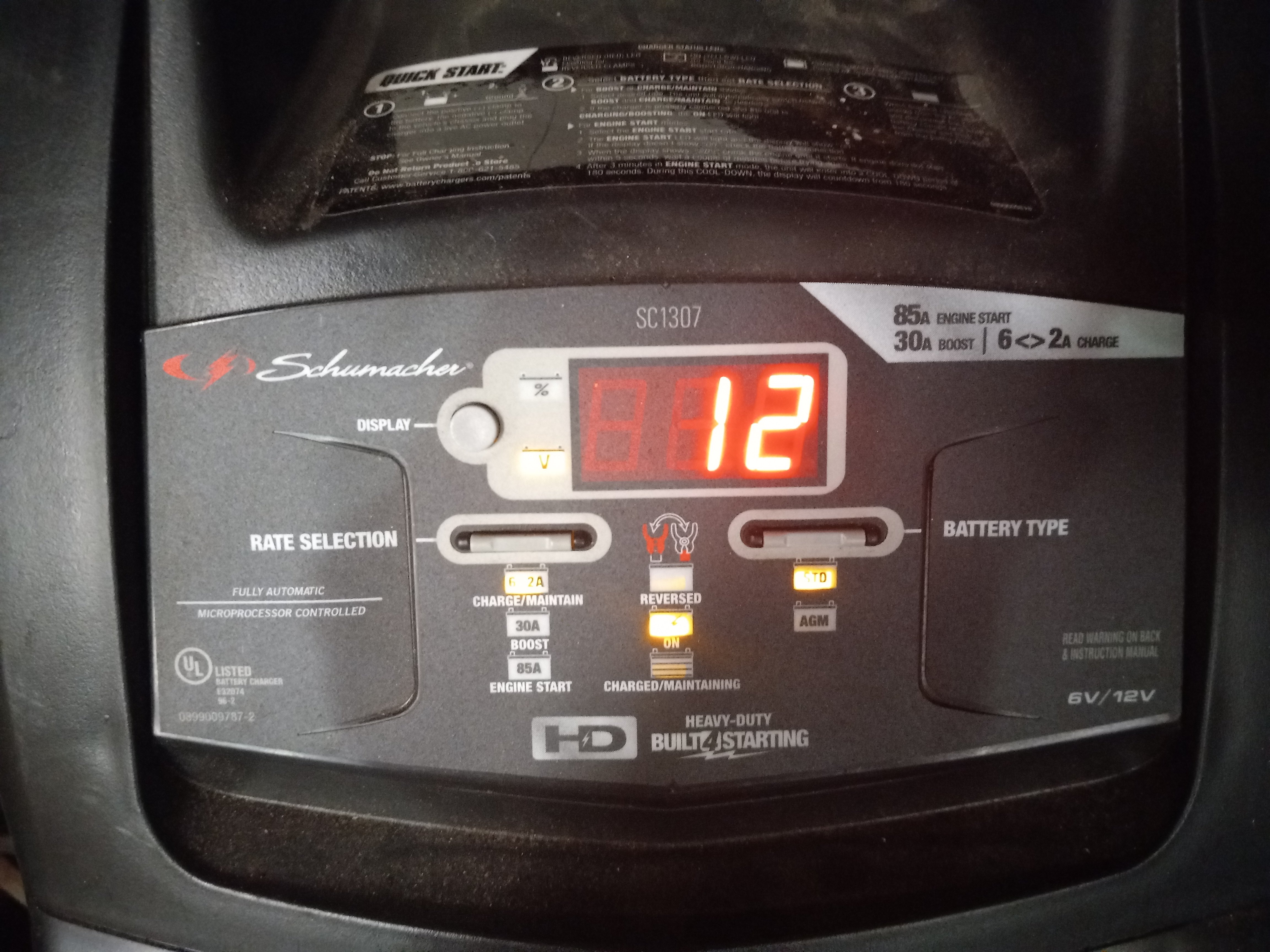

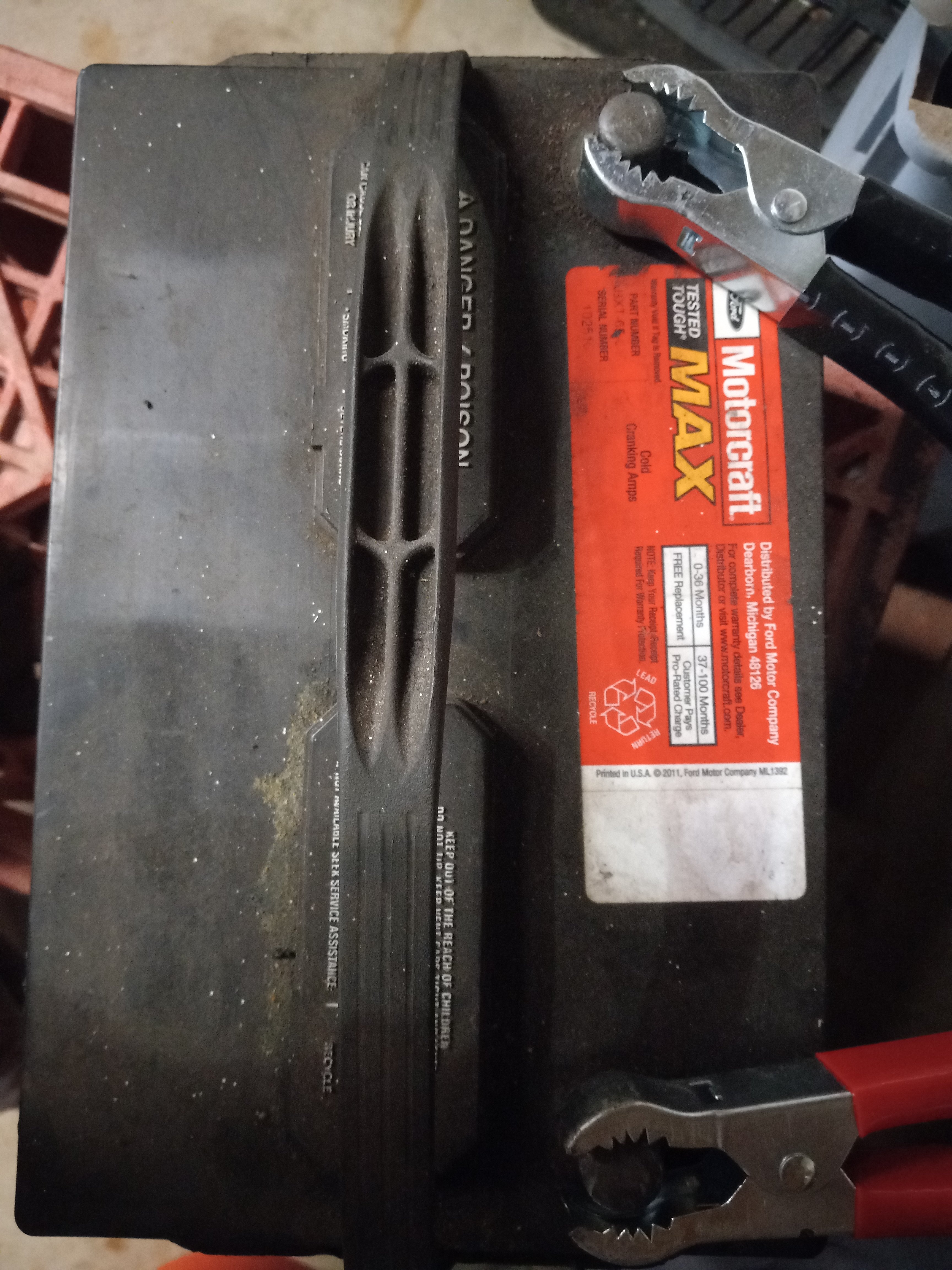

XXitanium Posted May 1, 2022 Posted May 1, 2022 I hooked my big shop (spare car) battery up backwards momentarily to my Schumacher. Duh! Â The shop battery was low. It's charging now. Â The CBX battery has 5/16 (May 2016) scratched in the top. ...that:s when I got the bike back from the shop. Â The CBX battery threw a code "SUL" on the Schumacher display. It's a sealed unit, but it does not specifically read AGM. Â https://www.motortrend.com/how-to/impp-1105-battery-desulfators-fact-fiction/amp/ Â I think I'm just going to buy a new battery for the CBX. Â Quote
XXitanium Posted May 1, 2022 Posted May 1, 2022 (edited) The shop battery voltage. Â No desulfating mode. Â https://www.schumacherelectric.com/products/6-2-30-85a-6-12v-fully-automatic-battery-charger-engine-starter/ Â Â Edited May 1, 2022 by XXitanium Quote
