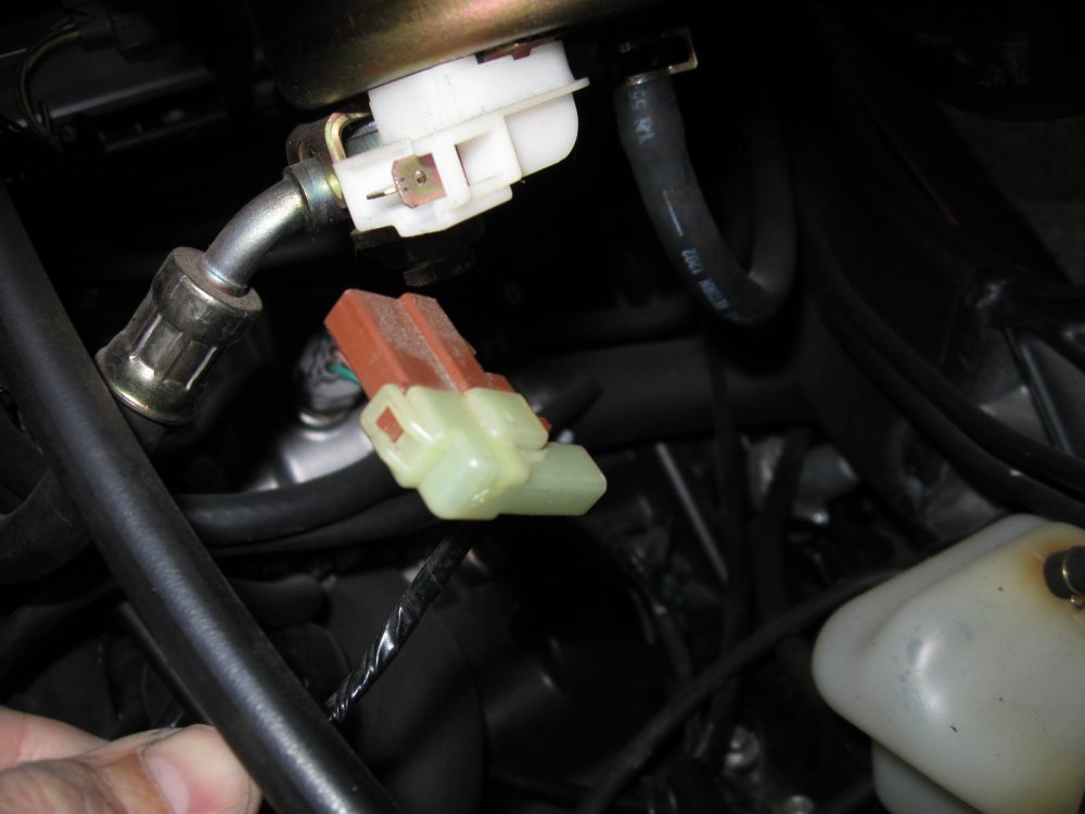

I almost got stranded today on my '01 Redbird. No running issues before whatsoever, parked after 20 minute ride, tried to start and heard it starving for fuel, then nothing. Cranked over strongly- good battery. I checked the fuses, lifted the fuel tank and started checking connections. I moved the connections on the fuel pump, and it then started. Runs normally since then, so it was corrosion at that connection and not the fuel pump I assume. My XX almost 20 years old- should I CorrosionX all the connectors, or do something better?

Before messing with the connector did you notice if the pump was running?  If so, did it sound normal?  I always paid attention to mine but I know some, maybe most, ignore it.  First few times I started the '97 I had a brief "oh shit" moment.
The connector doesn't look like anything's wrong, but it might have something I don't see.  And it's not a switch connector, just fuel pump connector.  I can't think of a reason to not hit it with CorrosionX, but if it does have corrosion/burns/looseness that should be taken care of first.  The spray might help a minor problem, but isn't a proper cure and it probably won't last if the problem isn't properly repaired.

Come to think of it, I do not remember hearing the fuel pump humming when I attempted starting. No clear signs of corrosion and no burns at the fuel pump connector, but jiggling it worked and got me home. There were no signs of corrosion either on the dreaded factory test plug when that left me stranded, so I'm still thinking that this is the issue at the fuel pump connector. I hoped someone else had experienced and recognized the same problem. I will go through every connector and ground as OMG has suggested.

Update  and not good- got stranded with no functioning fuel pump. No warning, just go/no go failure. Thought wrongly that corrosion at the connector plug was the issue, only temporary.  I suspected fuel pump failure, but tested voltage at the brown plug- no voltage to the pump! Hot wired fuel pump- it works. Fuse panel checked out. Where and what should I go back from the connector

1. Check fuel pump relay and connector(s)
2. Continuity of individual wires in fuel pump circuit. This circuit includes the ECM, so unplug 2 large connectors to it and clean/inspect + look for any broken wires. Also, make sure ECM is strapped down. There should be a very large O ring over it but can use bungy cord/wire ties etc.
3. Last but not least, you may need to do the "loom fix". In short, there is a junction block hidden under the loom tape that corrodes and causes intermittent/unusual electrical maladies. Not that hard if you are handy with a soldering iron.

The trigger for the fuel pump relay is a ground (I think its a ground) signal from the ECM on 4th wire counting from the LHS. Wire is listed as Br/Bl. This trigger signal may be dead.
Only reason I mention this is because this exact problem has come up a few times on another blackbird forum. If everything else checks out OK, then solution is either another ECM or hot wire the bad ground trigger signal with a relay thru the stop/start switch. This will allow the pump to run ALL the time the ignition and stop switch is on, for normal operation of the bike.   If you resort to this remember the ECM will no longer be able to shut off the pump in the event of trouble.

Thanks for the suggestions and insights. Yes, with ignition on there's no fuel pump sound at all, but I hot wired it and it's functional. I mentioned the first time it almost failed previously- I jiggled the fuel pump connector switch and that worked for a few weeks/couple of rides, thought it was corrosion there- I don't know if this is a real clue pointing to the actual fault or not.

No, not exactly. Disconnect or cut the Br/Bl wire (that goes to the ECM) near the  pump relay end and attach a new one that goes from said pump relay to the new relay.  Take the ECM out of the fuel pump loop altogether.  I have not done this procedure myself, so please double check against the wiring diagram and your own troubleshooting.
This would be after you have eliminated all other faults.
