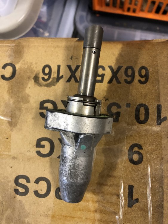

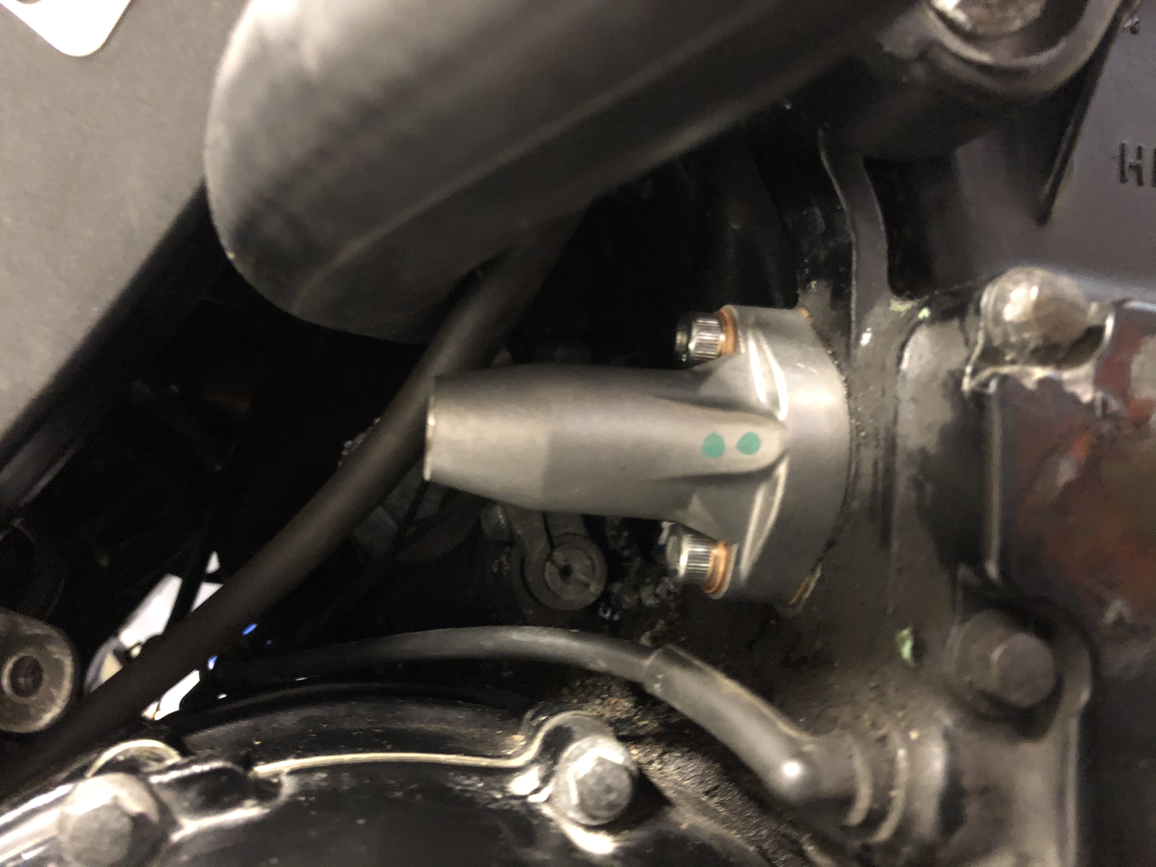

Got the new CCT in, very easy, out with the old
And in with the new

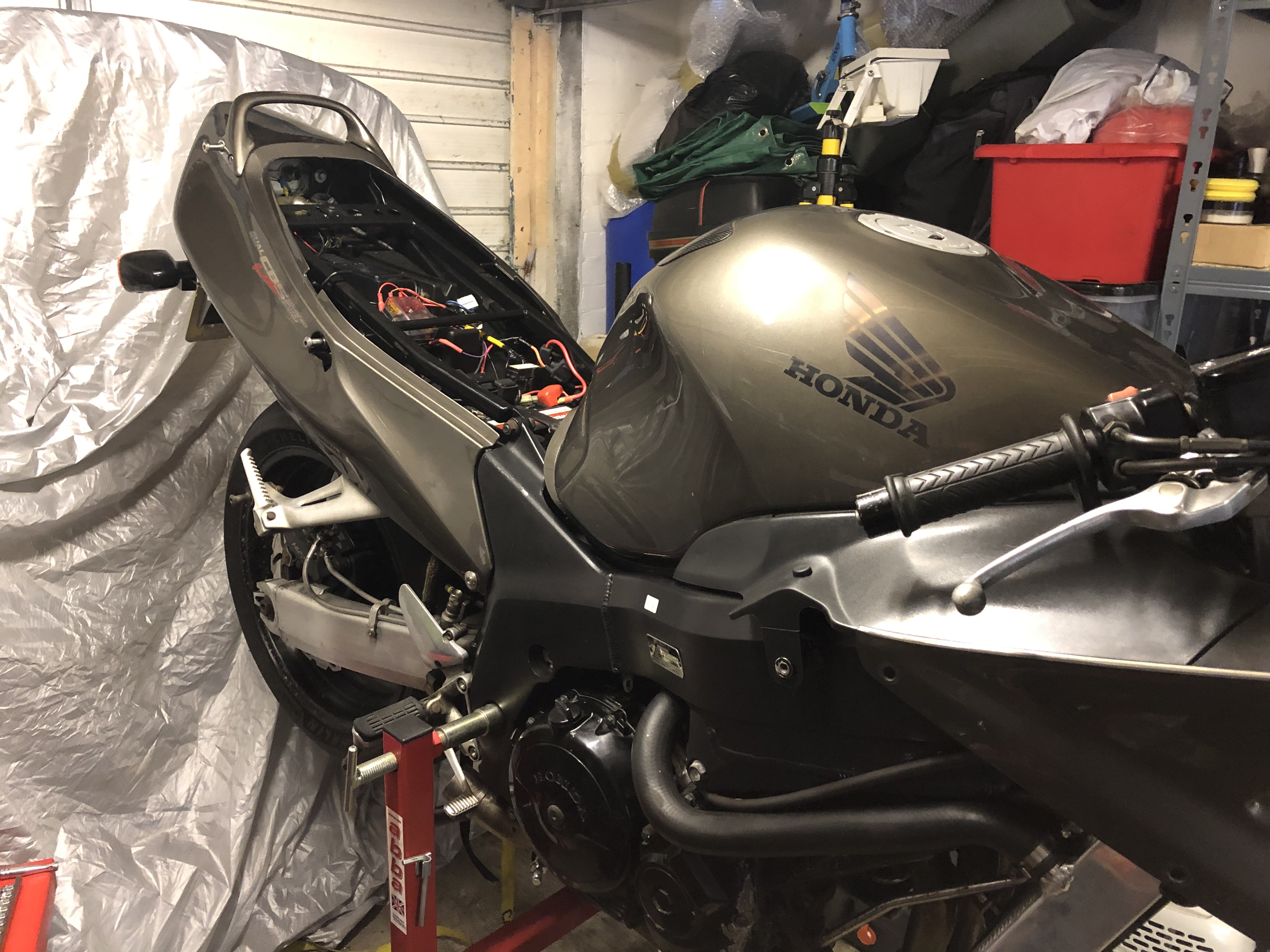

So the next job was to adjust the cameras so they picked up and recorded correctly, easy, however, as soon as I switched the bike on I noticed that only one of the four led lamps on the dash was working.  So the nosecone and screen had to be removed as well as the infills as I managed to drop a lamp and holder into the gunnels 🙄
Anyway, that sorted I fitted the rear cowl, it will need replacement as there are pieces missing but that’s no biggie.

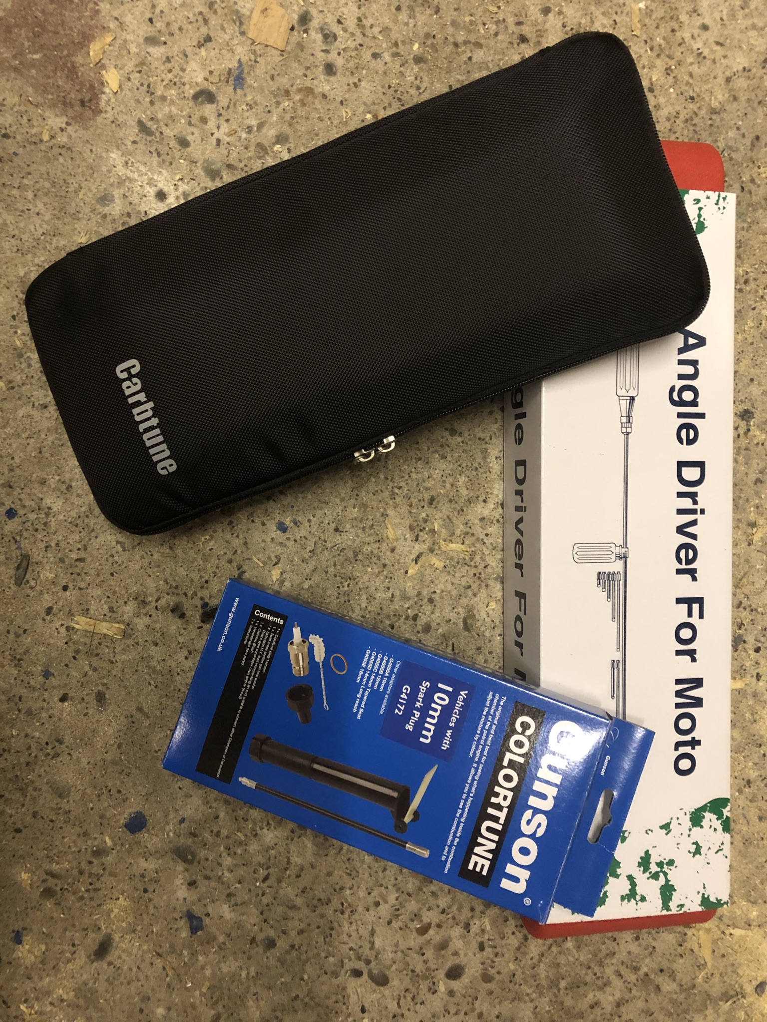

My carbtune, colortune and fancy screwdriver arrived yesterday so I just need my exhaust cans and I can get the bike finished.  Test date is now 8th January.

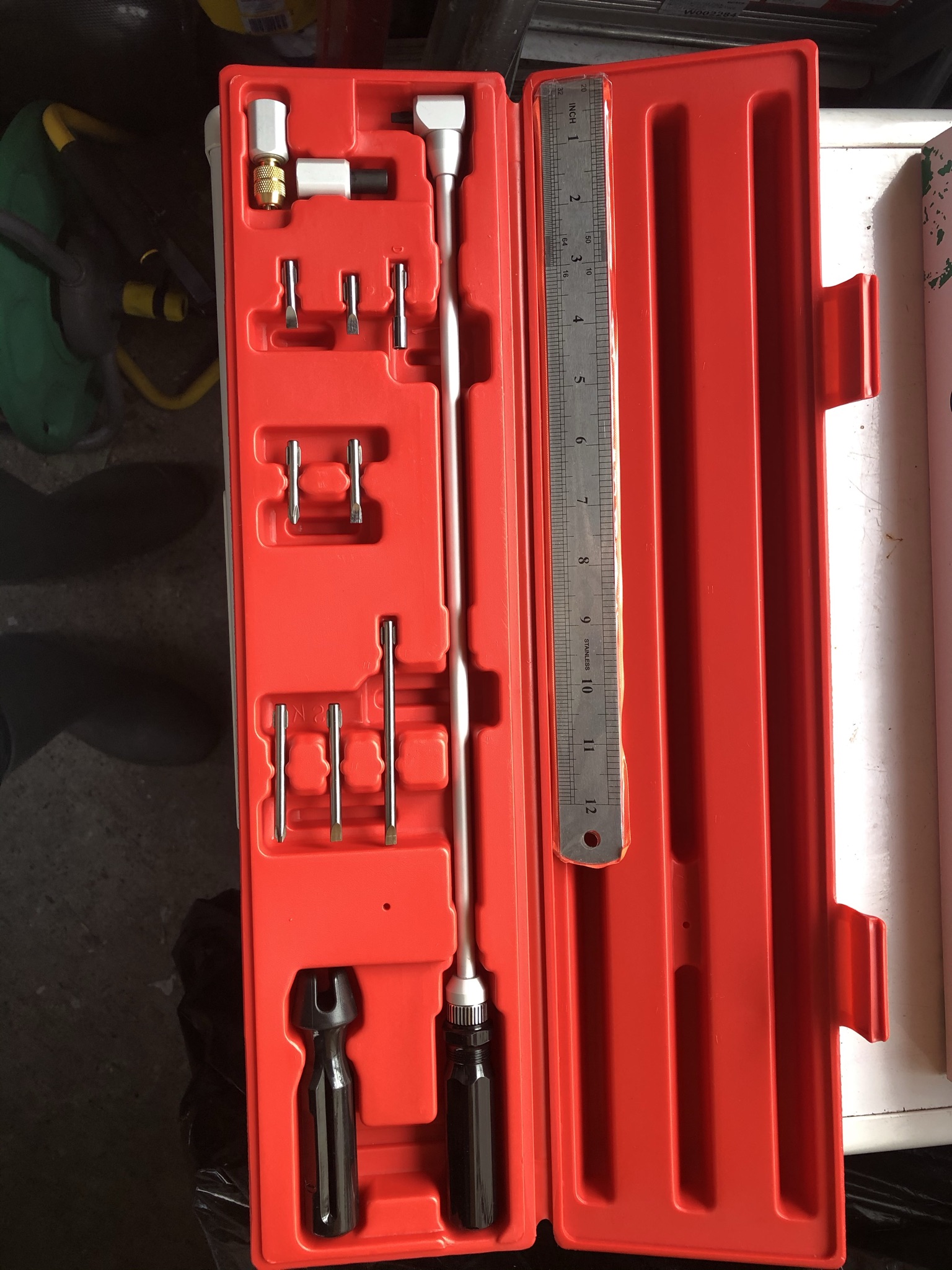

Can you show us your fancy screwdriver?

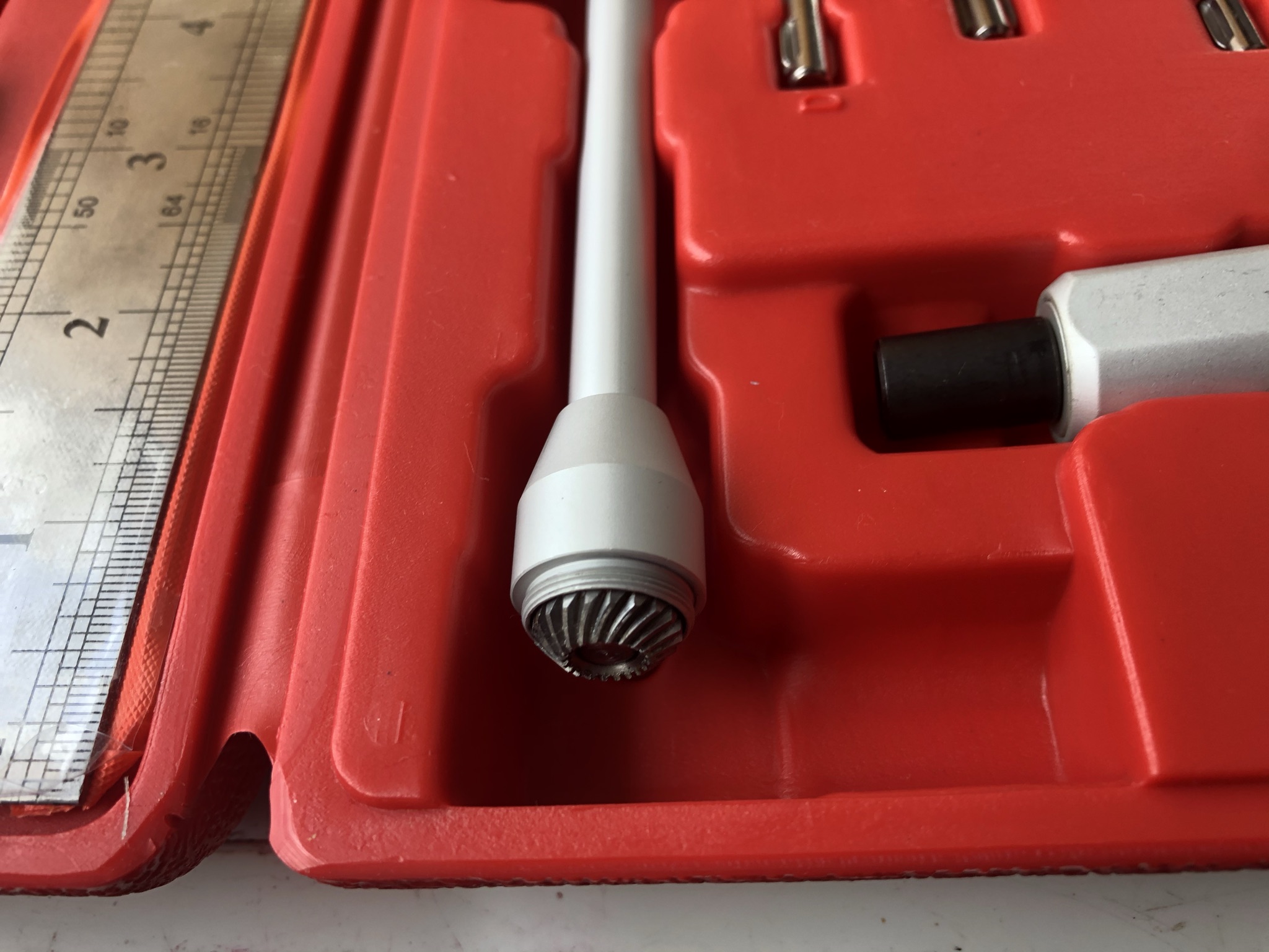

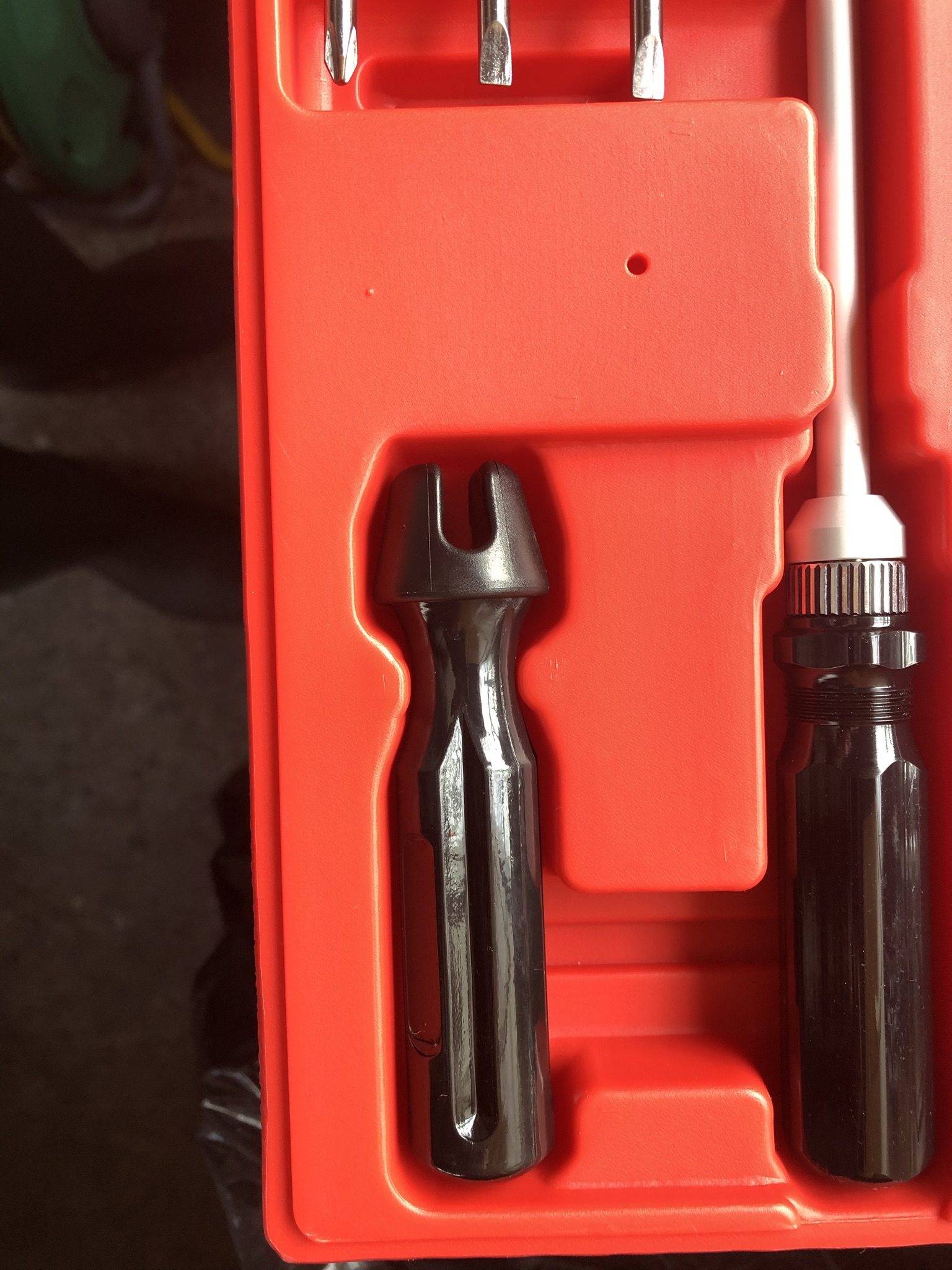

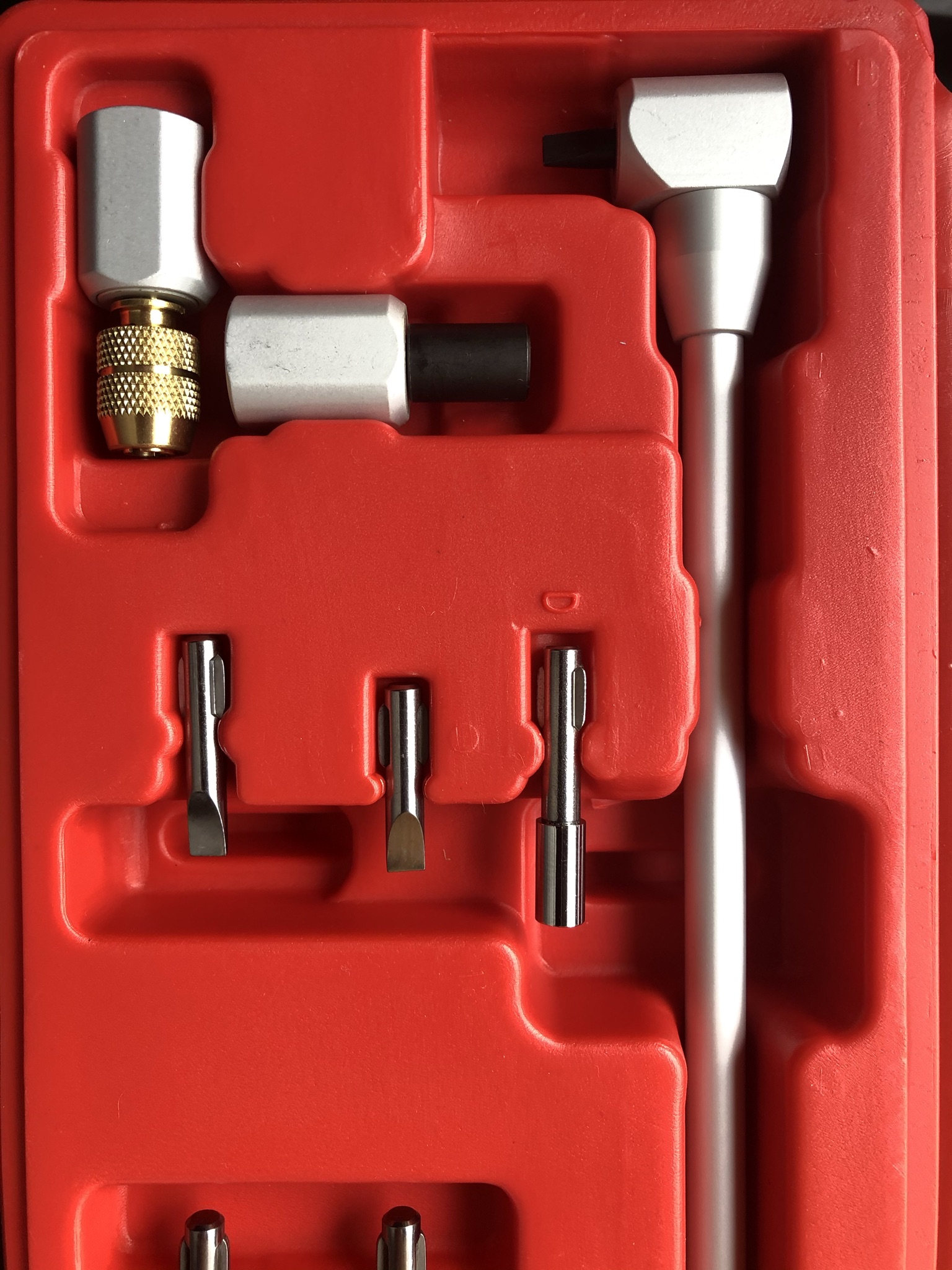

Most certainly :)
Overhead shot with a 12" steel rule for scale.  The head already fitted is a simple flat screwdriver.
Head for attaching all those other different screwdrivers shown

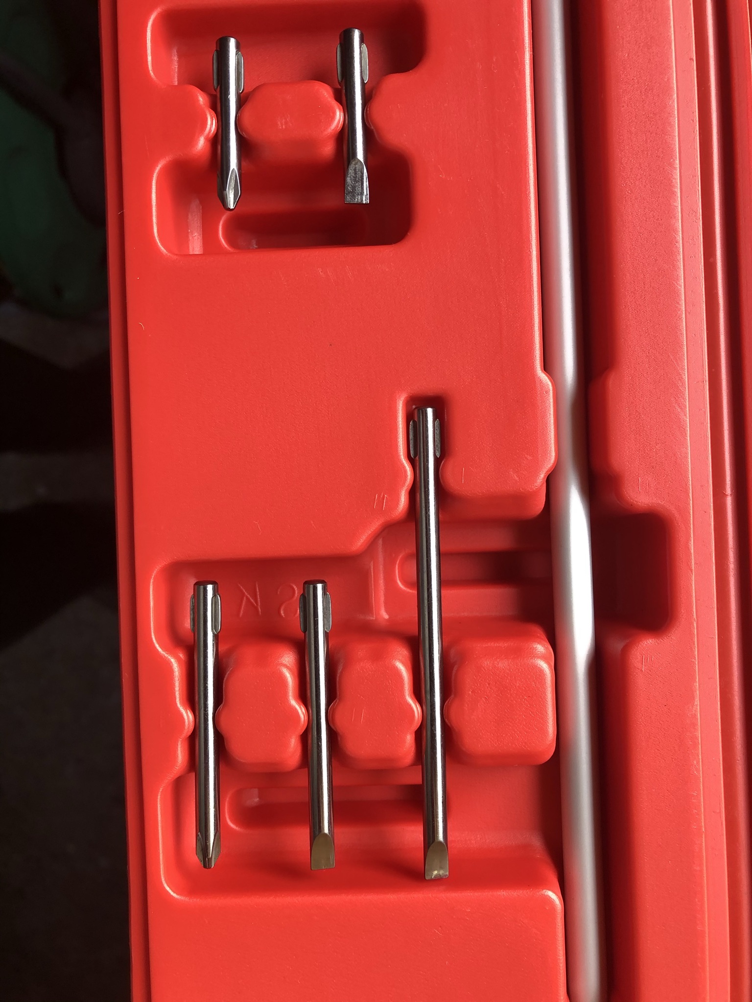

Closer shots of the set.  Head with the black piece was an optional extra that allows me to use standard hex bits.  The bit where the case has 'D' marked on it is the honda specific bit for adjusting 'D' type carburettor screws.

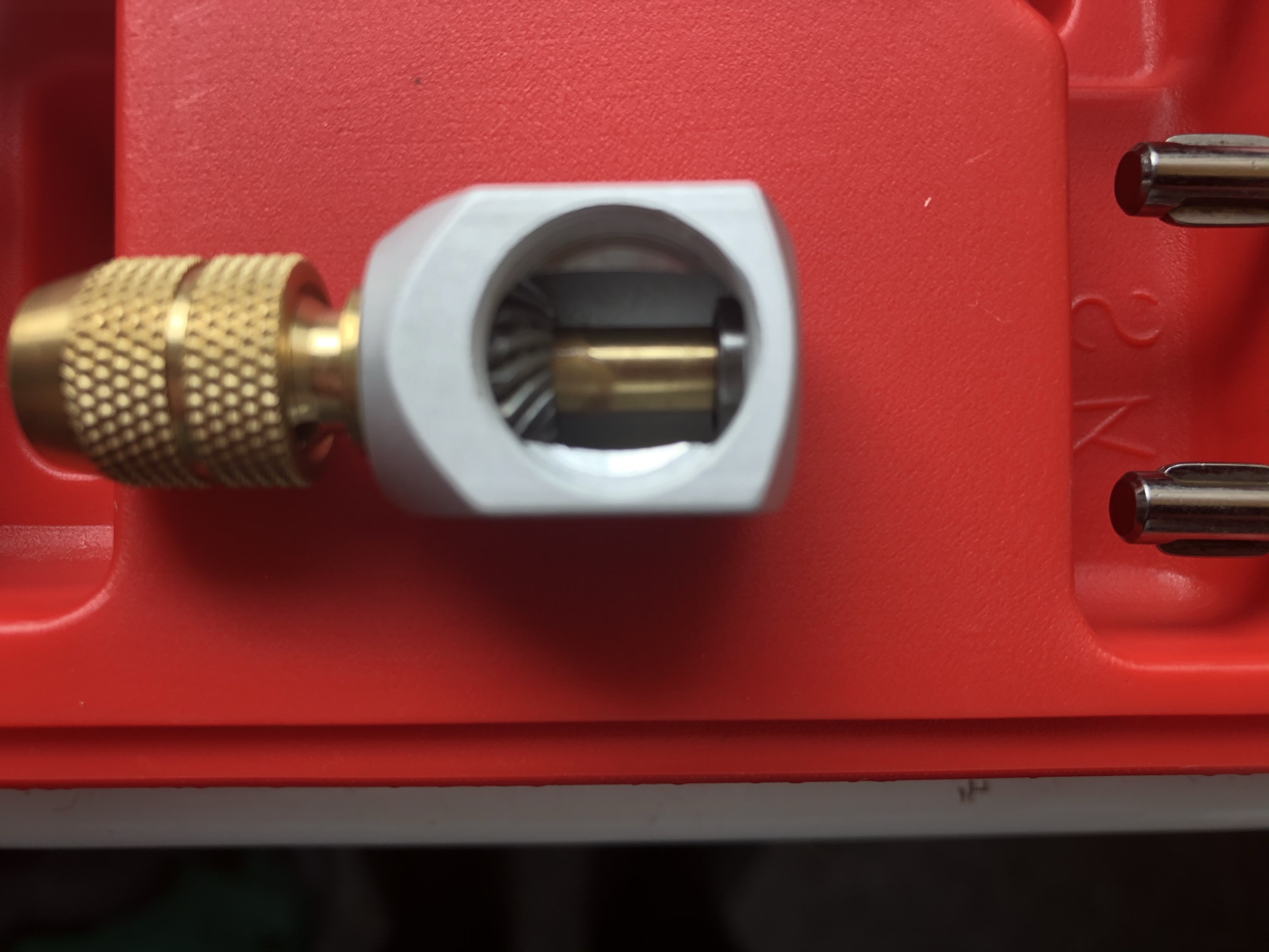

Finally the gear drive that goes into the heads

Where can a person get one of these from the other side-O-the pond?
Thanks Jabr.  Are the gears steel?  The reason I ask is the Pro Motion one I was looking at had aluminum gears and a lot of the reviews said the gears would strip very easy.  What is the brand name of yours?

I'll have to get the magnet out and check later.
Brand is Morgan, the people who make the CarbTune
The photo isn't good enough to say for sure, but it appears to be powdered metal.  Not as good as 'real' steel gears, but should be plenty good enough for this use.  Many power tools use powdered metal gears.  The connecting rods in my Excursion are powdered metal.  The stuff is quite durable, much more so than aluminum, just not as good as 'real' steel.

I emailed the company to be sure, this is what they sent me.  As soon as they come back with confirmation I'll post it.
Hello Jason
This is a product we bring in. We don’t manufacture it.
As far as I know gears are made from a hardened steel.
What I do know is we have been selling them for many years and never had one back with damaged gears. They do seem very tough.
I’ll ask the supplier and see what they say.
Best regards
Sean Morgan
Posted (edited)
Sean has got back to me and says the gears are made from:
SCM415(Chrome Molybdenum)
So essentially it is an alloy of steel.
Edited by JaBr
