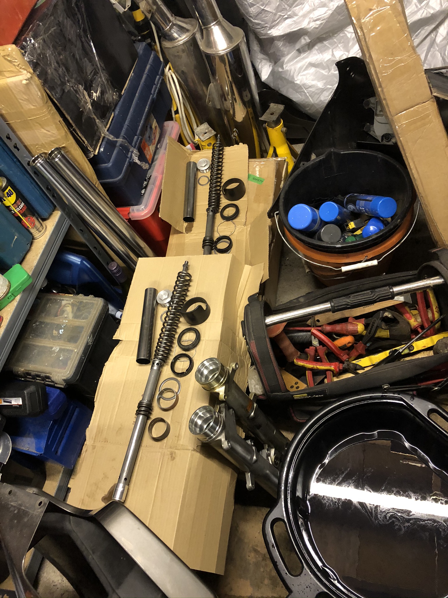

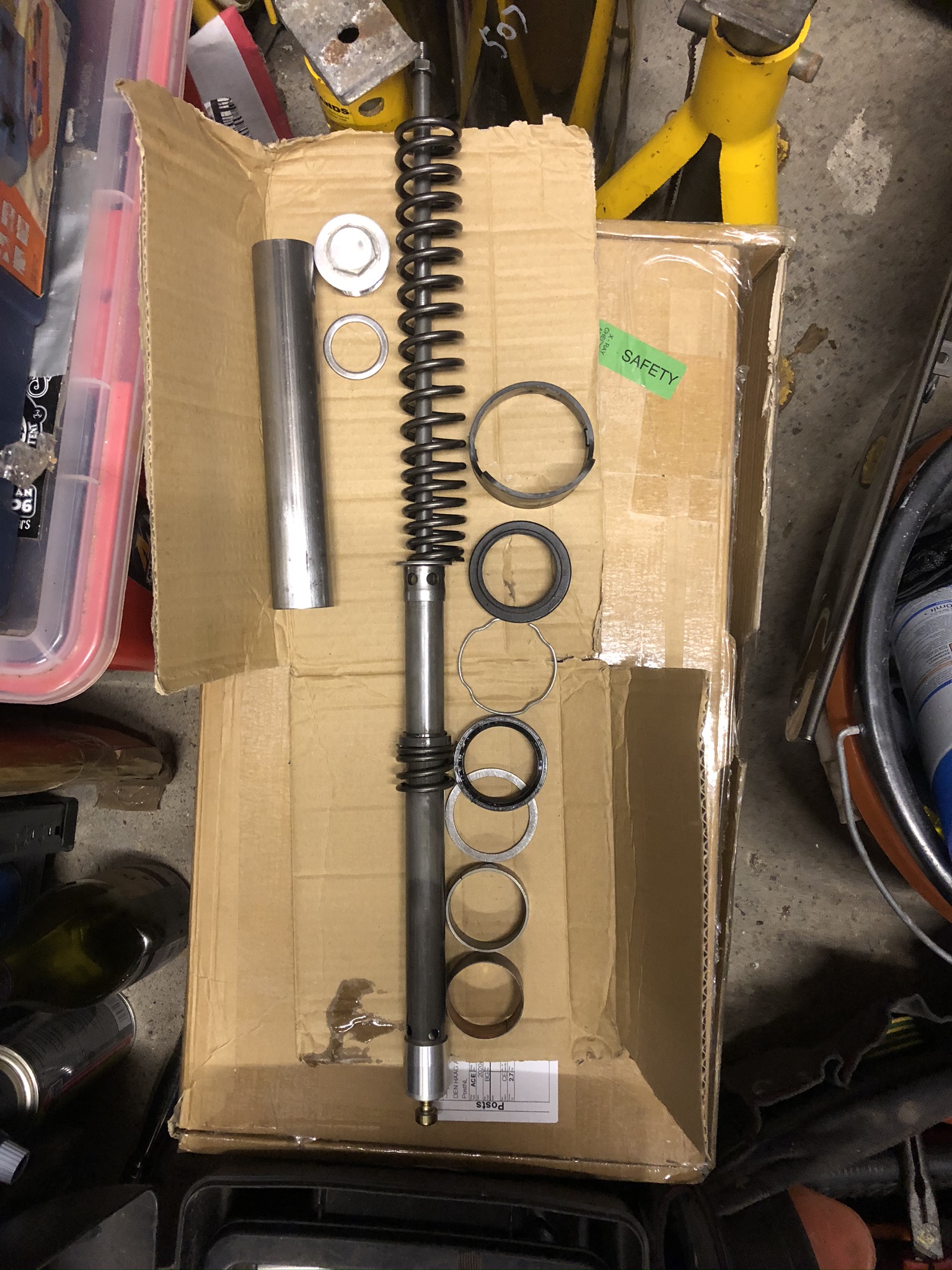

JaBr 66 Posted September 10, 2020 Author Share Posted September 10, 2020 So I finally did a bit more to the bird at the weekend. Having previously shown the state of the fork legs I bought some replacements, over the last few weeks I have looked at them every time I went into the garage and thought, nope, they'll be fine, not rebuilding them. I think this was a combination of laziness and fear of the unknown as I've never rebuilt forks before. Anyway, I decided to go for it, took about an hour working methodically and following the instructions in this video. Ironically, the thing I was most worried about was the cap coming off at 100mph and taking a chunk out of me, looking at the way the forks are constructed I don't think it's even possible with these forks. Once the cap is released from the stanchion it is still attached to the damping rod of the cartridge by a locked thread and therefore has a very limited amount of travel, all of which would be damped anyway. So anyway, a couple of pictures of the deconstructed forks. As you can see from the second photo, it's still pretty cramped in my garage. The tube to the left is the one that sits on the lower part of the cartridge. Very glad I decided to do this, the oil from the forks is decidedly murky, and one of the oil seals was just starting to weep. The new stacnhions are reasonably good but do have a couple of small stonechips in them. Quote Link to post Share on other sites

JaBr 66 Posted September 10, 2020 Author Share Posted September 10, 2020 1 hour ago, blackhawkxx said: So what parts did you replace in your rebuild? I'll be fitting new seals, bushings, and oil of course. No change to the springs, they seem fine as far as I can tell. I've been seriously considering the preload caps from Jaws but with all the money spent so far I can't really justify them at the moment. I do have a 6mm shim ready to go on the rear though, I understand that makes a big difference, one of the things I've found with the bird is that it's way less nimble than my '90 VFR, hopefully the shim improves things. I have the centre stand and wingrack going off for powder coating next week, I had a bunch of other parts powder coated a while back and want the bike to look tidy, a ratty centre stand next to a newly powder coated side stand just wasn't working for me. Quote Link to post Share on other sites
superhawk996 2,504 Posted September 10, 2020 Share Posted September 10, 2020 I've read that using a lighter than stock oil makes them better, but don't remember which was suggested. There might even be some instructions out there for tuning the valving. It would be worth checking into that stuff before putting them back together. Quote Link to post Share on other sites
tomek 577 Posted September 10, 2020 Share Posted September 10, 2020 It does not get really warm in your location so I'd strongly suggest lighter fork oil- 7wt. IIRC stock is 10wt. Not all suspension oils have been created equal. I use Maxima blue label or Ohlins products. Since you got everything out I'd disassemble and lap comp. and rebound valves. Flat piece of glass, start with 600 and finish with something finer. Make sure to use appropriate loctite where needed. Quote Link to post Share on other sites
The Krypt Keeper 2,021 Posted September 10, 2020 Share Posted September 10, 2020 The XX forks are seriously easy to pull down and work on. Do my own every couple years and like using 7.5 oil. Did find out that honda was cheap in the amount of oil they put in from factory. According to the manual and doing it by height I imagine honda shorted me an ounce or so in each fork. Quote Link to post Share on other sites
JaBr 66 Posted September 11, 2020 Author Share Posted September 11, 2020 18 hours ago, tomek said: It does not get really warm in your location so I'd strongly suggest lighter fork oil- 7wt. IIRC stock is 10wt. Not all suspension oils have been created equal. I use Maxima blue label or Ohlins products. I've already bought the Motul 10w but having done some more research I think 7/7.5 looks like a better plan for me. About 175lb in weight and like you say our climate is generally cooler. Quote Link to post Share on other sites
superhawk996 2,504 Posted September 11, 2020 Share Posted September 11, 2020 And note that while the number on the bottle 'should' be the end of the story, each brand will have it's own viscosity so it's not as straight forward as one would think. Quote Link to post Share on other sites

redxxrdr 521 Posted September 12, 2020 Share Posted September 12, 2020 (edited) You already have the forks down. Unless you are a lightweight, I would look at springs ( 1 kg) and emulators. I put the Penske cartridge in mine years ago, on a group buy. I ran 240 lbs full gear at that time. A friend, same size, rides a k1200rs. I would bottom out hard on the little bridge on 180 between Suches and Hwy 129. Not at all on the RS. Penske cartridge and correct springs make a real difference. The rear shim helps the bike turn in. Doing the front end is worth it. Cogent Dynamics did the group buy. They also supplied springs, emulators, and oil suggestions for my SV650. Another undersprung bike. Cogent Edited September 12, 2020 by redxxrdr 1 Quote Link to post Share on other sites

JaBr 66 Posted September 14, 2020 Author Share Posted September 14, 2020 On 9/12/2020 at 7:17 AM, redxxrdr said: You already have the forks down. Unless you are a lightweight, I would look at springs ( 1 kg) and emulators. I put the Penske cartridge in mine years ago, on a group buy. I ran 240 lbs full gear at that time. A friend, same size, rides a k1200rs. I would bottom out hard on the little bridge on 180 between Suches and Hwy 129. Not at all on the RS. Penske cartridge and correct springs make a real difference. The rear shim helps the bike turn in. Doing the front end is worth it. Cogent Dynamics did the group buy. They also supplied springs, emulators, and oil suggestions for my SV650. Another undersprung bike. Cogent I'm currently around 175lbs, usually around 140-145lbs dripping wet and naked, working from home plays havoc with my eating habits hence the increase. I'm not sure whether that qualifies as lightweight or not I also regularly take a pillion who ranges from 110-140lbs, she'd kill me if she knew I was sharing this 😳. On top of that we will occasionally be touring with three cases on a wingrack, when all this Covid nonsense is sorted we'll be heading for Provence to experience the lavender fields. At the moment though my finances are unlikely to go much further than a set of springs, I have already put well over £1500 into refurbishing the blackbird and that doesn't include bodywork which is going to need repairing, respraying, and new decals. I expect I'll be doing the front again in a year or two anyway as 5k is my fork oil change interval. Have to say, the andreani kit looks nice, but 548 euros isn't cheap. Quote Link to post Share on other sites
