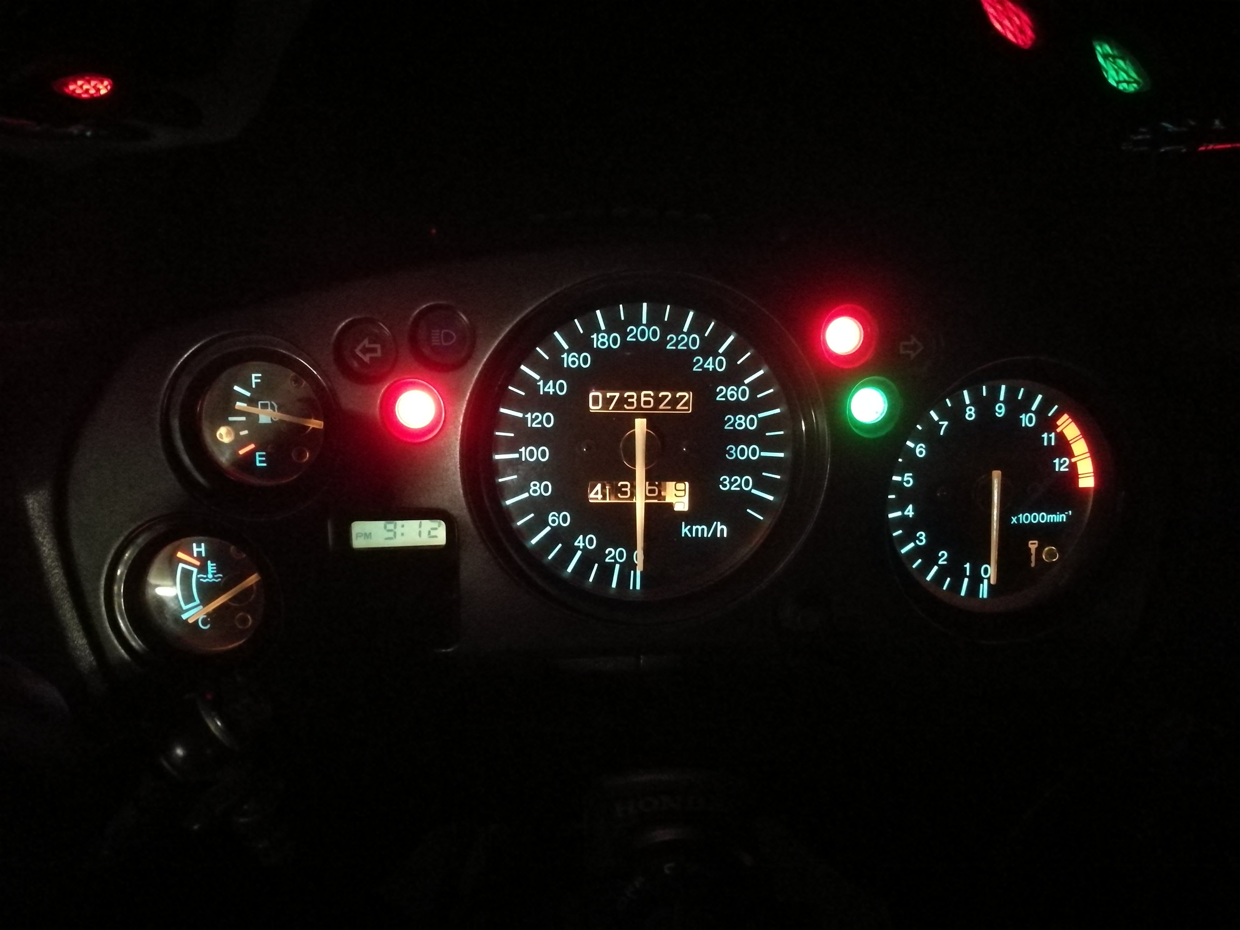

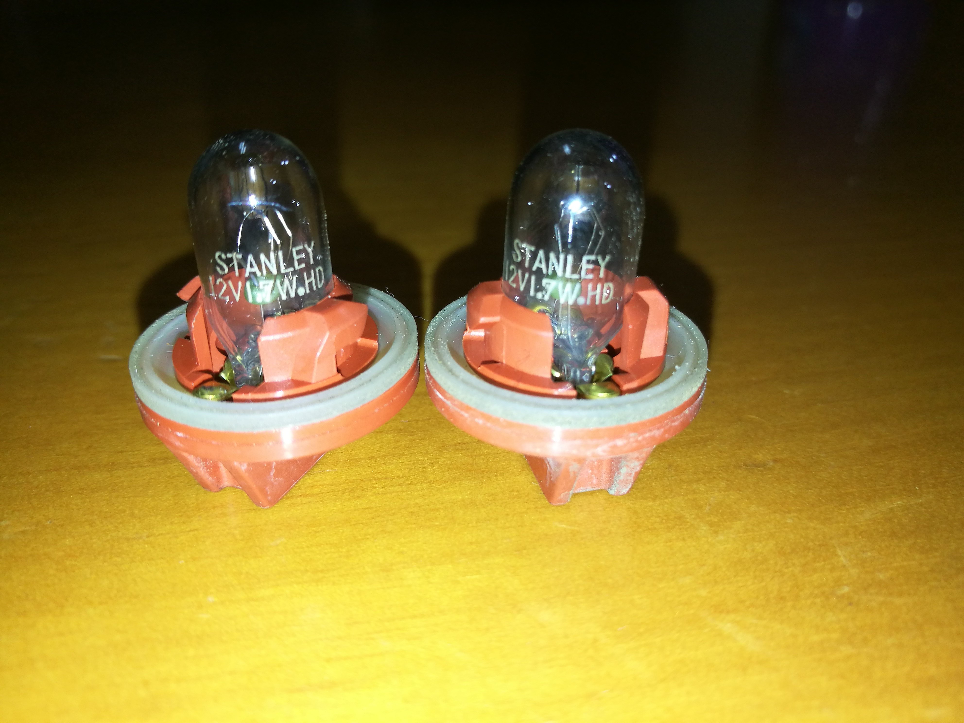

Hondero Posted May 19, 2020 Share Posted May 19, 2020 (edited) Hello, to change the bulbs I only had to remove the dome, the side panels and of the four screws that hold the odometer I removed only the top two, with this you can push the odometer forward one inch and with that to spare to access the bulbs . I changed the big six but I did not put led, I put the same but more watts, the ones I had were 1.7 watts and I have put them 5 watts. So it looks pretty good Just removing the top two screws gives you good access, removing the bottom screws takes more time and really doesn't need to. I think these are still the original ones, 20 years old !! These are the ones that I have put now. This is how my odometer looks now. I am afraid to put them on LEDs because they heat up more and will surely have a shorter duration, although if the good quality purchases are possible that they heat up a little and last a long time, keep in mind that the odometer is always on (here in my country it is mandatory to carry always the light on, so I did not put them on led). Edited May 19, 2020 by Hondero 1 Quote Link to comment Share on other sites More sharing options...

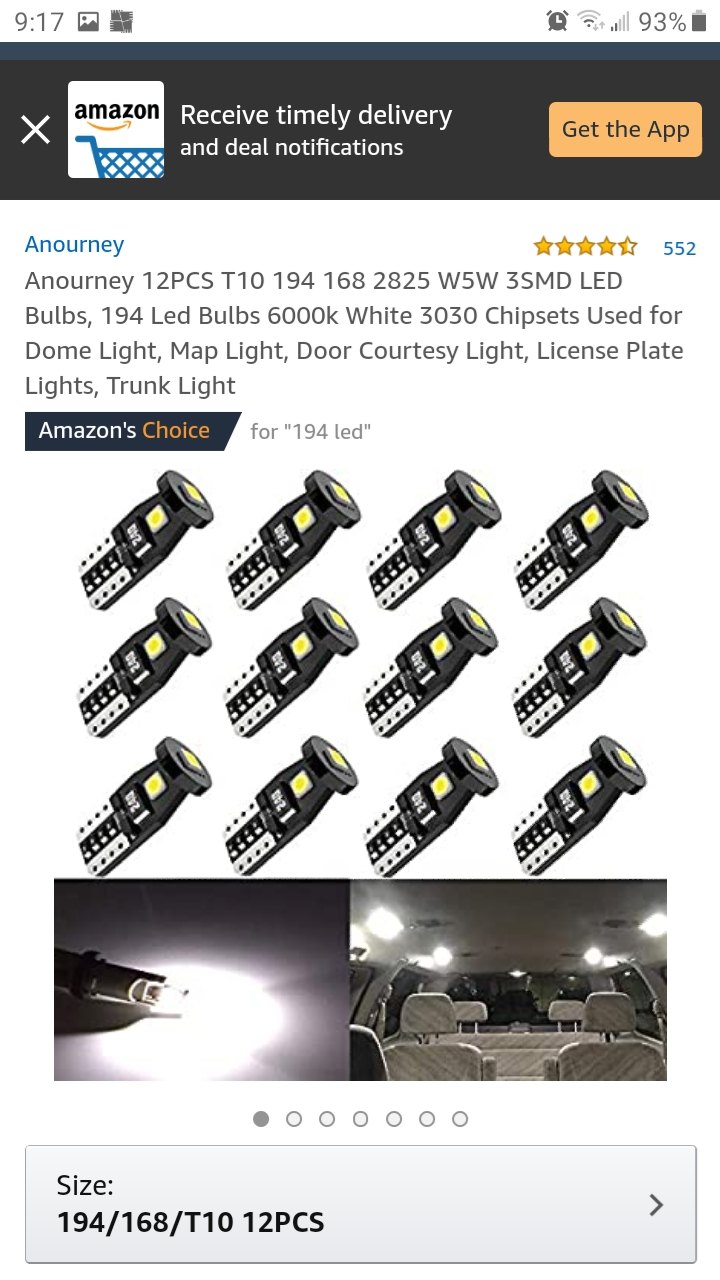

XXitanium Posted May 21, 2020 Author Share Posted May 21, 2020 https://www.amazon.com/Bright-Chipset-Interior-Courtesy-License/dp/B07DB7W78P/ref=mp_s_a_1_13?dchild=1&keywords=w5w+led+bulb&qid=1590037881&sr=8-13 Quote Link to comment Share on other sites More sharing options...
superhawk996 Posted May 21, 2020 Share Posted May 21, 2020 8 hours ago, XXitanium said: I looked it up. There are some people applying heat sinks to LED 5W bulbs! A 5W LED is gonna make a shit ton more light than 5W incandescent so it's an extremely unfair comparison. Most of my house lights are 6W LED, and they run cooler than the 40 and 60W bulbs they replaced. An LED instrument light is probably less than .5W. 1 Quote Link to comment Share on other sites More sharing options...
XXitanium Posted May 21, 2020 Author Share Posted May 21, 2020 6 minutes ago, superhawk996 said: A 5W LED is gonna make a shit ton more light than 5W incandescent so it's an extremely unfair comparison. Most of my house lights are 6W LED, and they run cooler than the 40 and 60W bulbs they replaced. An LED instrument light is probably less than .5W. ...agreed. most of mine at home are LED as well. They stand up to shock better too. I don't want to melt any of my kid's dash plastic....though it sounds like real-world experience *here* has proved it's not an issue. I was just rambling on about the heat sinks. I've done industrial installations where the heat sink was about 25lbs of aluminum. Quote Link to comment Share on other sites More sharing options...
superhawk996 Posted May 21, 2020 Share Posted May 21, 2020 8 hours ago, XXitanium said: https://www.amazon.com/Bright-Chipset-Interior-Courtesy-License/dp/B07DB7W78P/ref=mp_s_a_1_13?dchild=1&keywords=w5w+led+bulb&qid=1590037881&sr=8-13 I saw a video of someone testing one of those lights with a power supply and it pulled around .15W at around 14v. He was holding it for several seconds before dropping it saying that it was hot. A 194 incandescent gets too hot to hold even at battery voltage. Quote Link to comment Share on other sites More sharing options...

superhawk996 Posted May 21, 2020 Share Posted May 21, 2020 I have no idea what the W5W is, but no fucking way they're 5W, that's about half of LED headlight power. The test some guy did indicates they're .015sh watts which seems about right. From memory, the ceiling lights in my old motorhome were 8W incandescent and the LEDs were around .8W for about the same mount of light, the LEDs mighta been a little less light, super cheepos before good and cheap LEDs were so plentiful. Quote Link to comment Share on other sites More sharing options...
