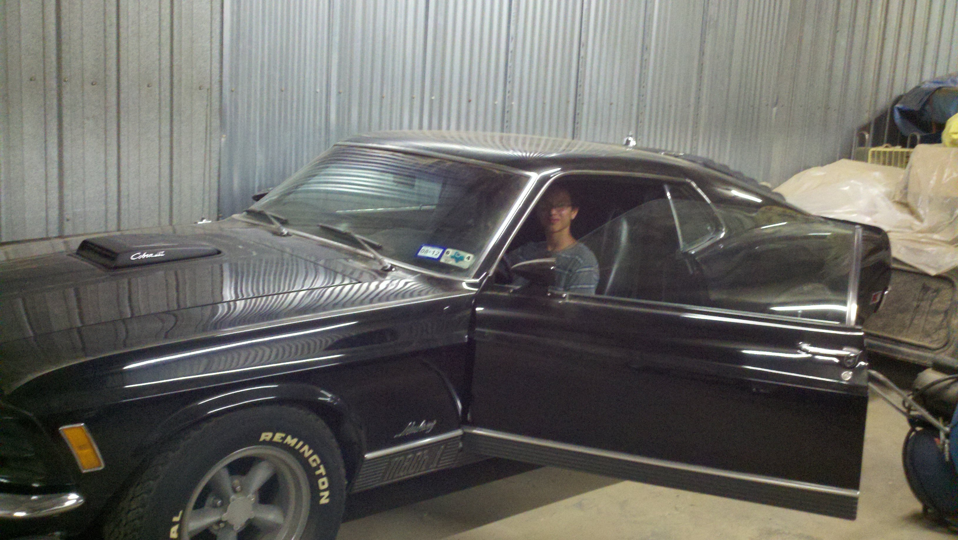

FiXXation Posted May 10, 2020 Posted May 10, 2020 Six years ago when my grandson, who lives with us, started seriously thinking about real cars instead of video games. We pulled the covers off so he could see what old iron looked and felt like. We put some air in the circa 1982 model tires. That was probably the last time it was completely uncovered. It is 50 years old now. 2 Quote
XXBirdSlapper Posted May 11, 2020 Posted May 11, 2020 20 hours ago, FiXXation said: Six years ago when my grandson, who lives with us, started seriously thinking about real cars instead of video games. We pulled the covers off so he could see what old iron looked and felt like. We put some air in the circa 1982 model tires. That was probably the last time it was completely uncovered. It is 50 years old now. Wow......just wow. Quote
