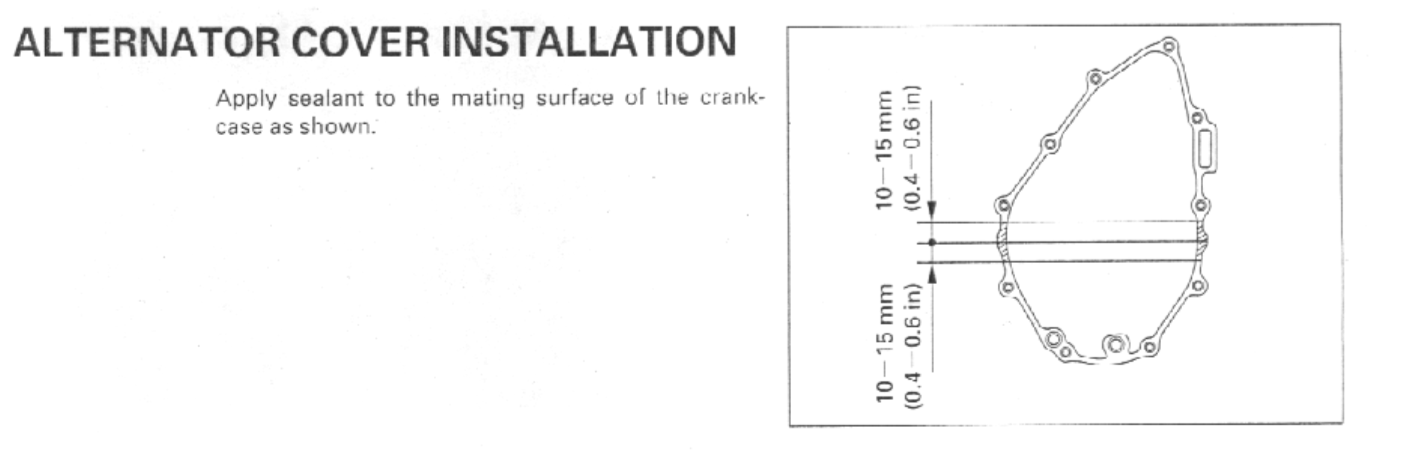

SierraKLR Posted March 11, 2020 Posted March 11, 2020 Dumb question. In the manual it states to put sealant on the crankcase face prior to the gasket in the "area shown". It looks like that is the two little areas on the right and left per this diagram. Is that correct ?? Not the entire surface ? Quote
superhawk996 Posted March 11, 2020 Posted March 11, 2020 1 hour ago, SierraKLR said: It looks like that is the two little areas on the right and left per this diagram. Yup. The reason is to seal the parting line between the case halves, any gap or variation in height between the two could let it leak past the gasket. A little dab on each line is sufficient, no reason to go crazy with it. My favorite is Permatex Right Stuff, but any sealant designed for engine oil contact parts should be perfectly fine. If the old sealant didn't peel off you probably don't actually need any, but better safe than sorry. Quote
jon haney Posted March 11, 2020 Posted March 11, 2020 Use Honda Bond, or something similar from any of the bike manufacturers. Quote
