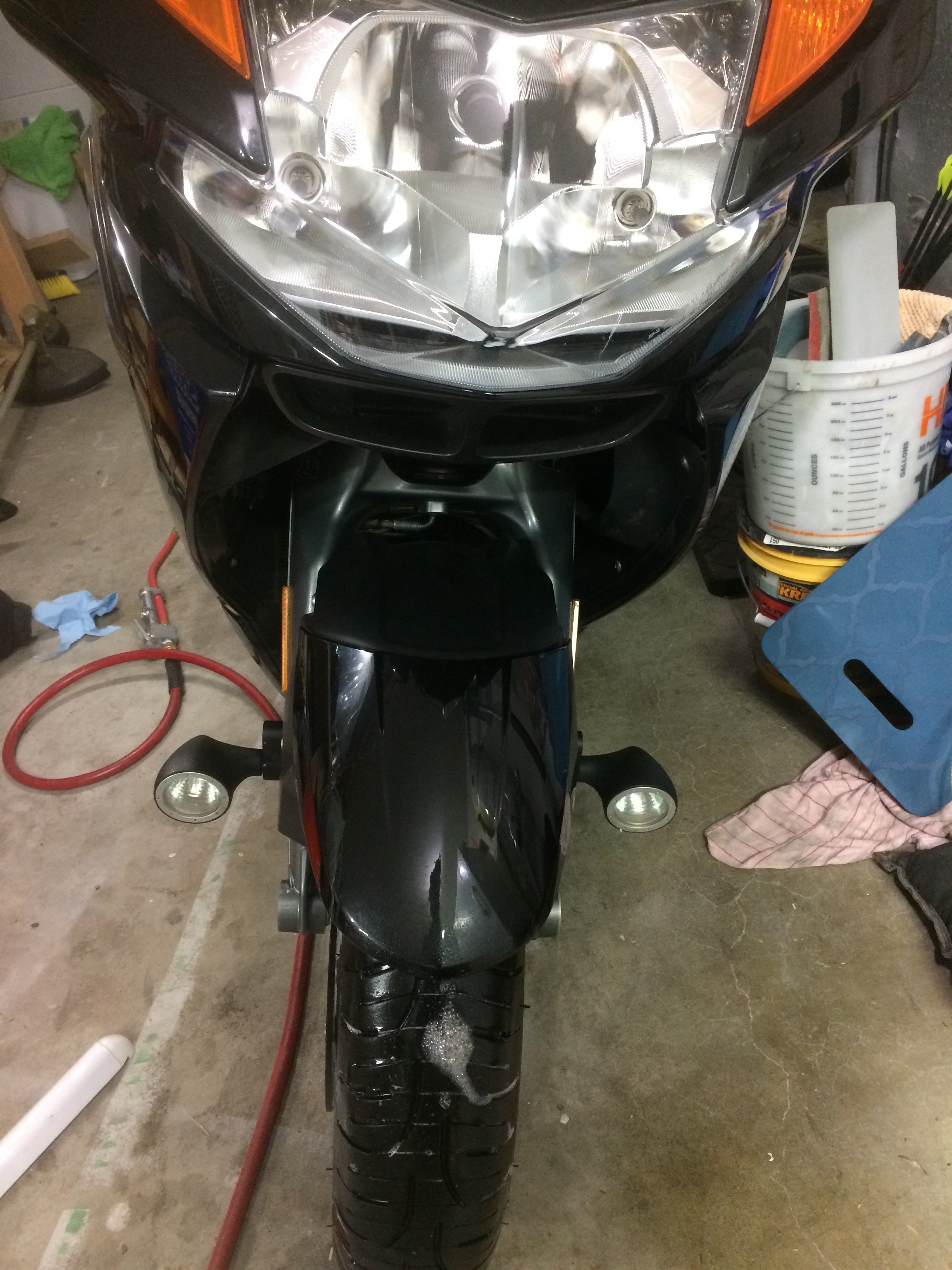

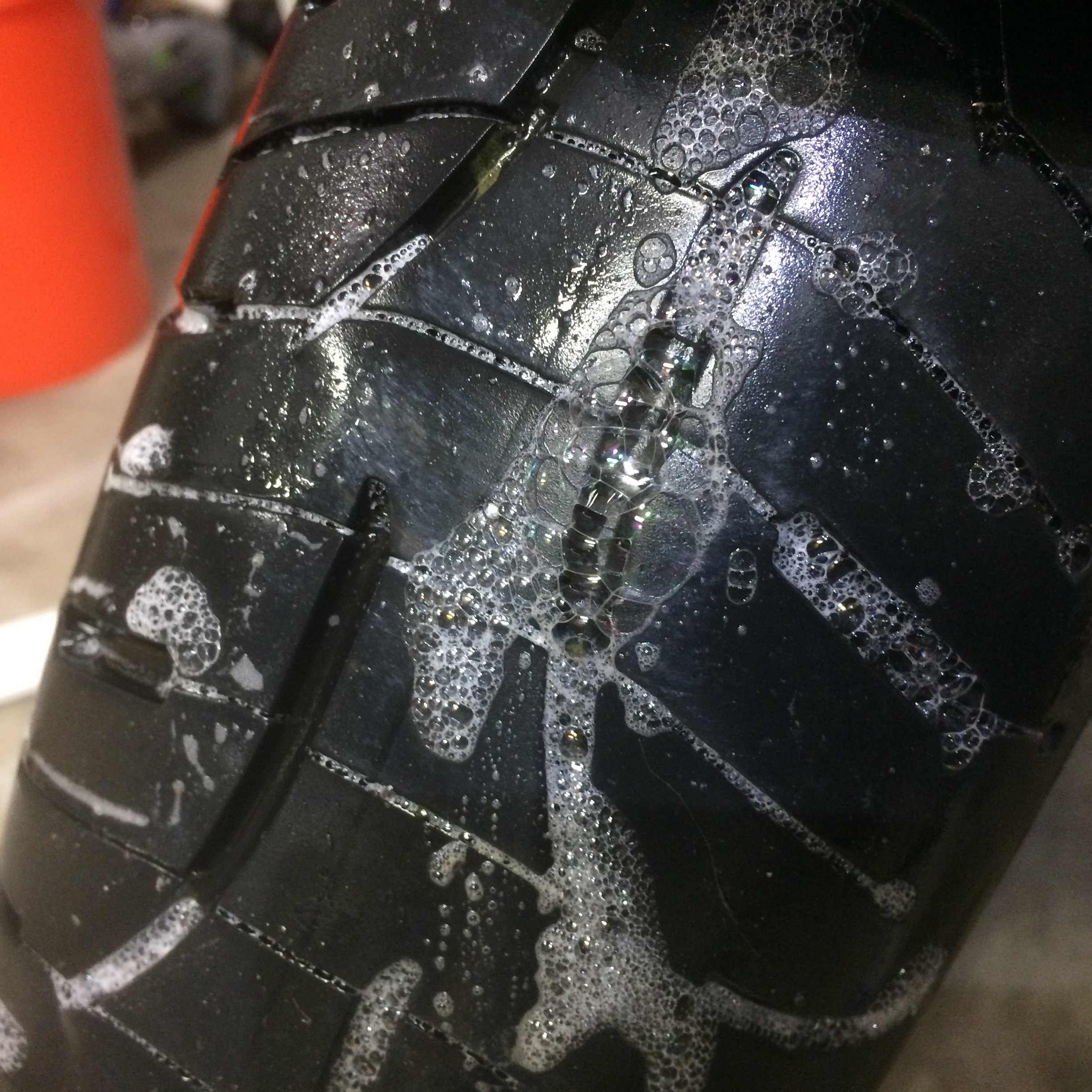

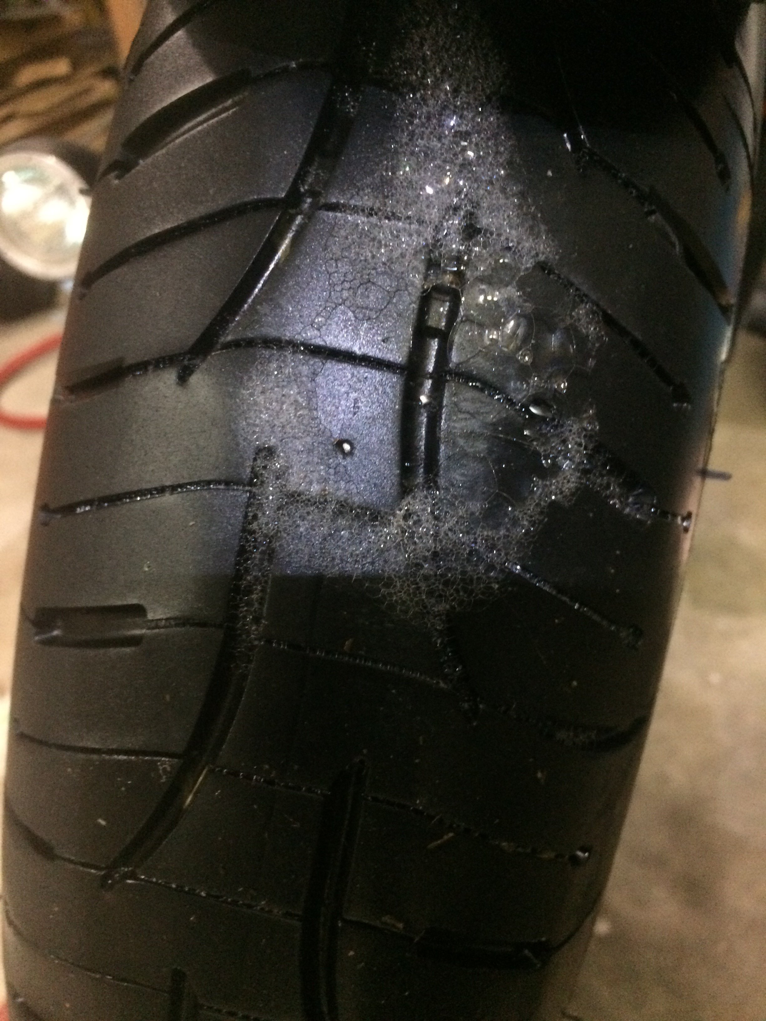

nomadicdread Posted February 5, 2020 Posted February 5, 2020 Got to inspecting the new BMW some more tonight and determined that the front tire is leaking from a puncture. I’m looking into my options among friends to patch and plug it myself. However, I’ve never ridden on a patched/plugged motorcycle tire. Would you? you can see that the puncture is in the tread. Additionally, it was like this at the dealership and they didn’t catch it even after I inquired about the low tire pressure from 1,300 miles away. Quote

nomadicdread Posted February 5, 2020 Author Posted February 5, 2020 I’ve got friends with tire machines and or the tools to dismount the wheel and tire who have offered the help or loan the hand tools. I sent the selling dealer an email last night expressing my displeasure. So I’m hoping they are going to pony up for a fix or replacement. Quote

superhawk996 Posted February 6, 2020 Posted February 6, 2020 So many said "plug it and ride" that I didn't really want to be the only one, but I wouldn't do it other than an emergency fix. A patch for a tiny leak like you have, sure, because there's probably no real damage done to the structure of the tire so it should be fine. Plugging that tiny leak will require enlarging the hole, ripping out cords creating a weak spot and deformation, and I wouldn't feel comfortable with it. Quote
tomek Posted February 6, 2020 Posted February 6, 2020 No, you dont have to enlarge anything for "tiny leak". I've fixed many, many small and medium leaks with something like that. OP has tiny leak. If it looks like it would need a plug from inside I replace tire. https://m.autozone.com/tire-repair-and-tire-wheel/tire-plugger-kit/slime-t-handle-tire-plugger-kit/486791_0_0?spps.s=6529&cmpid=LIA:US:EN:AD:NL:1000000:TRW:71700000060668488&gclsrc=aw.ds&&gclid=CjwKCAiAj-_xBRBjEiwAmRbqYrrFCacZ6R6JJ0JO8BHjWoShcmiB6OkYrihInobKgl21li_uOI6xuBoCdBgQAvD_BwE Quote
