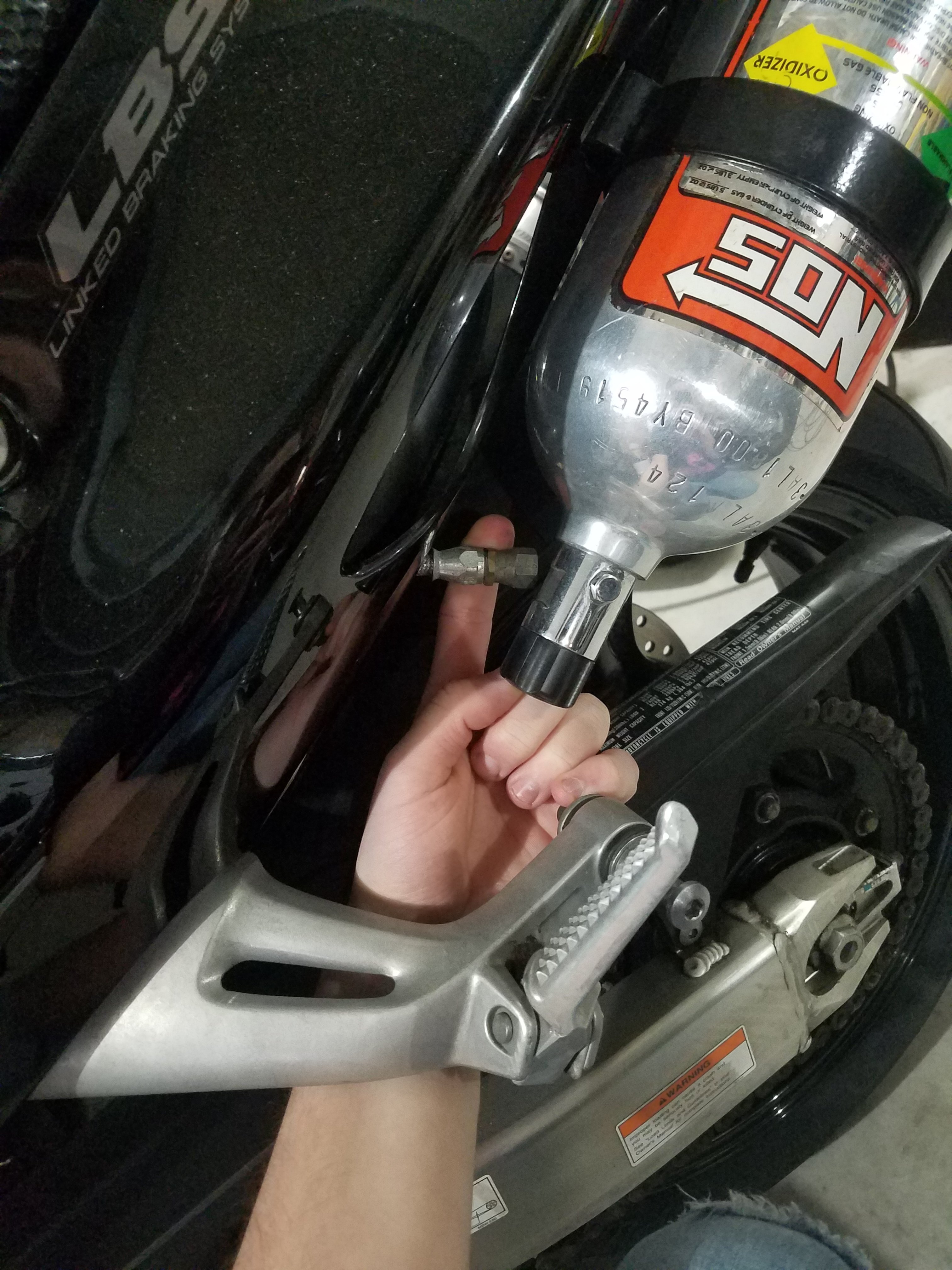

superhawk996 Posted November 9, 2019 Posted November 9, 2019 Is the NOS just for looks or functional? Can't see the hose. If functional, what's the set-up? Wet or dry, how much HP, ... ? Quote
Crashedbirb Posted November 9, 2019 Author Posted November 9, 2019 Just now, superhawk996 said: Is the NOS just for looks or functional? Can't see the hose. If functional, what's the set-up? Wet or dry, how much HP, ... ? Oh it's entirely functional, the hookups are hidden and it's on the left side of the bike, theres an arm switch on the left side fairing and once you arm it, it activates as soon as you WOT it. You feel a little kick and suddenly takes off. It's a wet NOS set up and it's a 30 shot. Just took this photo to show! Quote
superhawk996 Posted November 9, 2019 Posted November 9, 2019 Hadn't noticed there's a bottle on each side. Those would look great on my Bird! Did you make the mounting brackets for the bottles? Quote
Crashedbirb Posted November 9, 2019 Author Posted November 9, 2019 Just now, superhawk996 said: Hadn't noticed there's a bottle on each side. Those would look great on my Bird! Did you make the mounting brackets for the bottles? Last owner brought it to a shop who did everything, I plan on replacing all the fairings to repsol black/white fairings so when I do, I'll take photos to show how it was done! Basically they drilled a hole through part of the frame on both sides and the mounting brackets have a bolt that goes through that hole with a locking nut. Whenever I feel like it, I could take them off but come on, why would I, it looks so good on the blackbird Quote
Furbird Posted November 9, 2019 Posted November 9, 2019 I'm guessing (hoping, praying) that somebody took the pick-up tubes out of those bottles before filling them. When inverted like that they need to have the tubes removed if you didn't know. The stock engine can handle at least 2.5 times that amount of nitrous, but good luck keeping the nose down. Quote
Crashedbirb Posted November 9, 2019 Author Posted November 9, 2019 2 minutes ago, Furbird said: I'm guessing (hoping, praying) that somebody took the pick-up tubes out of those bottles before filling them. When inverted like that they need to have the tubes removed if you didn't know. The stock engine can handle at least 2.5 times that amount of nitrous, but good luck keeping the nose down. Yes they did! Theres no problems with them luckily, 30 shot is plenty though, its stupidly powerful without it and with it is just overkill 1 Quote
