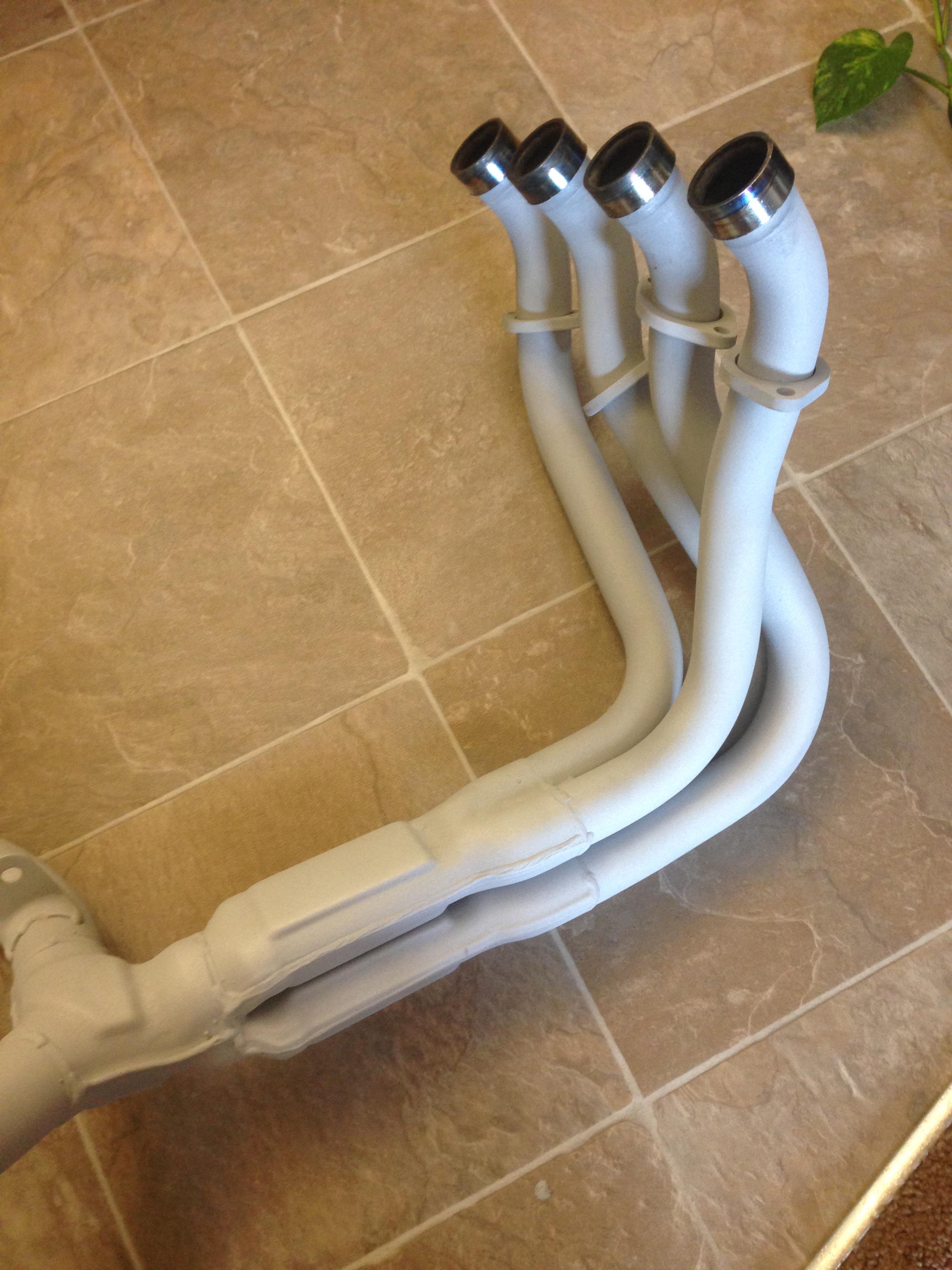

silverbird1100 Posted September 13, 2019 Posted September 13, 2019 I was all excited to brag about how much cooler my bike runs but the difference seems negligible. Cost me $400 including shipping and my bike was down for a month. What sold me was the .015" thickness, much thicker than typical costings. Guess it really is all about radiator flow, but at least now I know for sure. And yes I did paint them black. Quote

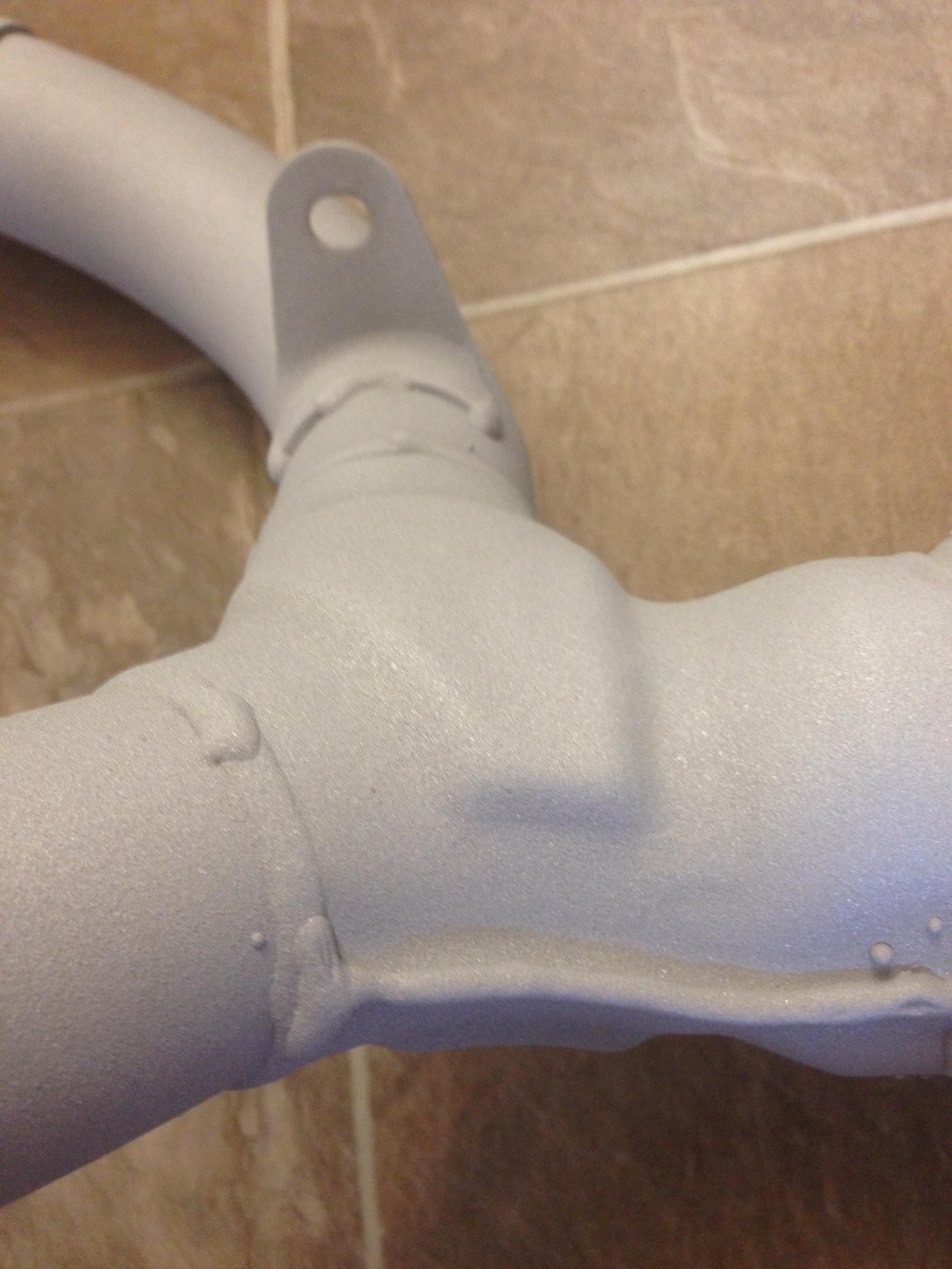

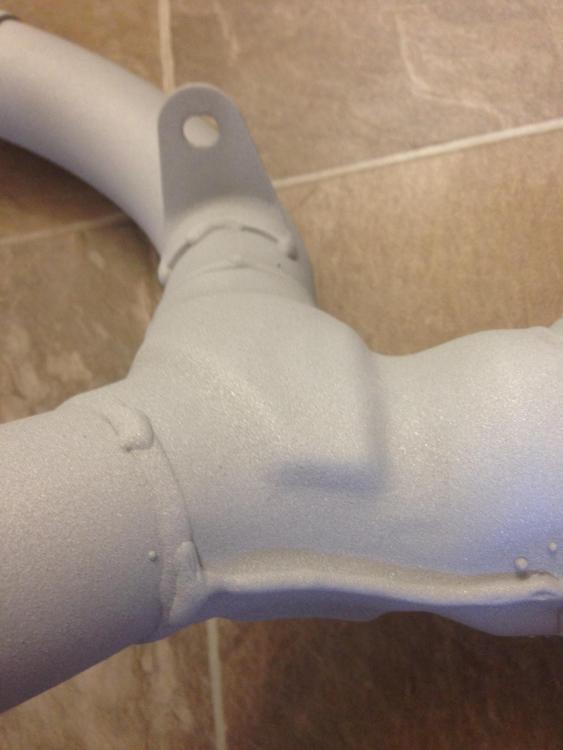

SwampNut Posted September 13, 2019 Posted September 13, 2019 Your catalytic converter is cupped. Quote
silverbird1100 Posted September 13, 2019 Author Posted September 13, 2019 Far as I know cats are only in exhaust pipes with expanded sections after it meets the mainfold. Quote
SwampNut Posted September 13, 2019 Posted September 13, 2019 7 minutes ago, silverbird1100 said: Far as I know cats are only in exhaust pipes with expanded sections after it meets the mainfold. They are. I can detect their cuppage from this view. You can't? Fucking amateur. 1 Quote
silverbird1100 Posted September 13, 2019 Author Posted September 13, 2019 I changed tires and went for a ride. Fan doesn't even come on now. 1 Quote
blackhawkxx Posted September 14, 2019 Posted September 14, 2019 10 hours ago, silverbird1100 said: I was all excited to brag about how much cooler my bike runs but the difference seems negligible. It should make you a little less hot in the heat of the summer but it would be hard to measure. As far as water temp...... I think Swamp has a coated header. Quote
silverbird1100 Posted September 14, 2019 Author Posted September 14, 2019 (edited) I probably jumped the gun, it might be slightly cooler. I was expecting more though. It made a big difference on my ZX14R for some reason but that was on a full Yosh, which was gretting rid of a lot more air. Edited September 14, 2019 by silverbird1100 Quote
superhawk996 Posted September 15, 2019 Posted September 15, 2019 The Bird that Carlos now owns has a JetHot coated header in the pretty shiny color, looks kinda like aluminum. At idle the header tube temp dropped from 400ish to 300ish with an infrared thermometer, but colors effect the readings on those things so I'm not sure if that's an accurate number. And it's real purdy. I considered swapping it back to the stocker before delivering the bike, but brotherly love & all...in the Az hell heat every bit helps. 300* is still a lot of heat, but that was sitting still with no wind. With a little bit of air flow I expect the difference with the coating would be even higher. I didn't do a whole lot of slow traffic riding after the swap and didn't really take note of felt heat before/after, but later realized that I no longer felt a noticeable furnace blast coming off of it like I used to. Do not expect a drop in engine temp, that's almost entirely controlled by the thermostat/cooling system. You'll probably get less fan running since the header isn't cooking the radiator as much and you should have less felt heat coming up around the fairings. If you have a thermometer and can get a temp reading it would be interesting to see your numbers. Quote

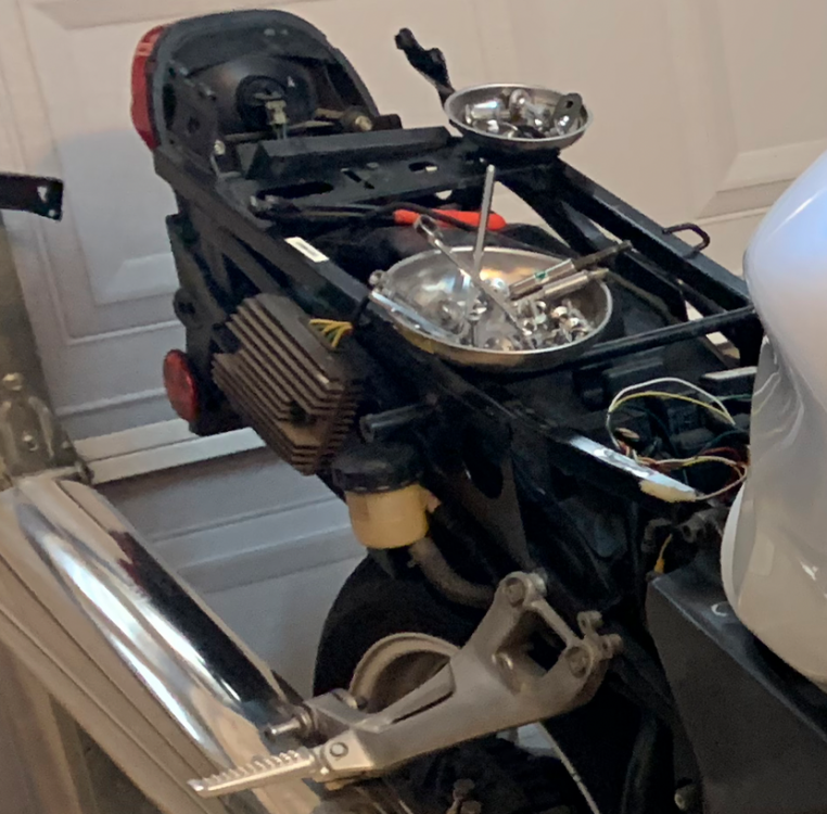

SwampNut Posted September 19, 2019 Posted September 19, 2019 I think the problem is that the fins just aren't big enough. The later models are huge. Here's mine... I should note that in 70k miles of AZ riding, I had one R/R fail, and one stator. Quote

OMG Posted September 19, 2019 Posted September 19, 2019 4 hours ago, SwampNut said: I think the problem is that the fins just aren't big enough. The later models are huge. Here's mine. Yup, mine has smaller fins, and its on the other side. I have a larger fan, no switch, it's always on. Similar mounting as the photo. No photo, sorry. Quote
