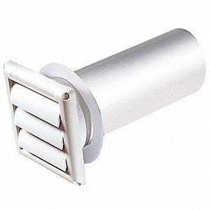

Ongoing issue with condensation on bathroom AC vents.  These vents are next to ceiling mounted haters/exhaust vents.  They use tubes drawing/dischargeing from/to the attic.  Is there something that could go on the end to close them off when air is not actively being drawn in to blown out to prevent humid air from working its way in?

I’m pretty sure the issue is humid air getting in via the ceiling vent in the bathrooms.  Hence why I’m wondering if someone makes a thing that blocks air flow when it’s not running to keep outside air from coming in.  I suppose I have to get up in the attic and have someone work the vent then the heat to see if the vent hose flows both ways.
Do you mean like a dryer or rangehood vent? They have "flappers" to prevent air (and mice and bugs) from getting back in when the blower isn't running. Also, did I read correctly that your bathroom fan vents into the attic? That's not right and they should be at least vented to the eaves but ideally outside. Maybe I'm missing the problem here but I read through the posts twice.
