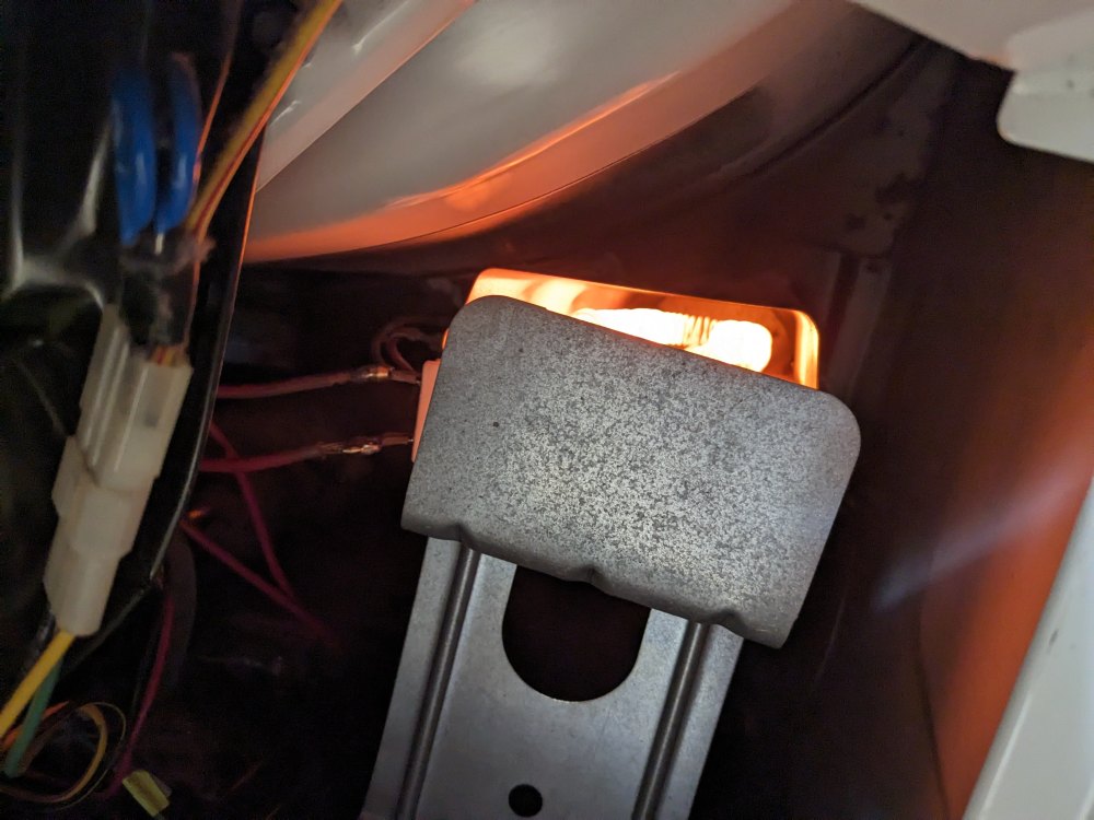

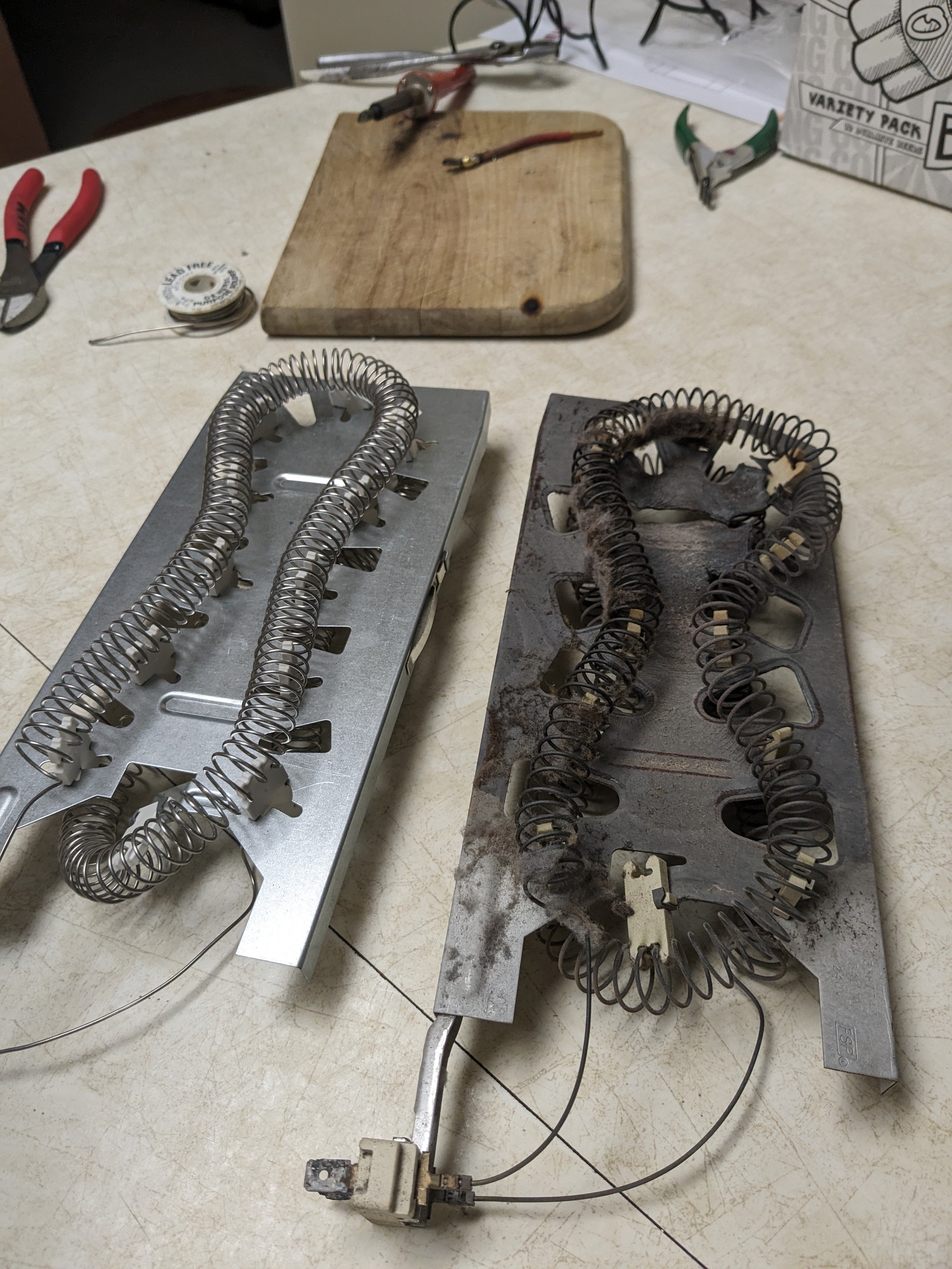

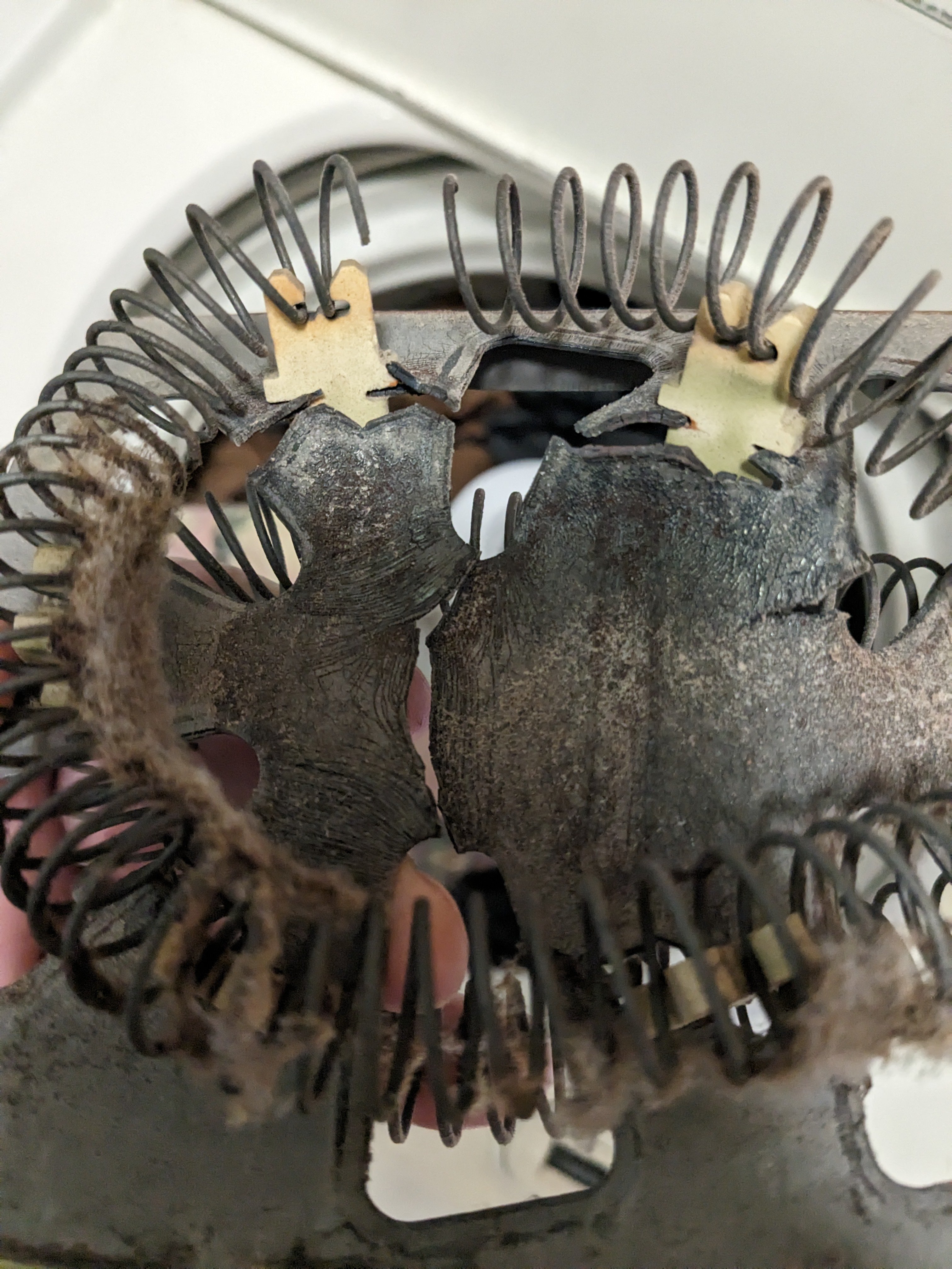

XXitanium Posted September 19, 2023 Author Posted September 19, 2023 it still runs... The old element had finally worked and rusted and broken. I bought the new element quite a while ago and had it in the cabinet. Is spade connectors keep coming loose heat humidity vibration? Quote
