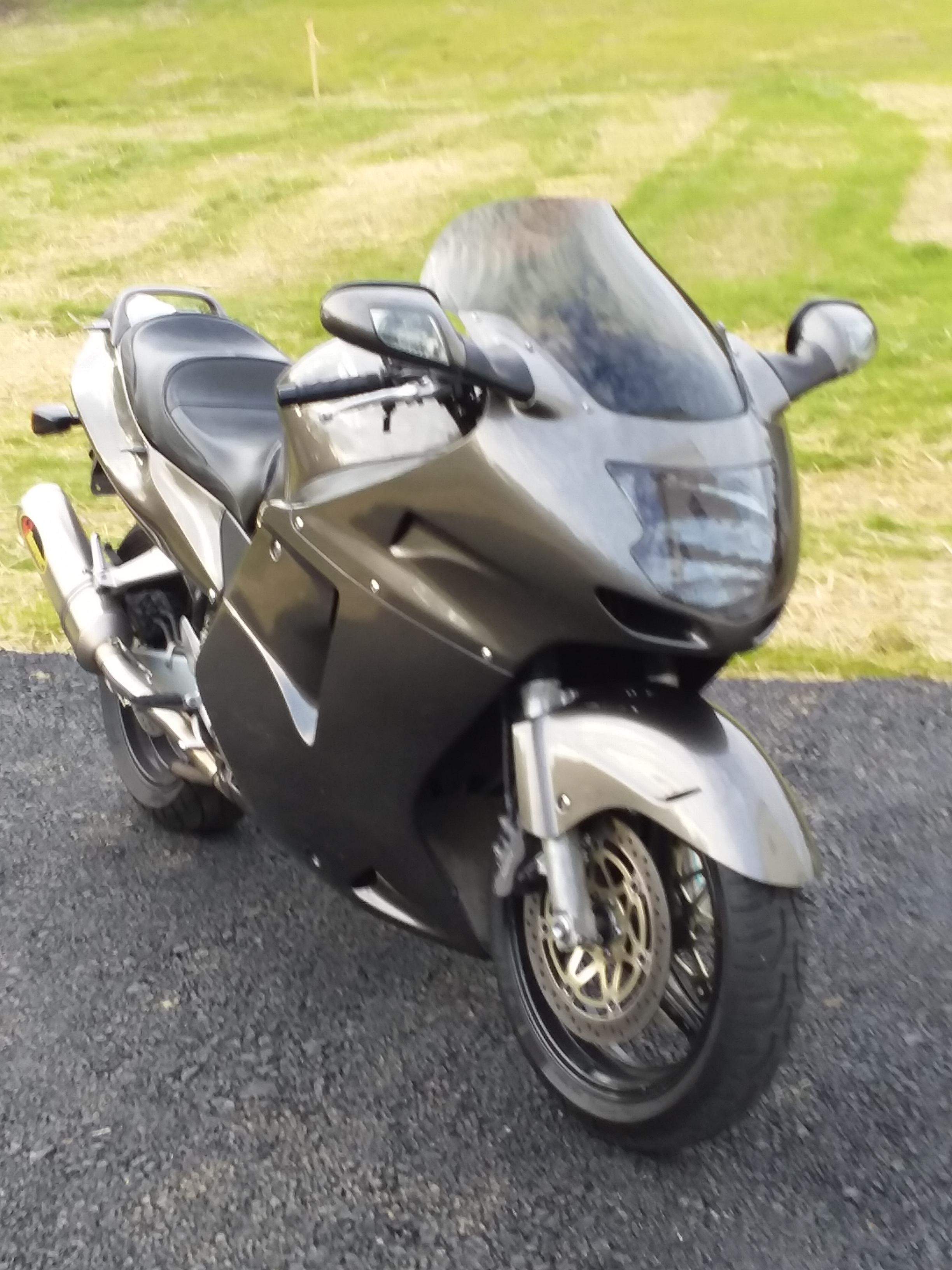

XXitanium Posted March 23, 2019 Posted March 23, 2019 The nice looking TI. I leave mine parked in the garage and gets away into the minuses, and it starts in the spring no problem. ... to back up the earlier statement that nothing on a XX will drop the battery. Quote

superhawk996 Posted March 23, 2019 Posted March 23, 2019 2 hours ago, XXitanium said: The nice looking TI. I leave mine parked in the garage and gets away into the minuses, and it starts in the spring no problem. ... to back up the earlier statement that nothing on a XX will drop the battery. Maybe on the slow ones, once you get into the red year and beyond I think there's some draw, but I haven't measured it. Quote

XXitanium Posted March 23, 2019 Posted March 23, 2019 Just now, superhawk996 said: Maybe on the slow ones, once you get into the red year and beyond I think there's some draw, but I haven't measured it. ...probably a lull in the Force... Quote
