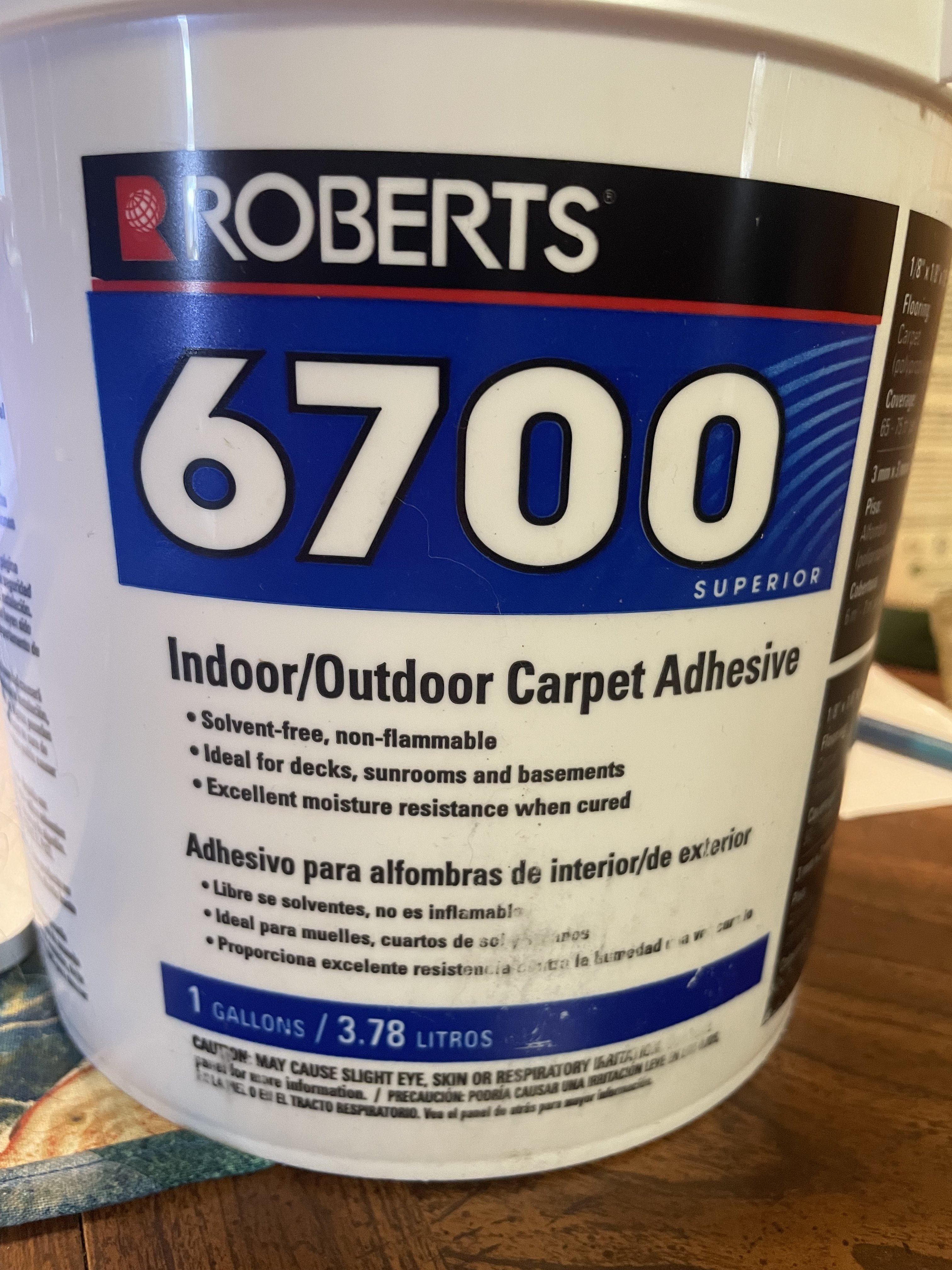

superhawk996 Posted September 9, 2023 Posted September 9, 2023 $30/gallon on Amazon, but there were similar cheaper ones. It's solvent free, many of them are. I chose this particular one because lots of people recommended it for my use. They're applied with a notched trowel and the instructions show how much coverage area different notch sizes are supposed to give. Quote

superhawk996 Posted September 12, 2023 Posted September 12, 2023 On 9/9/2023 at 8:54 PM, rockmeupto125 said: Which one are you referencing? I fucked up and didn't post the photo . Quote
XXitanium Posted September 13, 2023 Posted September 13, 2023 How thick is it? Can it be thinned? Quote
superhawk996 Posted September 15, 2023 Posted September 15, 2023 On 9/12/2023 at 8:32 PM, XXitanium said: How thick is it? Can it be thinned? Similar to wet cement. It's water based, I'm sure you could add some, but no clue if thinning would mess it up. Quote
