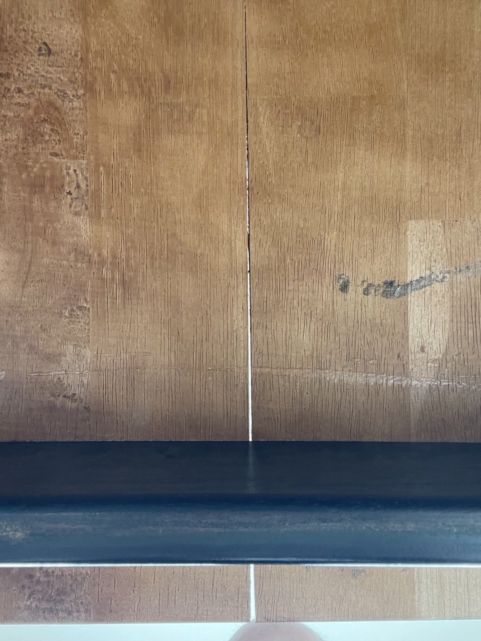

Zero Knievel Posted August 2, 2023 Posted August 2, 2023 The kitchen table developed a split. We’ve been told it would cost as much to fix (by a professional) as it would be to replace it. That said, I’m sure a woodworker would have no issue repairing the table for himself at minimal cost. I know I’d need a couple of clamps that go beyond 3 feet, wood glue, a reinforcement strip that would be glued and screwed into the underside of the table. Thoughts? Quote
SwampNut Posted August 2, 2023 Posted August 2, 2023 I need a more 3D view. Is it splitting in a single plane, or multiple dimensions? Meaning, is there curl plus the split? How much resistance is if you try to force them back together? Will it go? How important is it to you that the seam disappear (not show any signs of repair/issues)? Quote

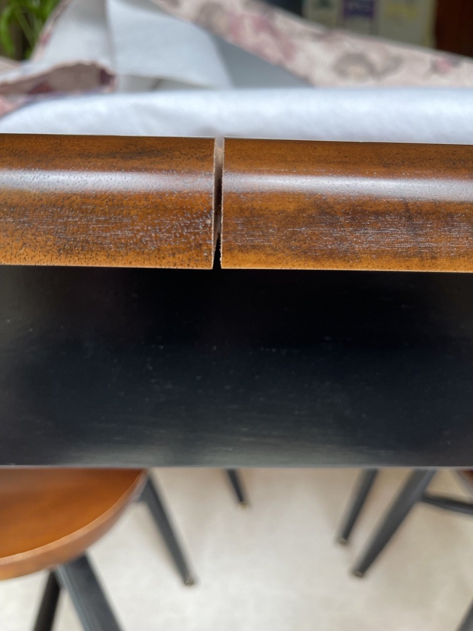

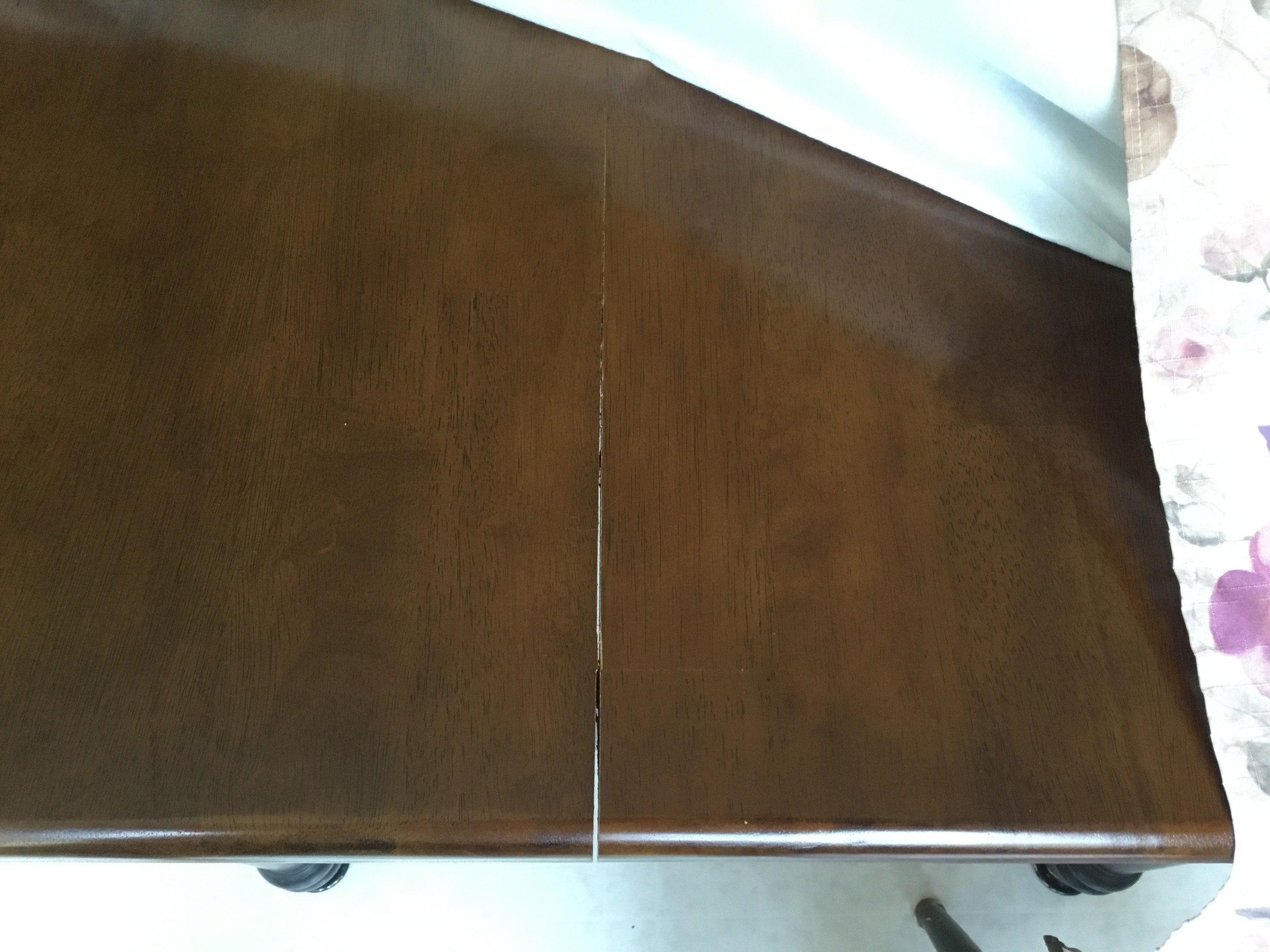

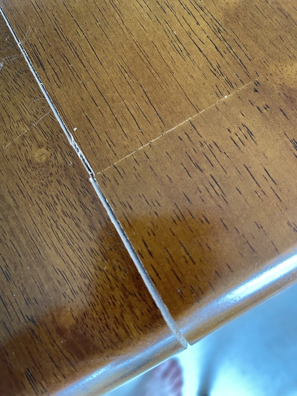

Zero Knievel Posted August 2, 2023 Author Posted August 2, 2023 I’ve added 3 more photos. Can’t force it back together by hand, and we keep the table covered, so I’m not worried about aesthetics. Quote
SwampNut Posted August 2, 2023 Posted August 2, 2023 There's a tremendous amount of force going on there, and there is now junk inside the broken joint trying to keep it apart. I would start with dry clamping it to see if it will even go together at all. Or, enough to make you happy. If so, then I'd apply Titebond II liberally inside the joint with a small brush, then clamp. This may be enough, hard to say. If you could clean the joint, it would be. You could add a support on the bottom. A flat piece, say 1/2" thick (ish, whatever) both glued and screwed to the bottom. The screws are for clamping, just need a few, not big. The glue will be the holding force. But you can't fit clamps in there so it has to be screws to close the glue joint. The screws only need to go into the top around 3/8 to 1/2" or so. Quote

Biometrix Posted August 3, 2023 Posted August 3, 2023 Why does the crack in the first of the 3 additional photos appear to have something white inside of it? Is that just the lighting/angle? Quote
SwampNut Posted August 3, 2023 Posted August 3, 2023 6 hours ago, Furbird said: Y'all trying to figure out how to fix it, I'm trying to figure out how it happened in the first place. It's wood. It does that. Ignore the rest of the retard post. Quote
Zero Knievel Posted August 3, 2023 Author Posted August 3, 2023 9 hours ago, Furbird said: Y'all trying to figure out how to fix it, I'm trying to figure out how it happened in the first place. Because it seems to me if you find the source, you prevent it from happening again. If the table is old, the question should be... why? Is there a structural issue? Termites? Humidity drop? Chuck Norris chopped the shit out of it? Andre the Giant body slammed your ass on it? Not sure if this matters, but this end of the table faces the windows in the kitchen that had 1/4” of ice on the inside this past Christmas…when we knew we had to replace the windows. 0 degrees that morning, and I think I remember hearing a CRACK that day, but didn’t see where it came from. I suppose extreme contraction made a weak point split. I actually see no structural issue with the table because the underlying frame is completely intact. Even if the split crossed the whole table, that surface wouldn’t collapse under normal use. 6 hours ago, Biometrix said: Why does the crack in the first of the 3 additional photos appear to have something white inside of it? Is that just the lighting/angle? Shot so the floor would reflect light into the camera so the crack would be visible. Quote

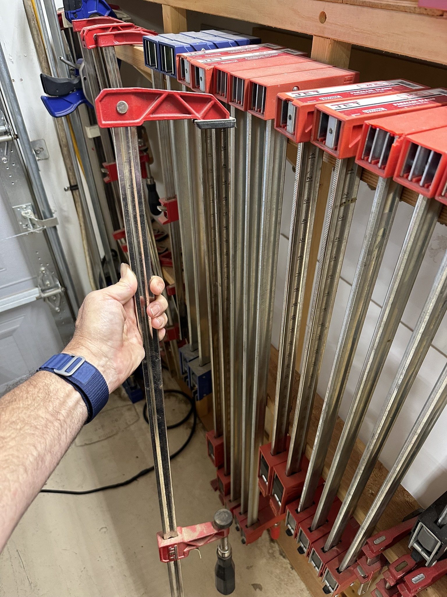

SwampNut Posted August 3, 2023 Posted August 3, 2023 It could be related, but I see things like this all the time, and I assure you nobody in Phoenix has their furniture near iced up windows. I just realized I didn't tell you one thing. You will need a stout clamp, probably, they aren't cheap. Your regular thin-bar clamps may not work. You wouldn't know until you try though. The one in my hand is actually a stout version of the generic thin, basic clamps, and I don't know if it would work. The cheap-ass basic shit at most stores will be even thinner. The one on the clamp rack next to it is called a parallel clamp, and can put down over 4x the force without bending. But they are expensive. The blue Irwin in the background is a maybe, but probably also expensive. Quote
IcePrick Posted August 3, 2023 Posted August 3, 2023 https://fireballtool.com/products/maximus-clamp-kit-set-of-2 Quote
SwampNut Posted August 3, 2023 Posted August 3, 2023 Now that's a clamp. It made me realize that a piece of black iron pipe and a clamp kit from HF would do this very well. https://www.harborfreight.com/2-piece-3-4-quarter-inch-heavy-duty-cast-iron-pipe-clamp-31255.html https://www.homedepot.com/p/BESSEY-H-Style-3-4-in-Black-Pipe-Clamp-Fixture-Set-BPC-H34/204986131 Quote
blackhawkxx Posted August 3, 2023 Posted August 3, 2023 If you were to go the really poor mans route, how about a couple of heavy duty ratchet straps which you already have and use buffers on the edge of the table and a 2x4 across the top to stop bowing? Actually Swap's HF suggestion sounds like the way to go and then you will have it for future use. Quote
SwampNut Posted August 3, 2023 Posted August 3, 2023 You will definitely be bowing it and I doubt that a pine 2x4 will stay flat. I mean, it's a good idea to have no cost, but may have poor results. I use strap "clamps" but only for square things like a box/drawer, so forces are equal. Hmm, two straps on opposite sides and equally tightened may be good.... Quote
