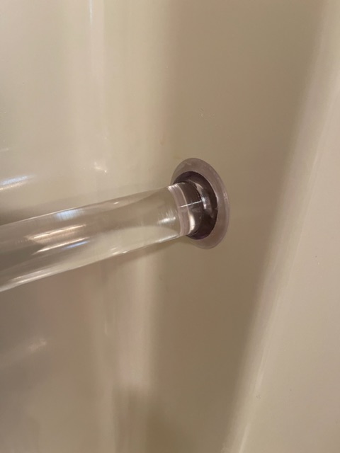

Zero Knievel Posted December 7, 2022 Posted December 7, 2022 The bit that secured the right end came off a while ago. I want to fix it, but there is nothing inside the hole to glue into. Can’t completely remove it because the “anchor” on the left side is still attached. Hardware stores are no help (not surprised by that). Removing the shower unit isn’t an option. Likewise, I want to avoid cutting or drilling the fiberglass. I was hoping there was a cap I could put on the end what would wedge in the hole tight, and that plus cement would permanently reattach it. Quote
XXitanium Posted December 7, 2022 Posted December 7, 2022 Take a close-up of the cap in the left side. Take a close-up of the hole, make it your new avatar. Measure the diameter of the clear rod. I'm betting a plumbing supply (specialty) store can help. Quote

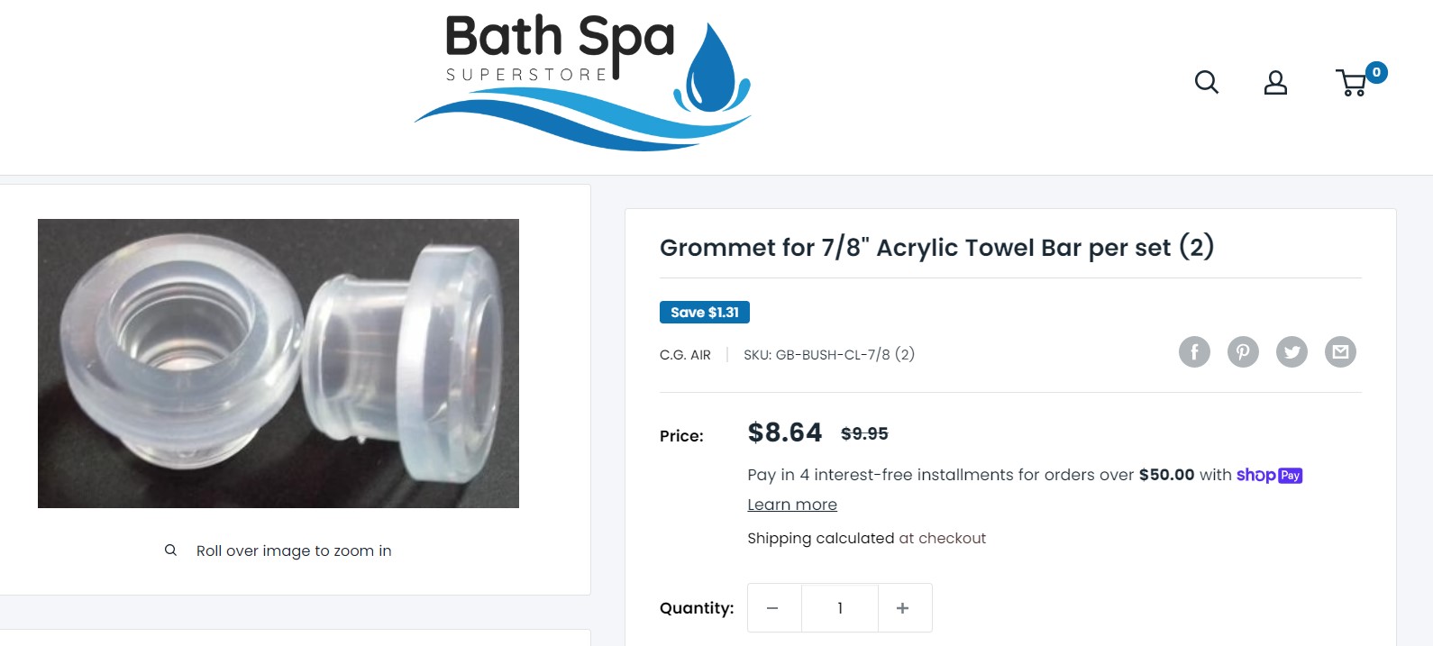

Zero Knievel Posted December 7, 2022 Author Posted December 7, 2022 Thanks. Just found this.... Quote
XXitanium Posted December 7, 2022 Posted December 7, 2022 Maybe need to drill the hole bit larger or buy a slightly smaller rod? ...a dab of clear silicone as adhesive? Take it easy on your girlfriend in the shower, aye bucko? 1 Quote

XXitanium Posted December 16, 2022 Posted December 16, 2022 On 12/7/2022 at 8:15 AM, Zero Knievel said: Thanks. Just found this.... ....picture of the repair? Quote
Zero Knievel Posted December 16, 2022 Author Posted December 16, 2022 Just got the email saying it’s shipped. Surprised it took this long to ship. Quote

superhawk996 Posted December 18, 2022 Posted December 18, 2022 On 12/16/2022 at 1:10 AM, Zero Knievel said: Just got the email saying it’s shipped. Surprised it took this long to ship. I don't understand how those grommets are going to work on this. If it does it'll be interesting to see how. Quote
Zero Knievel Posted December 18, 2022 Author Posted December 18, 2022 7 hours ago, superhawk996 said: I don't understand how those grommets are going to work on this. If it does it'll be interesting to see how. Slip over rod. May have to widen hole. Should lock rod in place. If I can get the rod out completely, I can make it symmetrical. Quote

superhawk996 Posted December 18, 2022 Posted December 18, 2022 5 hours ago, Zero Knievel said: Slip over rod. May have to widen hole. Should lock rod in place. If I can get the rod out completely, I can make it symmetrical. If the left side doesn't slide into the hole then maybe you could wedge it in place on the right with the new part, that seems unlikely, but I can't really tell from the photos. Not having it in my hands to better asses- I'd probably just use a strong sealant/adhesive on it. I'd probably go with 3m 5200 fast cure. Quote

Zero Knievel Posted December 26, 2022 Author Posted December 26, 2022 The parts arrived, but I haven’t had time to install them. Quote
Zero Knievel Posted January 1, 2023 Author Posted January 1, 2023 Finally done. Had to keep boring out the one hole until the insert fit…then a bit more as inserting the rod made it swell out and not let the rod in. Only did the one side as I saw no way to pop the rod loose from the other side without risking damage, and no tool I had would work with the minimal space between the rod and the hole. Shot some silicone lube to get the rod in, and even then it took effort. Unless it comes loose during normal use, I won’t cement it in place. Quote
