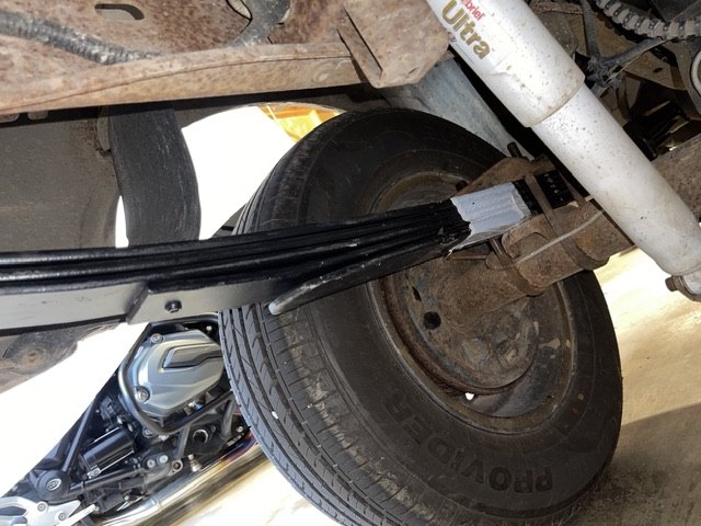

Zero Knievel Posted June 16 Author Share Posted June 16 Truck is done. $434.99 to install the springs. Took the guy 5 hours at $85/hour. Quite reasonable. I'll get a better look at how much OEM parts he had to change out, but I saw he did the rear hanger on the driver's side, and there is NO WAY I could have gotten tools in place to loosen the nuts mounting them to the frame. Commented that it was a bitch of a job, which I believe with over 200K and 25 years. Quote Link to comment Share on other sites More sharing options...
blackhawkxx Posted June 16 Share Posted June 16 1 hour ago, Zero Knievel said: Truck is done. $434.99 to install the springs. Took the guy 5 hours at $85/hour. Quite reasonable. I'll get a better look at how much OEM parts he had to change out, but I saw he did the rear hanger on the driver's side, and there is NO WAY I could have gotten tools in place to loosen the nuts mounting them to the frame. Commented that it was a bitch of a job, which I believe with over 200K and 25 years. When you can't loosen them, you cut them (in general). On mine, they were riveted to the frame so the heads had to be cut off and then driven out. I replaced both sides on my Ranger, have done far worse jobs. Saying that, I'm sure you made the right decision to have it done. Quote Link to comment Share on other sites More sharing options...
Zero Knievel Posted June 17 Author Share Posted June 17 Well…what a difference. Before, the truck rolled noticeably in every turn. Now, hardly any roll at all. Definitely needed to be done. It will be interesting how much the bed does or doesn’t sag when I pick up a year’s supply of salt for the water softener. Only the springs were replaced, so on Monday I can see about returning the unused parts. Quote Link to comment Share on other sites More sharing options...

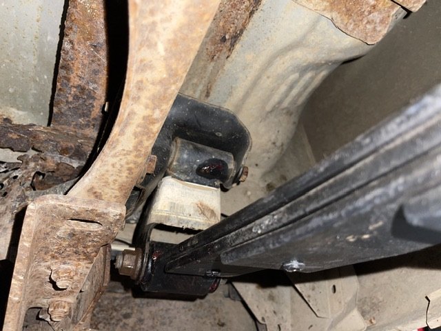

Zero Knievel Posted June 19 Author Share Posted June 19 From what I can tell, some new bolts were used for the springs. I’m guessing some either sheared or had to be cut off. The mounts were otherwise okay. Quote Link to comment Share on other sites More sharing options...
blackhawkxx Posted June 19 Share Posted June 19 3 hours ago, Zero Knievel said: The mounts were otherwise okay. Are you sure the spring hangers were not changed? They are black in your photo with everything else being brown. Quote Link to comment Share on other sites More sharing options...
Zero Knievel Posted June 19 Author Share Posted June 19 I have the replacements still in their bags. There are spots of rust on those hangers. The replacements are spotless. Quote Link to comment Share on other sites More sharing options...
superhawk996 Posted June 23 Share Posted June 23 On 6/19/2023 at 11:31 AM, blackhawkxx said: Are you sure the spring hangers were not changed? They are black in your photo with everything else being brown. The hangars get different paint, possibly powder coat. And it's likely that they're made of better metal which would also help them as the paint fails. Quote Link to comment Share on other sites More sharing options...
