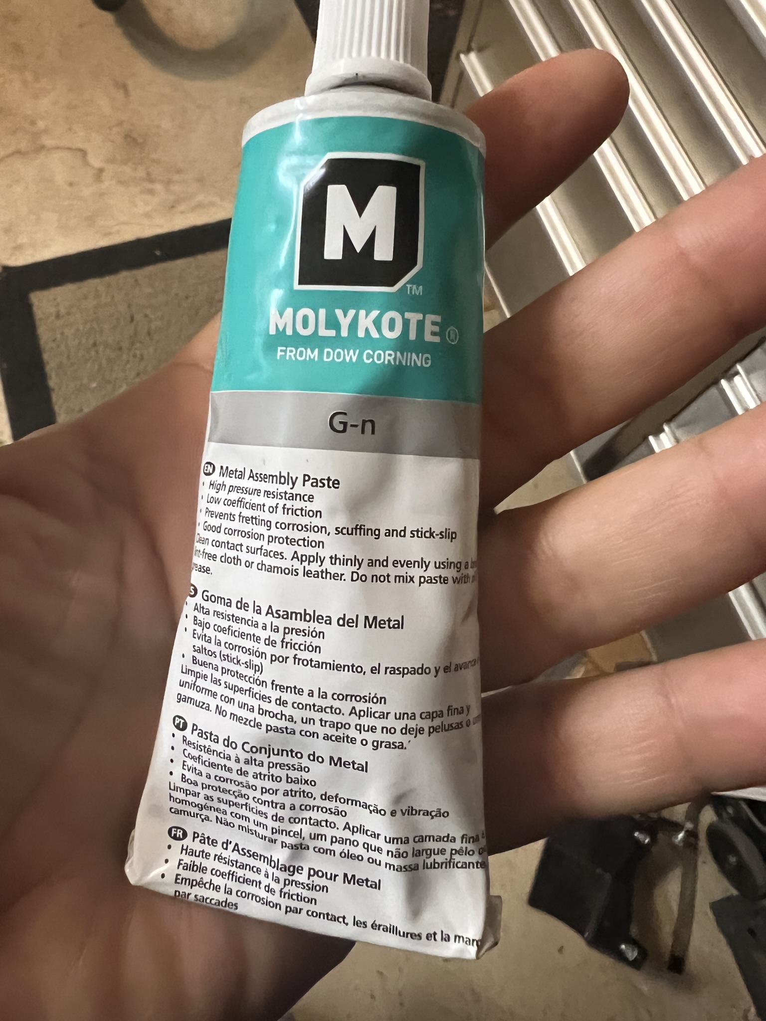

This is another high-dollar thing that lasts a lifetime.  I believe Oscar is still using the tube my dad owned.
I agree if it is a low use but works excellent, it is worth it.
This is a can, and he stole if from work, but they don't know I have it.  I often wonder why I'm so careful not to waste any, fuckin thing's 20 years old and around 3/4 full...after showing up already in used condition.
