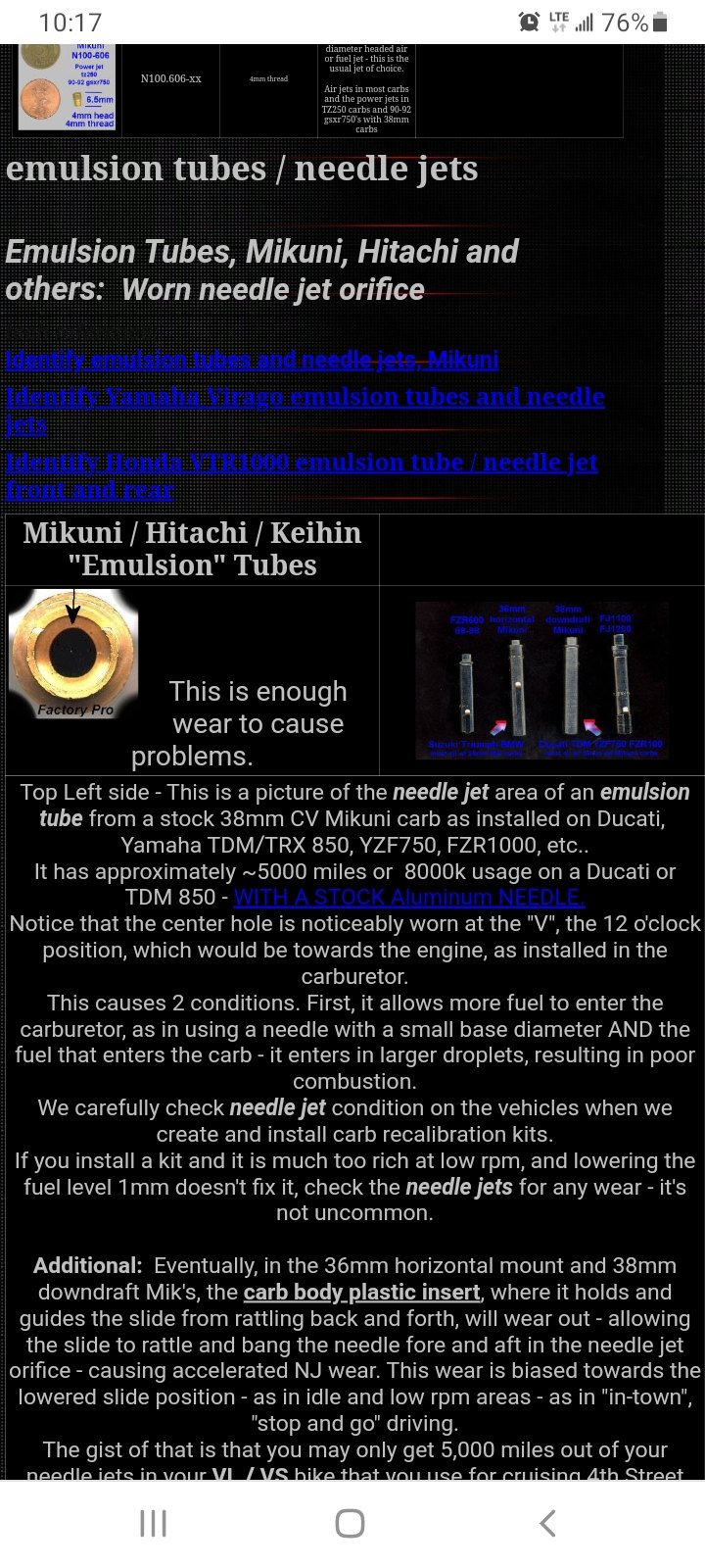

What mileage has the bike done? My '97 is on 279k km now, and is using a fuckton of fuel compared to 15 years ago. Took the needles and mainjets and looked at them under a strong magnifying lens and the wear is visible.  I have replacement needles and stock mains on order, and waiting for arrival. Might be worth considering if your bike has seen high mileage
You most likely need new emulsion tubes as well, no, I don't know when you get them for blackbird.
http://www.factorypro.com/jets,needles,emulsion_tubes,pilot_jets.htm
Edited by tomek
1 minute ago, tomek said:
You most likely need new emulsion tunes, no, I don't know when you get them blackbird.
The bike only has 29,000 miles on it.
I installed a Dynojet jet kit back in early 2002 and it only had about 2,500 miles on it at that time.
It's surprising the low miles on it, I have ridden it down from Seattle to Monterey and most of the way back to Alaska, in 2019 rode it from Alaska to AZ. at one point I shipped it down to Illinois and went to a number of bike meets. Most of the miles were long trips, Alaska has a short riding season.
The local bike shop picked it up yesterday. They told me that when I called and told them it was a 1997 they imagined the worst, they were amazed to see the bike in such pristine condition. The owner commented: We don't see many older bikes this nice.
