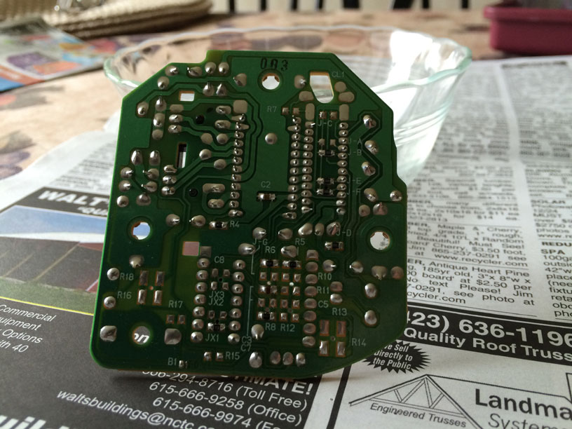

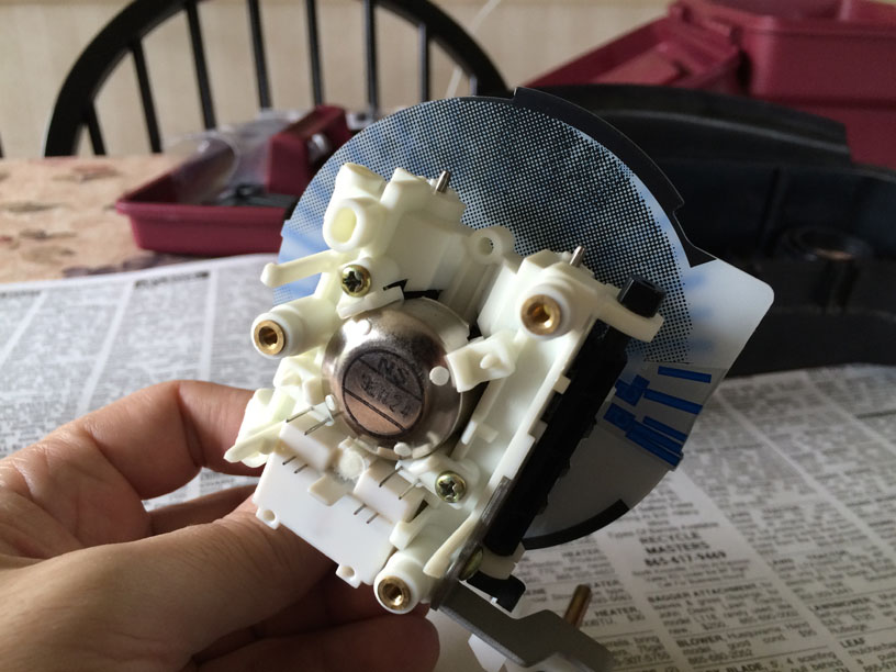

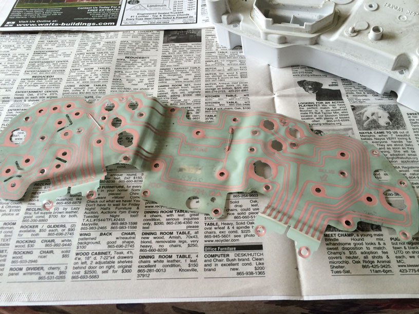

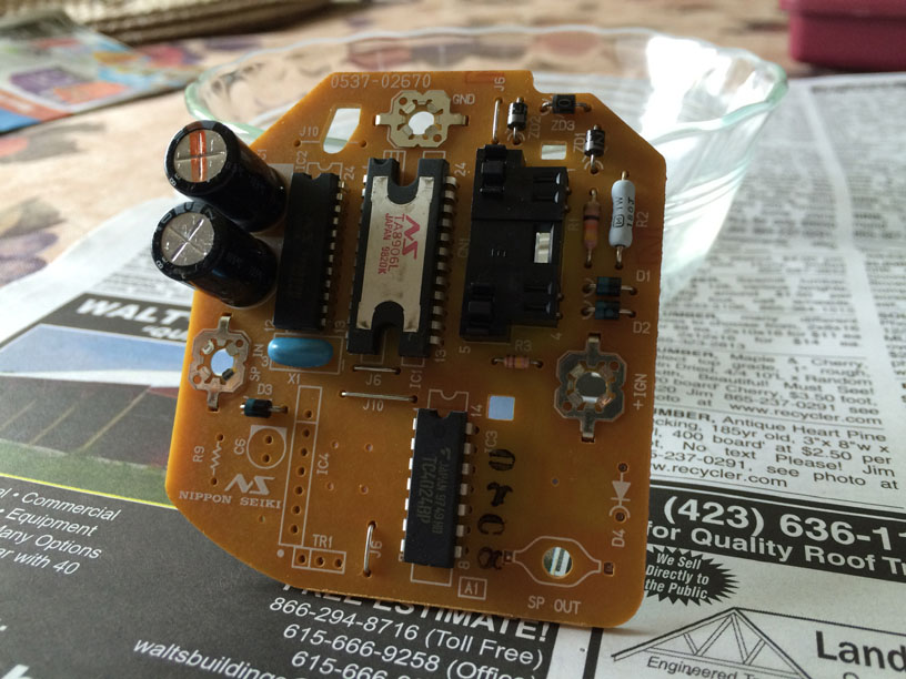

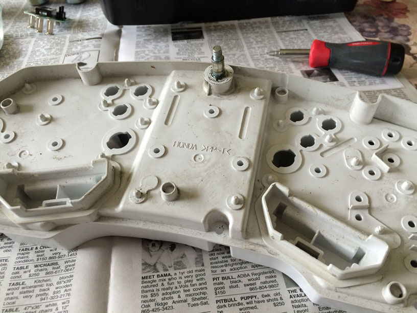

Zero Knievel Posted June 27, 2015 Author Posted June 27, 2015 Well, pulled it apart. I see nothing wrong. No obvious dirt or contaminants. I took some pics. It's still dissembled. I sprayed down the empty housing with electrical parts cleaner and took some WD-40 and paper towels to gently wash the flexible circuit board (both sides). No obvious signs of corrosion, but the 3 screws holding the speedometer into the housing were "whiter" than others. I might work them with a wire brush...but why they did this and the others did not, I don't know. The only "odd" thing I noted is that if the needle on the speedometer is at 85 or higher, it naturally wants to rotate to the right to max speed. If it's under 85, it will rotate left back to zero. Quote

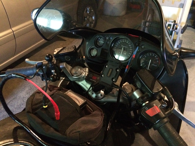

Zero Knievel Posted July 4, 2015 Author Posted July 4, 2015 Well, bike is back together. So far, I've found NOTHING. What I did do is add wires to the speedometer terminals (the pulse from 0v to 5v). These wires run up and over the instrument cluster. Ideally, I wanted to rig up some kind of light that would shine bright enough to show I have a signal. If the speedometer goes out but the light is still working, I then KNOW it's a failed speedometer unit. Sadly, I can't find shit that works with only 5v max. I'm currently figuring out how to strap a cheap multimeter onto the bike's dash. No luck there, but at least that would do the job. Quote
Zero Knievel Posted July 5, 2015 Author Posted July 5, 2015 Well, didn't find a lamp so far, so I reworked some leads to a cheap multimeter to reinforce them and installed plug connectors on the wires to the dash. I can keep the multimeter in the magnetic bag I use for by DVR unit, and the plugged in leads will keep it from slipping out (the prongs will feed through the pocket...which has a mesh design to it). If the weather turns sour, I can unplug it and stuff it into the bag for protection. Quote
