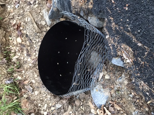

I fabricated the following to protect one of the drainage inlets under the driveway by buying a 2 foot section of black stovepipe and drilling holes in it.  I’m looking for the same material (strength wise) but pre-perforated.  I’ve had no luck finding it, and Google searches don’t come close to what I’m looking for.  The material has to be stronger than chicken wire or other mesh products, which is why I went with the stove pipe.

What I see in the stores isn't large enough in diameter...plus I'd have to cut it length-wise.  Plastic won't easily hold to a new shape, but if there's a supplier with more options, I'd like to see it.

Everything I see when I look for this stuff looks very flimsy.  It has to be able to withstand a torrent of water carrying silt and rock in a heavy drainage event.

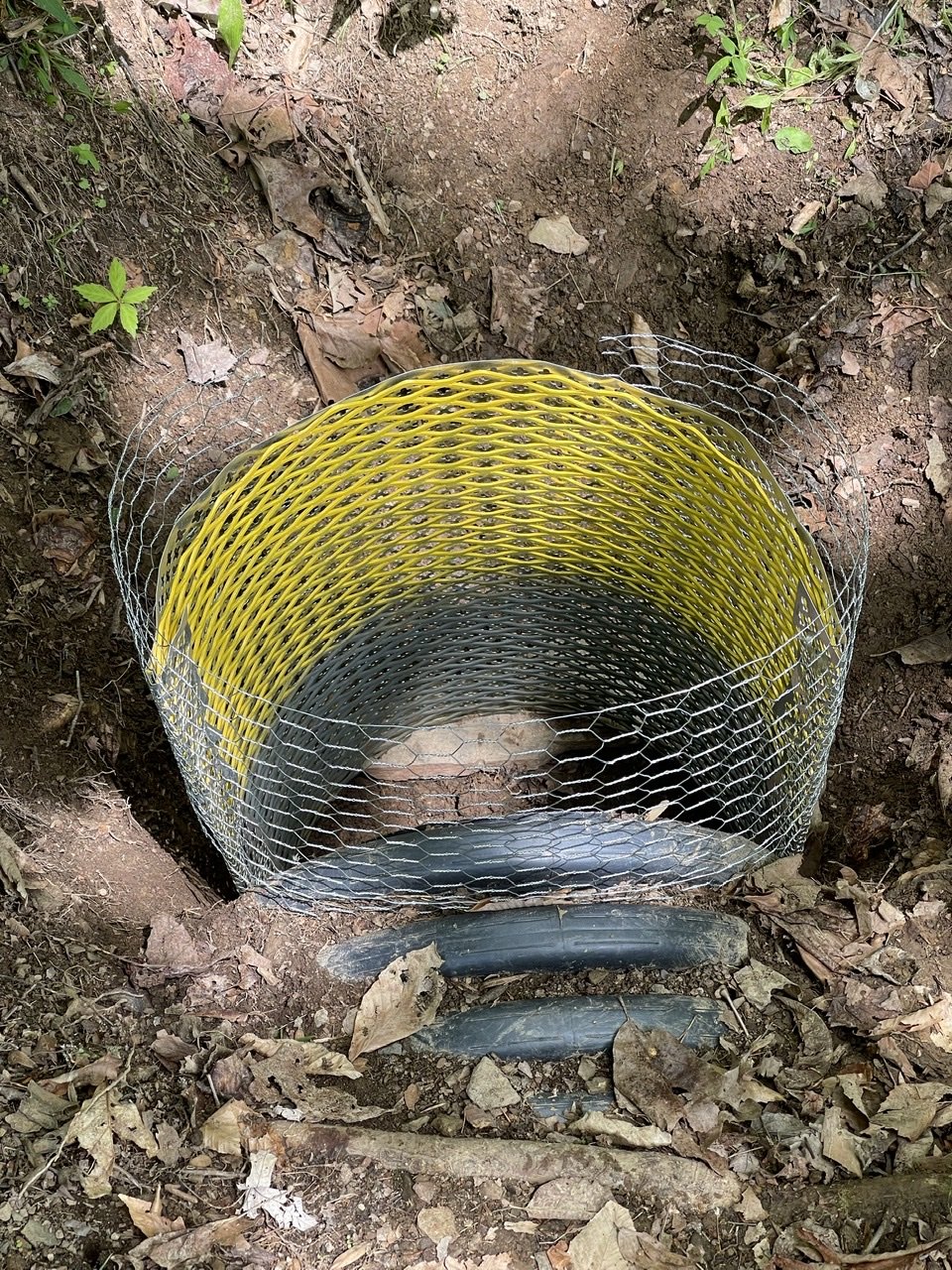

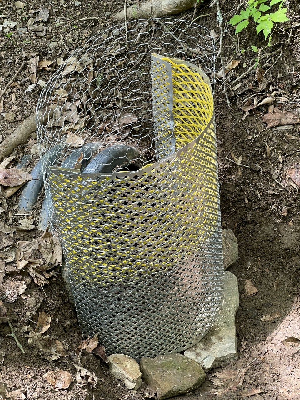

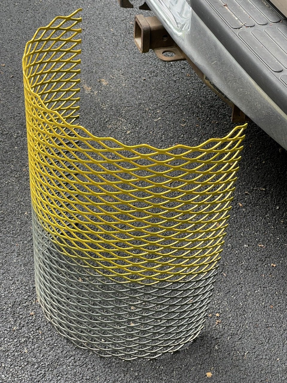

Well, I found a metal fabricator in town and had him make three of these…I painted them when I got home.  Under $80 for all three.  I’ve installed on the two main culvert inlets.  The stove pipe one will take more digging out to install.
Installing, I repurposed some of the old stuff and used chicken wire to prevent stuff falling in from behind.

You should remove the sheet with the small holes and leave just the expanded metal.  Those little holes will easily clog up with leaves, the larger holes have a decent chance of letting them through or at least letting them bend into the holes so that it stays flowing.
I thought of that.  I’ll see how they perform.  Silt flows down and has to be dug out anyhow, and removing it means more gets through.  It’s the difference between cleaning out what’s washed in and having to pull the whole grate out to relevel the ground.  As it stands, I still have to check after heavy rains for blockage from leaves washed down.  At the very least, these suckers are a lot more sturdy than what I rigged up on my own.
