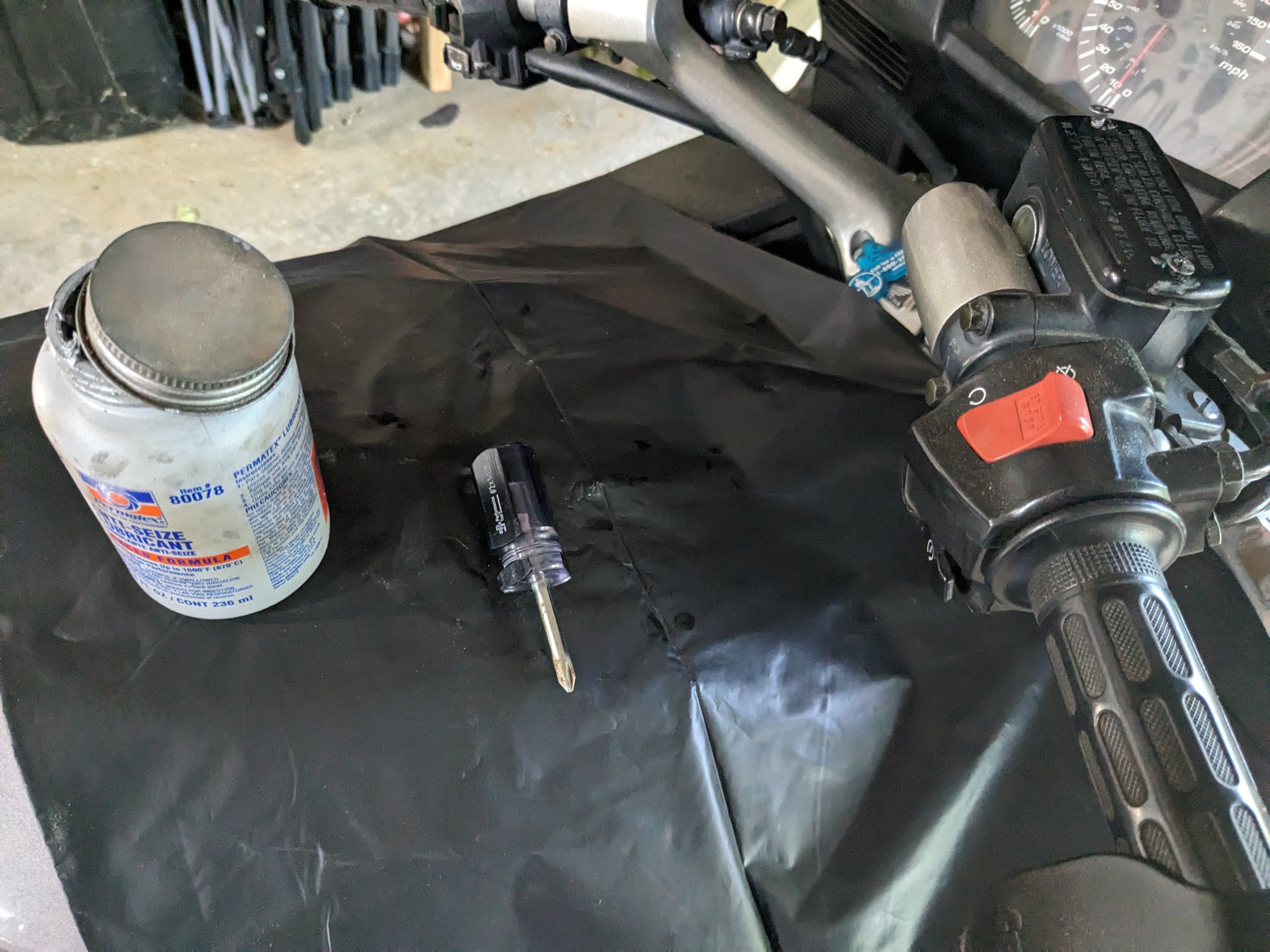

XXitanium Posted June 11, 2024 Posted June 11, 2024 Pre-ride. SWMBO requested check of DOT-4 levels. Stuck tiny screw. I tapped on the screw driver with a dead blow a few times. Funny thing, I have about 100 flat blade screwdrivers. I can only find about four Phillips, and most of them were the wrong size. There was one stubby that was bigger end. I was worried I was going to strip it out. Quote
XXitanium Posted June 11, 2024 Posted June 11, 2024 I put a tiny bit of anti-seize on them before I put them back in. Quote
superhawk996 Posted June 11, 2024 Posted June 11, 2024 33 minutes ago, XXitanium said: I can only find about four Phillips, and most of them were the wrong size. There was one stubby that was bigger end. I was worried I was going to strip it out. JIC is your lord and savior when working on Jap stuff. Oddly, I find that JIC drivers fit phillips screws better than a philips driver, but a phillips in a JIC screw is loosey goosey. The first time I used a JIC driver I was like- holy shit! It feels like it's stuck to the screw. It's almost like being in a torx or allen screw, but it will allow you to drive at an angle if needed. When you see a phillips looking screw that has a dot punched into the face, it's a JIC screw. Pretty sure every phillips looking factory screw on a Jap vehicle will be JIC. For decades I wondered why Jap vehicle's phillips screws had the dot and why they were more problematic than American phillips. Quote
superhawk996 Posted June 11, 2024 Posted June 11, 2024 I've wrecked several JIC screws using phillips, but haven't had an issue since discovering JIC drivers. Buy some. Quote
XXitanium Posted June 11, 2024 Posted June 11, 2024 31 minutes ago, superhawk996 said: JIC is your lord and savior when working on Jap stuff. I was reflecting on that while I was stumbling around my shop. I was going to order a set couple years ago. I never got around to it. Something happened Last week I bought around at the bar that would have cost more than it would cost me to get that set of screwdrivers. Screwed up priorities. I've been going in and out of Home Depot getting stuff for redoing the top of the deck. .....next trip. Japanese-Industrial-Standard. Quote
