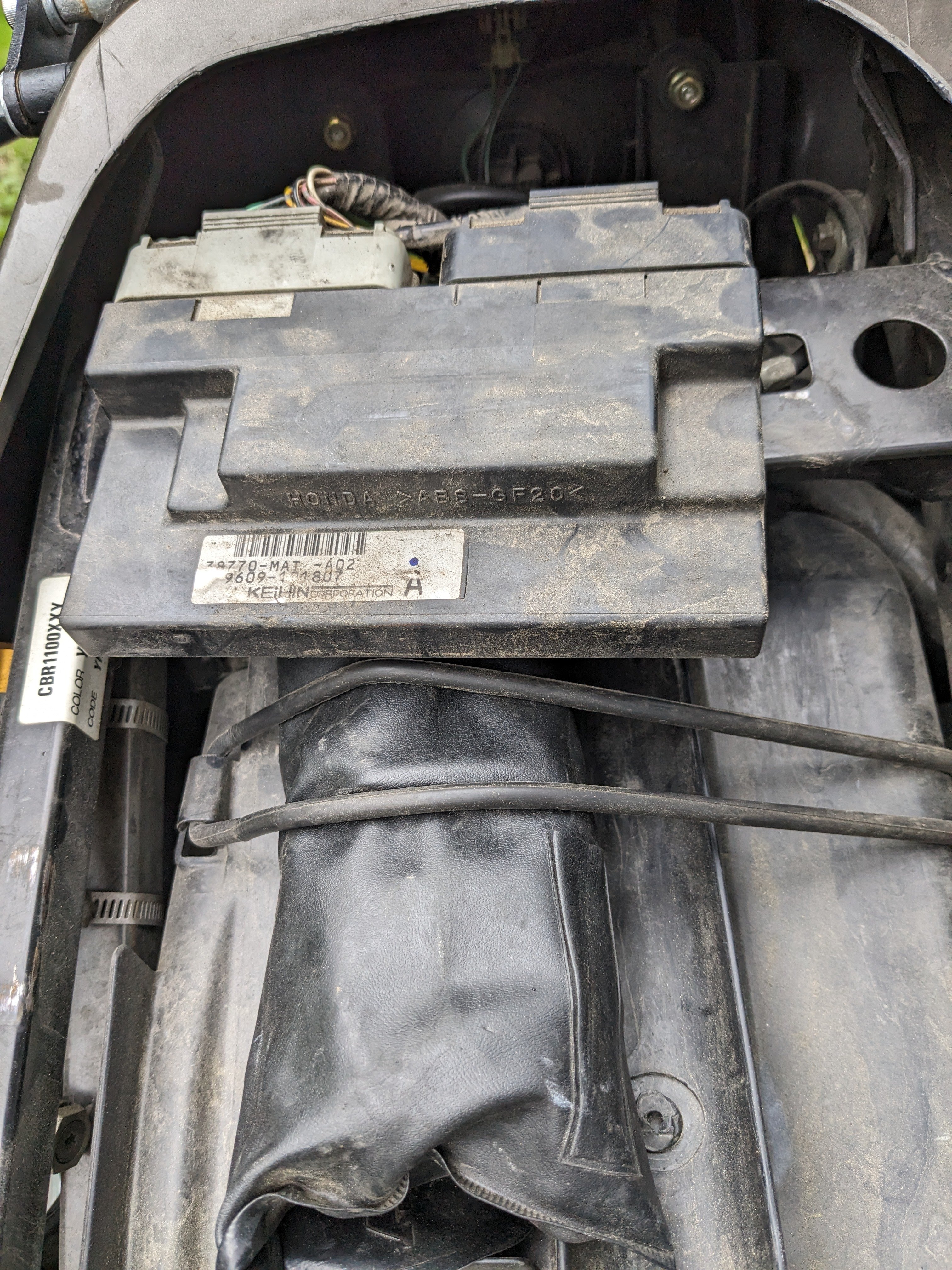

XXitanium Posted June 15, 2024 Author Posted June 15, 2024 The battery strap was loose laying on top of the battery. I don't know what kind of bump I had to hit to have that come loose. We looked at the ECU. It looked like the connection was fine, can I take off the tail light and get at edit enough to pull it out? Quote

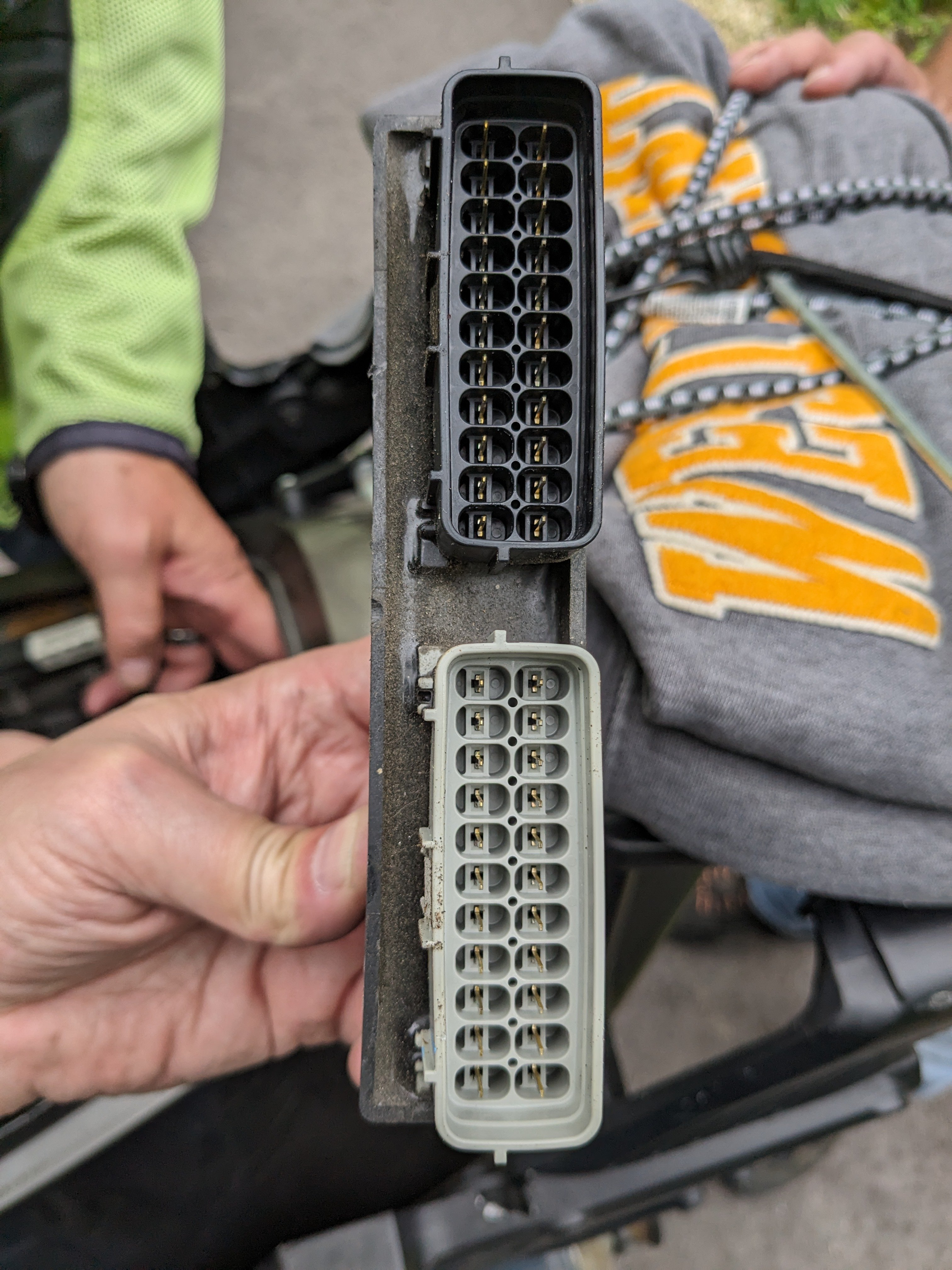

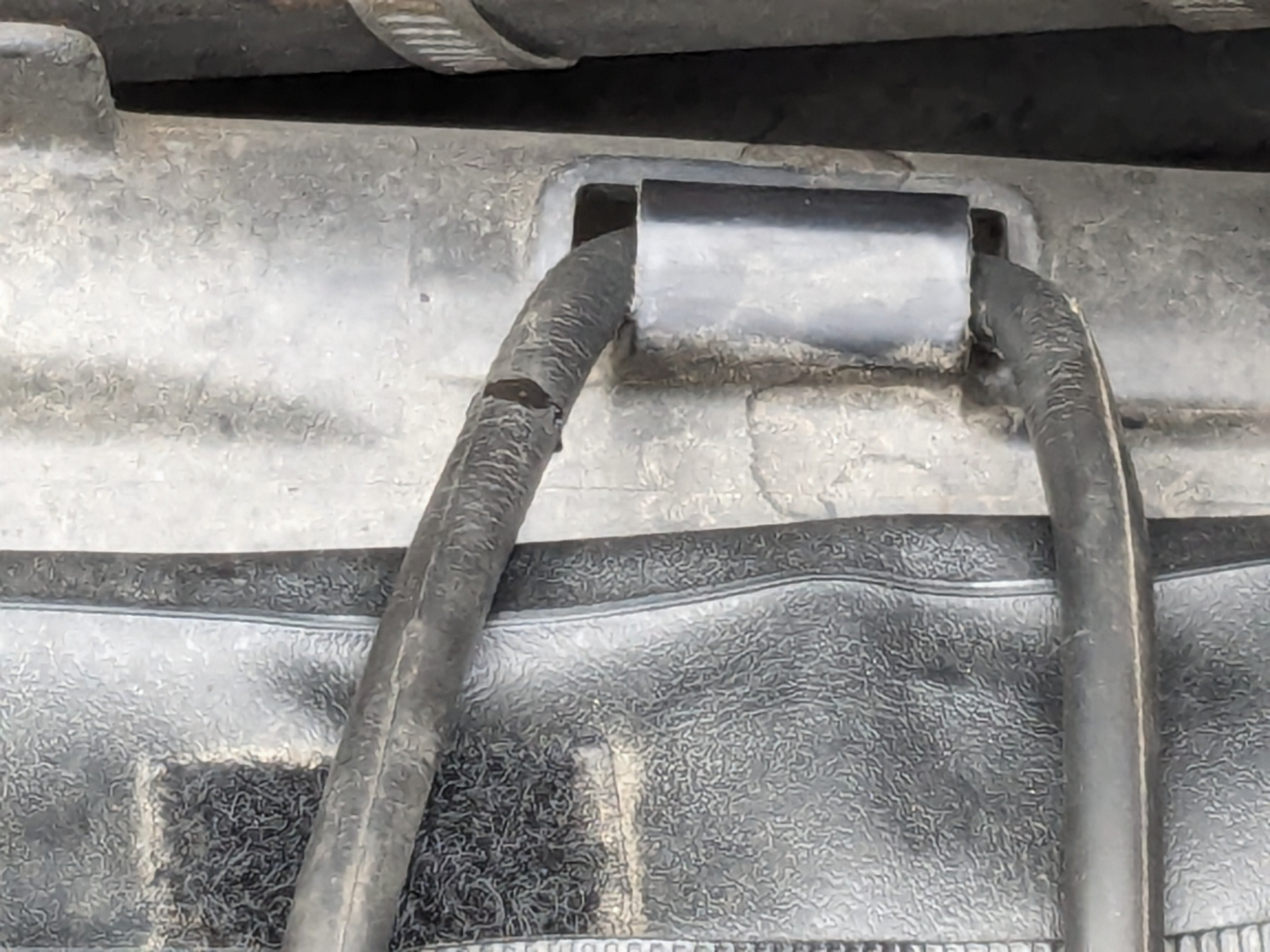

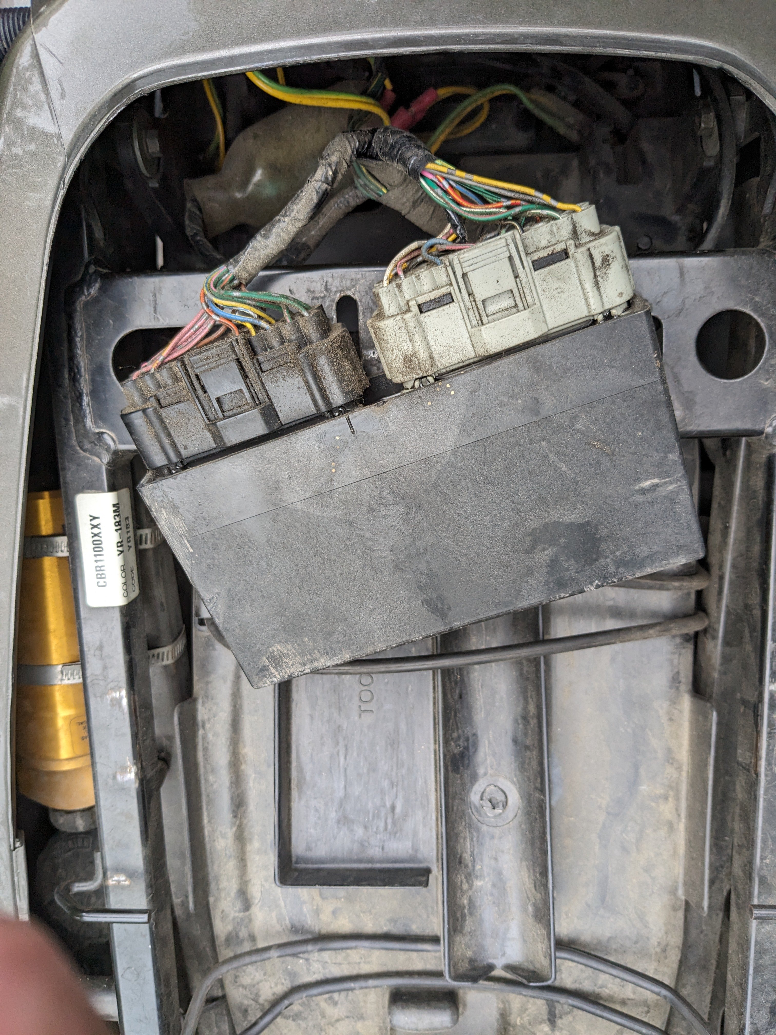

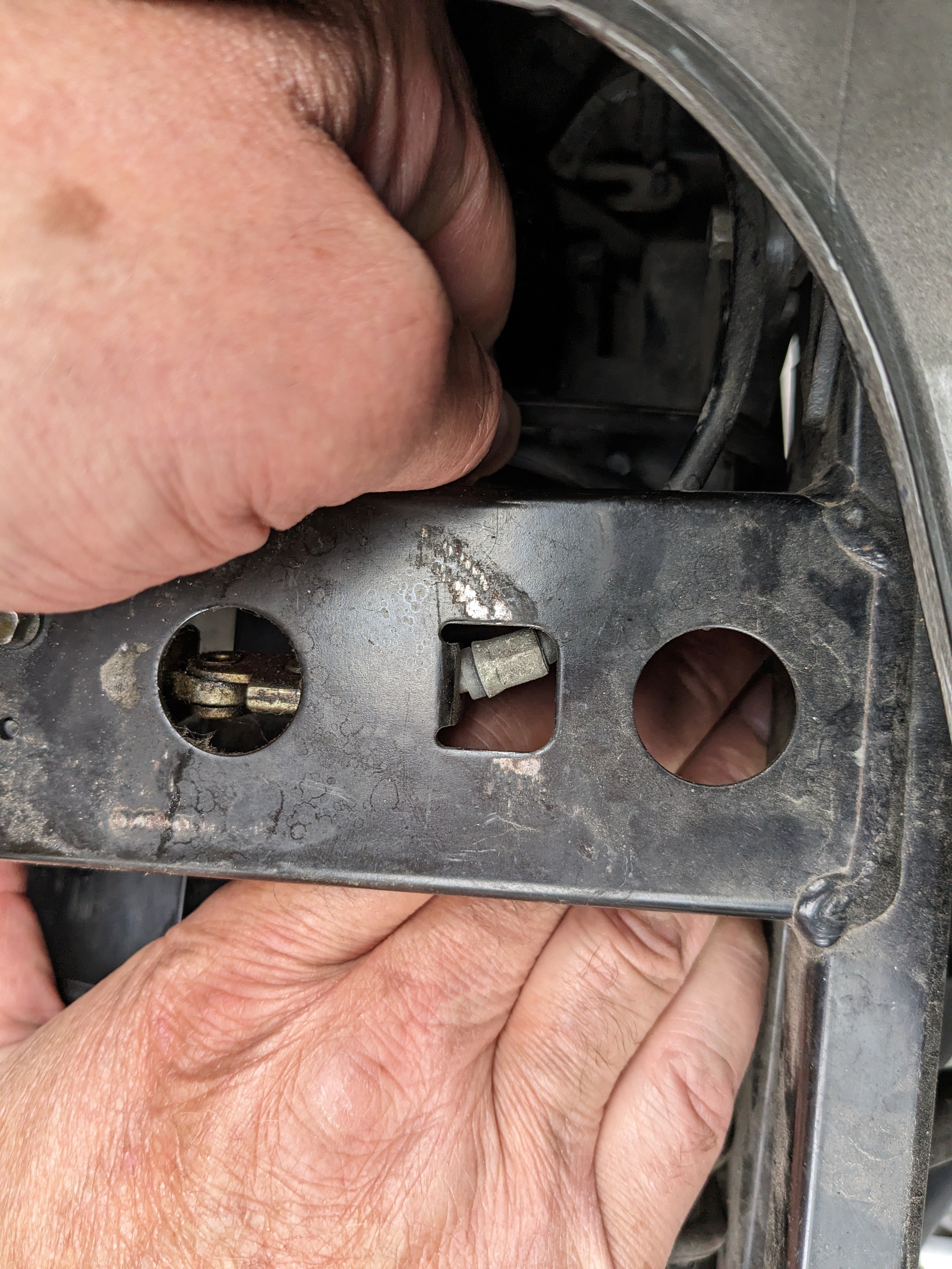

XXitanium Posted June 16, 2024 Author Posted June 16, 2024 I removed it. Pull the seat Take off the high tech retention device. Tip it back and pull forward. Keep your fingers our of the way while your millwright friends argue about who get to undo the little snappy things on the ECM. Your buddy that came along with the GTI stopped and got WD-40 contact cleaner and Permatex dielectric grease. ...they actually let you hit it with the contact cleaner and grease. Then it got hard... The high-tech ECU retainer pops. Quote
XXitanium Posted June 16, 2024 Author Posted June 16, 2024 Disconnecting the ECU may have cleared codes Put it all back in place. Millwright buddy informs me - isocyanate (Super Glue) was invented for splicing o-rings. We fixed the high-tech retainer device. See small black patch.... 1 Quote

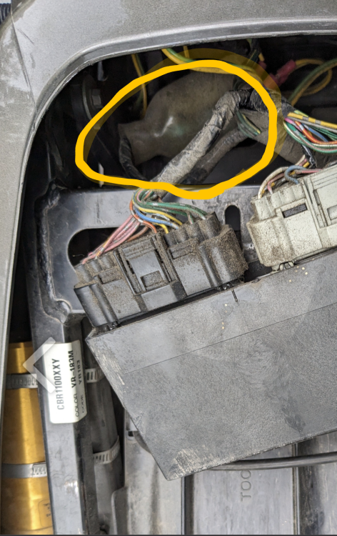

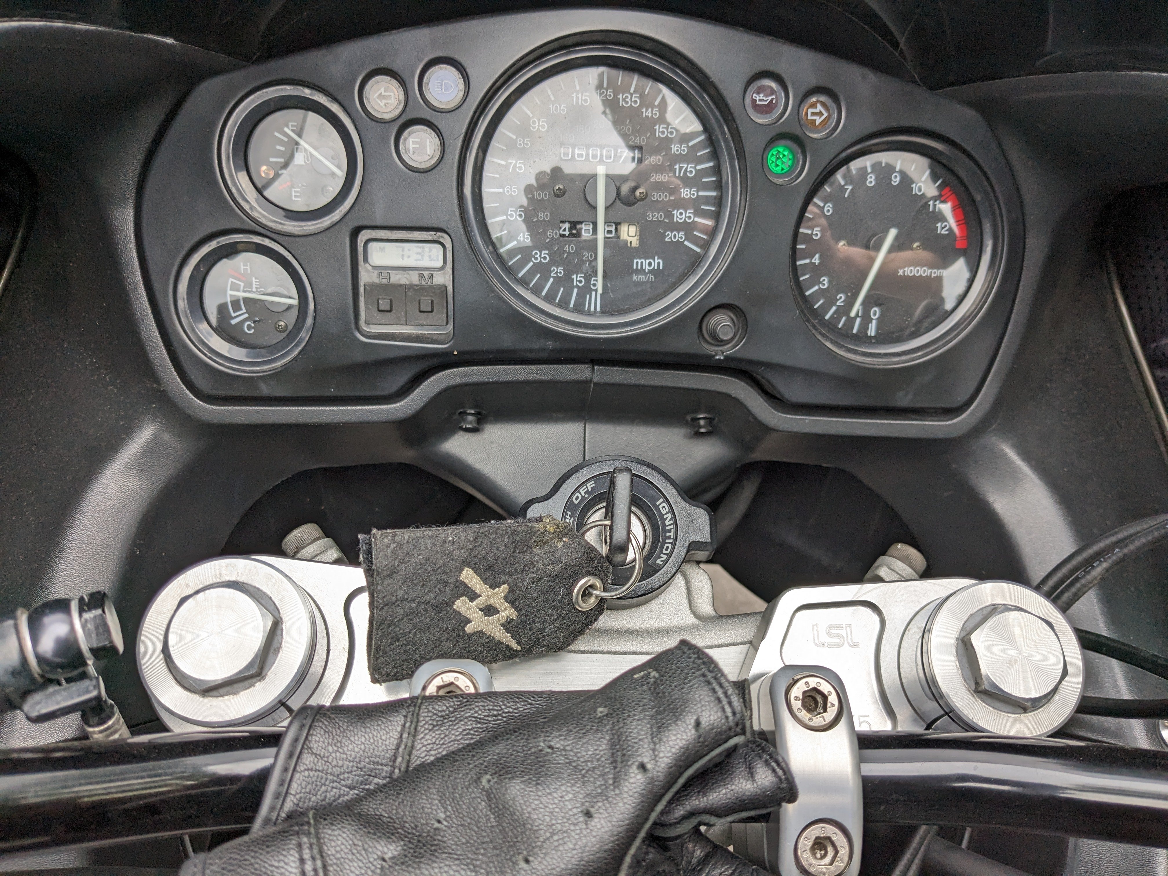

XXitanium Posted June 17, 2024 Author Posted June 17, 2024 OK, the light came back on shortly after we pulled out and rode 300 miles home. The OBD2 connector is wrapped in here? Quote

superhawk996 Posted June 17, 2024 Posted June 17, 2024 2 hours ago, XXitanium said: OK, the light came back on shortly after we pulled out and rode 300 miles home. The OBD2 connector is wrapped in here? The oil light came back, or FI light? You've talked about both. It doesn't have an OBD2 connector, just a two wire plug. You connect the two together with a small jumper wire and the ECU will flash the codes using the FI light. As far as the oil light and waiting to start, I'm pretty sure I started mine without waiting and didn't get an oil light, but I won't swear to it. I think the light is wired straight to the pressure switch, but I'm not sure of it. 1 Quote
XXitanium Posted June 17, 2024 Author Posted June 17, 2024 I had trouble seeing the lettering on the overcast day. It was easy to read on a sunny day. It was the large red Fi light near the gas gauge. 4 hours ago, superhawk996 said: It doesn't have an OBD2 connector, just a two wire plug. You connect the two together with a small jumper wire and the ECU will flash the codes using the FI light. Thanks! Quote
