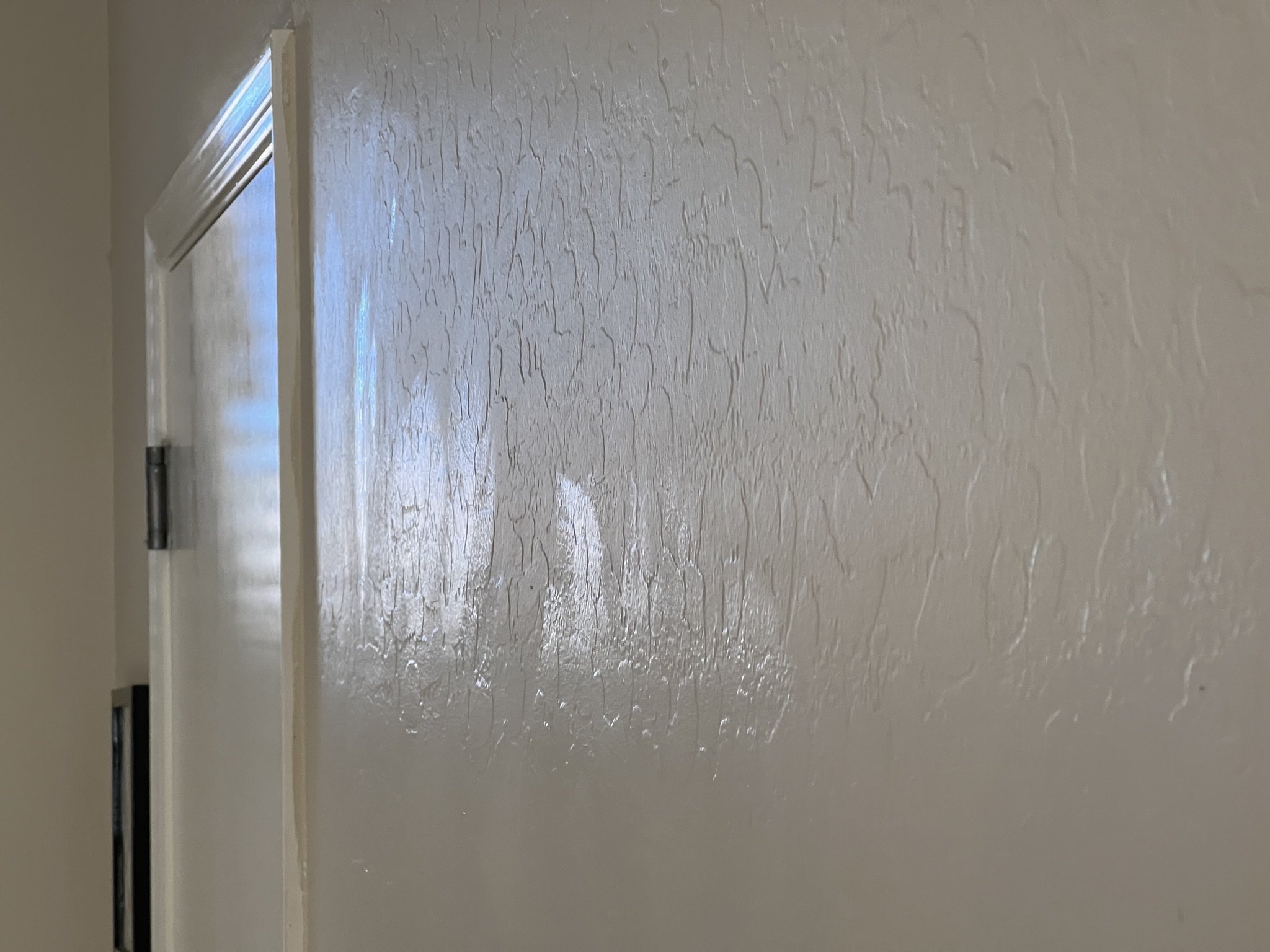

SwampNut Posted February 9, 2022 Posted February 9, 2022 Our house is painted with a flat cream paint most everywhere. But two areas, the kitchen and entryway, are semi-gloss. Well, I thought. But they really are just not as flat. I used the leftover flat paint that came with the house, and it's flatter than the walls. So I bought some semi-gloss, good to go right? Negative ghost rider. So then I mixed them 50/50...glossy. Now I'm at 3:1 flat to semi, and while not dry yet, I think it's headed to still being slightly glossy. WTF is on these walls? I know I'm being a picky cunt and I need to just not look at them sideways to the light. But I'm a picky cunt. Quote

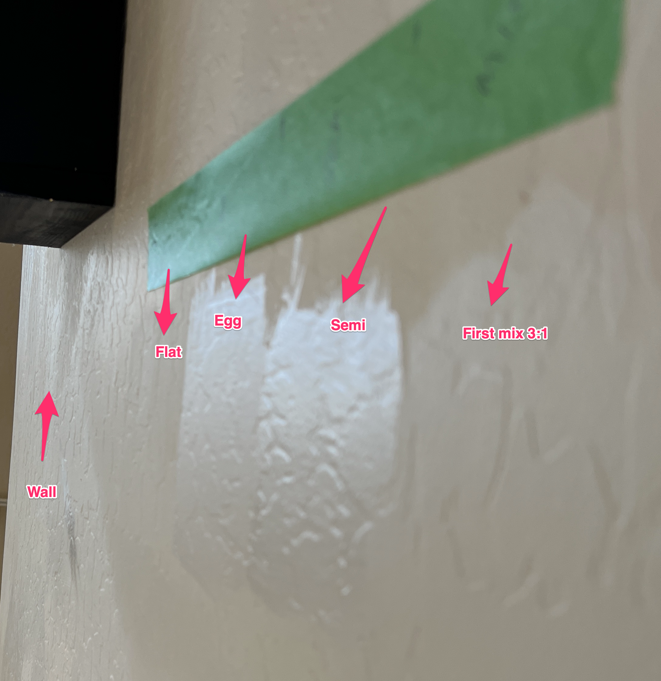

SwampNut Posted February 13, 2022 Author Posted February 13, 2022 Nope, not eggshell. That was way more shiny than the wall too. So now I have flat, semi, eggshell, and mix, and none are right. The color is spot on, shine is not. So fuck it, I mixed the rest of the flat with my previously mixed semi-flat, painted a larger area, and feathered the edges with a gun on very low production, high air. Quote

fizzy Posted February 18, 2022 Posted February 18, 2022 After coat 47 didn't work, you went ahead with 10 more?🍺 Your first pic showed areas of differing gloss. Anyway, I'm not there, you are. These things don't always show up well on pics. I think you are expecting too much from Behr, as it is low grade bottom shelf stuff. If you don't like my advice, go to a pro paint store, follow their advice and buy only top grade paint, at least for this particular project. Quote
SwampNut Posted February 18, 2022 Author Posted February 18, 2022 I didn't dislike the advice, just trying to figure it out. The spottiness was created because *I* spot painted. Before that, the wall was all even. I then tried the flat, then the semi, then the eggshell, creating the problem. Currently, with my mix of flat and semi, I'm reasonably happy and you can only see it if you try. So basically solved the problem, not the mystery of why. It has a shitload of coats right here because of multiple repairs. And then all the attempts with different paints. 1 Quote

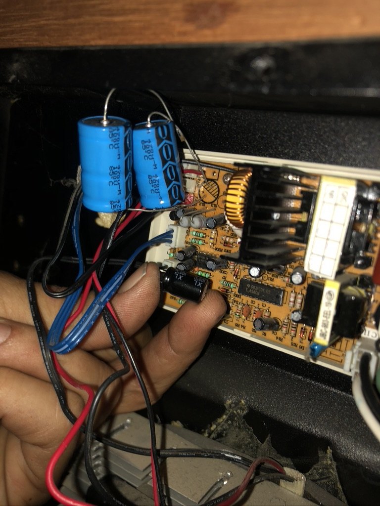

superhawk996 Posted February 23, 2022 Posted February 23, 2022 The toughest part of throwing some stupid old thing away is knowing that you'll need it within a week. I sorta hate my clutter/hoarding, but building a trailer hitch last week without a single run for metal, hardware, or tools was nice. Fixing the wine fridge last night wouldn't have happened if I didn't have a pile of electronic parts. I might not have bothered to pull the board out if I didn't feel I had a reasonable chance of having whatever part it needed on hand. While I didn't have the right capacitor, I had two that were up to the task when paired up. You can't even tell that it was worked on by a hack 😁 1 Quote
superhawk996 Posted February 23, 2022 Posted February 23, 2022 I learned that the internet accepted test for a capacitor using an ohm meter isn't foolproof. It passed the test but I still had my doubts. I then tested one of the blue ones and it appeared to have more capacitance despite being less than half the rating of the little black one; 470 vs 1000. I put in one 470 and the fridge fired up. I put the second on as a feel good of being close to the original rating. I think the huge size difference is because of the higher voltage rating of the blues, 100v. vs. 16v. Maybe they use different guts as well. Quote
