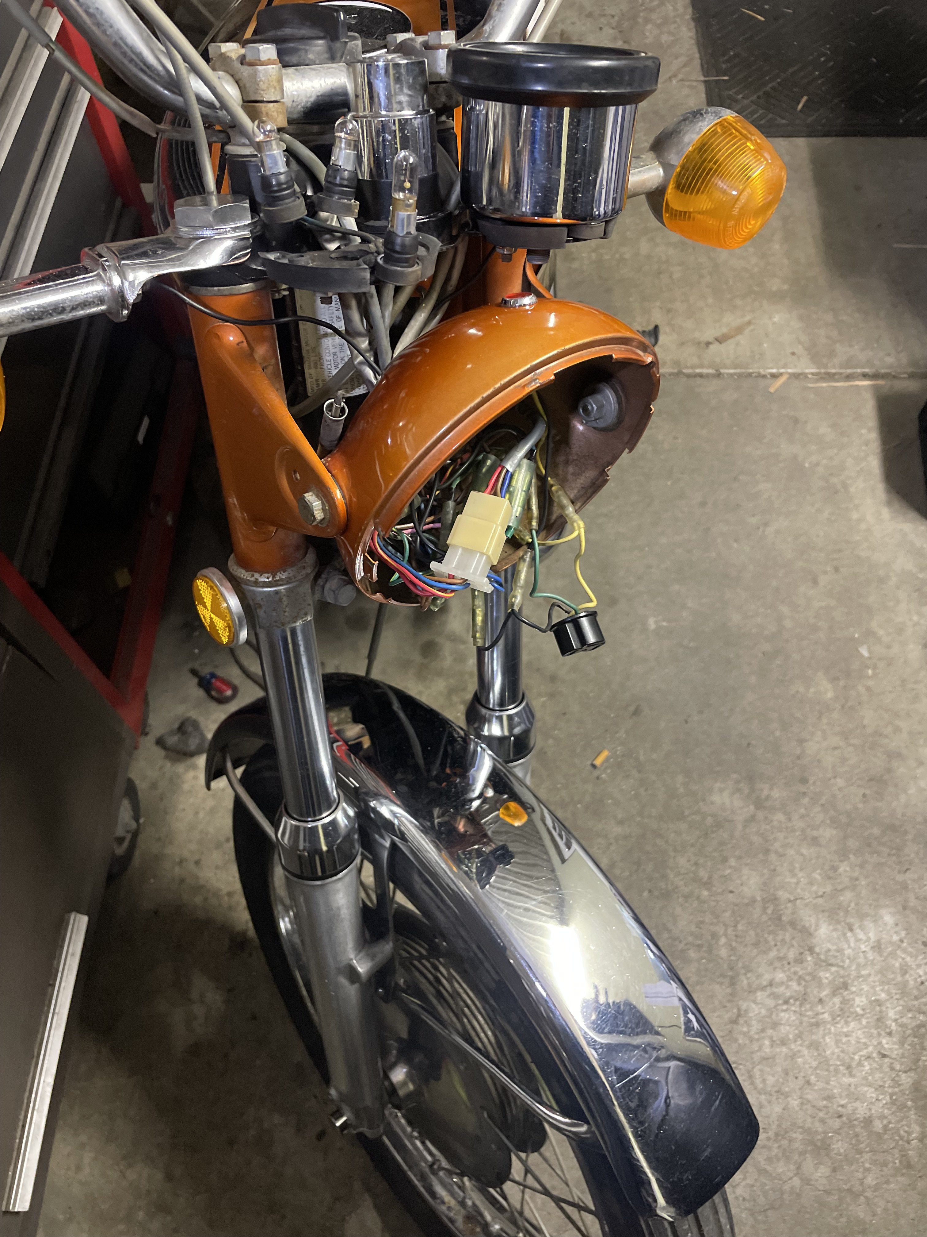

Today I got sucked into the rabbit hole.  I just wanted to clean the bracket for the instruments and the cables behind it.  Next thing I know, the ignition switch is laying on the bench disassembled.  The upper part of the switch is chrome, that got polished.  The lower half is painted and was shitty so it got sprayed.  The insides got cleaned and lubed.
Not a great photo, the switch is partially hidden behind the bulbs.

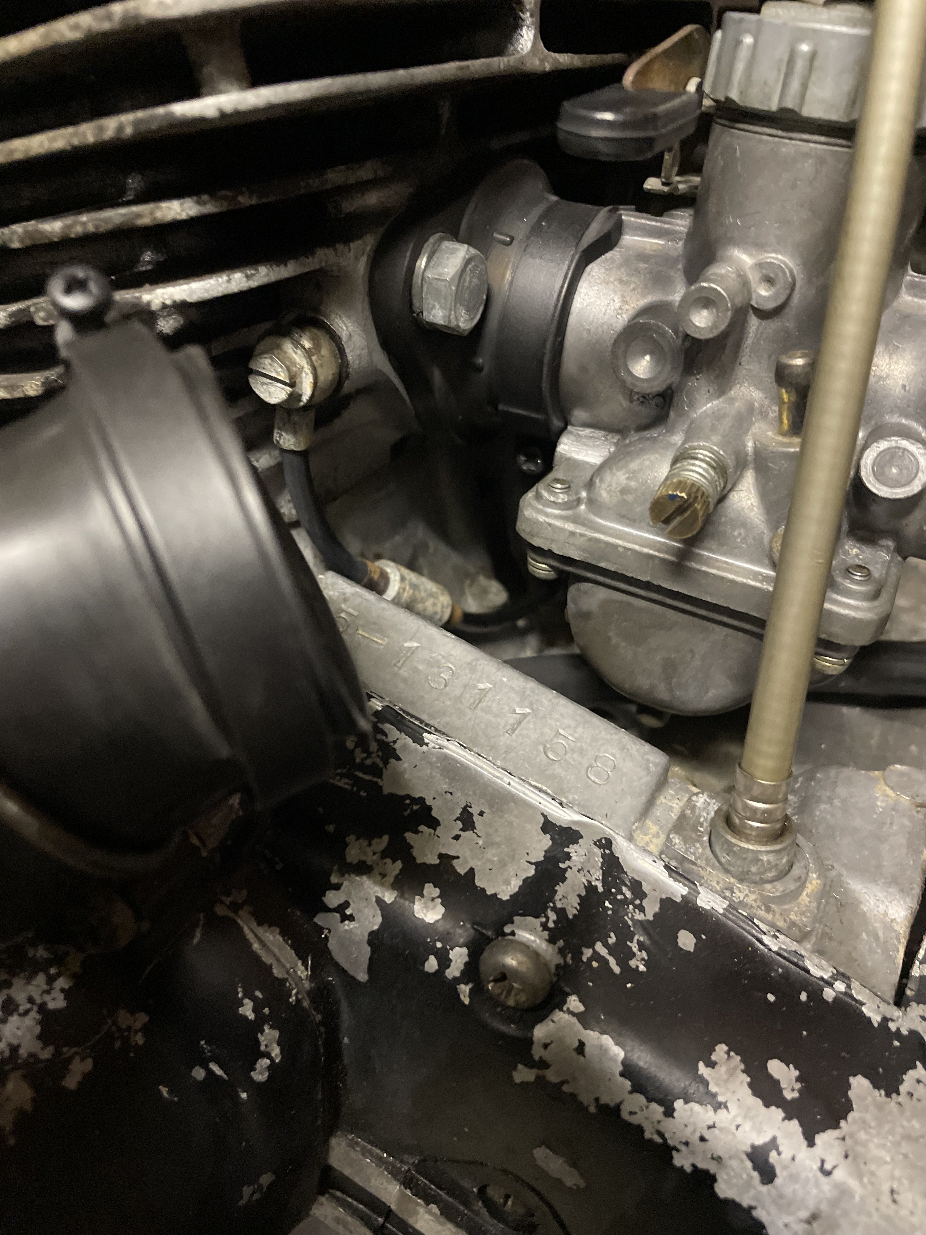

 The carb boot clamps were pretty ugly so I tumble polished the crust off and painted them.

I replaced the instrument illumination bulbs, one was burnt out and the other was missing, kinda odd.  I searched long and hard for the right ones, it was a chore, but I finally found some that were supposed to be the correct wattage but with a different globe.  Miss-advertised bullshitshit, they were 4watt, not the proper 3w, not having it.  Then I remembered about my 4th bulb stash box and there they were, 2 of the right wattage and size/shape.

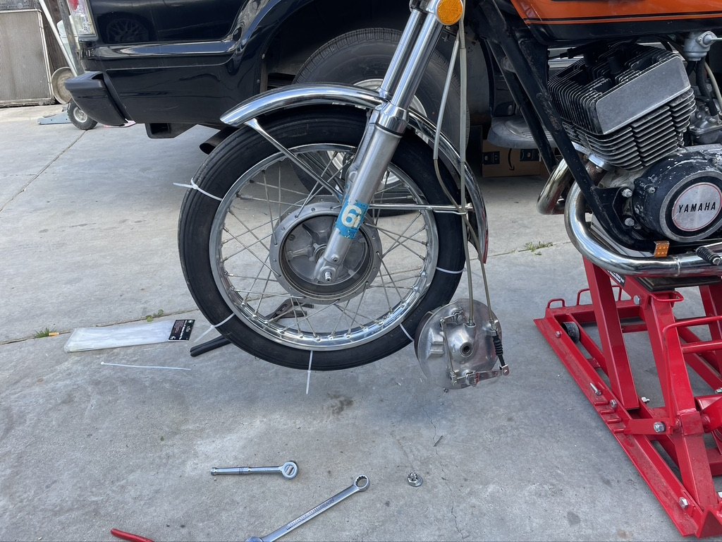

Zipties were a fail.  The recess in these wheels barely accommodates one bead, both together is an absolute no go so I cut the ties off and went traditional.  Holy fuck that was a battle.  Even when there was only about a foot of tire bead under the wheel I still had to use tools to keep prying to get it the rest of the way off, insane.  I got the front tire off and pondered how much worse the rear would probably be, at that point I said fuck it and took them to a shop, but the guy was out.  After waiting for over 1/2 hour I went back home and figured I'd just work on de-rusting the rear wheel.
It would be easiest to work on it mounted to the forks, but it would't fit with the tire on so I decided to have a go at removing it, way worse than the front.  I was finally able to get one spoonful of bead pried over the wheel, no way to get another in.  I held it and used a die grinder to cut through the tire bead, then it was only a 'normal' battle of stretching it over the wheel.  The rear rim was super rusty, some of the chrome is gone, but it cleaned up reasonably well.

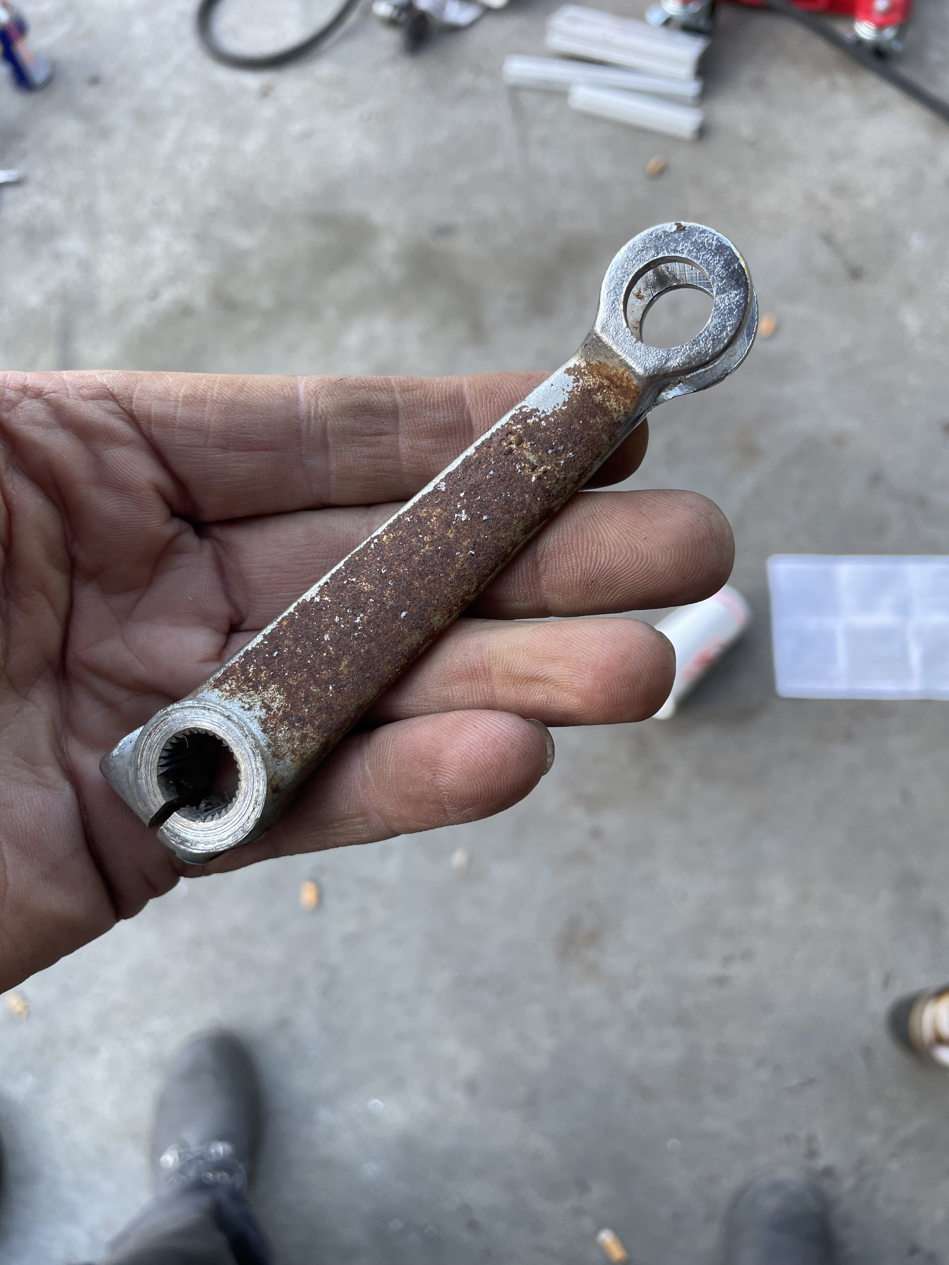

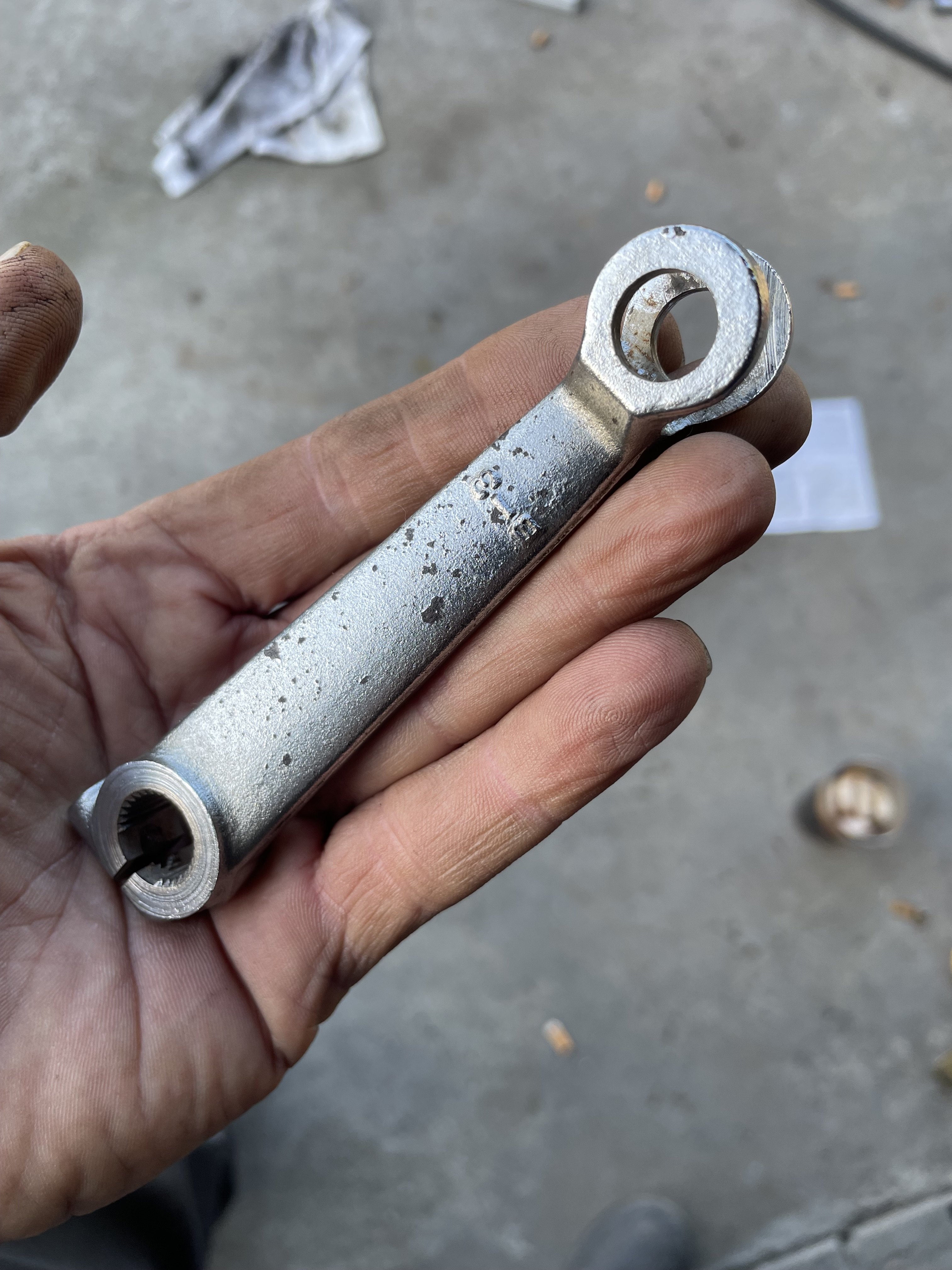

 I didn't take photos of the wheel, but here's the rear brake lever.  I had already done the ends when I thought to take the before photo.  If I decide to make it better I'll dab some chrome paint on the bare spots to hide them better, but it's vastly improved.  It took about 5 minutes, most of the work was done with a fine wire wheel on the bench grinder.  I wish I'd tried wire wheels sooner, it does a great job and does't scratch up the chrome as long as it's fine wire.  I used two different ones on the rear rim being driven by a cordless drill and die grinder.  I had a small one that was able to fit between the spokes fairly well.
I don't know about your R5 but new replacement parts like your brake lever were available for my CL and wasn't priced too high.
There are several parts I've restored that are still available.  A couple negatives on new stuff, cost and they'll stand out.  I've mostly gotten over the "stand out" issue as everything becomes nicer.  Cost: If I were to only replace everything that's available I'd probably be thousands of dollars in, and many more hours or dollars for labor.  The rims and spokes can be replaced, not a whole lotta money, but a fair bit of work that I've never done before.  I spent less time cleaning the brake lever than I'd spend trying to find a new one.
There's also the satisfaction of restoring stuff and keeping the bike original.

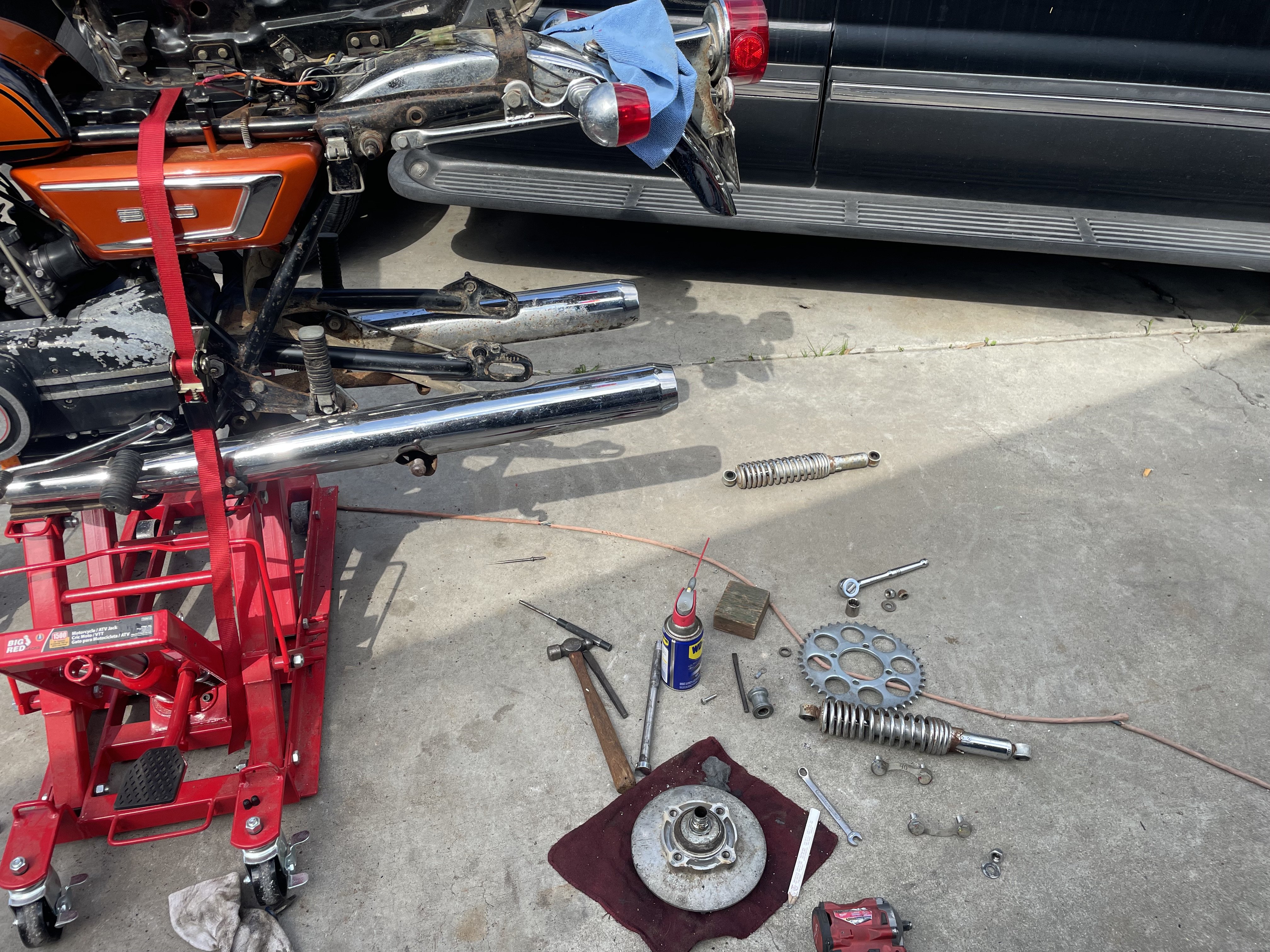

Since the rear wheel was off I might as well tidy things up a little, a few hours later there's probably a couple more to go.  The chain spent the day in the ultrasonic being moved around every 8-10 minutes.  It only effectively cleans right around the transducer, I think because it's so heavy, and so grungy.  While it was being cleaned I pulled and cleaned the chainguard, sprocket, etc.  Got the inboard sides of the mufflers, the swingarm, and other stuff that'll be a bitch with the wheel on.
The sprocket carrier is being stubborn, it might need to be sanded and then polished to be nice, but I'll probably not go that far for now.  The brake carrier will probably be about the same.  The aluminum is spotty and darkened; I tried steel wool, a fine wire wheel, aggressive compound, and the discoloration is still there.  But they're cleaner and smooth.
The left case cover will have to come off to install the chain so I'll probably give it a squirt of black paint to de-ugly it some.
