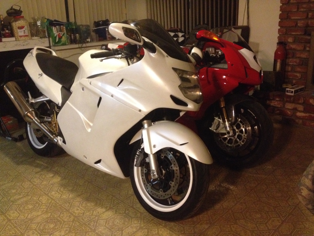

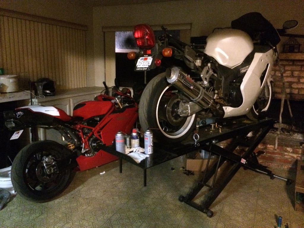

  2. He lied. NOBODY keeps a bike in their living room. 🙂 The second photo was probably during the connector fix. I don't think I took a photo of the connector. It's in the same area as the earlier bikes. IIRC there's a bit of a lump in the harness where the connector is. If the bike has been kept dry and you plan to continue that it might be ok to ignore the connector. Mine showed signs of being left outside a fair bit, enough to fade the frame paint. Lemme make sure I've got this right so far: Your pump works when you put jumper leads to it, the connector shows power when it's disconnected from the pump and you turn the key on, and the connector has a seemingly good ground connection. Either the connector isn't making good contact to the pump (less likely) or there's a resistance in the power or ground to the connector, more likely. I don't remember if the connector lets you put a meter into the back side to test for power while plugged into the pump. It might have a cap you can take off to get access. If it does let you, put both meter leads on it and cycle the key. If it shows reduced power then individually probe the + and - while putting the other meter lead to the appropriate battery post and that'll let you see if it's the + or - that's not getting to the pump so you know which one to chase. If the connector doesn't let you probe it disconnect it and connect it to a load. Jumpers to the pump, or connect it to a headlight bulb if you have one, or something that'll put a load on the circuit and allow you to put the meter to it under load. Maybe before doing all that: if there's another relay that's the same as the pump relay, swap it and see if that gets the pump to prime. A relay can work and have a shitty contact with high resistance. Before continuing on checking stuff, disconnect the vacuum line from the fuel pressure regulator to see if any gas comes from it when you prime the pump, if so, leave it off for now. The regulator seems to not like sitting around and will often start leaking shortly after seeing use again which will flood that cylinder with gas, I think it goes to #3. Plan on replacing it, I think it's worth the peace of mind. I think mine was already leaking slightly when I got the bike and didn't take long to start having problems because of it. I've read of some hydrolocking the motor because of it.
