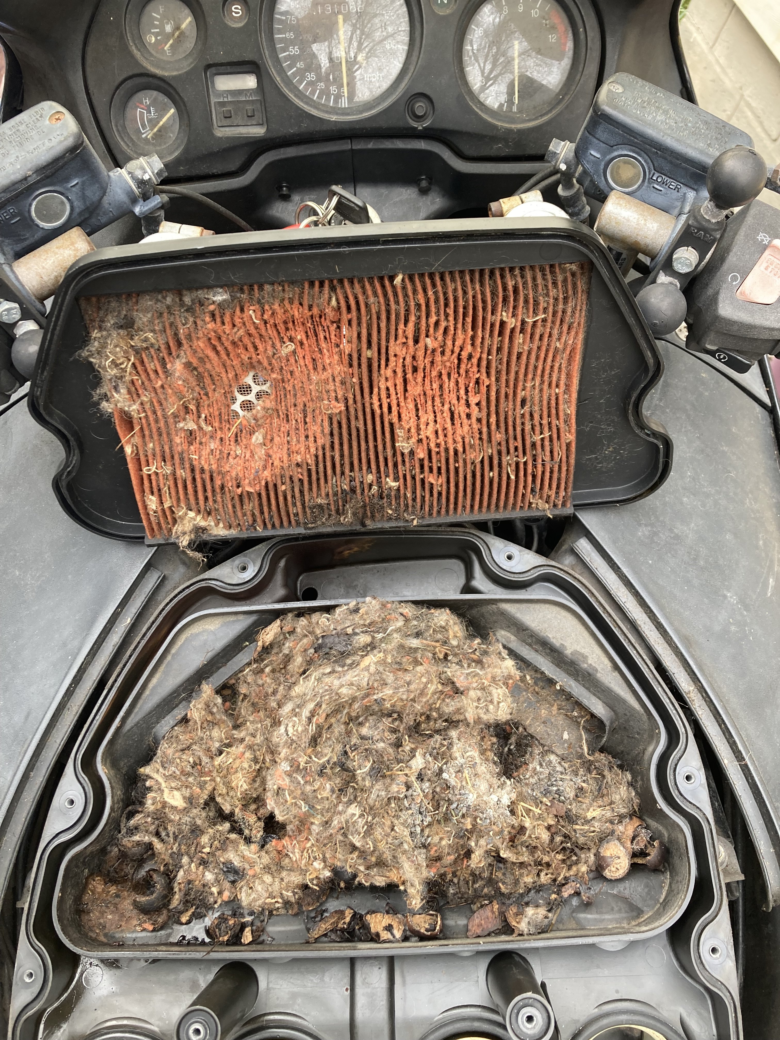

  1. So getting back into my rough running bird. Picked up an ICM from Joe recently thinking that might be the problem. Looking for the easy fix. Somewhere Joe said he didn t think that was the issue but humored me anyway. Plugged the "new" ICM in. Same issue. You were correct Joe. Now on to more detailed inspection of the carbs. Anything in particular I should be looking for. A little info. When starting at full choke runs rough. When warmed up a bit idles smooth. As soon as throttle is applied runs rough till high rpm. the statement about high RPM may not be accurate. Its just the way the engine sounds.

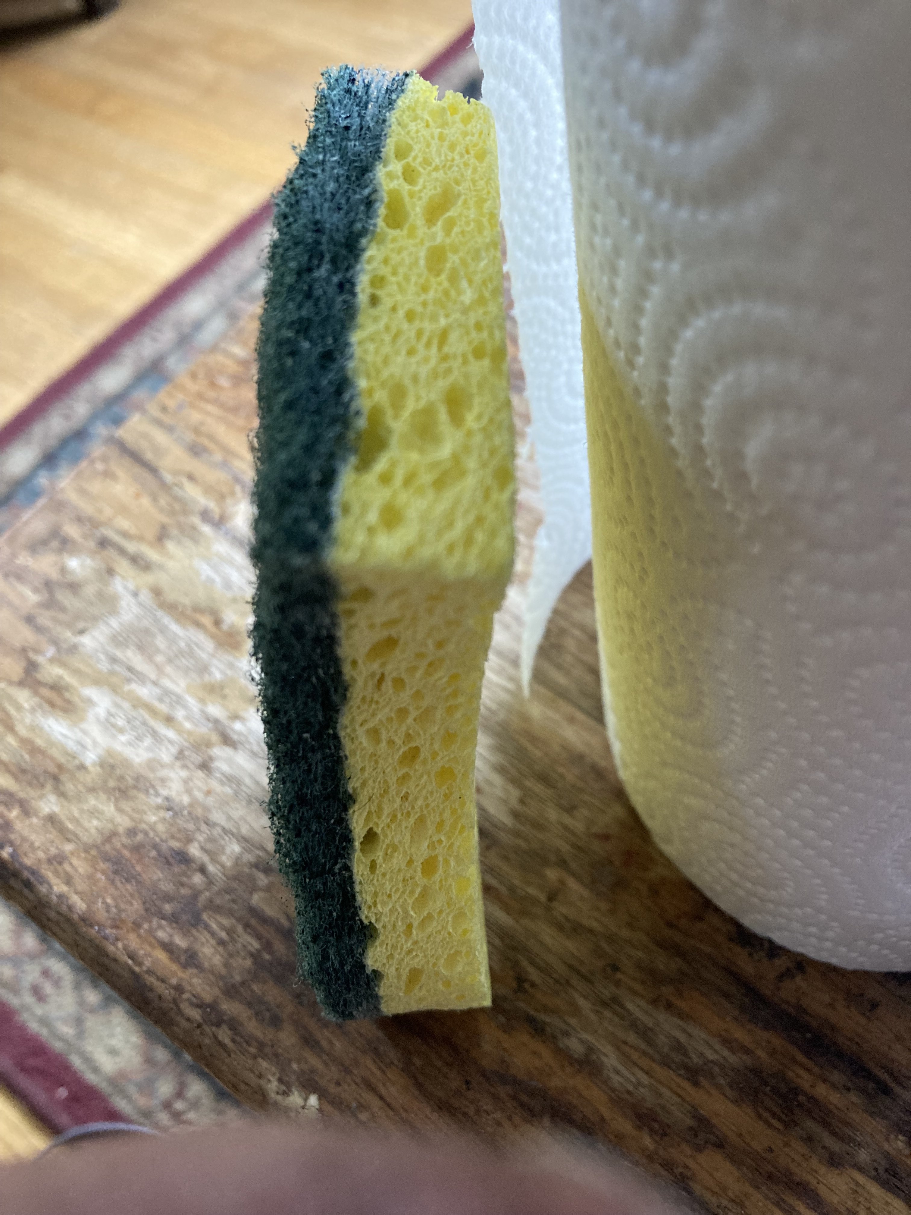

  2. Its the green material. Air passes through easily.
  3. Acorns. It lives in a shed during the winter months. Covered in the driveway otherwise. The shed is not as buttoned up as it could be.

  6. I bought a K&N. $30 more but it’s being delivered tomorrow morning by Amazon. The little spongy breather filter I’m gonna make myself. Going to cut the yellow part off one of these kitchen sponges and use the green Part and cut it to size.
  7. Also what material are you guys using to replace 17254-MAT-000. Discontinued.
