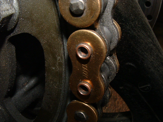

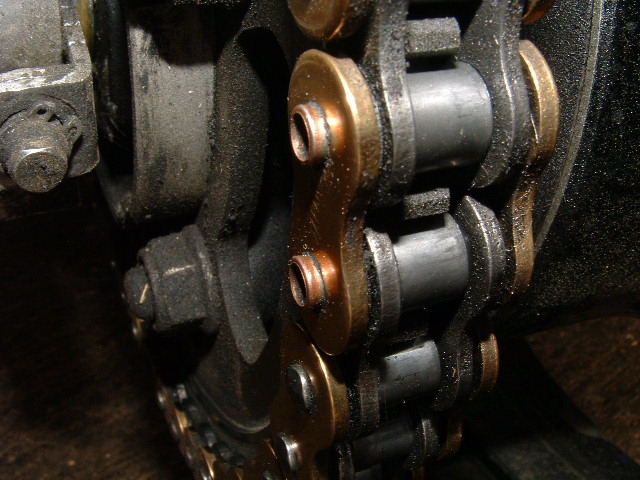

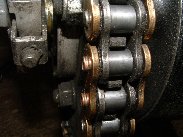

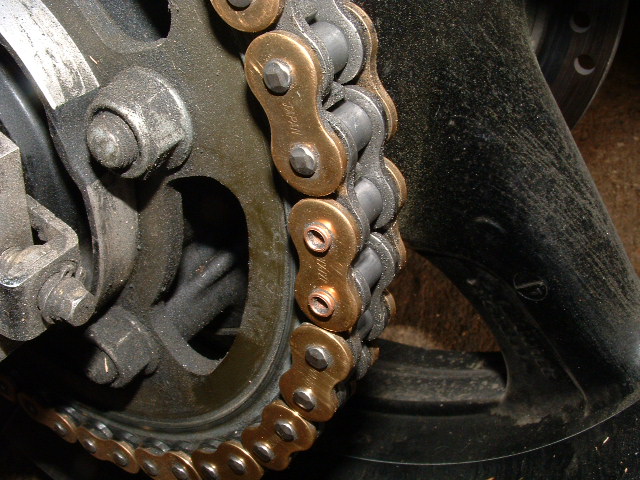

RXX Posted March 30, 2007 Posted March 30, 2007 Doug had a buddy replace his chain a few weeks ago, using what sounds like a ball peen hammer on his master link. Doug is concerned that they were not mushroomed enough. I promised him pics of mine, done with one of those pro-motion (or motion-pro, I do not remember which) tools. Would you gurus comment on whether I should tighten down more, or is it OK? Then Doug can decide what to do concerning his. And of course, if mine is too lean, I will compress more. If anyone has pics of a proper brad, please share! Thanks Quote
EVLXX Posted March 30, 2007 Posted March 30, 2007 From what I can tell... it looks good. Although you never to a straight on from the rear pic. So if you look at it from the rear, and you see that all the side plates line up together, you're good to go. You got me scared, about the ball-peen hammer thing though..... Glad I'm not Doug. IF he's your friend, maybe you should offer to fix it for him.... useing the propper tools. Quote
rockmeupto125 Posted March 30, 2007 Posted March 30, 2007 I can only tell you that if that were mine, I'd put the tool back on and flare it more. Quote
jcrich Posted March 30, 2007 Posted March 30, 2007 I can only tell you that if that were mine, I'd put the tool back on and flare it more. +1 I just checked both of my bikes and mine are both a bit more flared than that. Quote

rockmeupto125 Posted March 30, 2007 Posted March 30, 2007 I don't know what brand of chain that is, although its easy to assume its a DID. You should use the spec sheet that came with the chain as far as how much to compress/flare the rivet link. The DID chain supplied with the XX originally is not the same chain you buy aftermarket, and therefore the specs in the service manual will not apply. They may be the similar (after all, how many different ways can you make the same size link chain), but I can tell you that the masterlinks of the FACTORY DID chain and the AFTERMARKET DID chain have different sized link posts, and its reasonable to assume they may not meet the same spec for flaring. Quote
airborneXX Posted March 30, 2007 Posted March 30, 2007 I don't know what brand of chain that is, although its easy to assume its a DID. You should use the spec sheet that came with the chain as far as how much to compress/flare the rivet link. The DID chain supplied with the XX originally is not the same chain you buy aftermarket, and therefore the specs in the service manual will not apply. They may be the similar (after all, how many different ways can you make the same size link chain), but I can tell you that the masterlinks of the FACTORY DID chain and the AFTERMARKET DID chain have different sized link posts, and its reasonable to assume they may not meet the same spec for flaring. Could that be why Honda allowed such a broad range in the spec? I totally agree with using the chain manufacturers specs if they are available. When staking the pins you also have to go by feel. It can be very easy to press the plate on too much or stake the pins too much and bind the link, and still be within the specs. When I put my RK chain on last year, I set it to the middle of the Honda spec. So far so good, YMMV. Quote
rockmeupto125 Posted March 30, 2007 Posted March 30, 2007 Any machine work has an acceptable range....this would be no different. The spec sheet is usually in the bag with the master link and grease. Quote
RXX Posted March 30, 2007 Author Posted March 30, 2007 If I recall, I flared until the link got "sticky" in relation to its neighbor. I didn't have the concept of specs in mind. In hindsight, the stickyness may have been virginal. Anyway, I am going to rectify it tonight or tomorrow. Quote

rockmeupto125 Posted March 31, 2007 Posted March 31, 2007 If I recall, I flared until the link got "sticky" in relation to its neighbor. I didn't have the concept of specs in mind. In hindsight, the stickyness may have been virginal. Anyway, I am going to rectify it tonight or tomorrow. That really doesn't sound right. Flaring the pins shouldn't push the sideplate onto the link. Think of an axe head on its handle. You put the axe head over the shaved end of the handle, then you drive the wedge(s) into the end of the handle. That locks the axe head in place....it doesn't force the axe head further down on the handle. Its not exactly the same mechanism, but its the same concept. Expanding the pin on your chain link should not be moving the link...it should only hold it tighter and prevent it from coming off. The sideplate is supposed to be pressed on with a tool because it is intended to be tight enough just like that. Staking the pins is insurance that the continued motion of the chain doesn't work the link free. Probably any flaring would be adequate to the task, but the idea is that with a slight flare like yours, the angle that the pin metal makes in relationship to the sideplate is minimal, and the sideplate would theoretically take much less power to work its way slowly up that shallow angle, whereas a "properly" staked pin has a near 90 degree angle which any forces acting to remove the sideplate would have to overcome...and it would be easier to actually break the pin. The folks making these chains are smarter than me and have more experience with how they work, so I'm inclined to take there suggestions on how to install them. Hope this makes some sense....I'm only on my first pot of coffee this morning. Quote

oldgeezer Posted April 9, 2007 Posted April 9, 2007 Here's what the Honda manual says... Diameter of the staked pin DID 5.50-5.80 mm I went with the DID chain, and yesterday managed to borrow a slide caliper to check the staked diameter. One pin is 5.30 mm and the other was even smaller (I only checked the larger pin). Hmm. My mechanic/friend has worked on Hondas for 30years but damn, I'm no longer convinced that good mechanics can't make a mistakes. While 5.3 mm MIGHT be OK, it's less the the Honda minimum of 5.50 mm. Shit. I'm gonna get the proper tool and do it myself. Jeeze. I guess the old adage is true, "if you want it done right, do it yourself". Quote
RichardCranium Posted April 10, 2007 Posted April 10, 2007 While that master could probably stand to be staked a bit more...if you have ever removed a chain you know how hard they are to get off (not counting just chopping it in half with a grinder). I'd say that its probably on there much better than you think. If money was no object it would be interesting to see if you could even pry that bastard off of there without grinding the pins down. Quote
