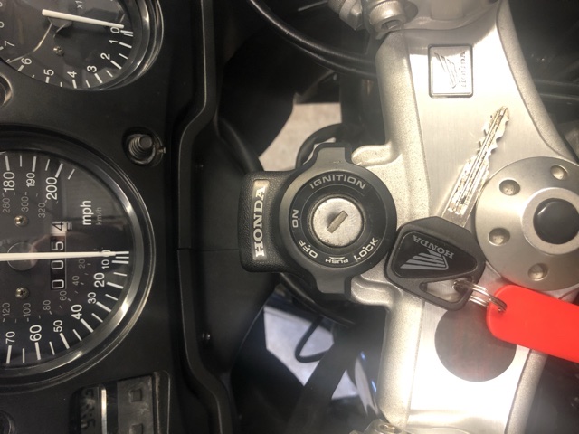

I've just picked up a Blackbird, 1999 9,600 mile on her, FSH 1 owner,
I think the ECU is on the way out as now and again im getting code 25 with the Side stand down.
SO im looking for a ECU but don't know if my bike has HISS or not? It doesn't have HISS on the Ignition key surround just says HONDA

Key symbol on the dash is HISS, yes.  As far as code 25, or knock sensor, it won't be the knock sensor. This is a not uncommon malady of the analog dash FI bikes.
