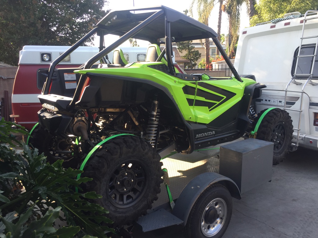

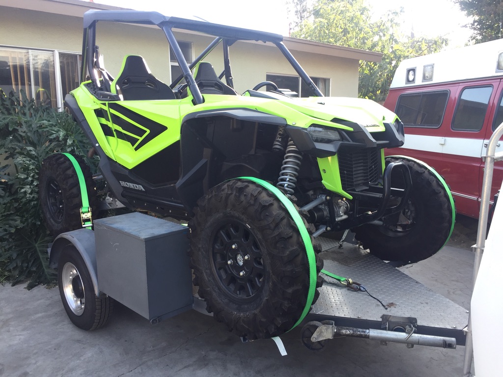

superhawk996 Posted October 14, 2020 Author Posted October 14, 2020 5,400lbs working load, 20k lbs breaking strength, and cheap enough to triple up. The ones I bought are 3,333/10k, plenty for a sub 1,500lb toy. One over each tire pulling down and two underneath holding forward/rearward. Comfortable over kill. One tire strap alone made it impossible to move by hand. It might go out this weekend. It's still not registered so I'm debating it, but there's never law enforcement where I'm going; the shooting area we went to. It needs a CHP inspection to finish the transfer/registration process and the earliest I could get was Dec 1. Had I known before going into the process I woulda dug deeper into titling it in AZ, but they wanted some inspections also and I wasn't sure how long it would take to get done. In CA it appeared that it was going to be a quick process, after doing all the papers and paying I got the surprise. Quote

superhawk996 Posted October 17, 2020 Author Posted October 17, 2020 If only your Jeep had a bed... Talon loaded up. The trailer was originally a 4 place dirtbike trailer, converted to a 2 big bike trailer, now a UTV trailer. The car is wider than the side boxes and I wanted to keep them so I modded them to slide out far enough to clear. It had a long bike ramp that I cut in half then made spots for them to hook onto the trailer. They store under the deck next to where they attach for loading/unloading, slide them out and hook into place. I had to add 'extensions' for the front tires to sit on and the rear tires are about centered over the rear beam, it's just barely big enough. Stability is good and there's not too much tongue weight. The trailer is a '76 and I'm almost positive it had original bearings and grease, impressive. \ Quote
