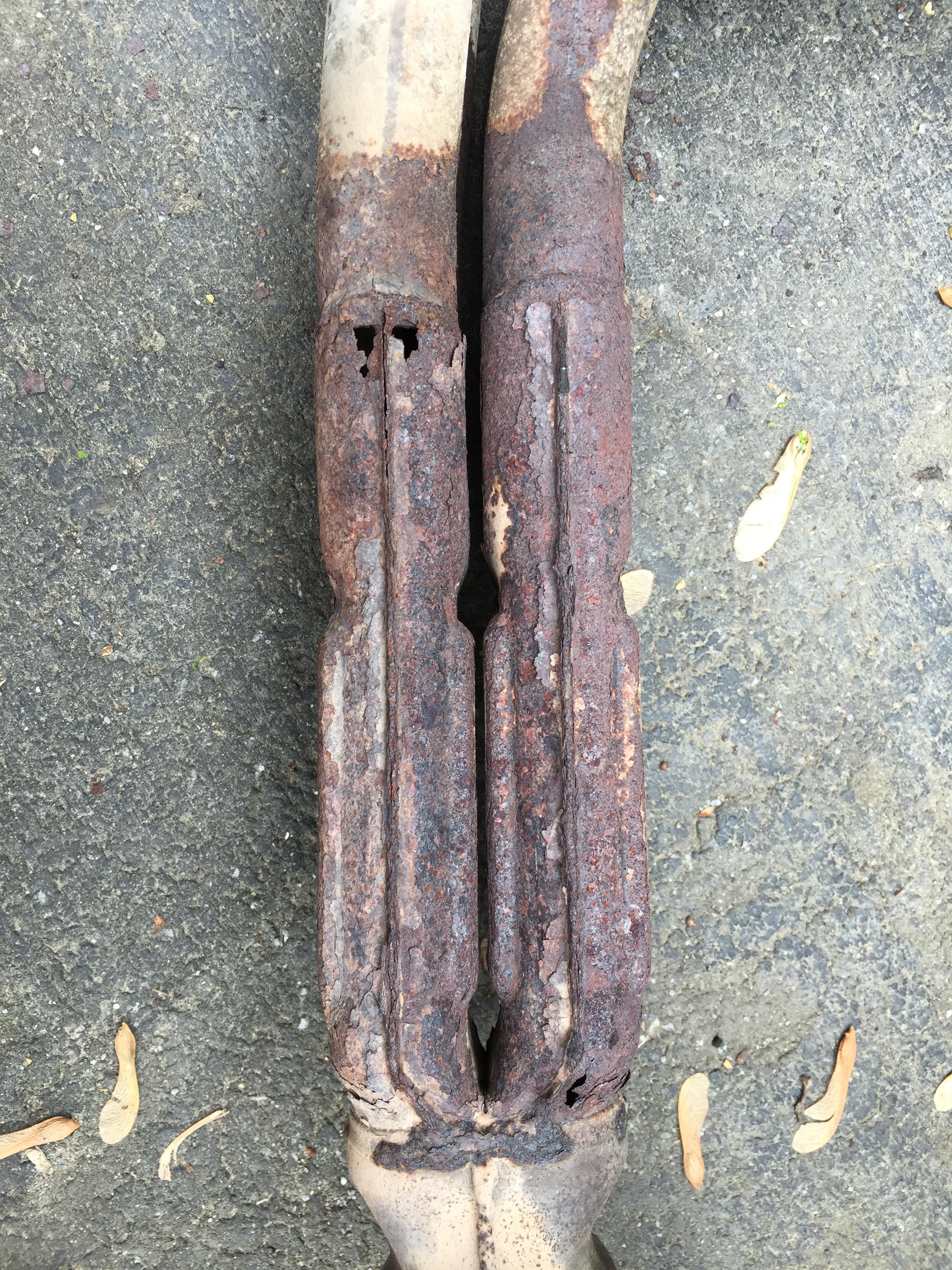

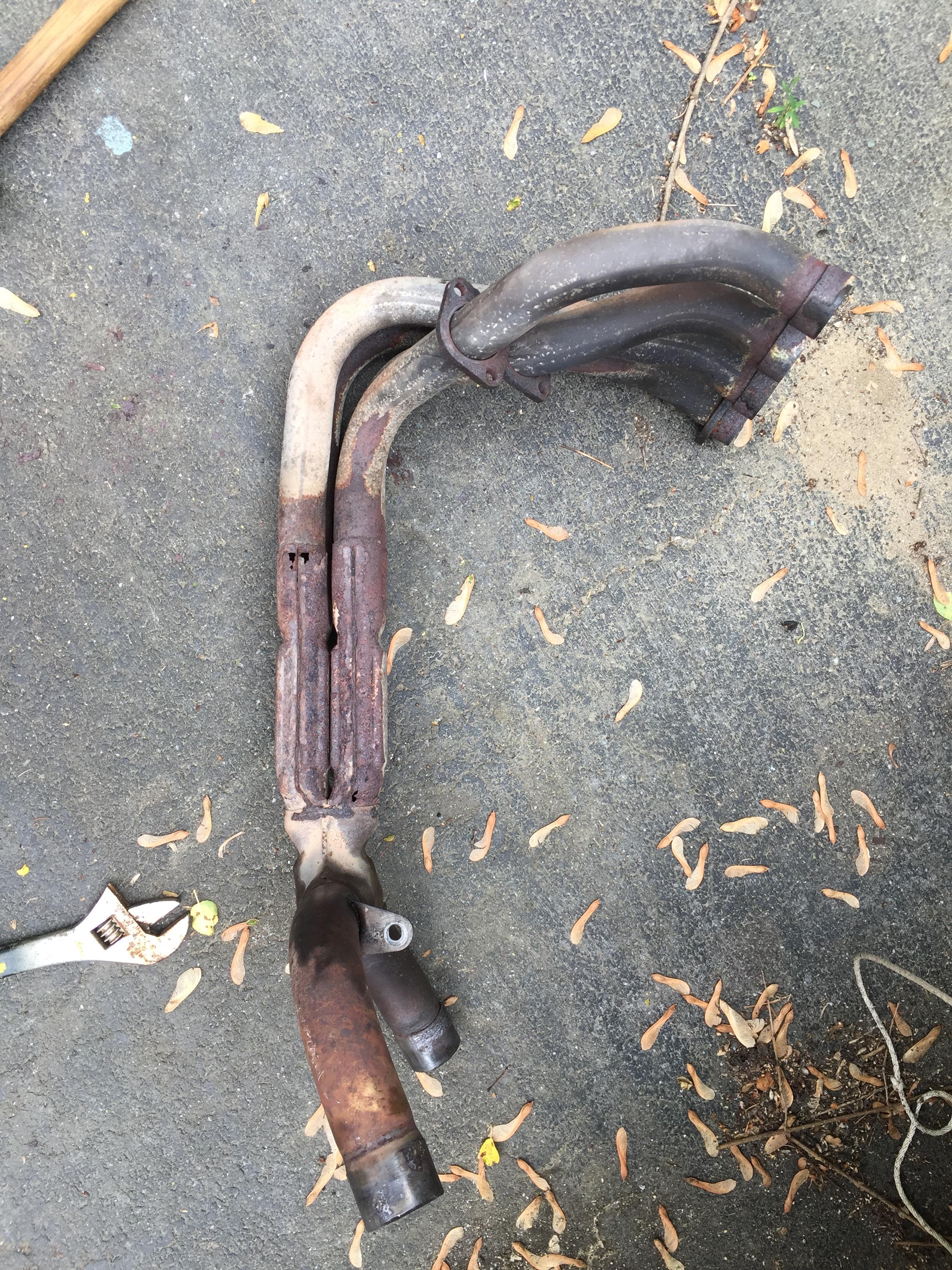

XXitanium Posted June 3, 2018 Posted June 3, 2018 38 minutes ago, Dotetcher said: Pics of the old one. What causes that in your opinion? Do you ride salted roads at all or high miles, or.....? Quote
Dotetcher Posted June 3, 2018 Author Posted June 3, 2018 Both. This bike has close to 130000 miles. Ridden hard. Put away wet. Seriously now. Ridden coast to coast, all times of the year, salted roads and unfortunately salt water a few times. Outer Banks. Rte 12. One road in, on road out....sometimes. 1 Quote

blackhawkxx Posted June 3, 2018 Posted June 3, 2018 That is the worst looking Blackbird header I have ever seen. Quote

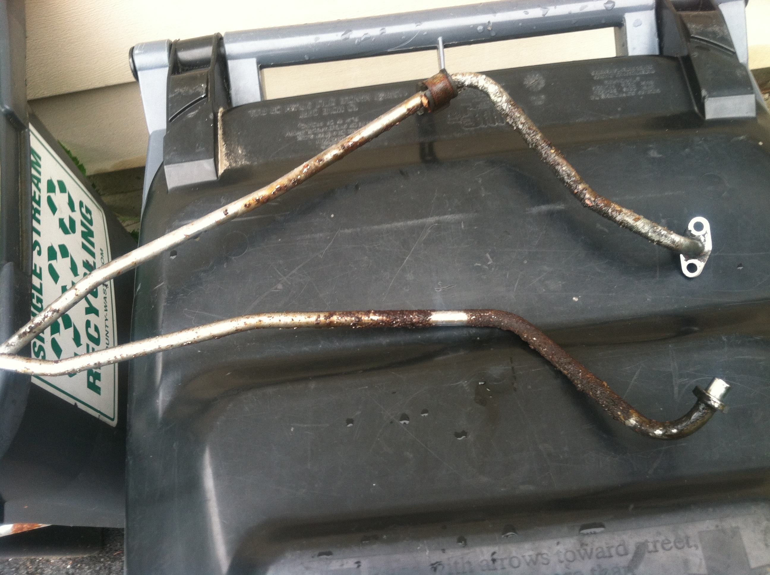

Dotetcher Posted June 3, 2018 Author Posted June 3, 2018 You should have seen the lines to the oil cooler. They went last year. Quote
