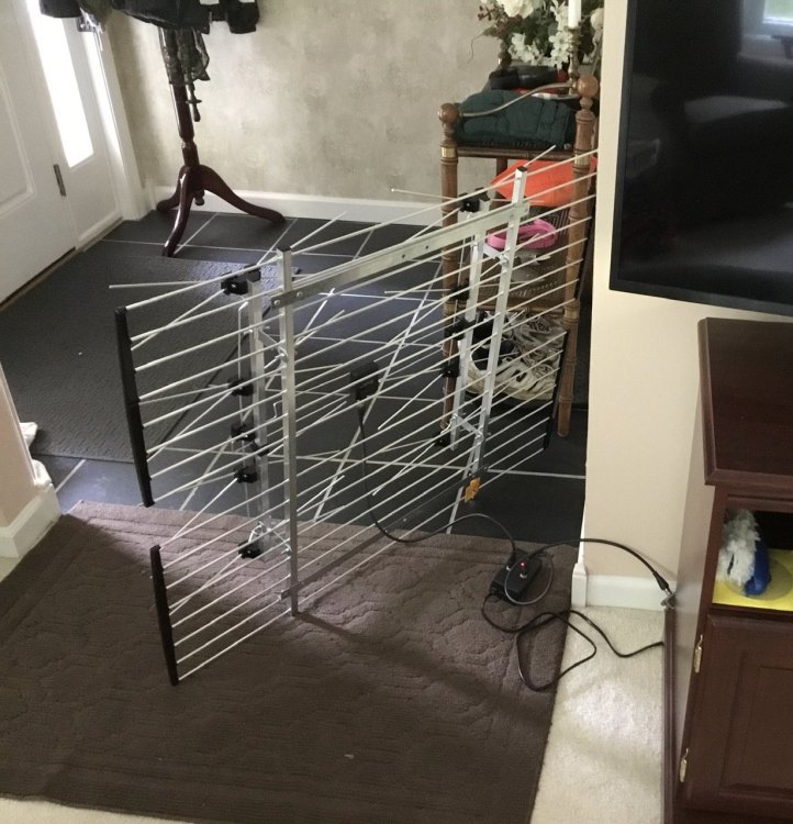

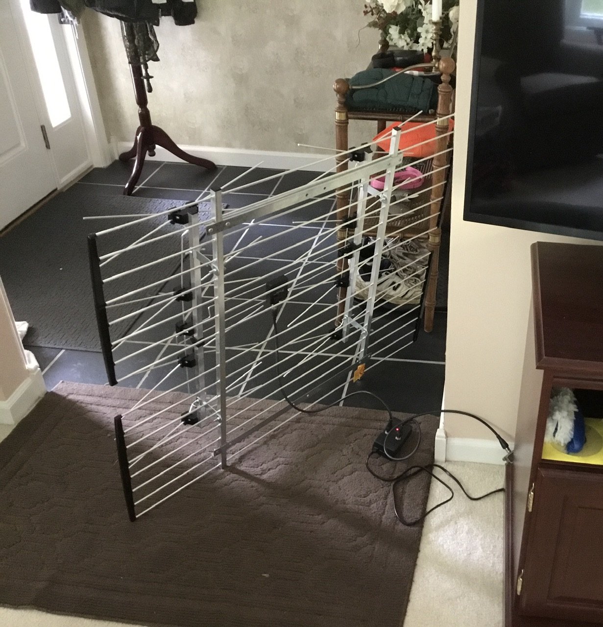

Zero Knievel Posted July 17, 2023 Author Posted July 17, 2023 (edited) Antenna is here. Setting it up in the house, it works well. Considering mounting it in the attic. Any suggestions for what kind of mount to use? Edited July 17, 2023 by Zero Knievel Quote
SwampNut Posted July 17, 2023 Posted July 17, 2023 If nothing else, that is a nicely made antenna. Use whatever mounts make sense to be able to aim it, based on your construction. I will assume you have just plain 2x4 or 2x6 structure in the attic? Should be easy to find a mount that just screws to them or around them, and has 120-160 degrees of motion for aiming. Quote
SwampNut Posted July 17, 2023 Posted July 17, 2023 Oh...polarization matters! Mount it horizontally, not at an angle with the rafters and shit. I've seen that, not good. Well, basically, follow the instructions. Quote
Zero Knievel Posted July 17, 2023 Author Posted July 17, 2023 1 hour ago, SwampNut said: Oh...polarization matters! Mount it horizontally, not at an angle with the rafters and shit. I've seen that, not good. Well, basically, follow the instructions. You mean vertically, right? Horizontal would have it facing up or down. Quote
blackhawkxx Posted July 17, 2023 Posted July 17, 2023 I wonder about the difference between mounting indoors as apposed to outdoor as far as signal strength? Quote
SwampNut Posted July 18, 2023 Posted July 18, 2023 5 hours ago, Zero Knievel said: You mean vertically, right? Horizontal would have it facing up or down. Well, I was thinking of the plane of the top/bottom parts. But again, it will tell you the way to position it in the install guide. Quote

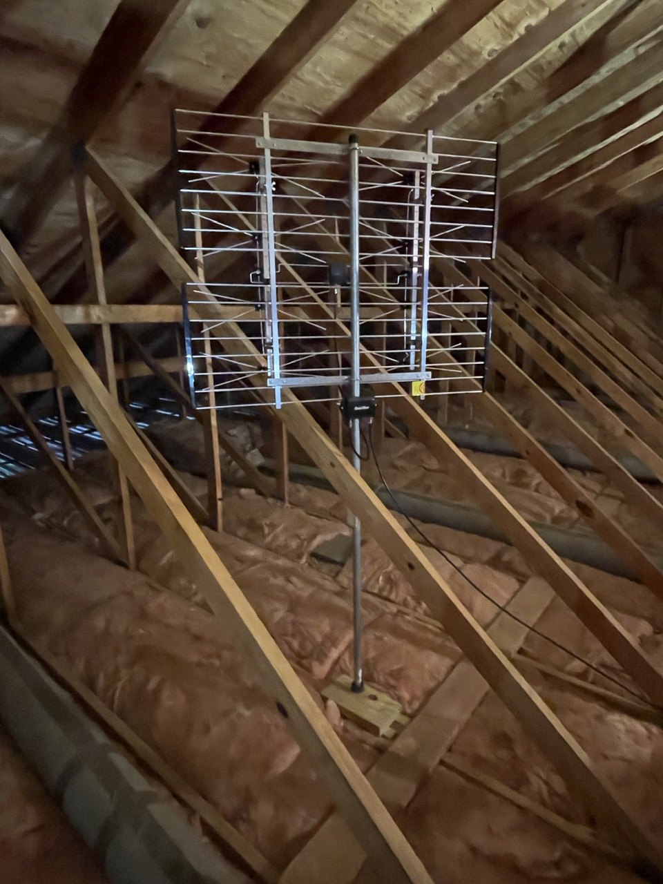

Zero Knievel Posted July 28, 2023 Author Posted July 28, 2023 Finally installed. We get 30 channels now (5, 11, 19, 39 & 68). Took two days in this heat. Got the antenna set up and ran wire through the house to ensure it worked as placed. Today, I ran the wire down the wall to the TV. I was fortunate to get the hole placed correctly on the first try. Quote
