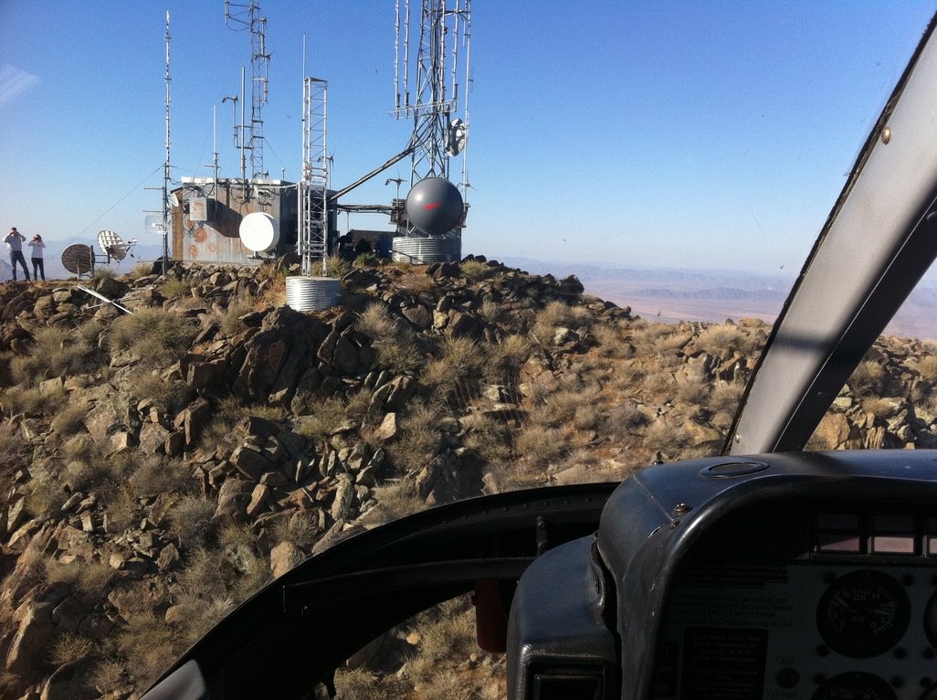

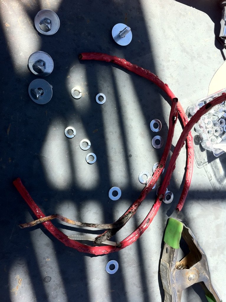

SwampNut Posted July 3 Share Posted July 3 5 minutes ago, superhawk996 said: Expect every single possible fault imaginable, then a few more. This was a fun one. "Nothing else has worked, we should go up the tower and check the dish grounding cable." "Nah, it's like #4 wire, it can't be damaged." Quote Link to comment Share on other sites More sharing options...
blackhawkxx Posted July 3 Share Posted July 3 Lightning strike? Quote Link to comment Share on other sites More sharing options...
SwampNut Posted July 3 Share Posted July 3 5 minutes ago, blackhawkxx said: Lightning strike? We can only assume. There are no lightning detectors up there, for reasons I don't understand (probably dollars). Quote Link to comment Share on other sites More sharing options...
