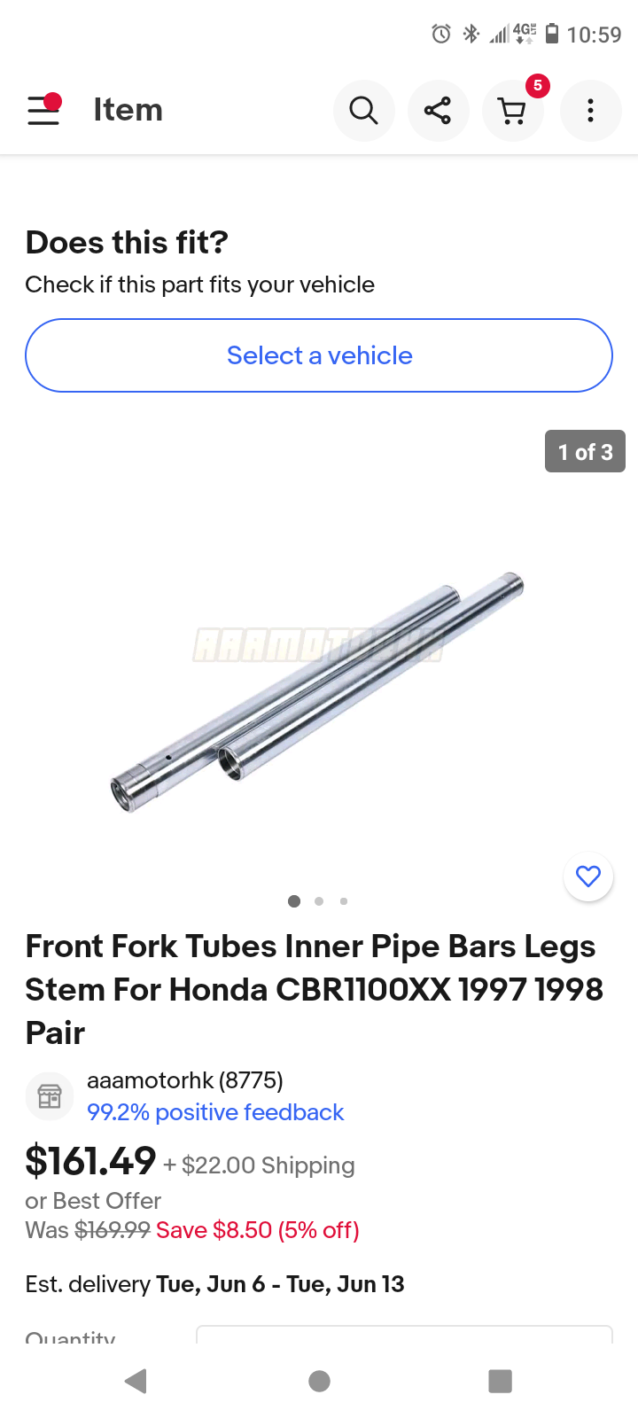

tomek Posted May 19, 2023 Posted May 19, 2023 I got similar problem on my VFR1200f. Aftermarket or OEM seals- same result- there is some weeping. I got closer look at inner tubes and sure enough, vertical scratches. I ordered pair of chinesum inner tubes, we'll see how it goes. Supposedly they are not that horrible. They are available for XX as well. Quote

SR71BLACKBIRDXX Posted May 19, 2023 Author Posted May 19, 2023 Never tried cleaning them. Don't think I've ever had a problem like this other than on a dirt bike. I've got new seals and oil ordered already. So I guess I'll throw them in. I don't mind spending the money on tubes as I'll probably die with this bike. Just boggles my mind that the smallest imperfections would cause a leak. I've owned bikes with 40k+ miles that were perfectly dry. Quote
