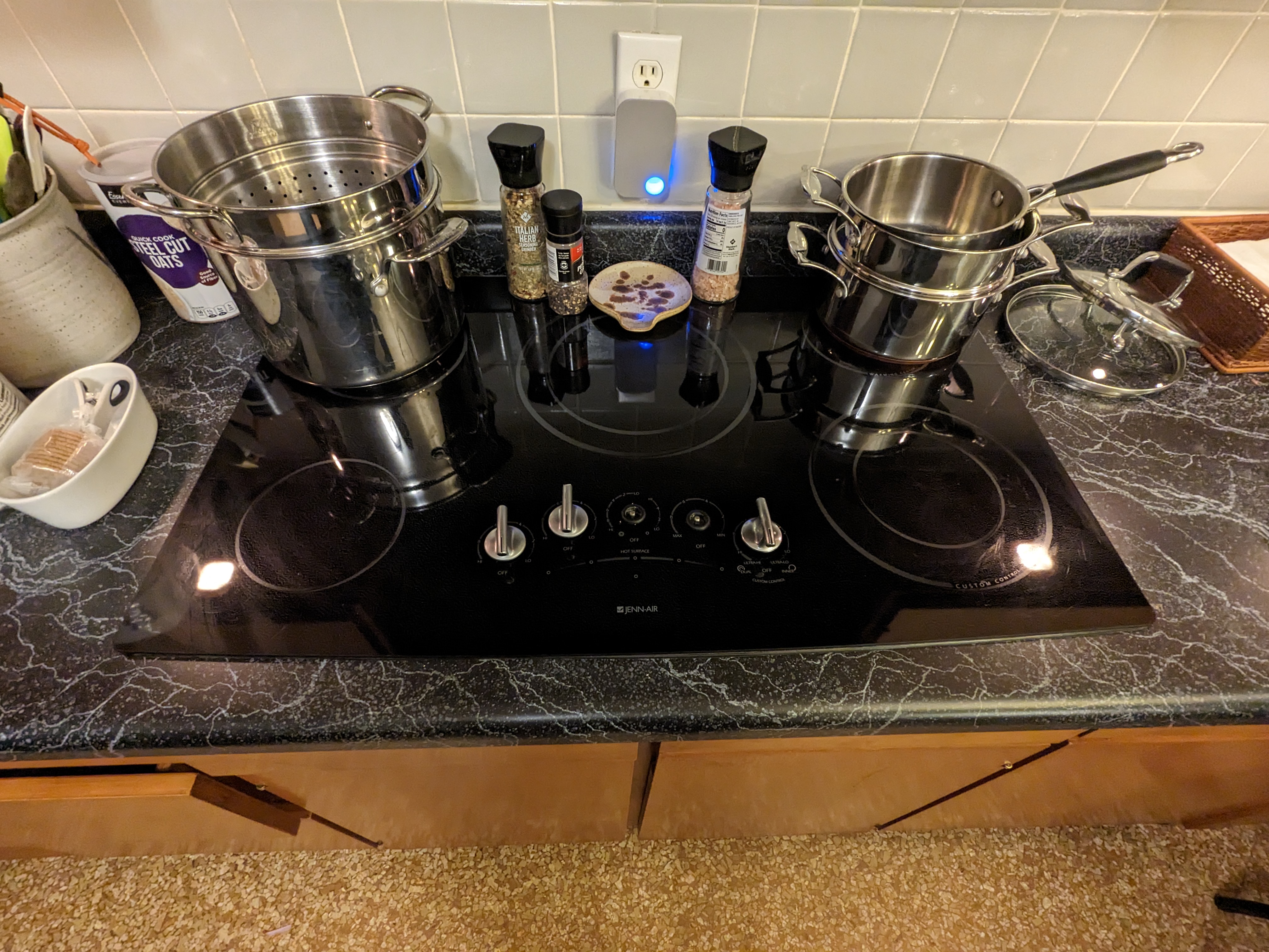

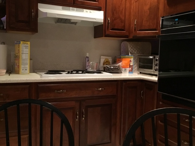

Zero Knievel Posted February 23, 2023 Posted February 23, 2023 The range top sits in the hole cut into the new countertop. It’s larger than needed, so the range top shifts from time to time. Mom doesn’t want to bolt it down in case it ever needs replacement and the replacement’s footprint doesn’t match for holes. I bought some Permatex Clear RTV Silicone. My thought was to apply a dab at the front corners, and when it cures, it will be a strong enough hold to prevent it slipping. I’m concerned about heat, but if the burners emitted that much heat at the countertop level, the range top would be too hot to touch and the counter would melt. Thoughts? If not this, what product would be better? Quote

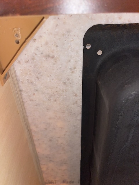

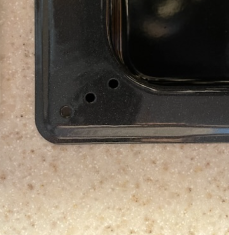

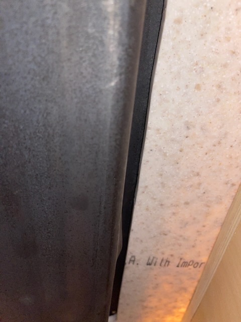

XXitanium Posted February 23, 2023 Posted February 23, 2023 Picture of where the top meets the counter from above and below. You know we like pictures. ...did you replace the windows yet? (Bolt it down when she's not looking or tell her it has to meet NEC code) Quote

XXitanium Posted February 26, 2023 Posted February 26, 2023 Is it just a straight piece of counter, or is there a 90° corner or something even more complicated? Quote

Zero Knievel Posted February 26, 2023 Author Posted February 26, 2023 7 hours ago, XXitanium said: Is it just a straight piece of counter, or is there a 90° corner or something even more complicated? Straight where the cooktop is, but 90 degrees on both ends. Came in 2 parts and had to be glued together. The first one was poorly made and should never have left the factory. Head of QC came out and redid it all (to their credit), but he commented that this happened all the time…installs without a final review by QC before installation…resulting in complete replacements at the company’s cost. 7 hours ago, XXitanium said: How much did they charge you for the countertop? Don’t recall off hand. Not crazy expensive but not cheap. It’s a step up from the fiberboard/laminate basic countertops (original was still in good condition). This is a resin composite. Looks like stone but isn’t. Quote

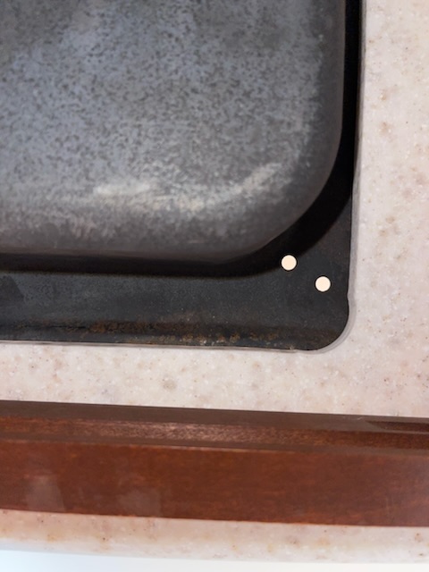

XXitanium Posted February 26, 2023 Posted February 26, 2023 That last close-up shot that you had, is that showing holes go all the way through the top from the bottom and are visible from above? I'm thinking Superhawk996's RTV solution is pretty good at this point. Quote

XXitanium Posted February 26, 2023 Posted February 26, 2023 Are there holes all the way through the top? Quote
Zero Knievel Posted February 26, 2023 Author Posted February 26, 2023 No…that’s the base of the unit…the catch pan for anything that falls through the heating element hole. Lowes and Home Depot understood my situation, but they didn’t have anything in stock that addressed it. Searching inventory wasn’t helpful since unless you know exactly what something is called, you get results for a ton of stuff that’s not what you want. However, I had an idea. Why not make a shim to close the gap? I have lots of scrap wood. Taking measurements, I’m trying to close a 1 1/8” gap in the front and 10/16” gaps on the side. The counter itself is 1/4” thick. If I want to do front and back evenly, that’s a 9/16” gap for front and back. I also noticed that with the exposed holes, I could secure it to the drip pan where the shim and hole aligns. Quote
