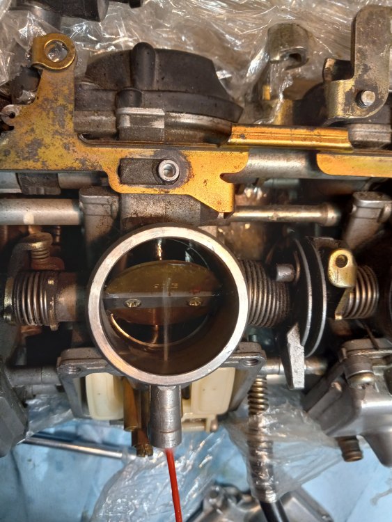

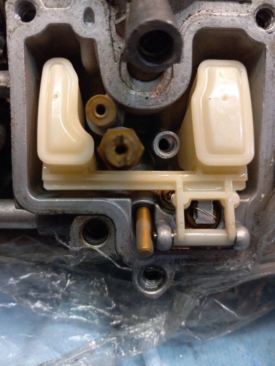

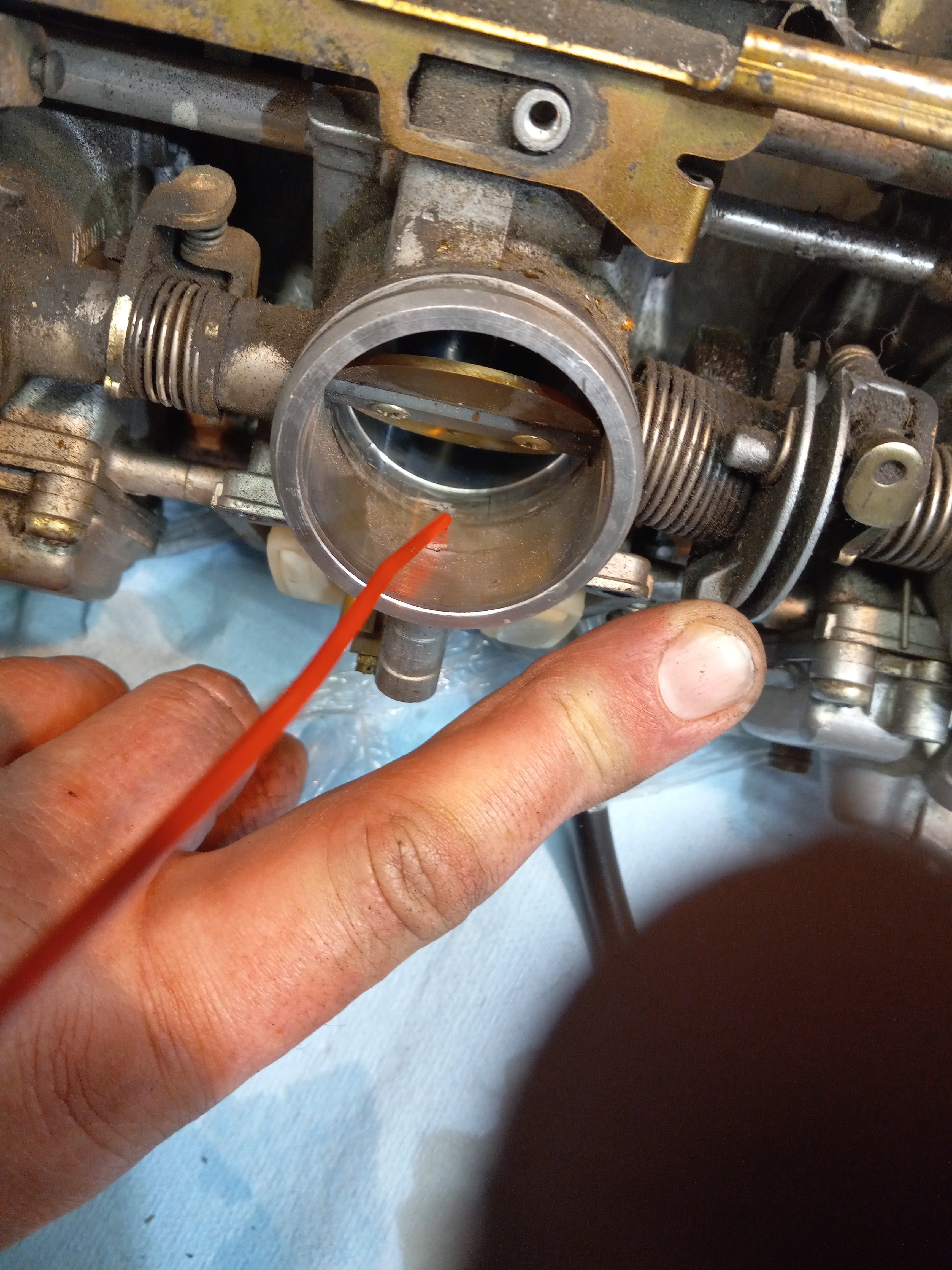

tomek Posted January 16 Share Posted January 16 (edited) I'd try superhawks suggestions first. Many carb bikes do have low pressure fuel pump, and it is possible to fill bowls with fuel by turning key on-off couple of times before cranking the engine, but XX is not one of those. Anyway, pics from Mikuni carbs, should be all about the same. Pics with pilot fuel jet in place and removed. Edited January 16 by tomek Quote Link to comment Share on other sites More sharing options...

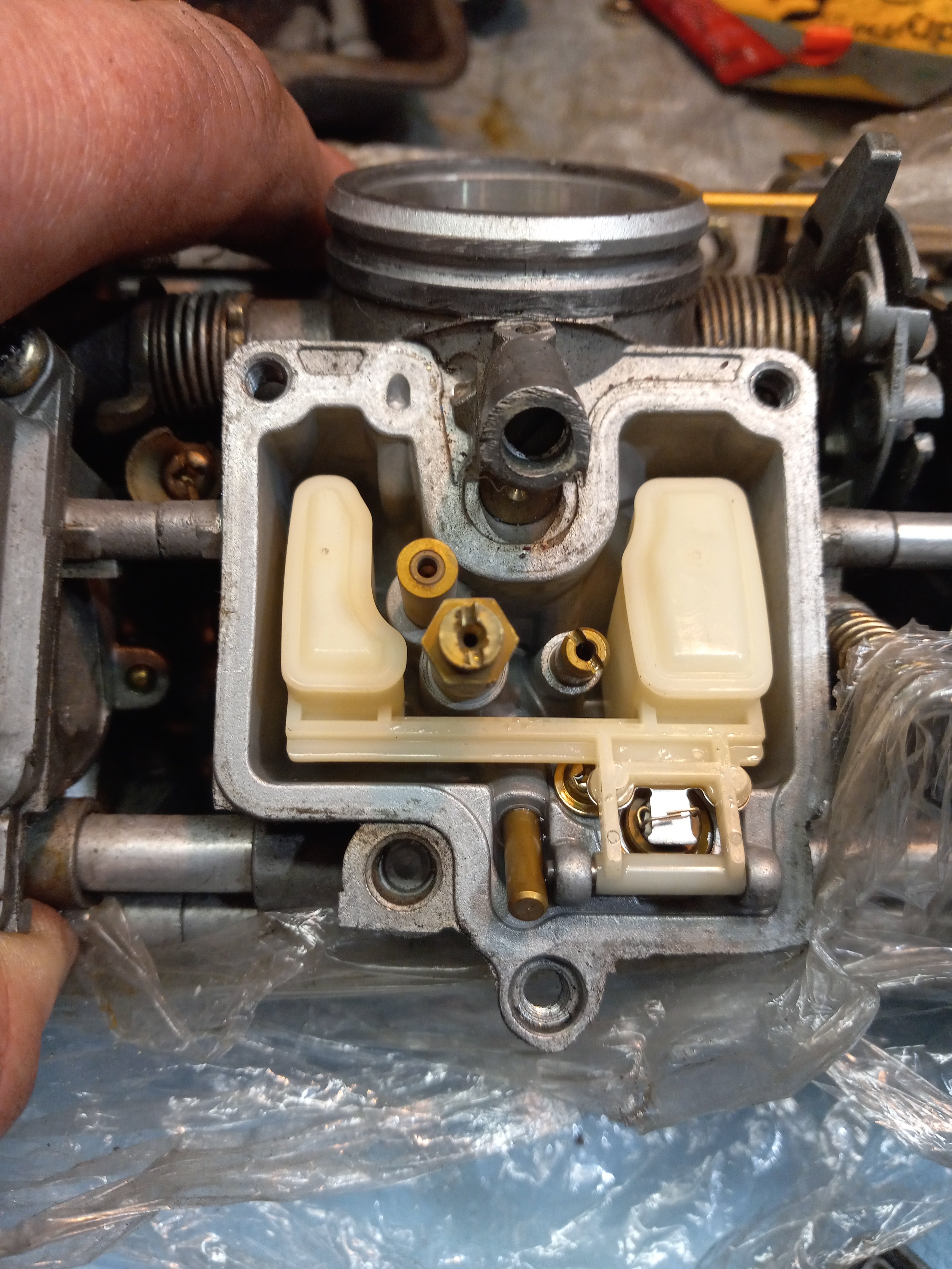

tomek Posted January 16 Share Posted January 16 (edited) Fuel from pilot jet flows to 4 holes at the bottom. Edited January 16 by tomek Quote Link to comment Share on other sites More sharing options...

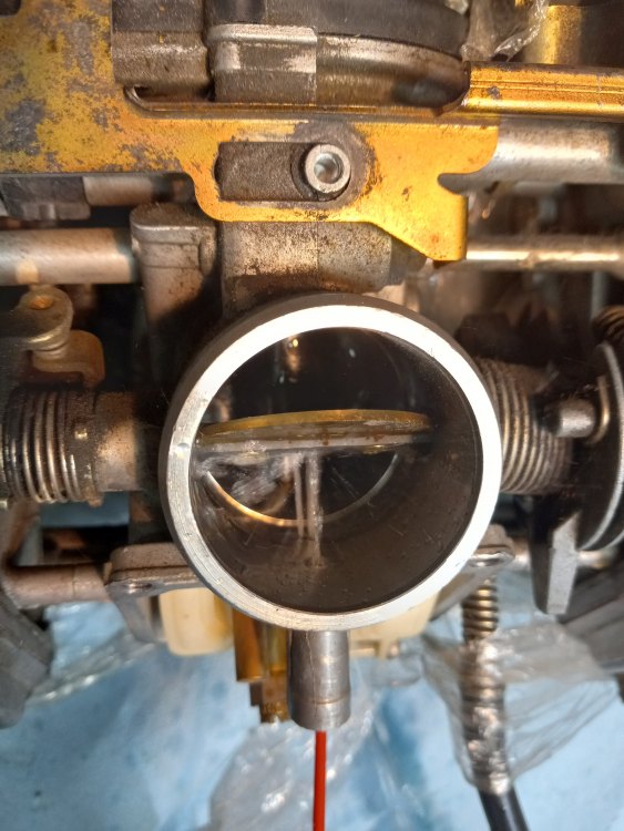

tomek Posted January 16 Share Posted January 16 Keep the throttle open but sticking something in the other one, remove pilot jet, and spray carb cleaner like in the picture. Quote Link to comment Share on other sites More sharing options...

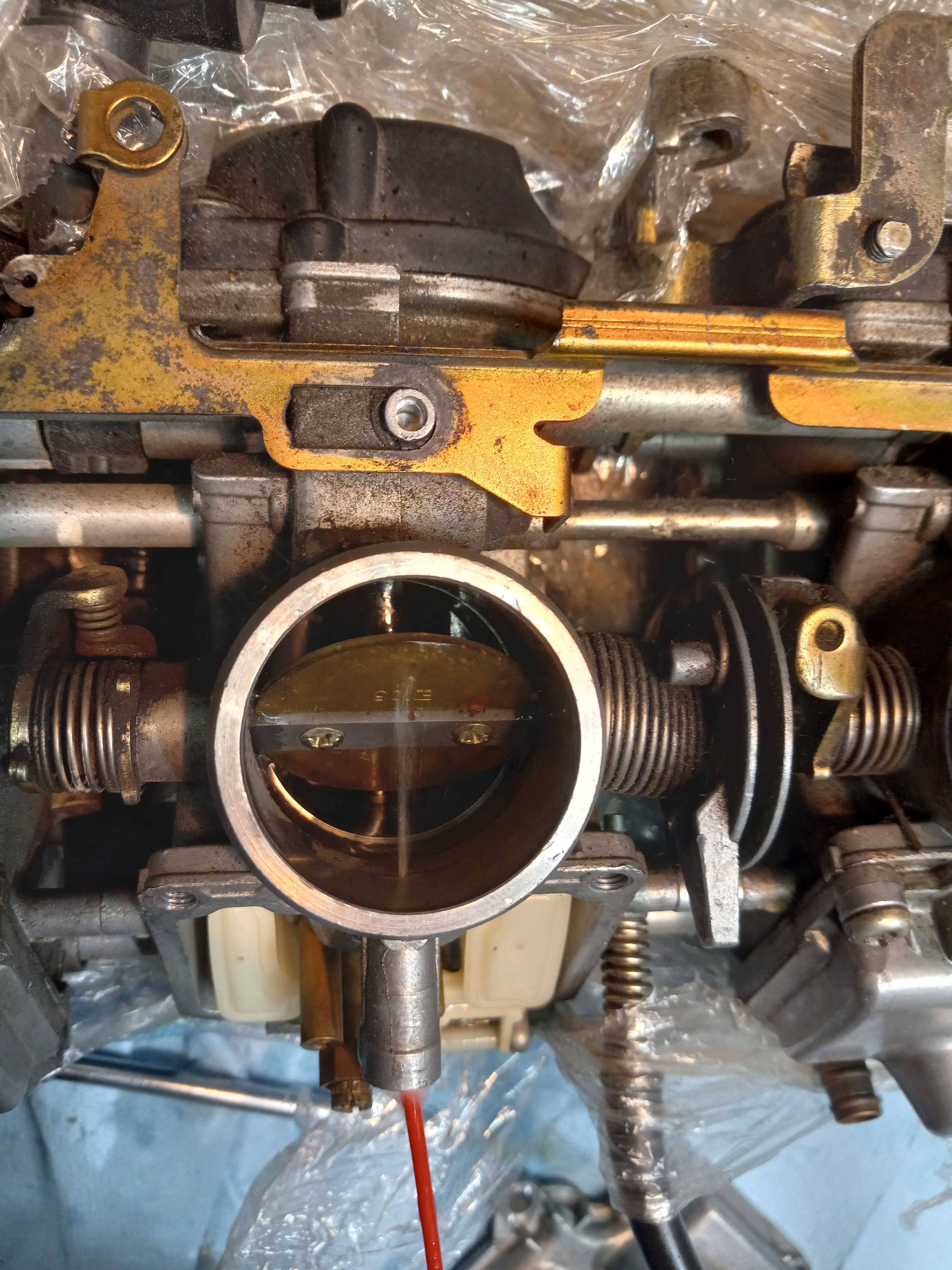

tomek Posted January 16 Share Posted January 16 (edited) Remove idle mixture adjustment screw, but before you do it turn it all the way in. Count the turns. You gonna have to reinstall it exactly the same way (turns). Usually it is around 3 turns out from fully turned in position. Clean it with carb cleaner. It will be flowing from just on hole. Carb turning is becoming lost art, but as you can see adjustment screw controls flow only to one of 4 holes on the floor. So, sometimes turning the screw won't fix lean conditions under certain loads, different jet is needed. Edited January 16 by tomek Quote Link to comment Share on other sites More sharing options...

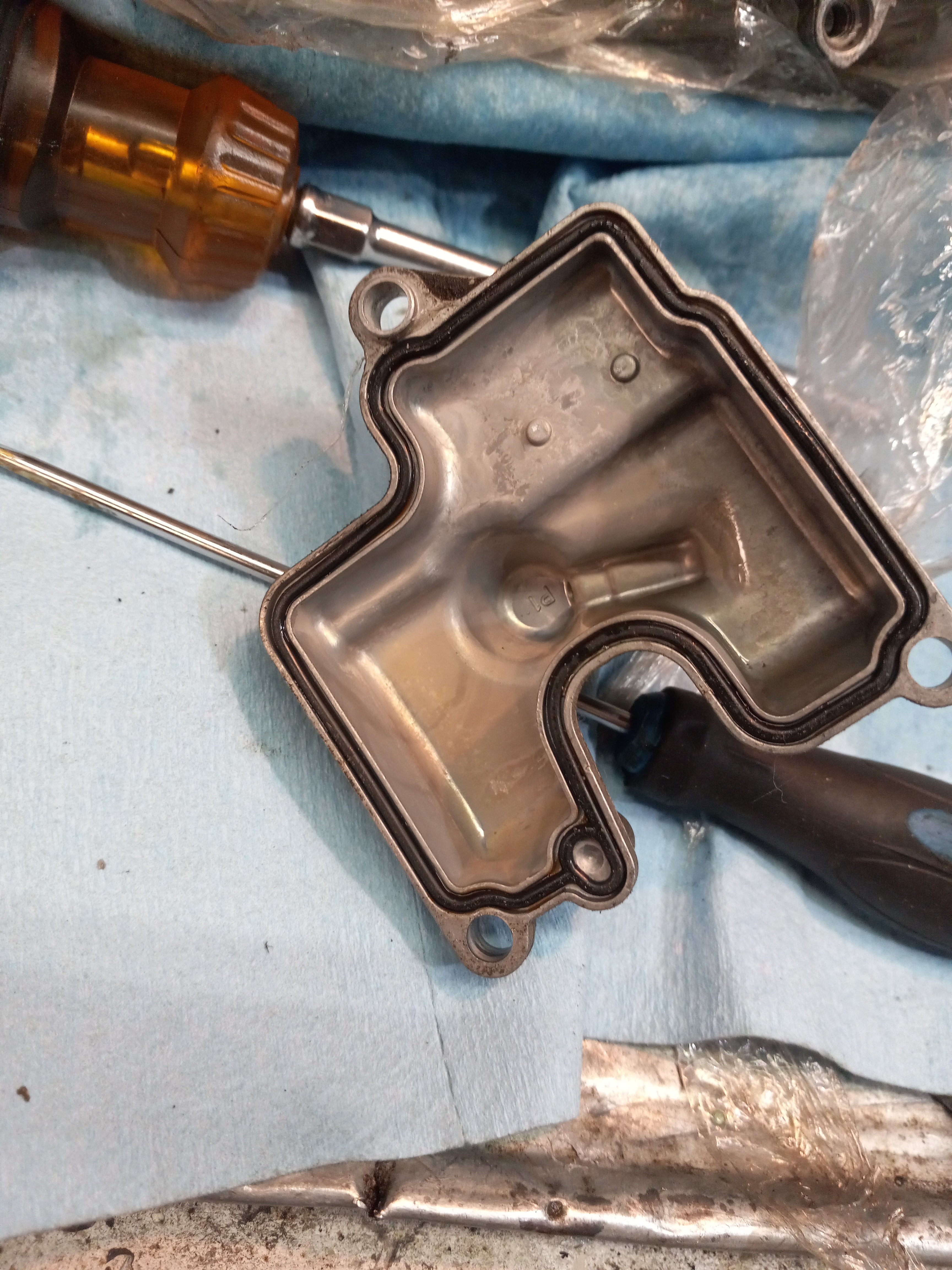

tomek Posted January 16 Share Posted January 16 Bowl gasket can be reused about 176 times. 2 Quote Link to comment Share on other sites More sharing options...

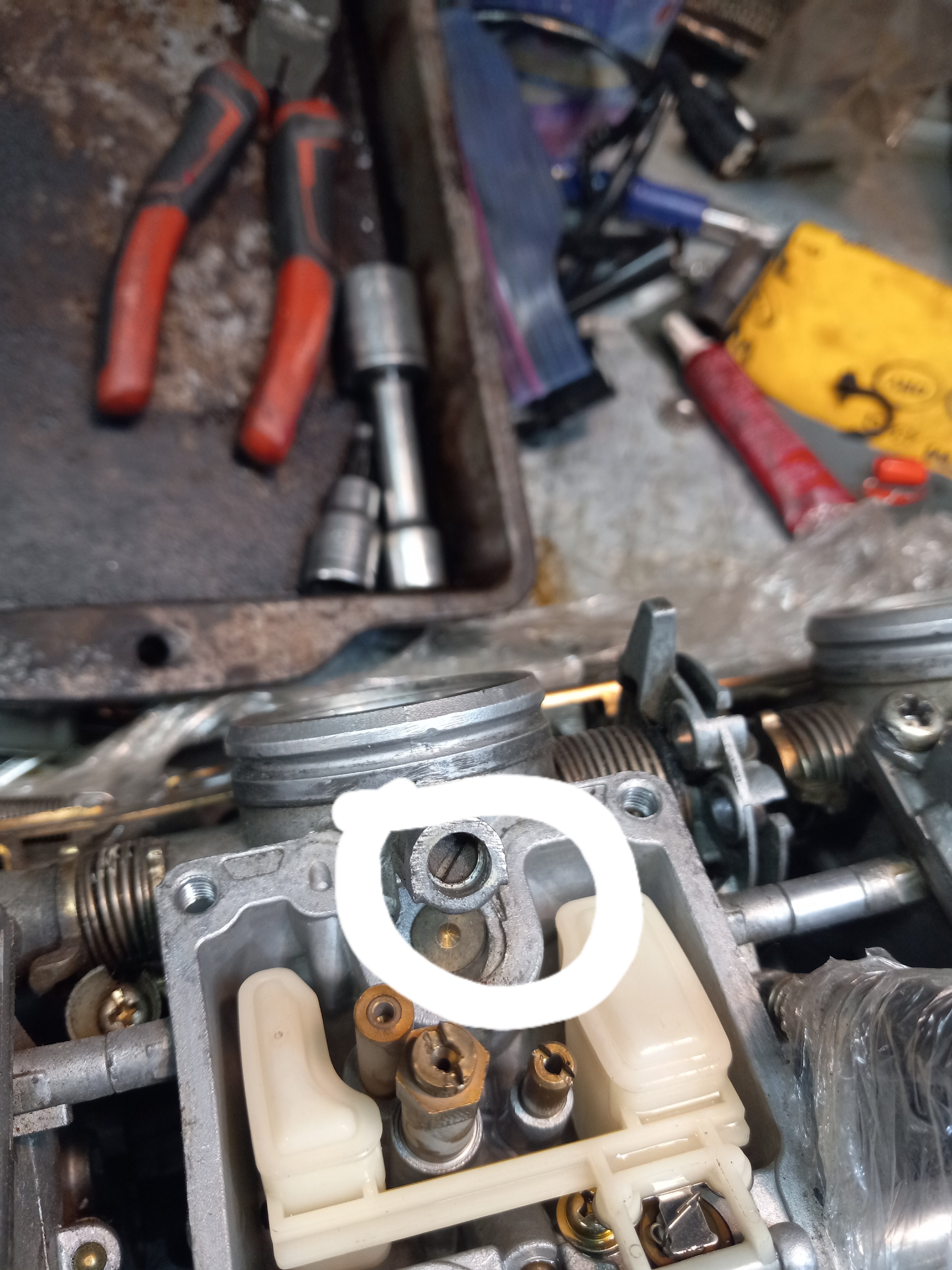

tomek Posted January 16 Share Posted January 16 Idle mixture adjustment screw. Quote Link to comment Share on other sites More sharing options...
