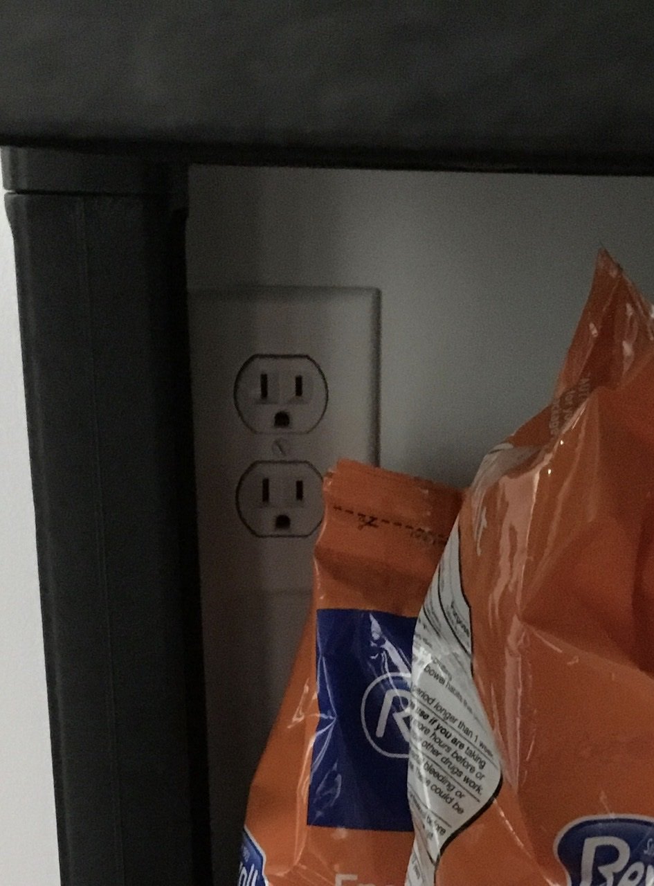

Okay…alternatively, just saw this outlet in the laundry room (where attic access is).  It might be simpler to run router/modem cable into the laundry room.  Drilling into walls to route cable can be concealed with trim plates, and the modem/router could sit on the top shelf of the storage shelves and plug in right below.
Hmm, I'd think this through . . . How hot does the attic get? Will that temp have any effect on the router?
Oops, just saw the laundry room option--that'd get my recommendation.
