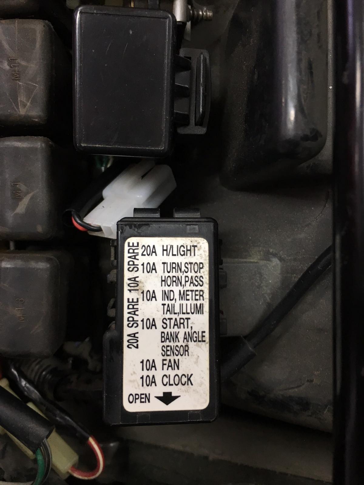

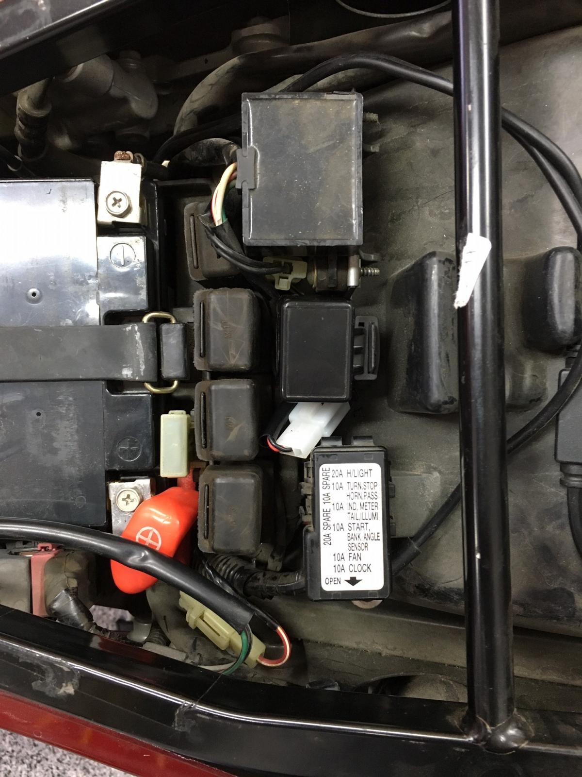

TFT Posted February 5, 2016 Author Posted February 5, 2016 Here is the fuse box and other stuff next to the battery. None of the fuses indicate fuel pump. Quote

The Krypt Keeper Posted February 5, 2016 Posted February 5, 2016 (edited) 2nd pic left lower corner under red cover also why is your 02 bird red? traitor Edited February 5, 2016 by The Krypt Keeper Quote
TFT Posted February 5, 2016 Author Posted February 5, 2016 (edited) 2nd pic left lower corner under red cover also why is your 02 bird red? traitor Thanks. The fuse looks good, but I am going to buy some fuses and replace it. Oops, its a 2001. It's my wife's Bird. She's the traitor. Edited February 5, 2016 by TFT Quote
