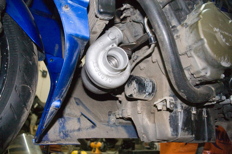

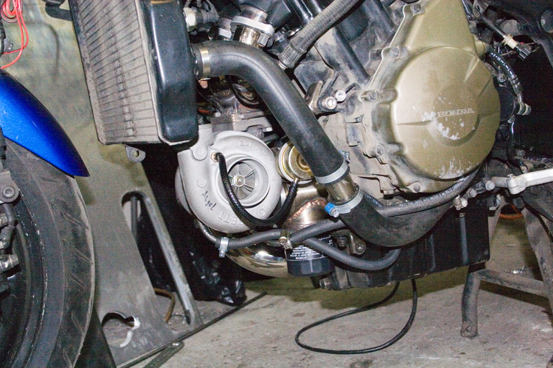

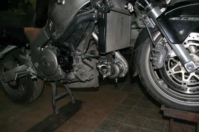

First, FI Blackbird 2000.

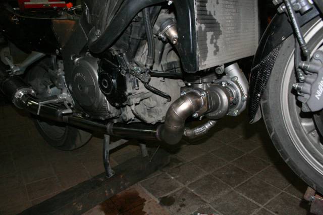

It has Garrett-17 turbo, but his housings overbored to 2860 size. We got similar performance as 2860 but smaller size.

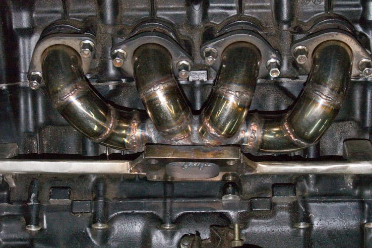

Turbo header: TIG-welded, stainless steel.
Installed 4 EGT sensors, it necessary to accurately monitoring turbine temp. because we use launch-control modes (when clutch disengaged, throttle=100%, ignition advance= 0..-5 degrees and RPM limit in 5000, this helps to build boost at low rpm).

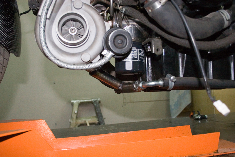

Oil filter rotated to 90 degrees, and oil to turbo gets from its adapter.
Drain line connected to electrical oil scavenge pump locaded under a fuel tank.

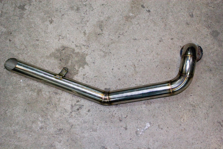

Downpipe - simple 60mm stainless steel tube, connected to Devil muffler. Wideband AFR sensor inside :)

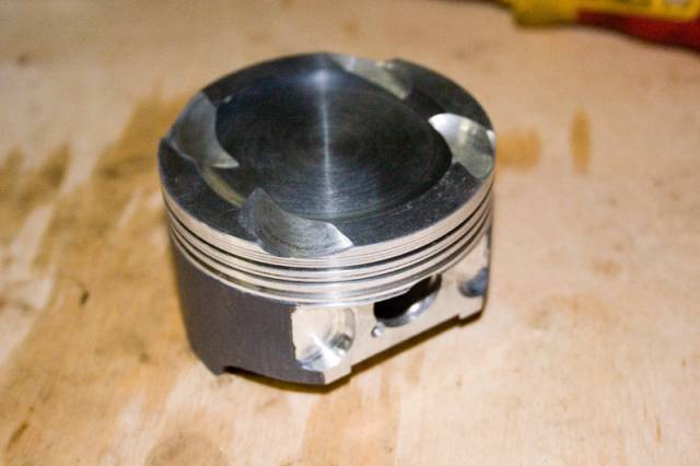

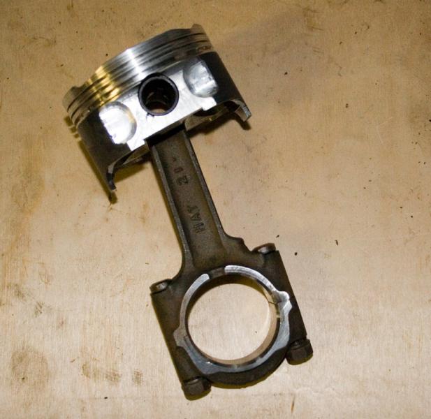

Engine. Custom pistons for 9:1 compression ratio, made specially for me in military factory:

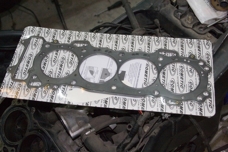

Connection rods are stock (now i want buy Carrillo's), Cometic head gasket.

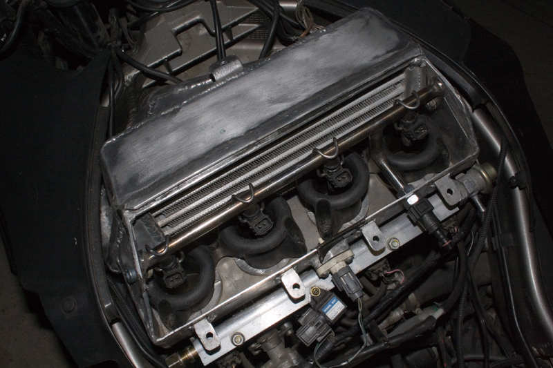

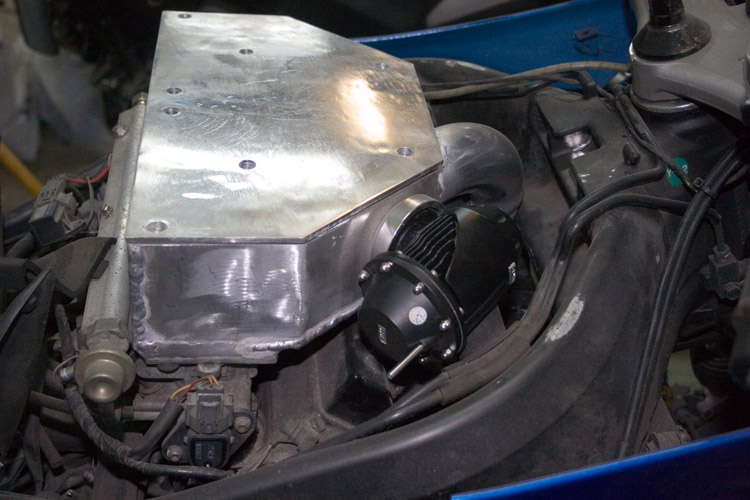

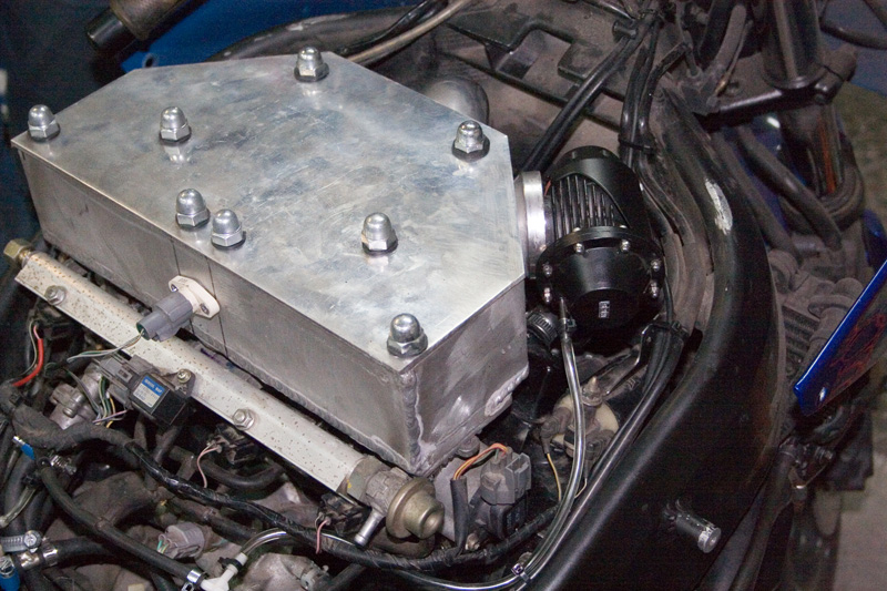

Intake plenum has velostacks, water intercooler and secondary injector rail (from honda S2000). Installed Water-Methanol injection system from AEM.

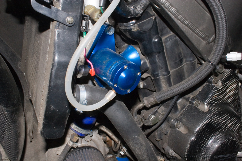

Blow off valve is simple, but it work very well:

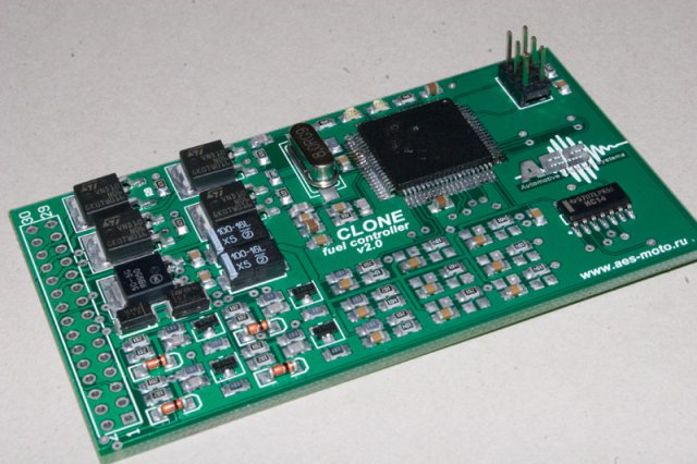

Spark and Fuel management system (ecu) designed specially for this bike, based on Cortex-m3 (stm32f103) controller.

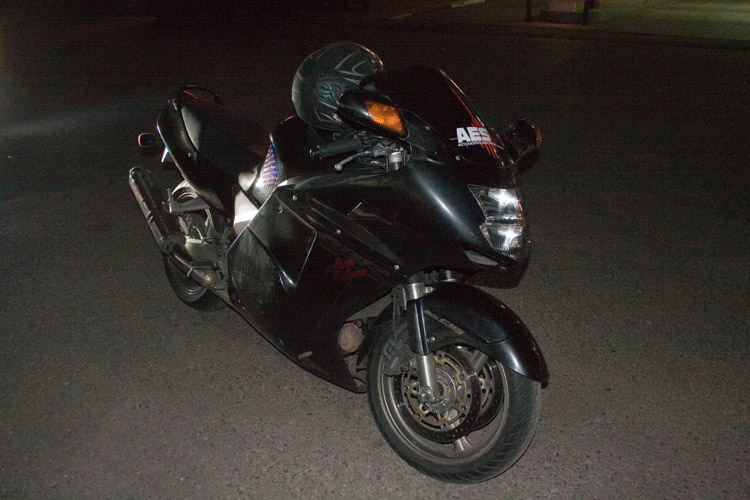

Turbo Blackbird:
This is first Russian Turbo Blackbird :icon_biggrin:
Now it has extenden swingarm, electronic traction and boost control.

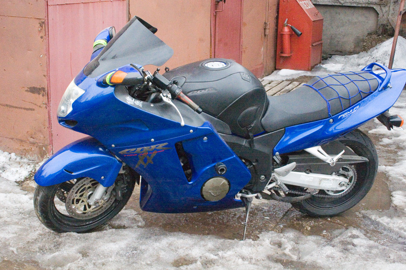

Second TurboBird :icon_evilgrin:
Carbed CBR1100xx 1997 year old.

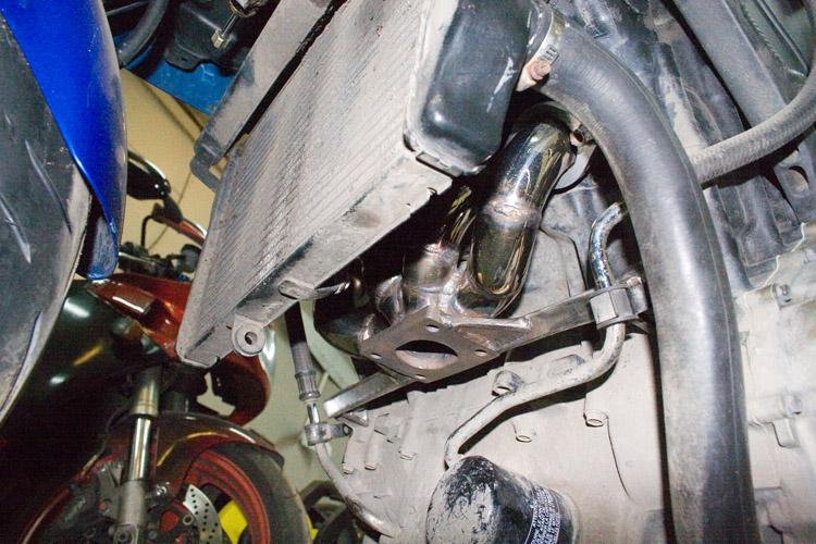

Time to make exhaust flanges:
Russian roads had very bad quality, this is reason for made addition turbine support (without it turbine header may crack). In CATIA software I calculate required arm sizes (to turbine flange):
Welding process:

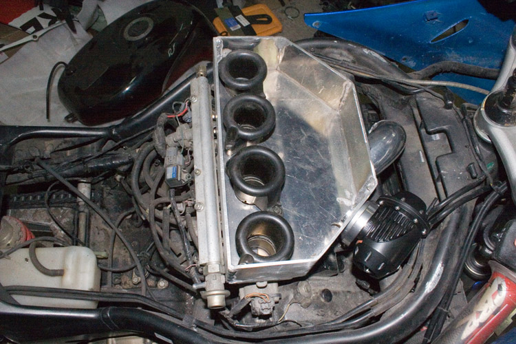

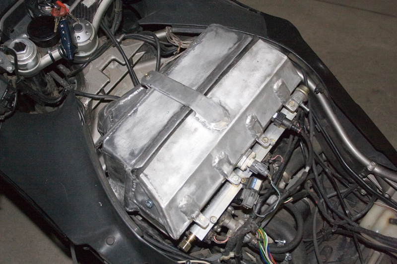

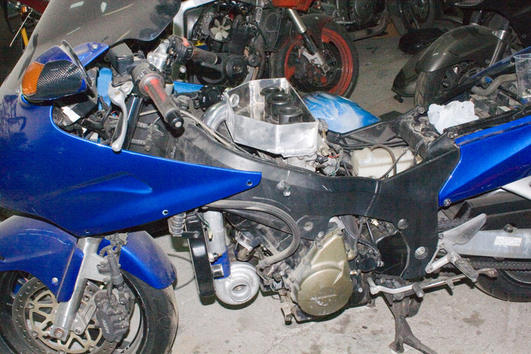

Turbo intake plenum (receiver):

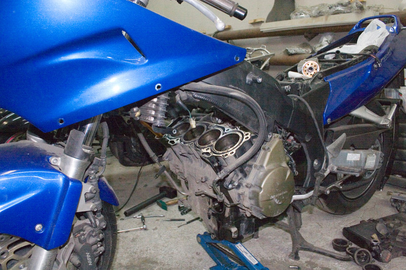

Engine rebuild (custom pistons, gasket, clutch, etc). Also we changed cylinder head to 2000 year injector. Now we have 1997 fuel injected BlackBird!
ECU similar to 1-st bird, DIY on STM32F103 controller.

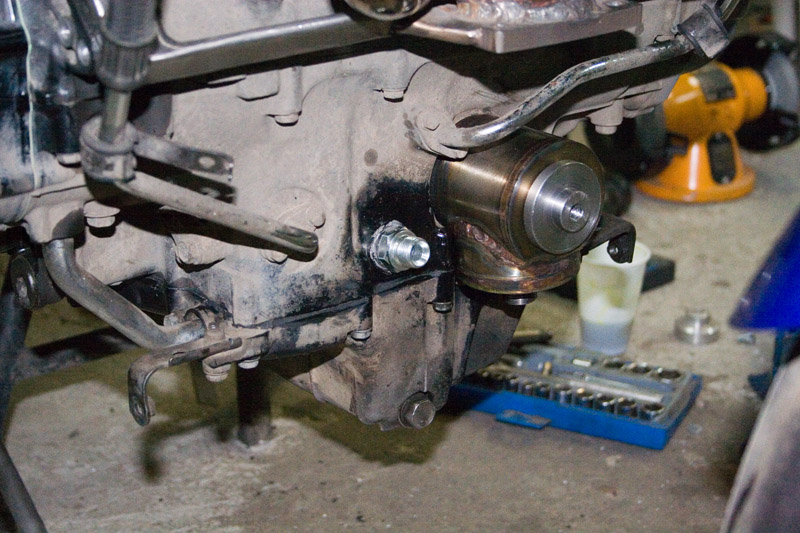

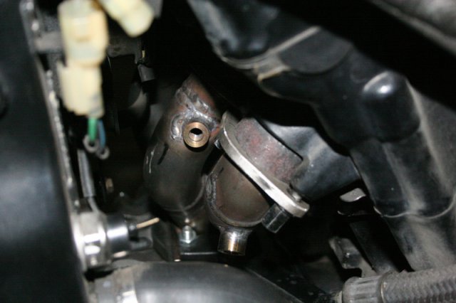

Installed pipe connection for turbo oil drain line. Pay attention, it over oil level !

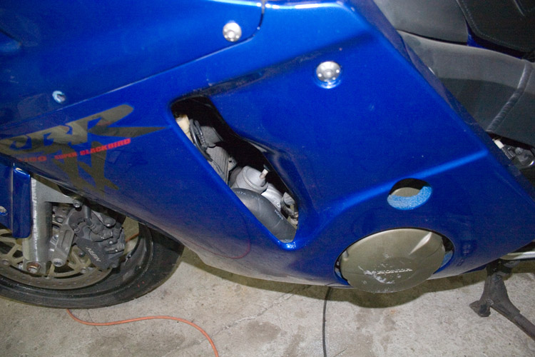

Downpipe connected to stock exhaust system:
Intake installed:

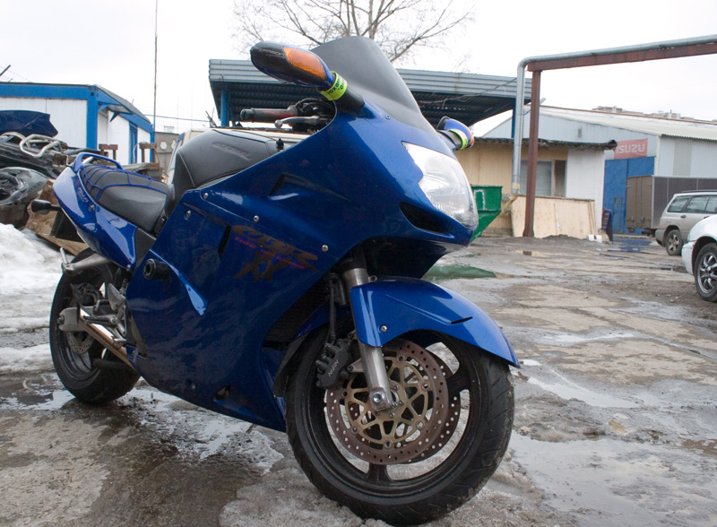

Now we have absoluttely "stock-like" 1997 bird, but it FI with turbo engine :icon_biggrin:

Installed HKS SSQV blowoff valve:

Downpipe. 133 dBa at CEM noise meter :icon_evilgrin:
Engine. Thicker Cometic gasket and adjustable CAM sprockets. That's all.
Oil filter adapter. All right reserved, patented :icon_naughty:

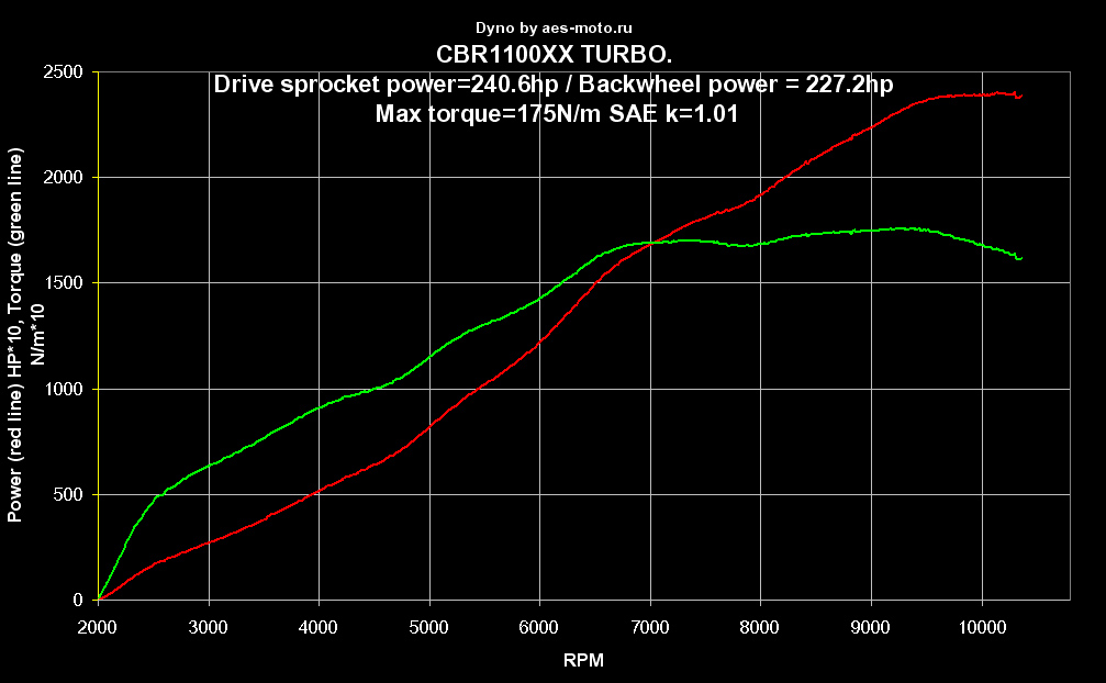

ECU: Stock, with specially designed Fuel Controller, similar to PowerCommander (we called it "CLONE" :icon_biggrin: ) but has ability to boost-control, autotune, MAP-based correction tables and knock sensor input. DAC converter generate fake stock-like map-sensor signal (Bike ECU now happy and FI error on boost not lit):

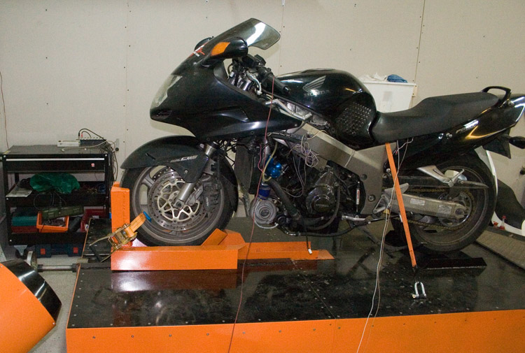

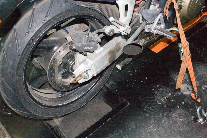

Dynoruns. Very loud :icon_twisted:
