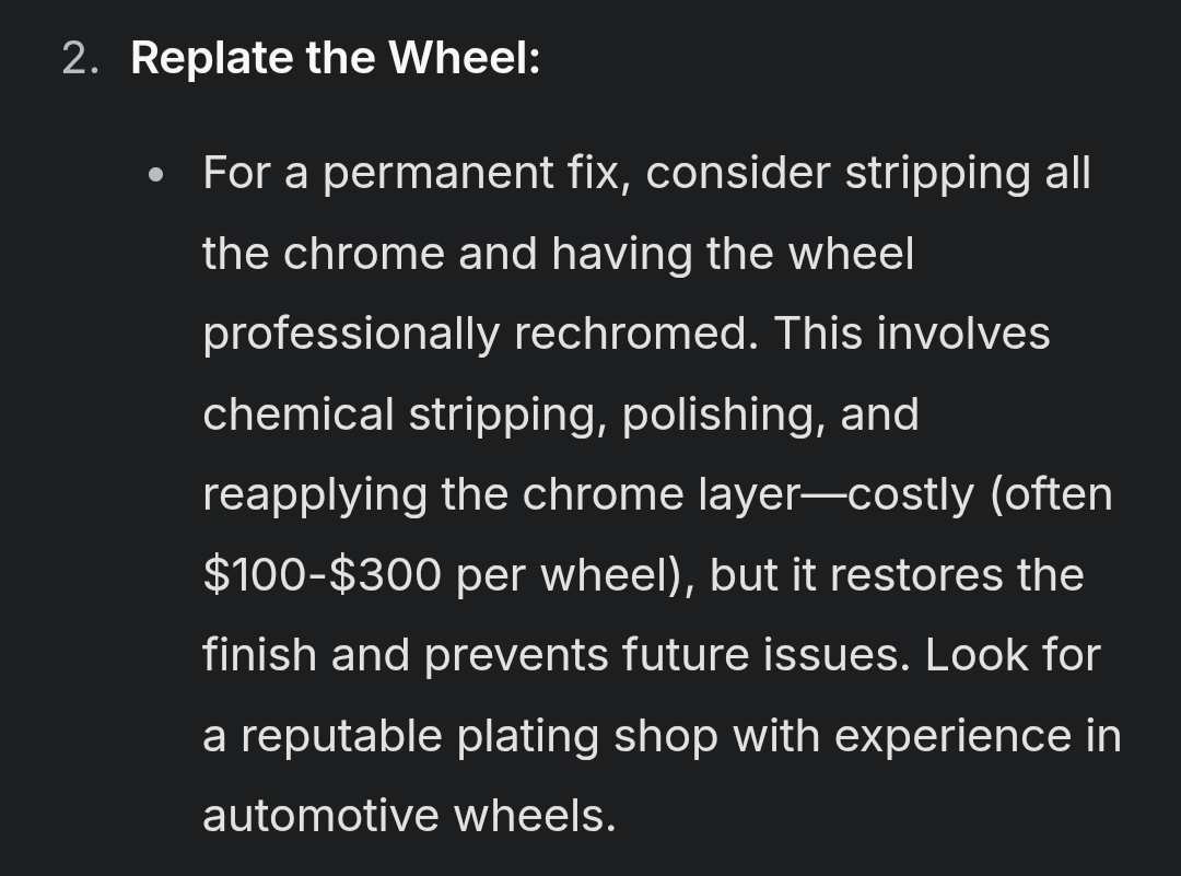

XXitanium Posted April 6, 2025 Posted April 6, 2025 1 hour ago, SwampNut said: Fuck, that's an idea! Ask Rocketman's AI. https://grok.com/share/bGVnYWN5_cd00affc-6572-4bbd-8d62-37c6b6bab7c4 That's pretty good. If they need to stay true chrome, what's the repair budget? Screen-grab from that AI... 1 Quote
rockmeupto125 Posted April 7, 2025 Posted April 7, 2025 Find out where they do that for $100. I'll get 4 sets done 2 Quote
