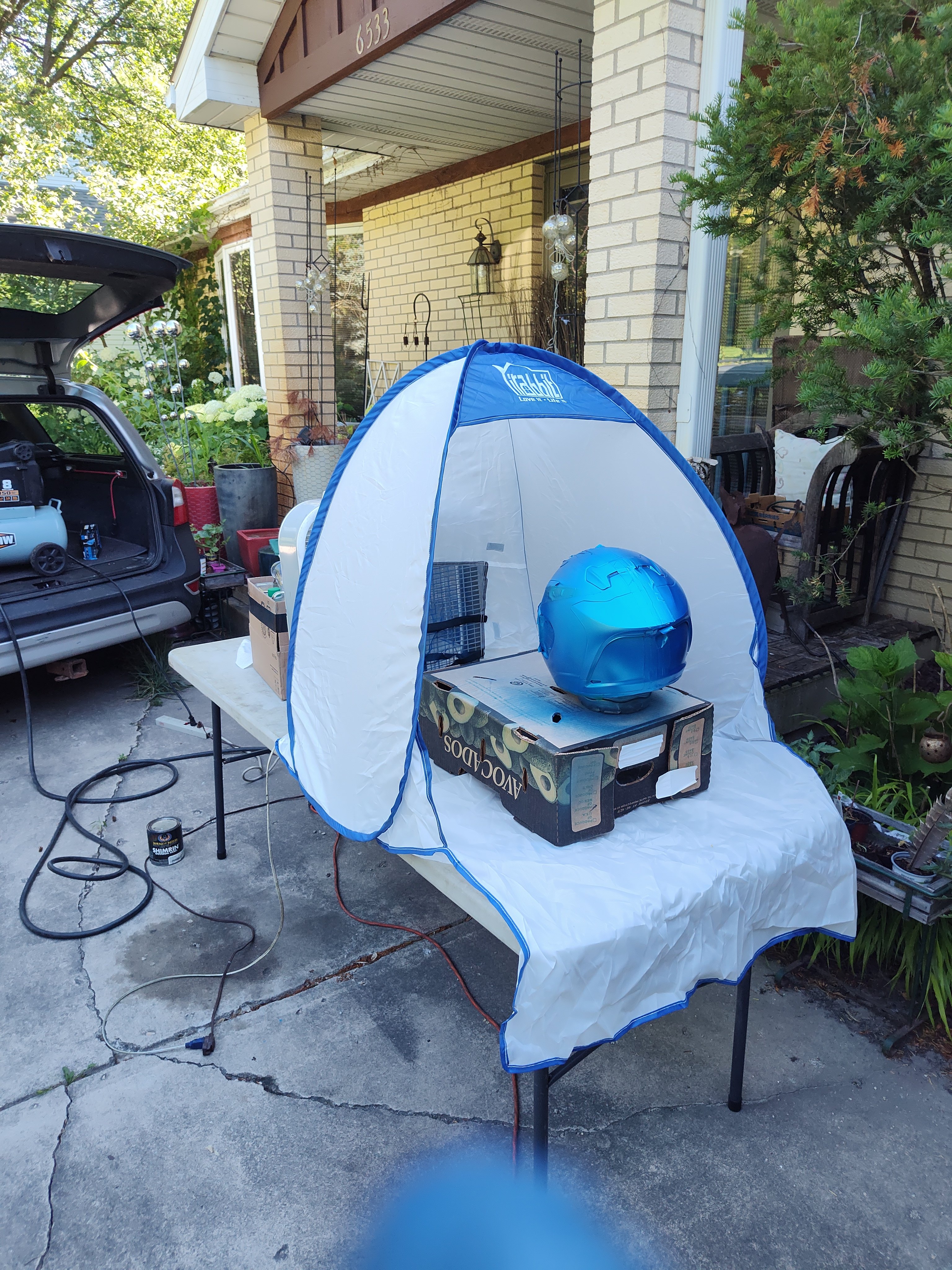

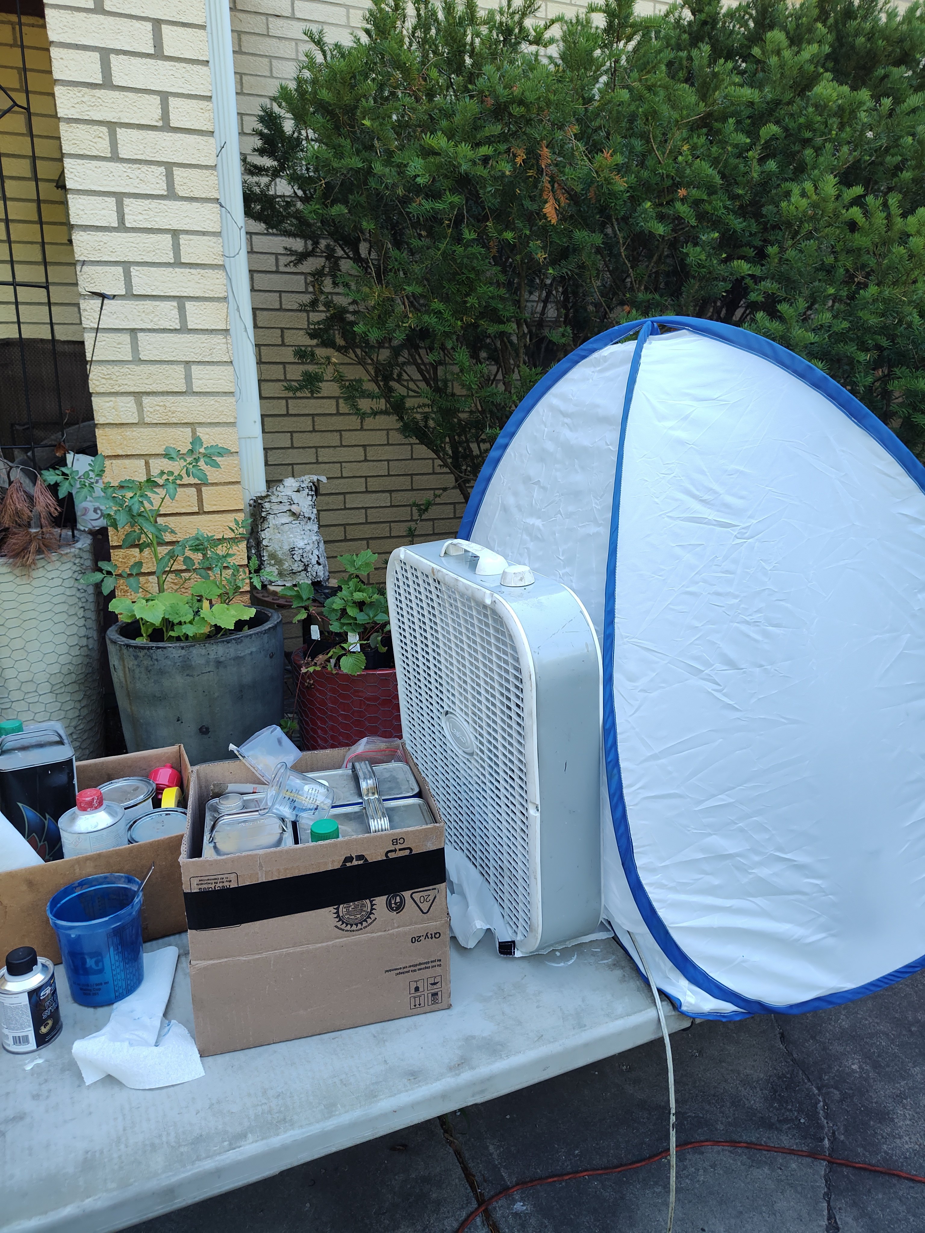

 Sure, my cousin does own body shop, spray booth, etc. But it is an hour away. Hard to justify if you painting small items, like a helmet, and project could be multi colors.
 One color ends up being 3-4 hrs deal. 2 hrs driving plus actual labor.
 Doing this instead. I'll go to my cousin for final clear though.
 It is gonna be kick ass helmet once I'm done.

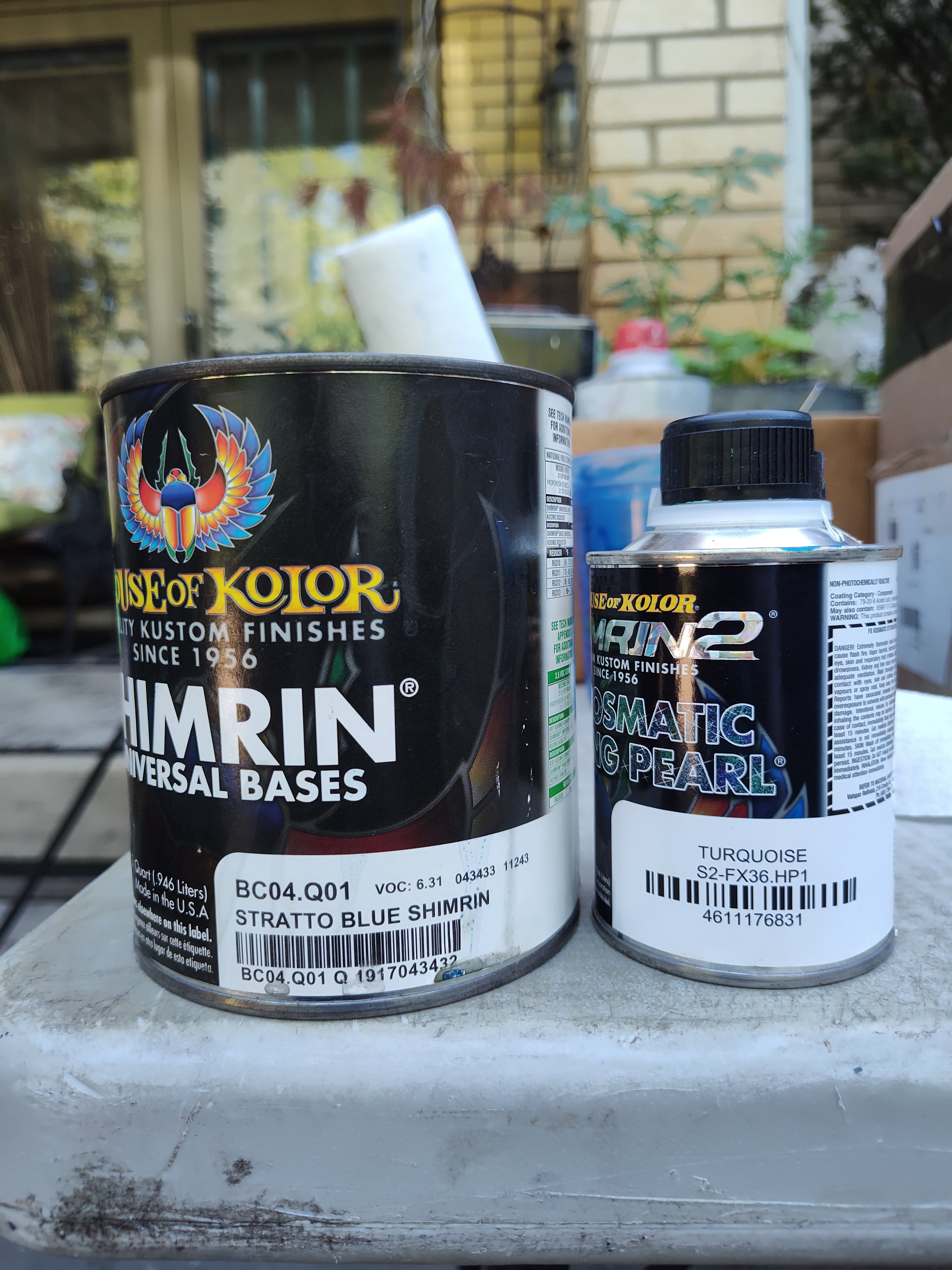

House of Kolor paint of course because I don't except substitute. Of cours, PPGs top line, Glasurit, BASF, etc are nice as well, but those are primarily OEM match paints. But that's not what I'm doing here.

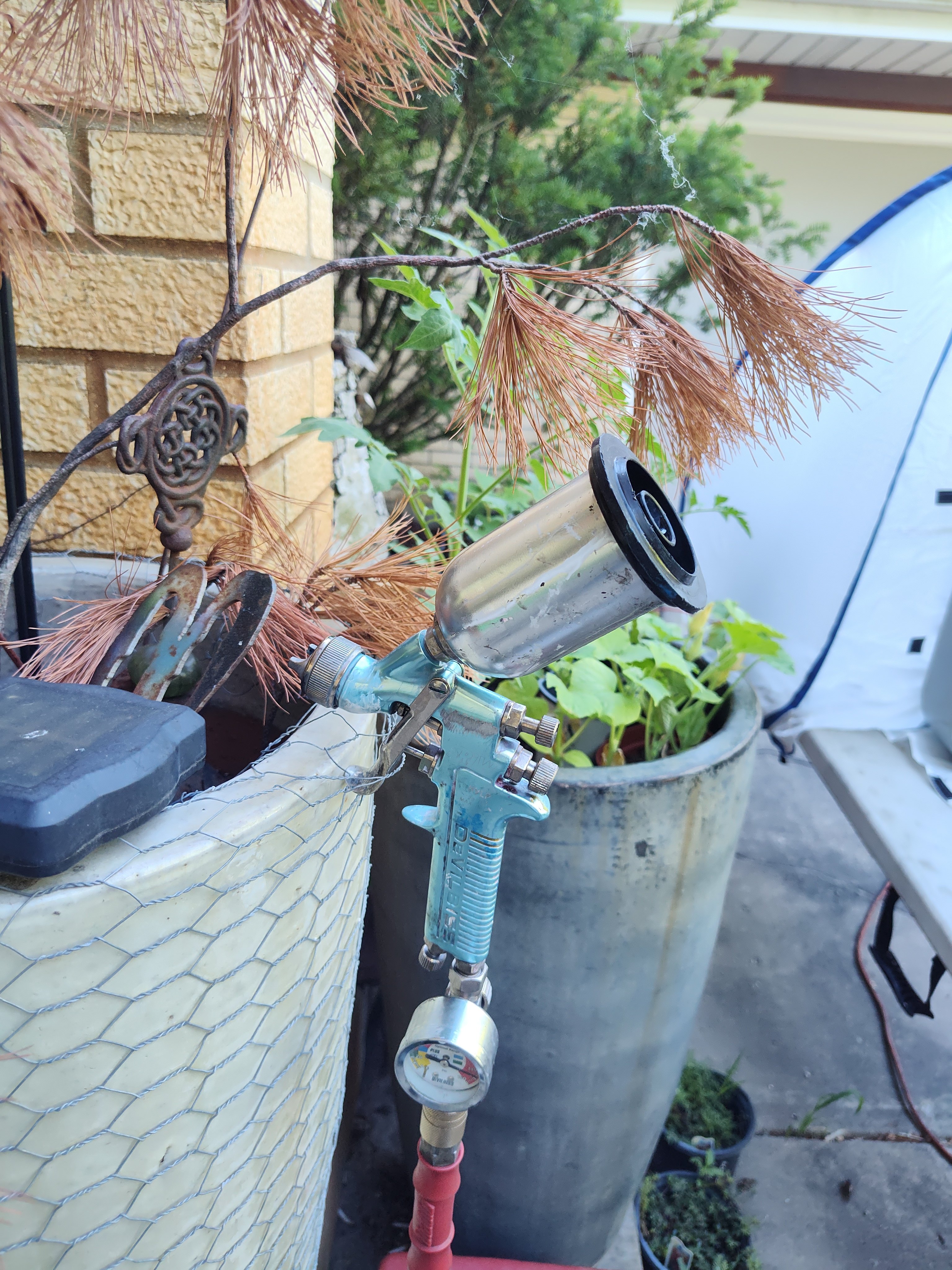

That tiny compressor is powerful enough to feed my mini gun.
Why in not my garage? Because my neighbors would just kill me. The smell. Bad and poisonous.

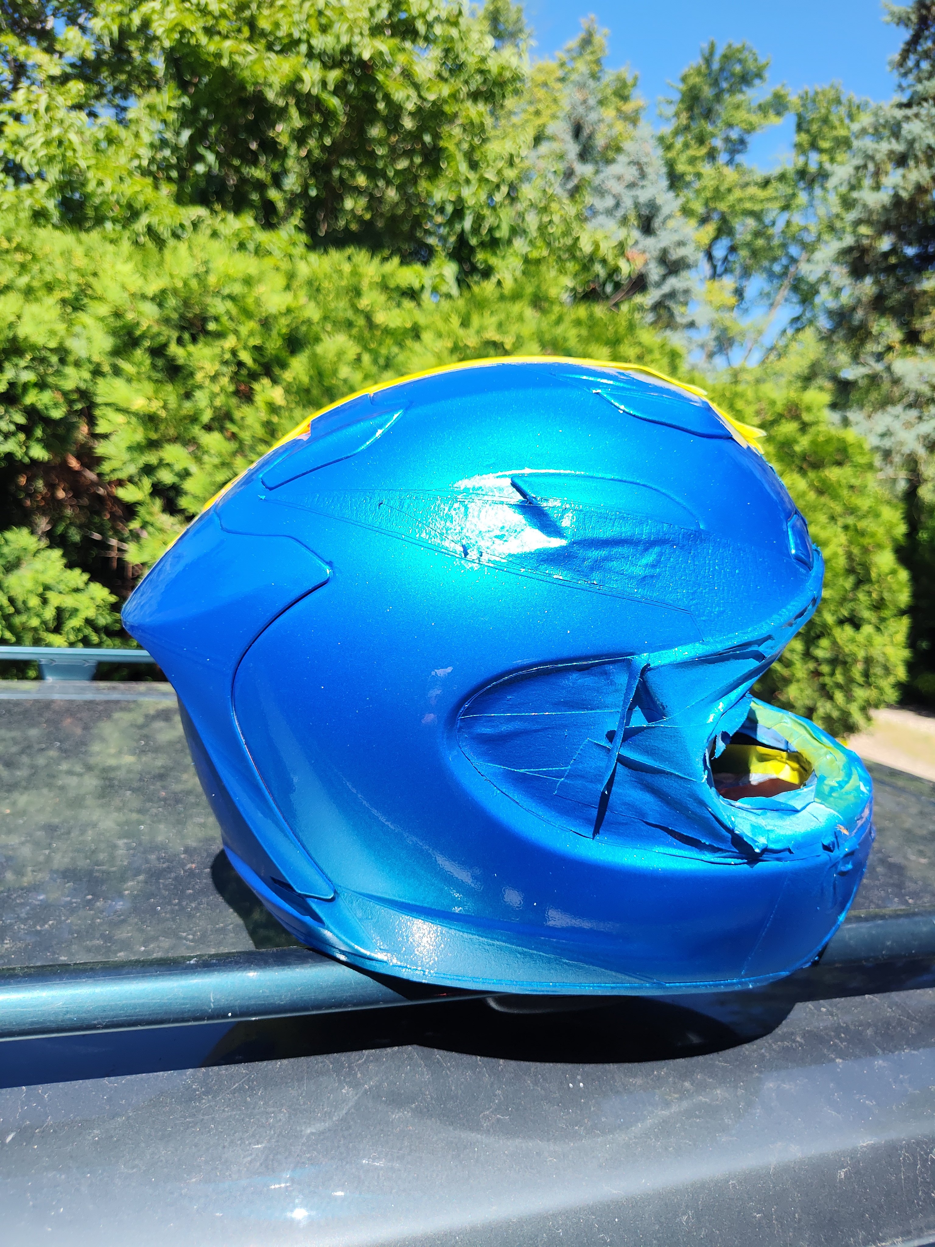

 Mixed bc04 and fx36 3 to 1. Absolutely stunning color. With mini gun you need to run more than normal reducer to get good sprayability.
 Would not paint larger objects with mini, but for small items atomization is good enough.
Blue is done. Absolutely stunning in direct sun.

 Price for fx36, special effects, is ouch. I got it cheap of eBay, but normally is around 150 bucks for half of pint. BTW, it is just the beginning. I think it needs some areas of black pearl. I'm gonna contact my ex, she is still batshit crazy but always had excellent ideas about graphic designs. What colors go well together, etc.

Your tape is cupped.
In the first photo I thought it was blue chrome and I was excited to see it closer up and finished.  In the second it looks to be a metallic blue(?).  It still looks cool and I look forward to seeing the final product.

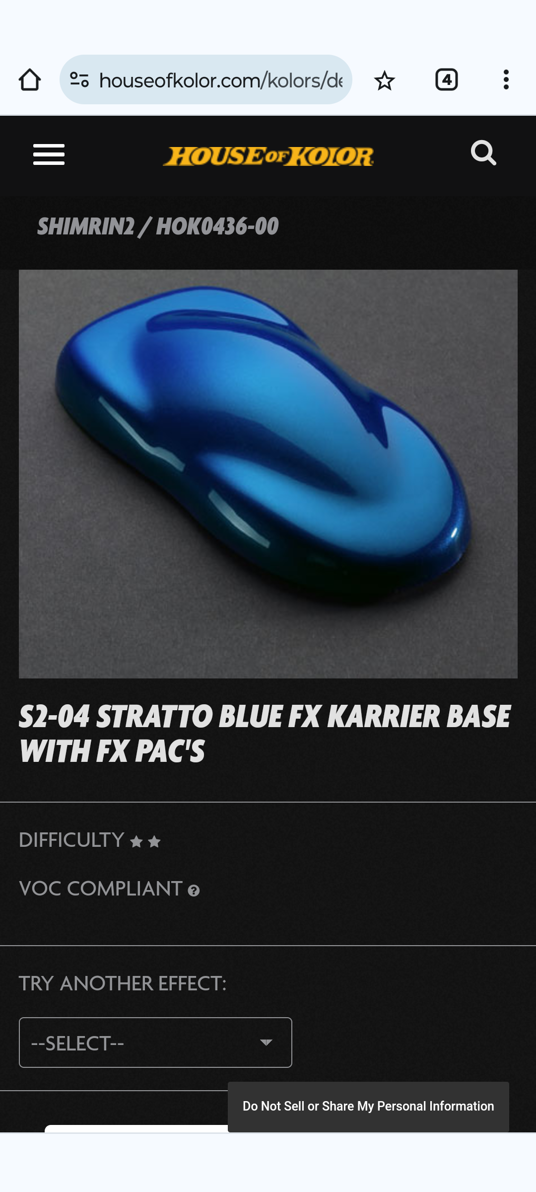

 It is neither metallic, chrome or pearl. All of it together. There is one more coat planned, black pearl, and then maybe couple decals.
 Debating whether do normal clear or flat. Probably normal since now every redneck worships flat.
I wanted something blue, and happened to have components to mix this.
