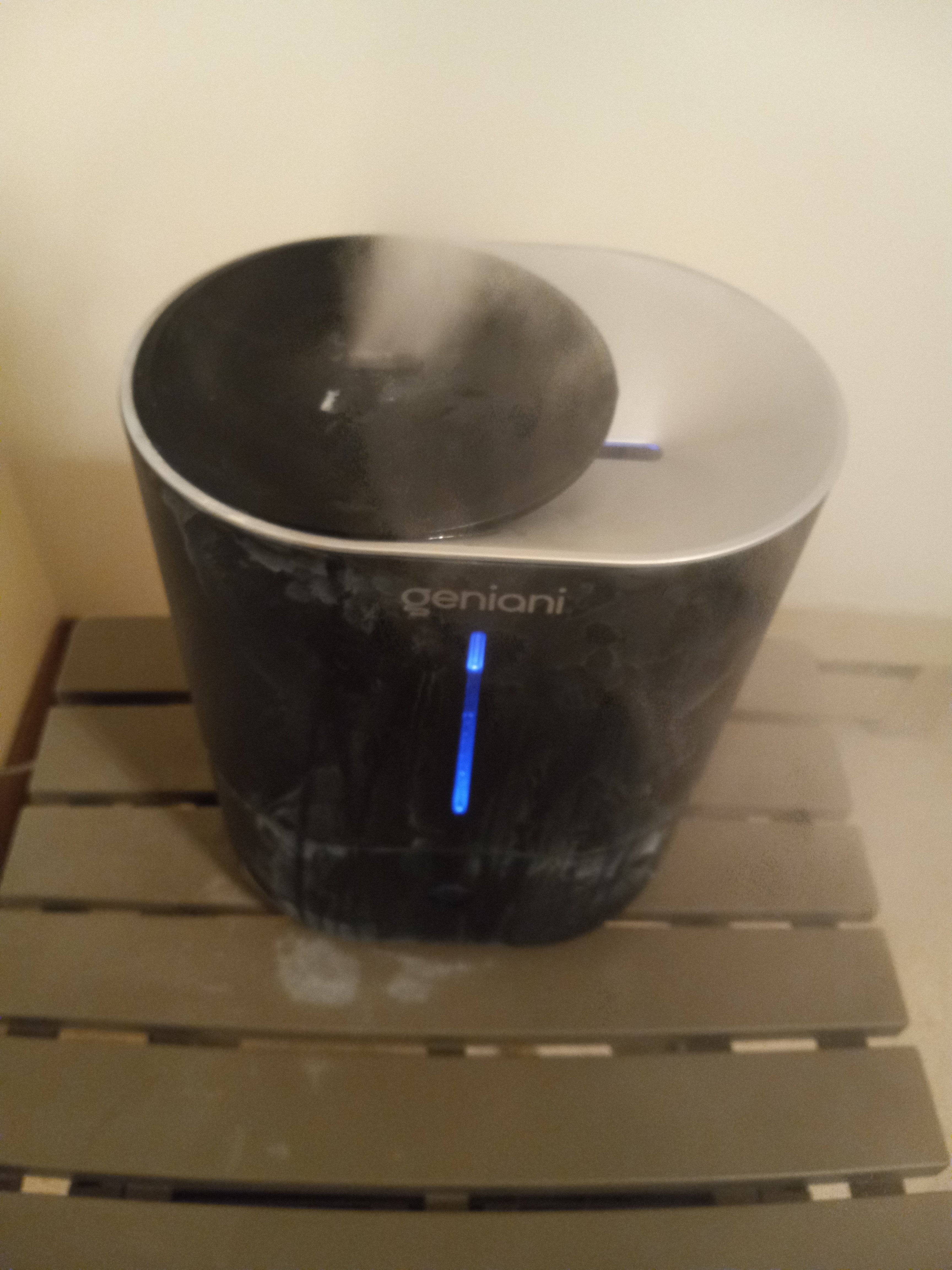

SwampNut Posted March 28, 2022 Share Posted March 28, 2022 I've been told several times that this is bad, according to "common knowledge." But I can't find any such thing when I google it. The most negative thing I can find is to be careful not to have the humidity go too high. We have an automatic humidifier, and my thought would be to set it around 45, maybe 40. Comments? Humidifiers in the Summer The issue is mostly present in the winter, but if you live in a dry climate such as here in San Diego, it’s possible to experience these symptoms all year. Even if you live in a very wet place, if it’s hot you’re probably running your air conditioner. That’s a sure way to dry out your home. Running a humidifier will help fight dry, itchy skin, even in the summer. Plus, did you know it can save you money? Think about it. Running a humidifier in tandem with your air conditioner means that your AC is cooling wet air. You know those ridiculously overpriced fan/spray bottles sold at amusement parks? It’s the same principle. Cooler air inside your home means you can raise the temperature on your AC. This in turns cuts your electric bill. Stop allergies and save money. It’s a win-win. When Should I Start Using Humidifier with Air Conditioner? Usually, in summer, we use air conditioners almost all the time. As I mentioned earlier, the air conditioner removes both moisture and heat while cooling our home. Due to dry air, you can have skin-related problems such as dryness, itchiness, etc. Besides, when the humidity becomes low, it can cause respiratory problems as well. If you have someone in your home who has asthma problems, you should be more concerned about the humidity of your home. So, if you’re currently facing these problems, you must need a vaporizer with your AC unit. Dryness itchiness Headaches Chapped Lips Nose Irritation, etc. Quote Link to comment Share on other sites More sharing options...
SwampNut Posted March 28, 2022 Author Share Posted March 28, 2022 Relevant physics... Evaporating water consumes energy, cooling the house. So running the humidifier with heating is actually a fight. You have to heat the water to change its state. The type of humidifier doesn't change this; we have an ultrasonic but it doesn't change state. It aerosolizes the still-liquid water, which then can more easily absorb energy and change state. It's always about five degrees cooler near the humidifier. Simple rule of physics. The AC removes SOME water from the air, not all. And it reduces temp. RH is a ratio of temp and absolute humidity. The AC reduces AH, but *might* not lower RH because it's also cooling. From an AC tech: If you live where the air is extremely dry, perhaps with a RH less than 20%, it could be reasonable to use both at the same time. If you don’t let the RH increase to more than about 40%, the condenser on your AC will not become wet and the AC will not remove any moisture, i.e., there will be no latent heat load on your AC. But if the RH becomes too high because of the humidifier, the AC will remove part of it thereby increasing the latent heat load on your AC and running up your power bill unnecessarily. Quote Link to comment Share on other sites More sharing options...

SwampNut Posted March 30, 2022 Author Share Posted March 30, 2022 3 hours ago, JoWhee said: just buy a good automatic unit. There's a thread on the details, but... Good ultrasonic with auto control, easy descale, connected to an RO unit so it never really scales at all. A separate sensor confirms it doesn't go too high. I've got it at 40% now. The weather suddenly took a turn with some rain, so the AC only ran for a day or so. High of only 78 today. Quote Link to comment Share on other sites More sharing options...
