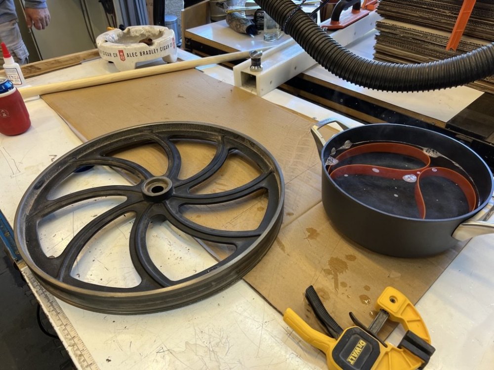

Change your bandsaw tires more often than every 15 years.  It blew pieces out all over, one missed my face by an inch.  It damaged an expensive Woodslicer blade.  And almost nobody stocks tires for an 18" saw, just the 14.

Is it a rubber ring that slips onto the wheel or do you do you have to replace the whole wheel?

I think you're talking about metal bandsaws.  They don't have tires.  All wood bandsaws do, as far as I've seen.
Hot water, a little soap, loop it half way, clamp, stretch all the way into the groove.  The saw is much quieter and smooth-running now.  I never realized how much blade vibration and deviation had crept in because of the cracked tires.

Trippy how the camera angle, and maybe because of the curved spokes, makes the center look like it's off-set towards the right.
