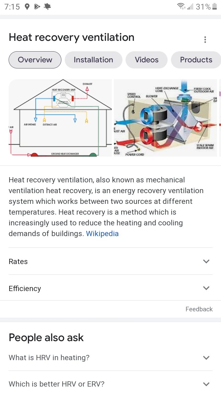

Zero Knievel Posted January 8, 2022 Author Posted January 8, 2022 9 hours ago, XXitanium said: Keep the air moving. I wonder if they make an air exchanger that can heat the air being pumped in. Otherwise we’re just blowing freezing air into the house. Quote
JoWhee Posted January 8, 2022 Posted January 8, 2022 Yes it's called an HRV, we use them in Canada, I'm not sure how popular they are stateside. It's also a decent solution for radon gas. https://www.lowes.ca/product/air-exchangers/venmar-air-exchanger-with-heat-recovery-and-hepa-filtration-3-000-sq-ft-536768 The HEPA is a decent addition for $150 especially if you have pets. 1 Quote
XXitanium Posted January 9, 2022 Posted January 9, 2022 14 hours ago, Zero Knievel said: I wonder if they make an air exchanger that can heat the air being pumped in. Otherwise we’re just blowing freezing air into the house. That is a thing. I was thinking more - ceiling fan. Quote
XXitanium Posted January 9, 2022 Posted January 9, 2022 Heat Recovery Ventilator Not a catchy name Quote

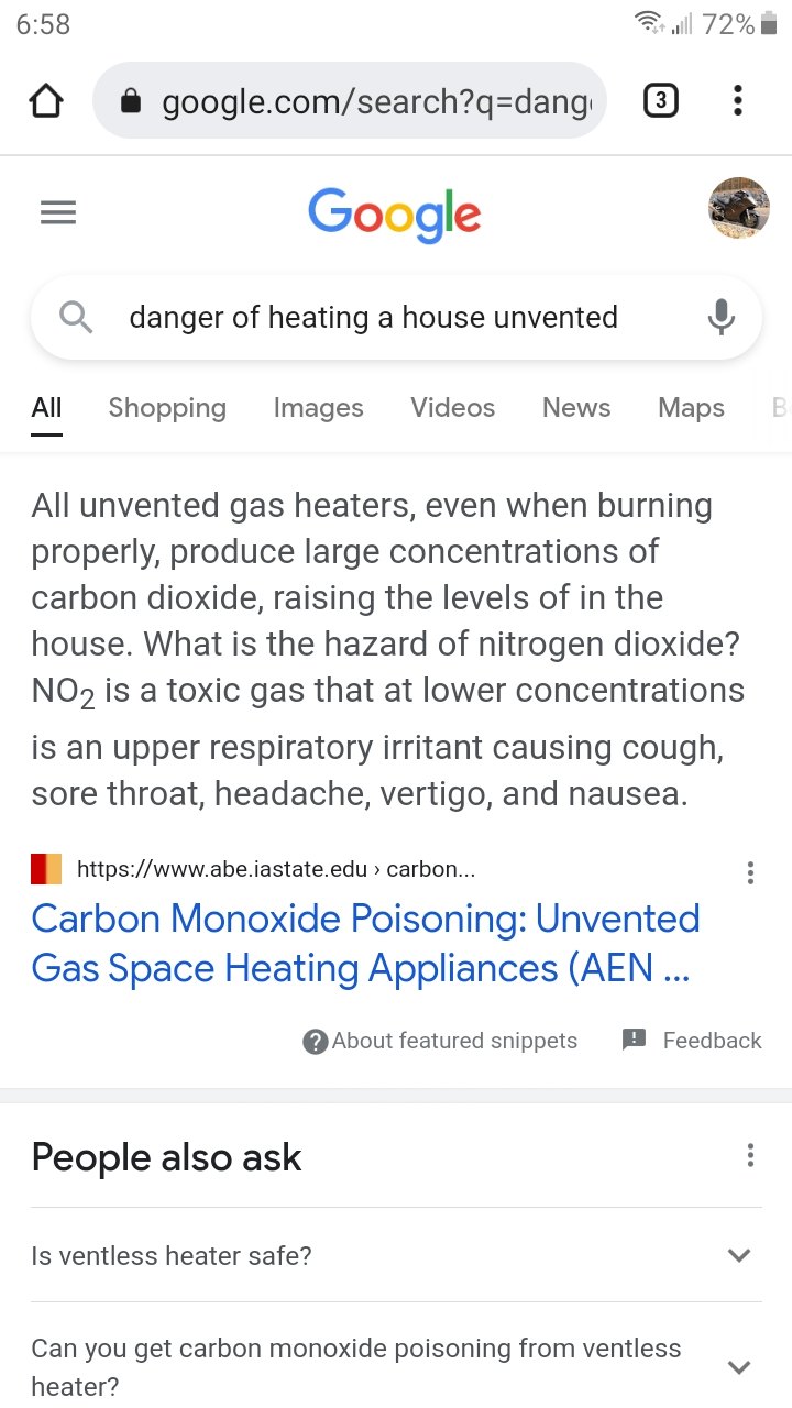

XXitanium Posted January 10, 2022 Posted January 10, 2022 8 minutes ago, Zero Knievel said: CO detector....sorry.... Carbon Dioxide will suffocate you. Carbon Monoxide will poison you. @Biometrix doesn't seem to have concerns, so maybe it isn't a thing to worry about with LP. Quote
SwampNut Posted January 10, 2022 Posted January 10, 2022 A tiny amount of CO is very bad, period. An increase of CO2 and decrease of O2 is bad, but not deadly or quick, without you feeling it. Our bodies have no clue how much oxygen they get, which is why you die almost instantly in an inert gas atmosphere, without feeling it. We detect CO2, so if it gets high, you will feel like you're suffocating in your own house. Unvented indoor heat will deplete oxygen eventually without some exchange to the outside. I have no idea what the practical way to do this is, just adding the biology of it. Quote
