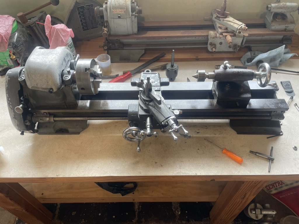

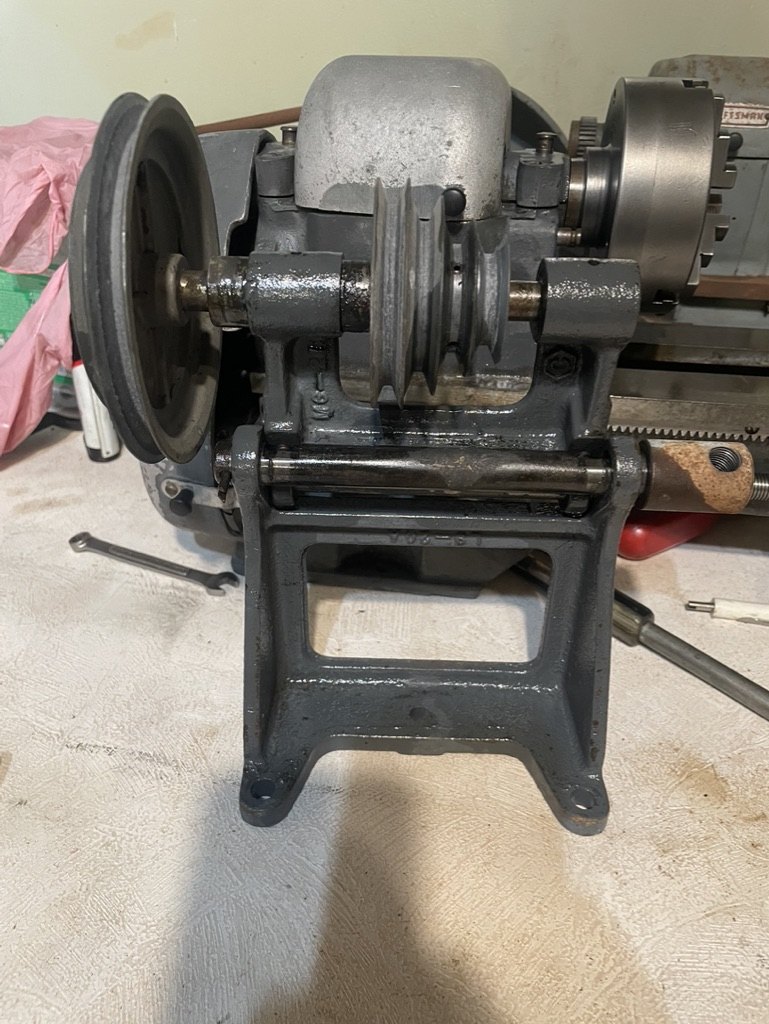

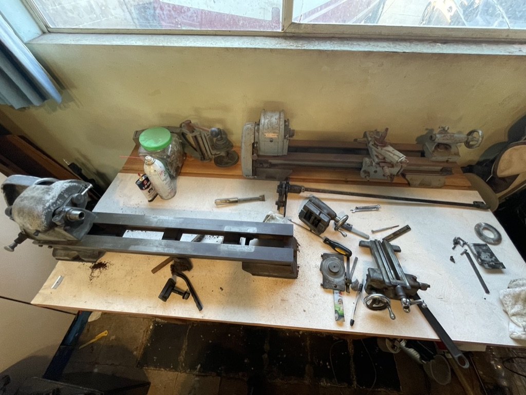

  9. It's sorta done. The lathe itself is done and I did a test run powering it with a drill just so I could enjoy seeing it cut. The motor drives a pulley thing which then drives the lathe, normally they would all be mounted to a bench, but I haven't decided where I want to mount the lathe yet. I might join the three with a metal plate so that it can be moved around as a unit and set on a bench wherever instead of dedicating it to a place. This is the 'pulley thing' that needs to be mounted behind the headstock.

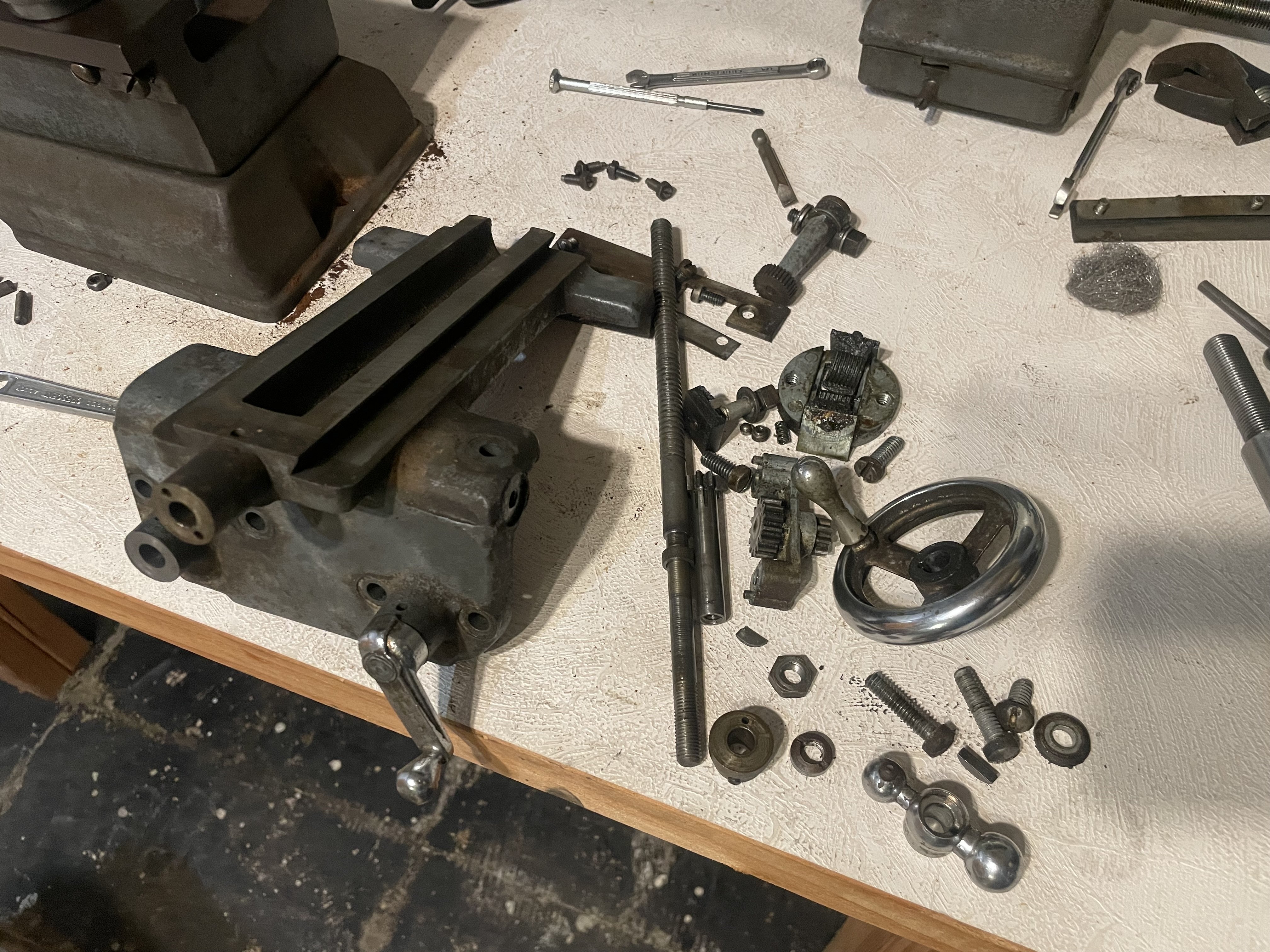

  10. The carriage is almost done. The knob is missing from one of the handwheels, but I might have another one. So far things move smoothly.

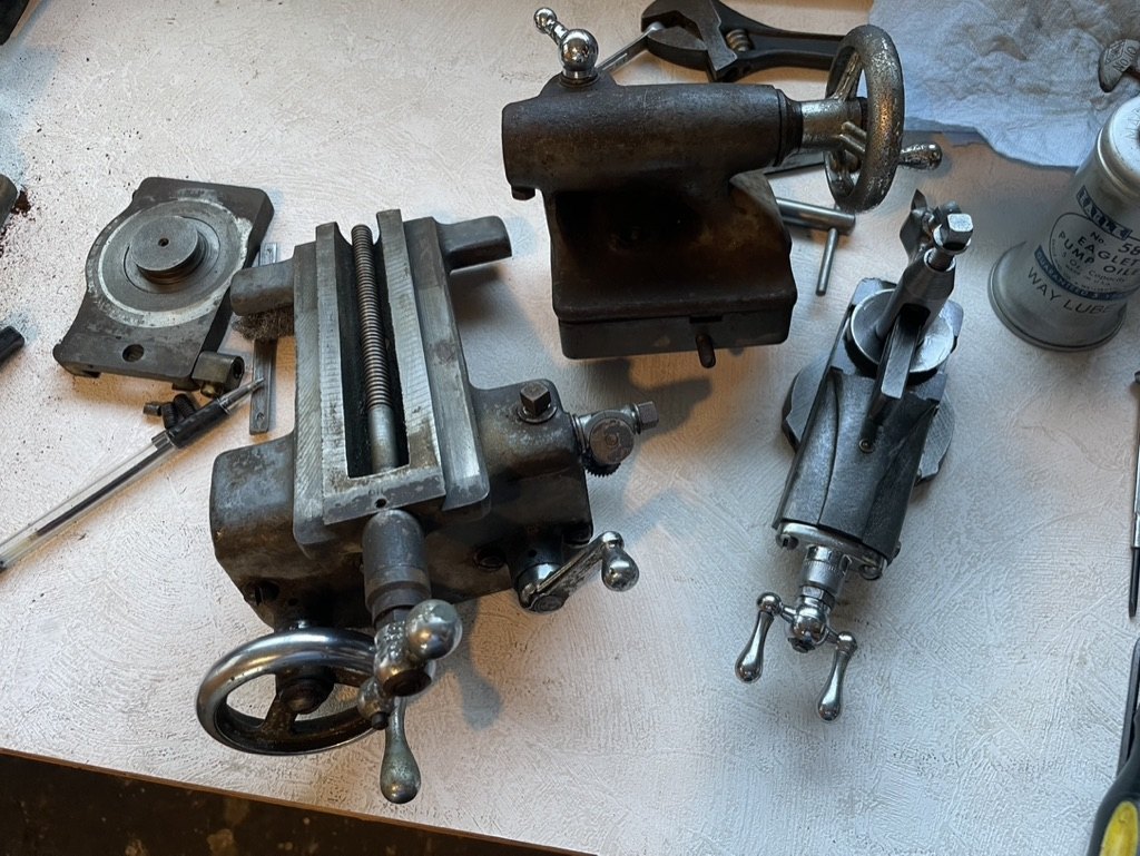

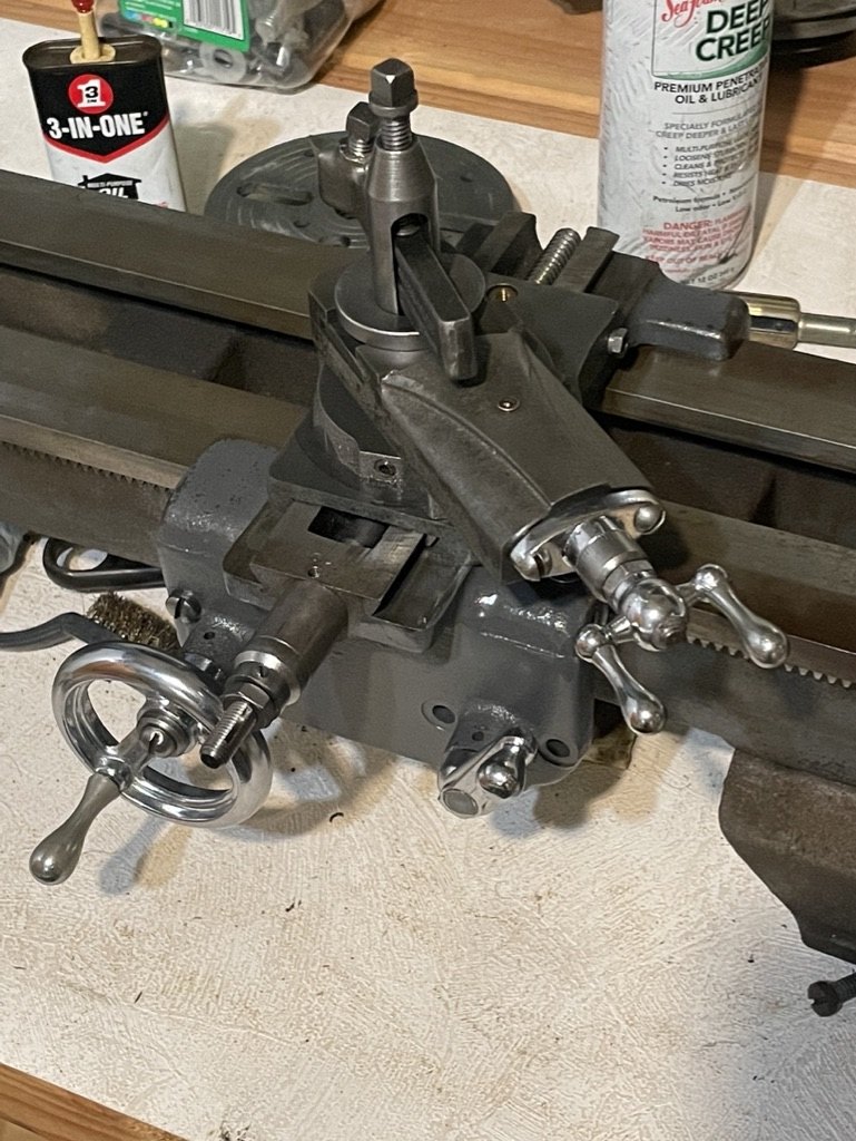

  17. The stripped carriage. Straight from the phone because I ran out of patience.

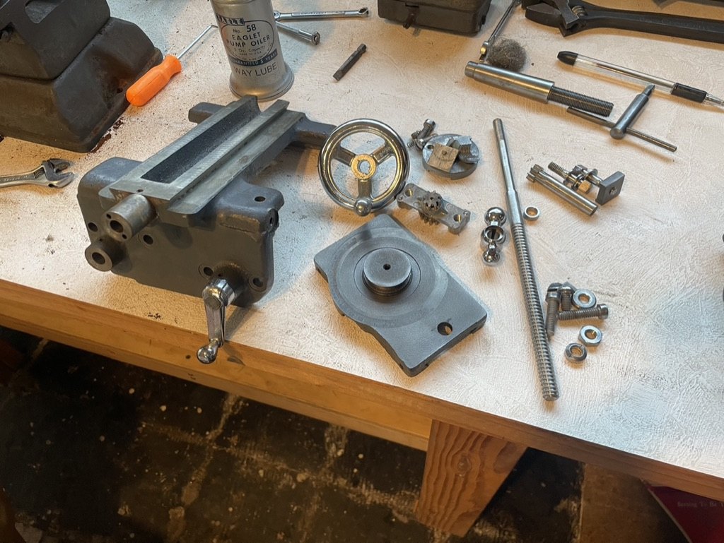

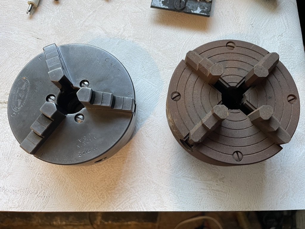

  20. Photos are fixed. .heic isn't the problem, it happened because I edited them, just rotation. Apparently I was impatient, I guess they take a while to re-develop after rotation. Details: I photograph with my iphone 12 mini, they magically icloud themselves to the computer, I post from the computer, and drag/drop them onto the post. I tested with a few, editing is what makes them not work. Sometime between a few minutes and about an hour they became ready to drop. Here's the chucks. I started with Superclean to degrease, then soaked it in Evaporust for about a day, then a fine wire wheel to shine it up some. After way too much reading about what to lube it with, it's just like asking "what oil should I run in my car", I used way oil and reassembled it. I would barely move before, now it's smooth and easy. And the other photo that wouldn't work. The tool holder slidey thing was the first to be stripped and reassembled. They used decent chrome, most of it cleaned up perfectly. Actually most of the metals and the overall construction seem pretty good for a toy sized lathe. The gears are some weird alloy of aluminum, zinc,+something I can't remember and said to be easy to chip/break, but apparently wear well as long as they're lubed. The carriage is stripped and I'll probably work on that tomorrow. Removing the remaining handle would be somewhat destructive, the shaft is pushed through it and smashed over so those parts will stay through the cleaning. I was going to insert the photo, but it's stuck at the one hour photo place being developed. And I've now learned that it's not an edit problem. Whether edited or recently taken, they need some time to become drag/droppable.
  21. The one in the background was given to me by a friend about 35 years ago. It was in poor shape, my dad took it to work and restored it. Luckily it was a union job, they pay you to do side stuff and supply all the necessary tools and supplies. It looked like new, unfortunately it was missing some parts, never got put to use, then collected 3 decades of rust. In the forground is one Randy (house mate) gave me a couple weeks ago. I wish I'd taken photos before starting on it, it was in pretty nasty condition. At first I was going to use it to restore the first one, then decided to just work on the 'new' one. I kinda want to fully restore it and paint it, but I'll probably just do a mechanical restoration so that it works properly. At one point I decided that if I could get hammertone green spray paint so it would match the mill I'd do it, but it doesn't appear to be available without spending close to $100/can...nope. Both chucks were in the same condition. I don't know why the photo won't show, fucking computers, maybe it will if you click on it. 3785A836-A254-4FD7-9811-C12E5D7816C4_1_201_a.heic One part done, lots more to go. 2A9EB27A-7699-4611-A02C-F19B5846C0B1_1_201_a.heic
