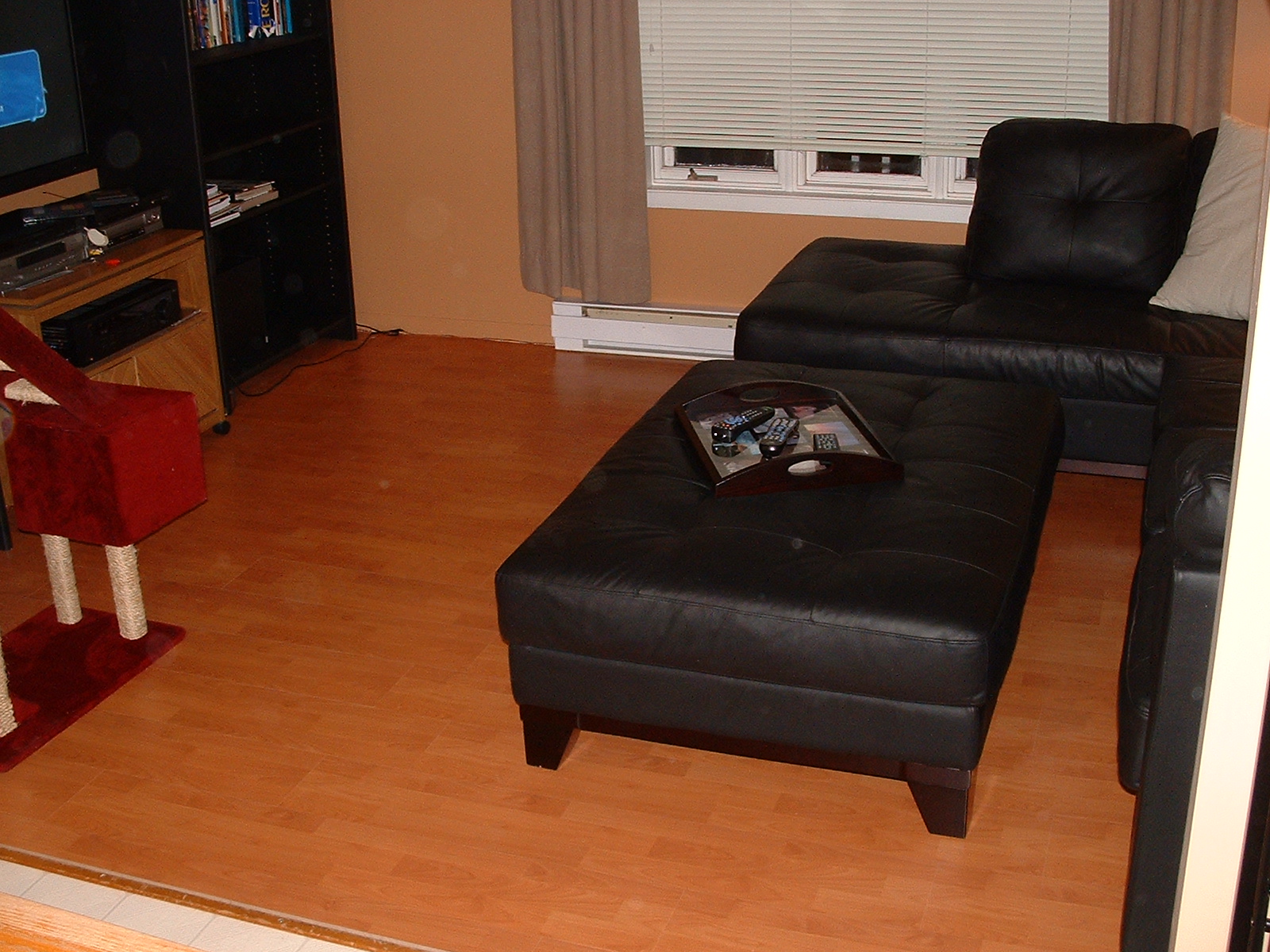

JoWhee Posted December 10, 2006 Author Posted December 10, 2006 I've been using the 6" scraper along with a puty knife works great, now I'm getting the click floor down it looks even better. [attachmentid=5508] Quote
