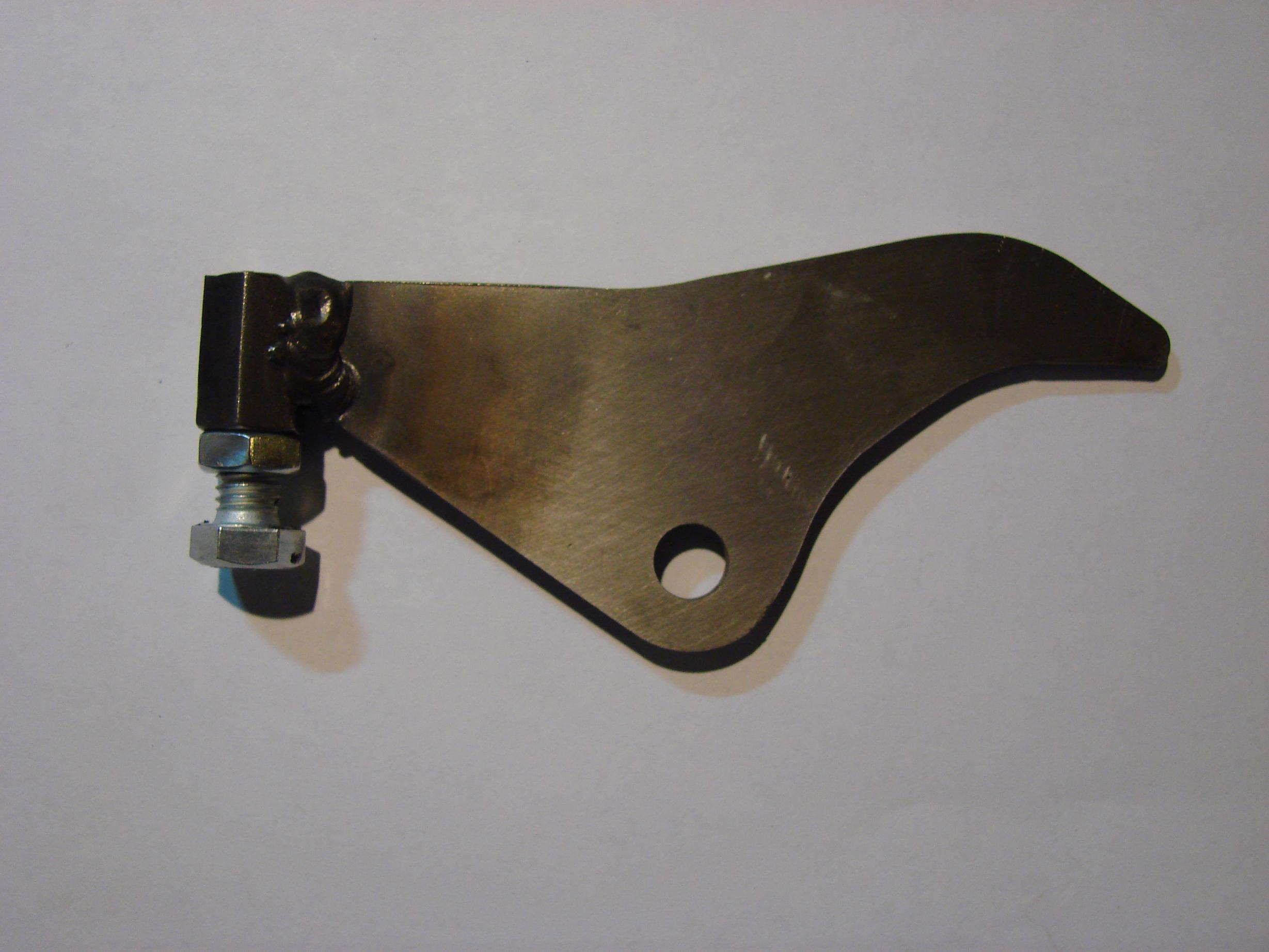

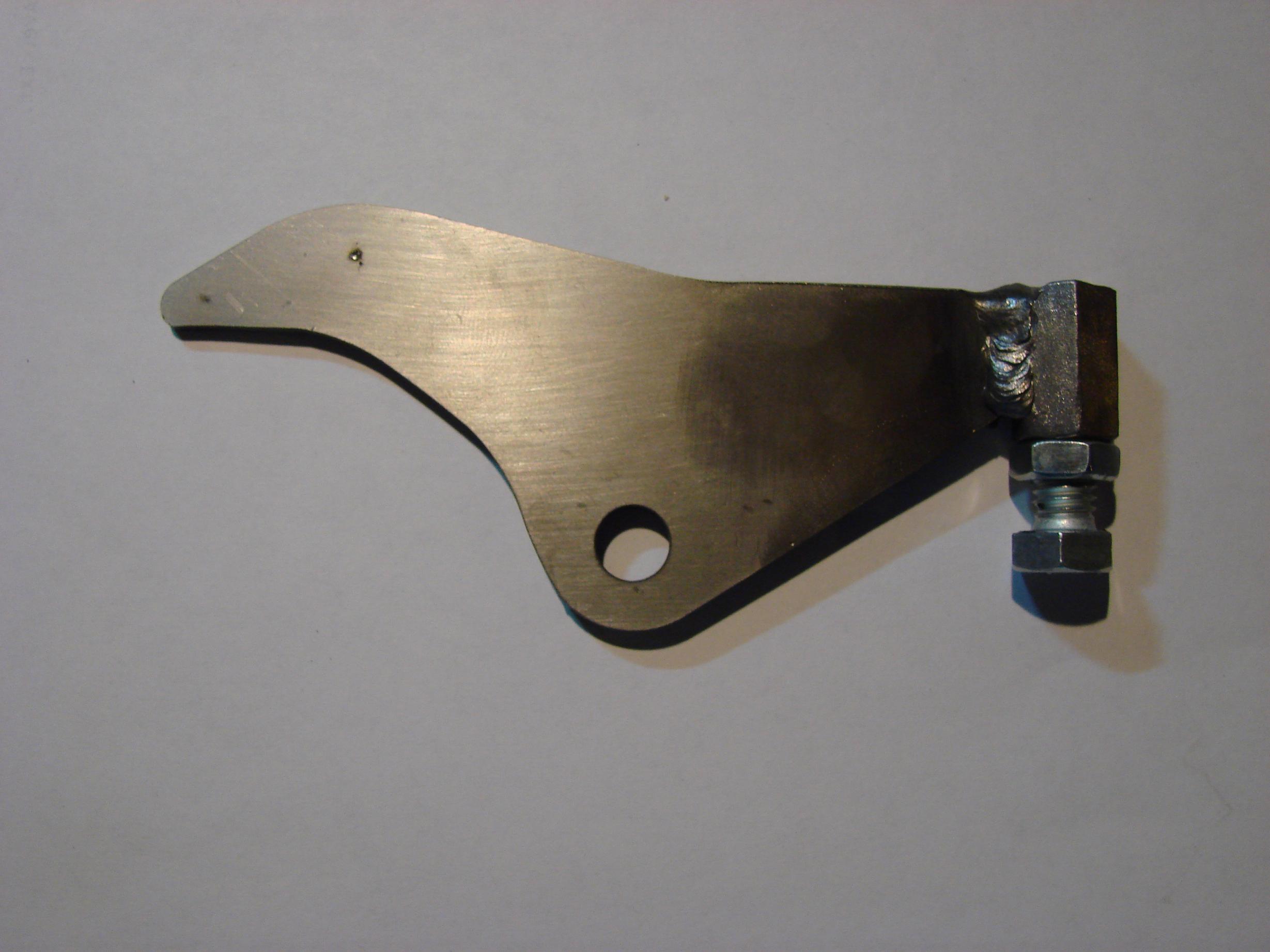

cbrxxquad Posted April 9, 2008 Author Posted April 9, 2008 orginal post for reference and info but the answer is yes to prevent the centerstand from contacting anything, Got a call that I can pickup the prototype tonight. Looks to be around 20 plus shipping in stainless steel, but can't get the coupling nuts in anything but carbon. Would only be 2 dollars cheaper in cs. Yes I can weld ss to cs. I could do powder coat but gonna add. Will post a pic as soon as I can prove it works, but not much difference just simpler. Quote

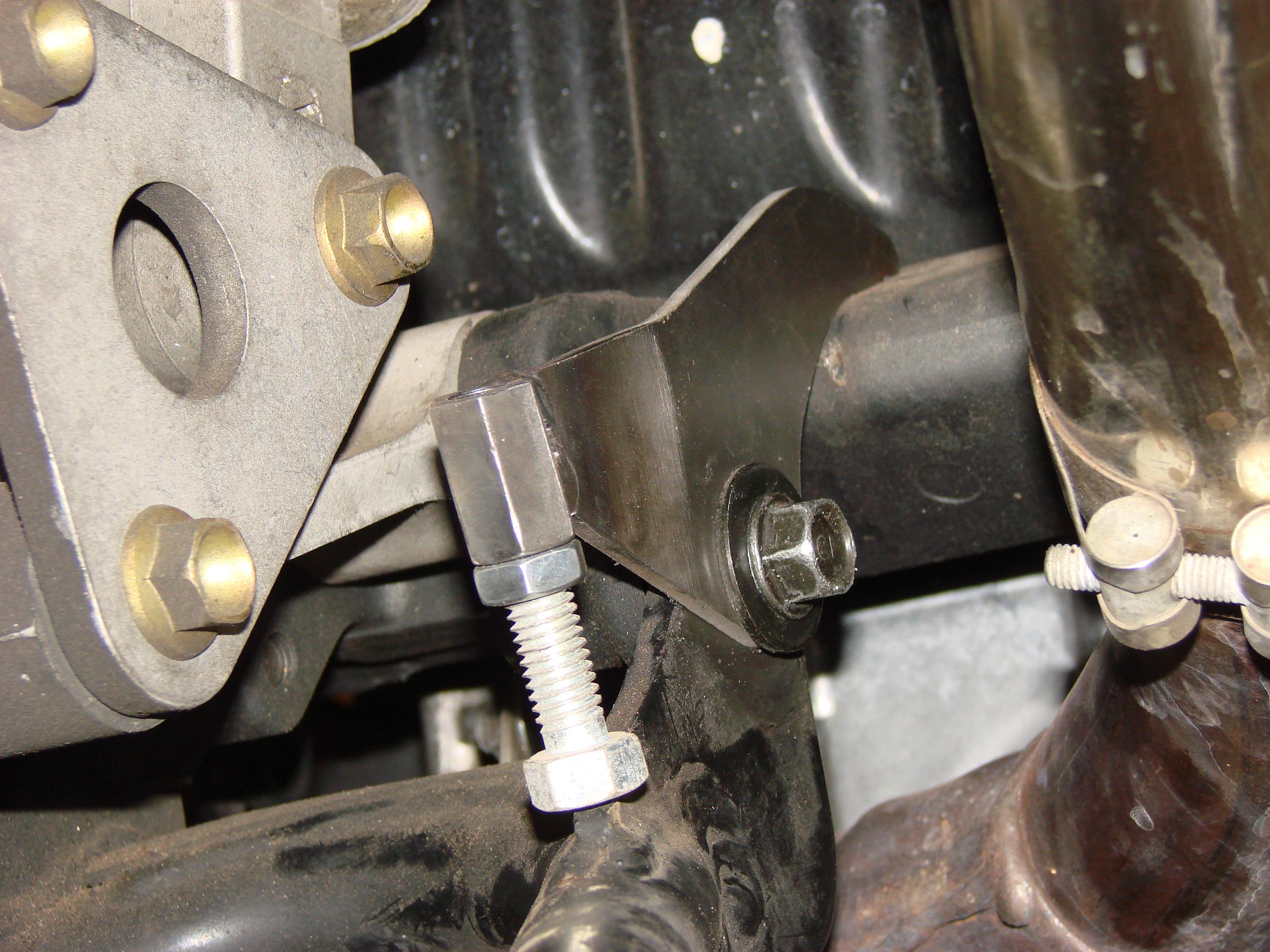

Iceman_40 Posted April 9, 2008 Posted April 9, 2008 I am interested. I had to build a bracket off the stop on my pipe as my chain kept hitting the centre stand. I assume the bolt on the part is a adjustment for where the stand stops? Quote
cbrxxquad Posted April 9, 2008 Author Posted April 9, 2008 I assume the bolt on the part is a adjustment for where the stand stops? Yes, Quote
Iceman_40 Posted April 9, 2008 Posted April 9, 2008 I assume the bolt on the part is a adjustment for where the stand stops? Yes, Thanks. I figured as much, but wanted to check. At least I know if it isn't long enough I can put a longer bolt in Quote
cbrxxquad Posted April 10, 2008 Author Posted April 10, 2008 I assume the bolt on the part is a adjustment for where the stand stops? Yes, Thanks. I figured as much, but wanted to check. At least I know if it isn't long enough I can put a longer bolt in Yes you can If needed, but don't get it so low that it drags when turning. Will shoot some installed tomorrow. Quote
Iceman_40 Posted April 10, 2008 Posted April 10, 2008 I assume the bolt on the part is a adjustment for where the stand stops? Yes, Thanks. I figured as much, but wanted to check. At least I know if it isn't long enough I can put a longer bolt in Yes you can If needed, but don't get it so low that it drags when turning. Will shoot some installed tomorrow. No worries. It's been in this position for 20,000 km and some of that was real twisties so I'm safe. Just nice to know I can get rid of the shitty one I put on and still be able to get the stand back where I want it. Quote

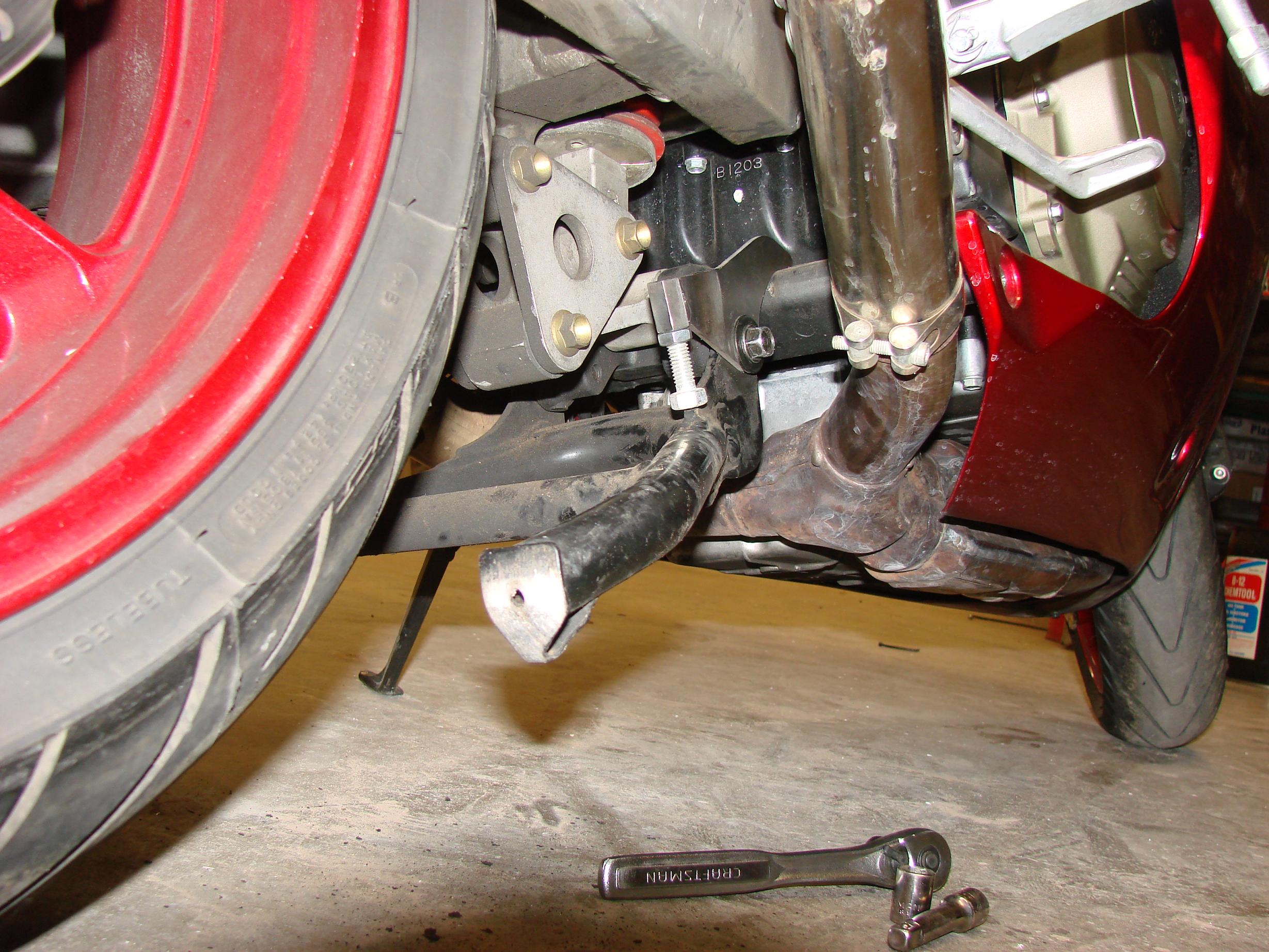

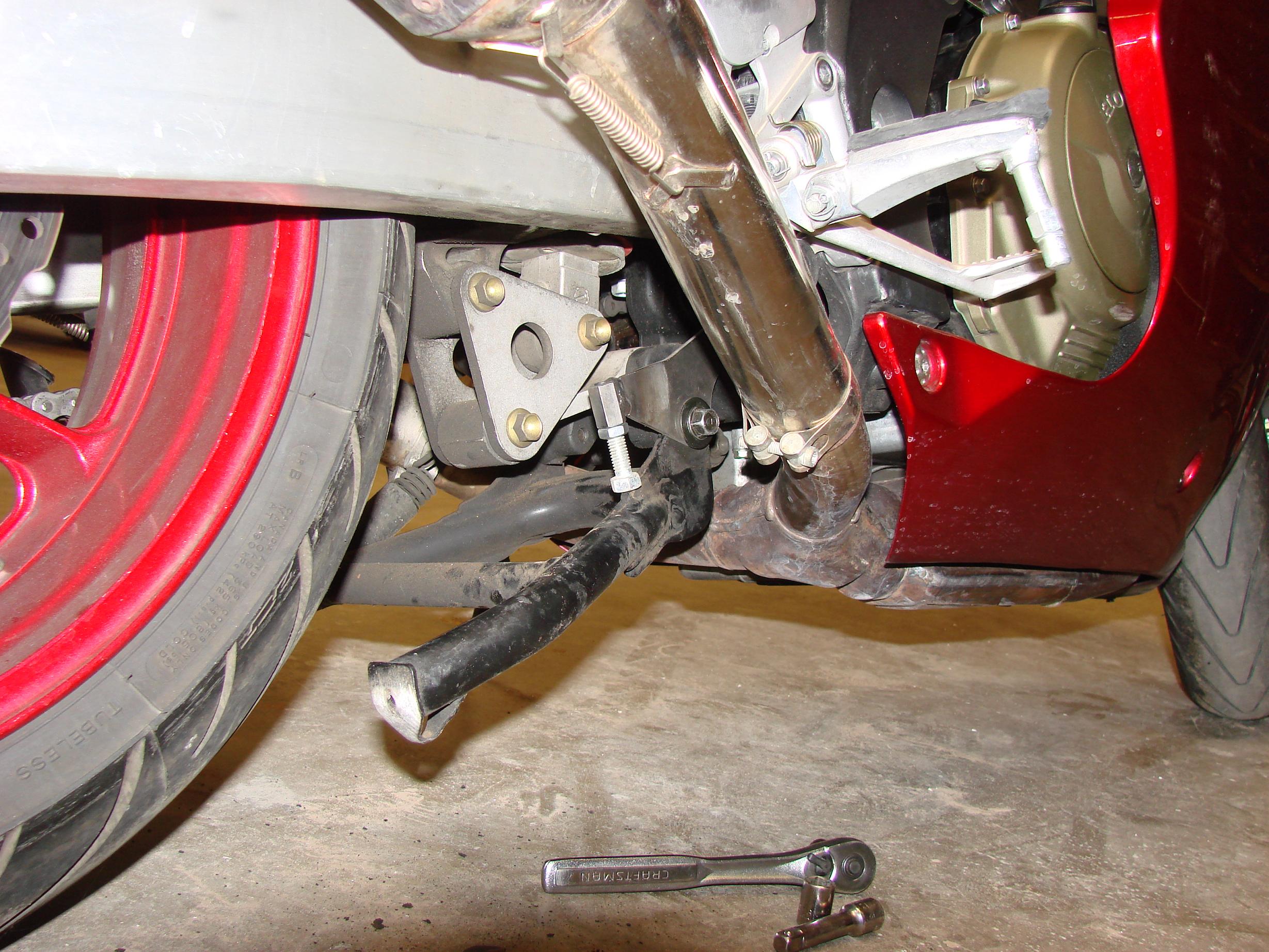

cbrxxquad Posted April 10, 2008 Author Posted April 10, 2008 Pictures added of the install to first post. Quote
