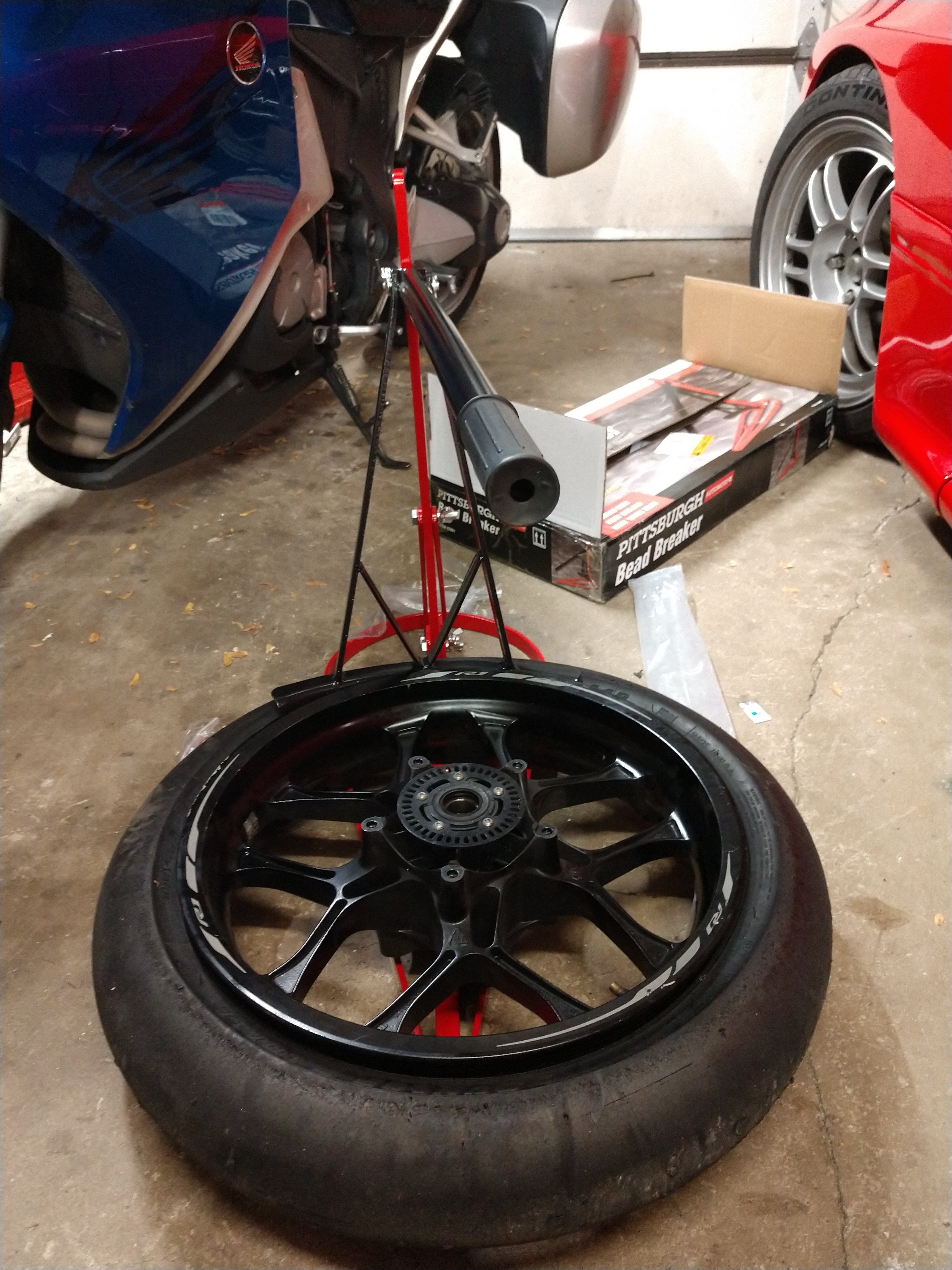

Typically it  takes me 30-60 seconds to break bead on common motorcycle tire with nothing more than couple spoons. Dunlop race slicks are entirely different animal, extremely stiff construction. It is major pita to break bead on them, with HF tool -10 seconds job.
I have had one of those for about 25 years or more and it does work well.  It has been used on all my motorcycle tires, car and even large pick up truck tires.  I use a couple pieces of wood (2x4) under the wheel to protect the rotors which I see that you don't have on in your photo.

I use a 2x4 under my trailer hitch, with a rubber mat under the rim for protection, and/or more wood for keeping the discs off the concrete.  Practically free, and only have to store the 2x4's.  Came close to buying the H-F unit a couple times, but I already had the lawn mower tire version (POS), and hardly ever used it.  Would have built one that fastens to the garage wall studs, if I hadn't insulated and sheet-rocked.

BTW, you would not be able to break the bead on that Dunlop slick with other ways mentioned by Jon and blackhawkxx. Trust me on this. It is that difficult. It does help if you keep it in tire warmers for 1 hr or so.
Sure wish I could give it a try, because I've busted beads that took 50 psi to to re-seat (with soapy water).  Do you have this same issue with different brands of wheels/motorcycles?  Does a new slick seat fairly easily?
Dunlop slick  is the only m-cycle tire I had problems with breaking the bead. Rear Dunlop slick on Yamaha R1 rim will make grown man cry. This particular rim has very shallow "dip" in the middle. The takes considerable force to remove or install even with proper m-cycle spec tire machine.

So, it is very tight fit but I never had Dunlop spin on the rim. Pirelli slicks spin fairly easy unless you use special sealer.
