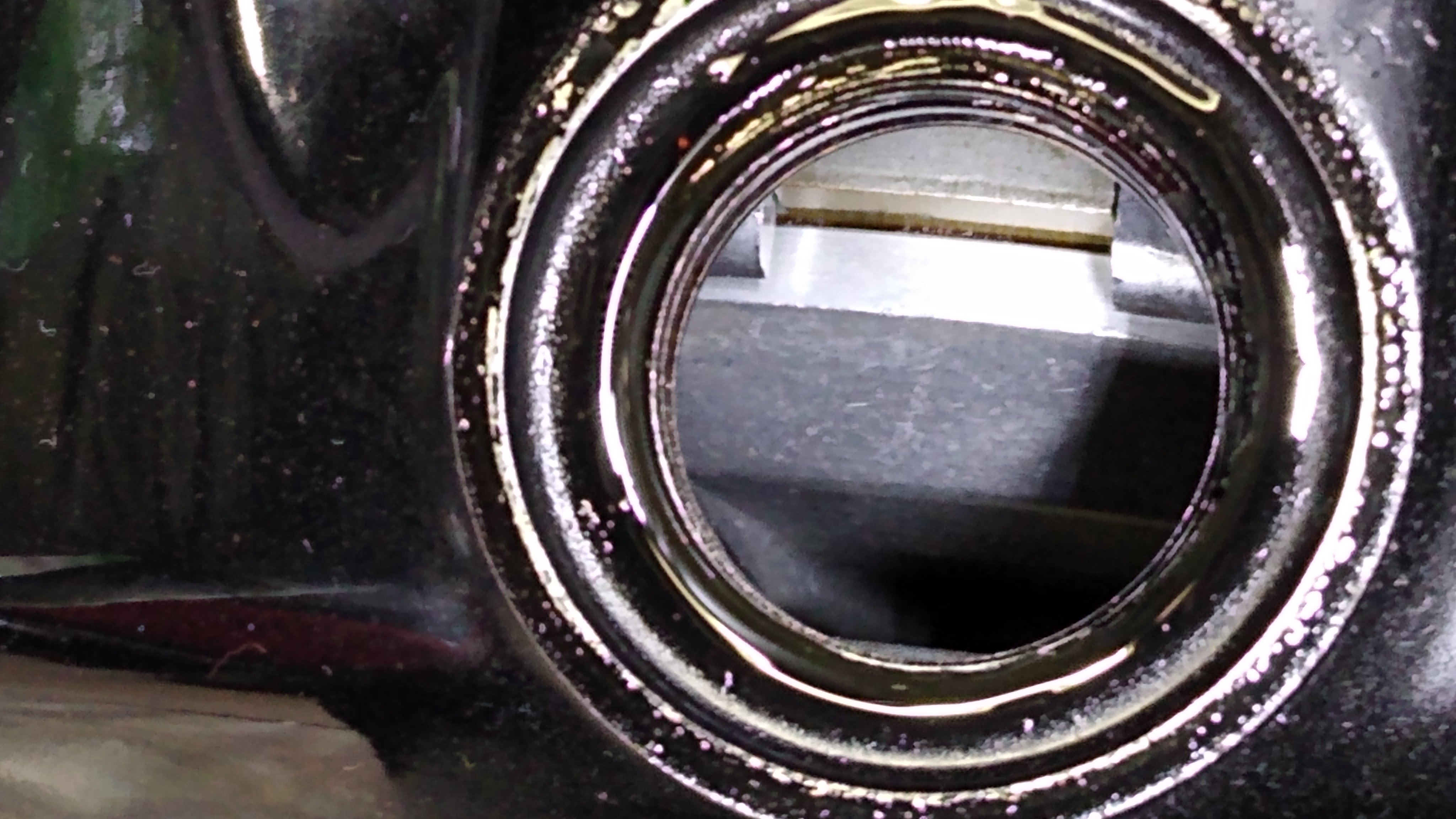

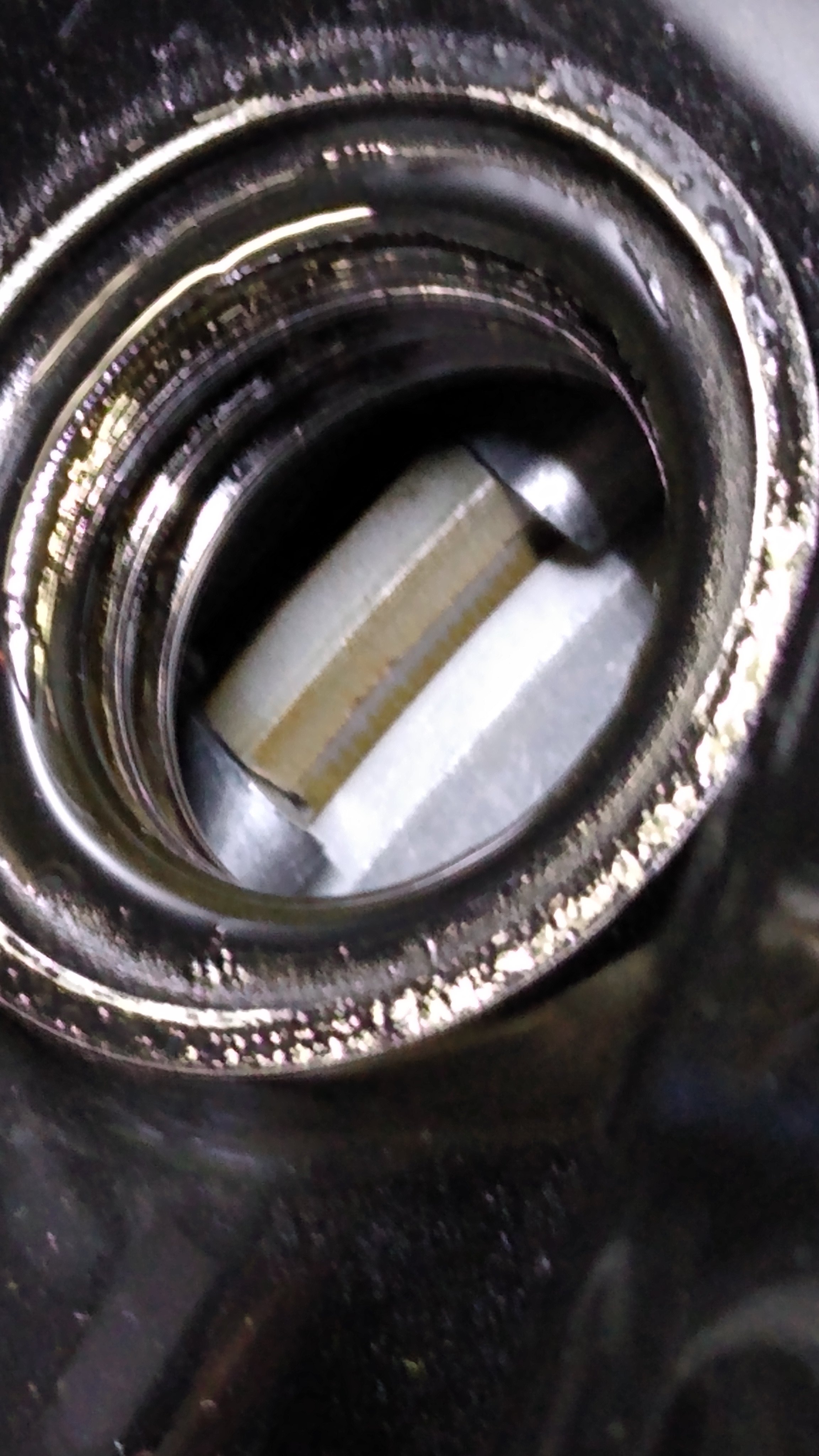

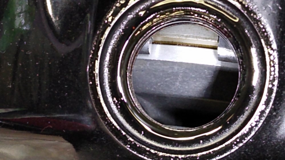

superhawk996 Posted May 2, 2020 Author Posted May 2, 2020 It's supposedly super special great oil, but normally I wouldn't spend that kinda $. I did it as a last attempt before deciding that there is definitely something up with the clutch that needs investigating. The shifting smoothness compared to the M1 15-50 makes it worth the $, but if my clutch does have an issue it might shift as well with the cheaper oil once that's cured. If any of you would shoot a pic of your clutch through the oil filler hole it might help me ID what's in there without taking it apart, mine may have an aftermarket clutch. Also, if you have a way to measure the stroke of the clutch while you're there that could be quite helpful. One of my previous bikes, maybe my first '97BB, had a noticeable improvement with bike spec 10-40 (I think it was Castrol synthetic) compared to Rotella 15-40. Quote

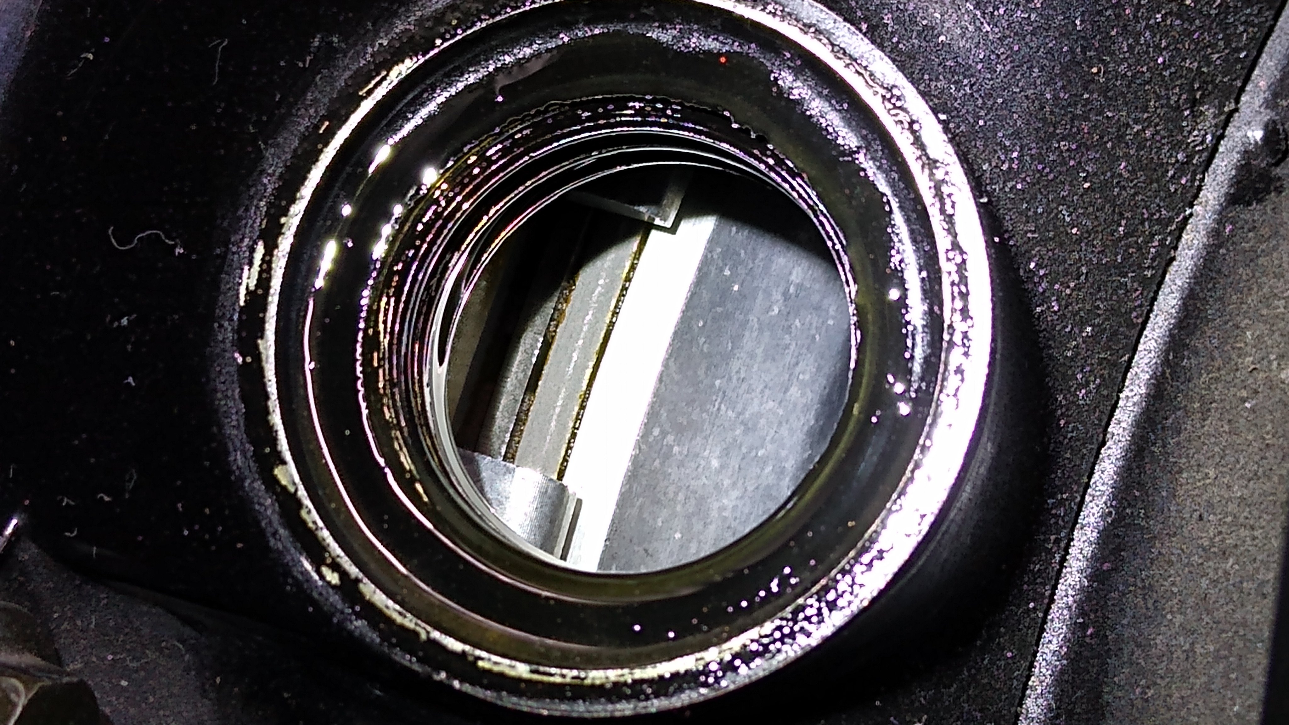

superhawk996 Posted May 3, 2020 Author Posted May 3, 2020 2 hours ago, blackhawkxx said: Thank you. Would you take a shot at about the angle of the first one but with the clutch lever depressed? That should give me a good reference for how far the stock system moves it. Quote

blackhawkxx Posted May 4, 2020 Posted May 4, 2020 23 hours ago, superhawk996 said: Thank you. Would you take a shot at about the angle of the first one but with the clutch lever depressed? That should give me a good reference for how far the stock system moves it. I found it hard to hold my larger phone and the lever plus click the photo. Quote

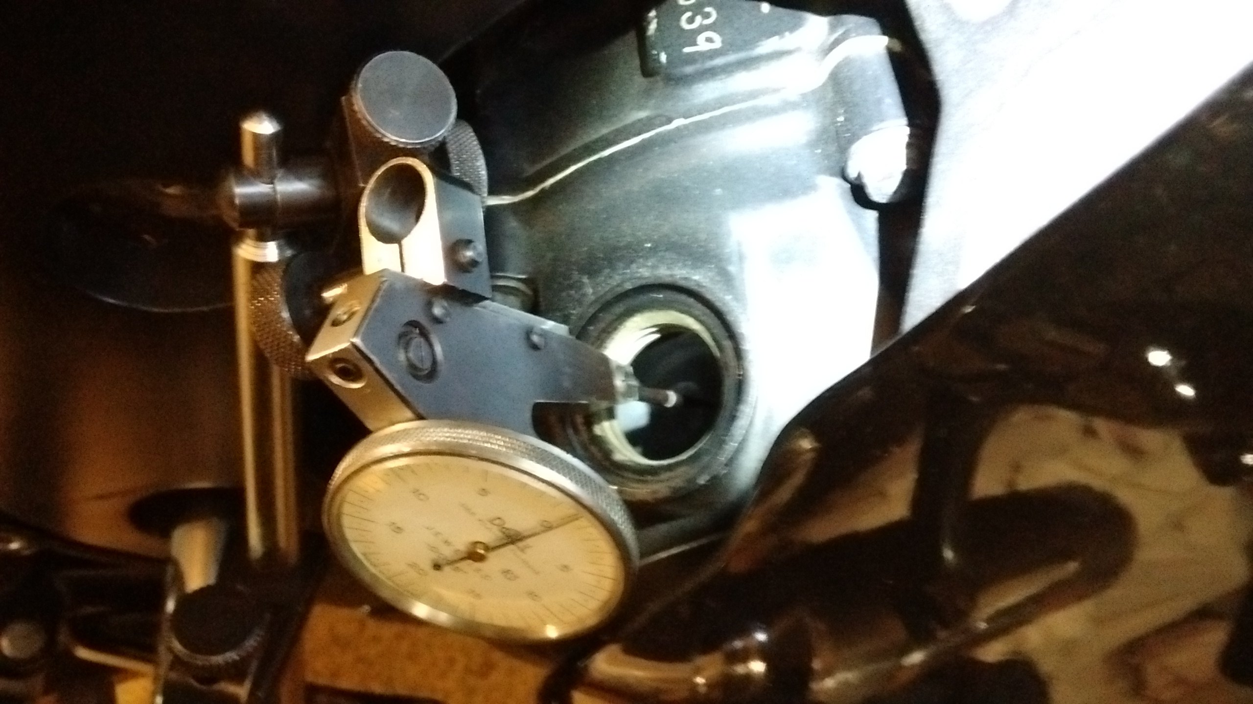

joblock Posted May 4, 2020 Posted May 4, 2020 On 05/02/2020 at 7:39 AM, superhawk996 said: It's supposedly super special great oil, but normally I wouldn't spend that kinda $. I did it as a last attempt before deciding that there is definitely something up with the clutch that needs investigating. The shifting smoothness compared to the M1 15-50 makes it worth the $, but if my clutch does have an issue it might shift as well with the cheaper oil once that's cured. If any of you would shoot a pic of your clutch through the oil filler hole it might help me ID what's in there without taking it apart, mine may have an aftermarket clutch. Also, if you have a way to measure the stroke of the clutch while you're there that could be quite helpful. One of my previous bikes, maybe my first '97BB, had a noticeable improvement with bike spec 10-40 (I think it was Castrol synthetic) compared to Rotella 15-40. Quote
XXitanium Posted May 4, 2020 Posted May 4, 2020 15 hours ago, superhawk996 said: Do you think light oils might have lead to an early death on your R1? Speaking of which; I lost track on that motor. Did you rebuild it? If so; any power mods done in the process? I'm young and impressionable. If someone doesn't disprove this, I might try it. ....this one? Quote
superhawk996 Posted May 4, 2020 Author Posted May 4, 2020 3 hours ago, joblock said: That kinda looks like a dial indicator, but they only measure linear movement in line with the plunger; what is that thing called? Today I played with the adjustments and might have figured out the solution. The mysterious mechanical clutch actuator is kinda odd and it appears that I just need to make some adjustments/tweaks. The cable is too long to get a proper adjustment without having the adjusters all the way out to where they're falling off the threads, but at that point I was able to get a good release and find neutral. I'll take some measurements using your guy's measurement & photo to confirm, then I'll probably have to have a cable made to the right length. Thank you joblock and blackhawk. 2 Quote
